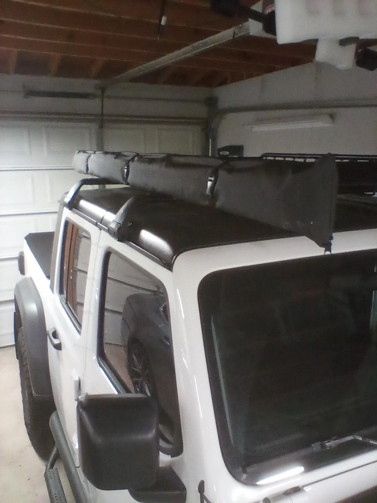

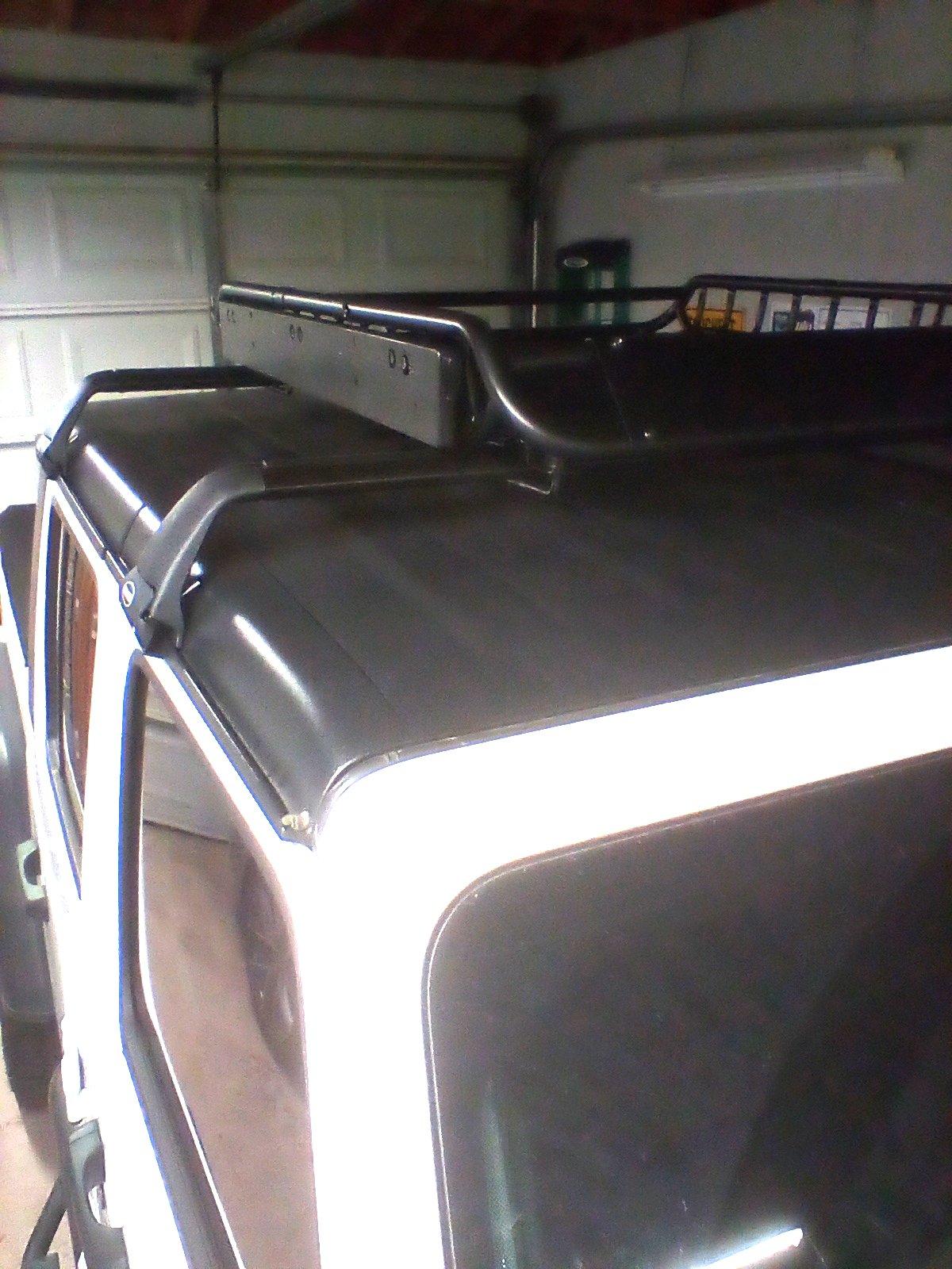

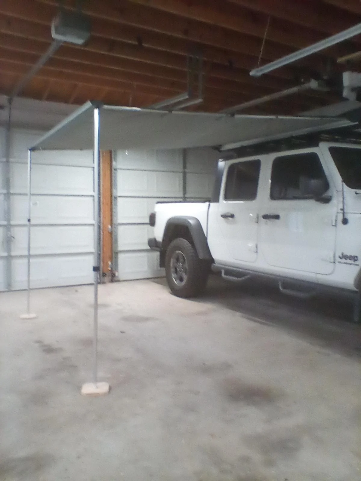

Hooke crossbars, Maxxhaul roof rack, Yescom canopy and a piece of 1x4. Ready for the South Texas sun with sand pads for the poles.

Jeep Gladiator Mounted Awnings IMG_20200728_112308
WHY the 1X on rack?

The side of the rack is not vertical and canopy design requires vertical mount. Simple fix is board thicker at the top u-bolted to the rack vertical bars.

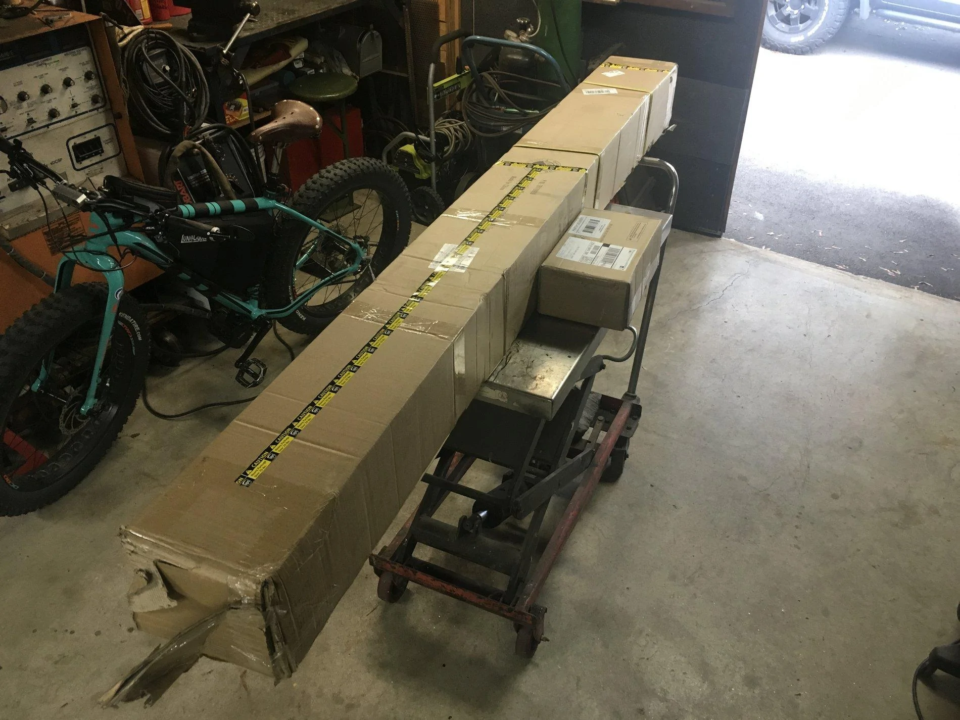

OVS 270 just arrived!

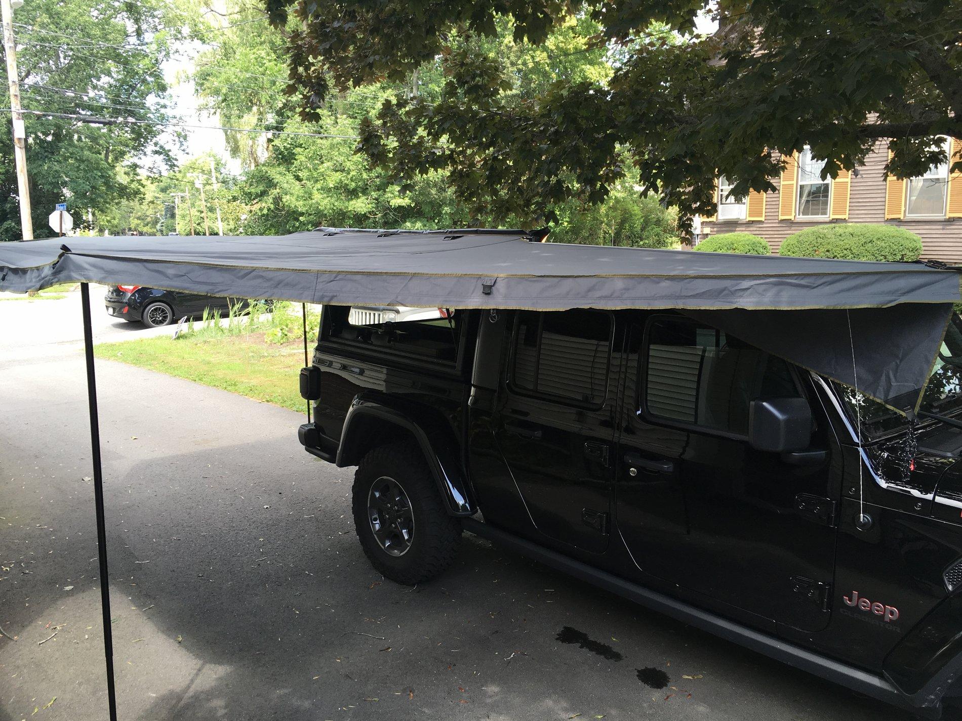

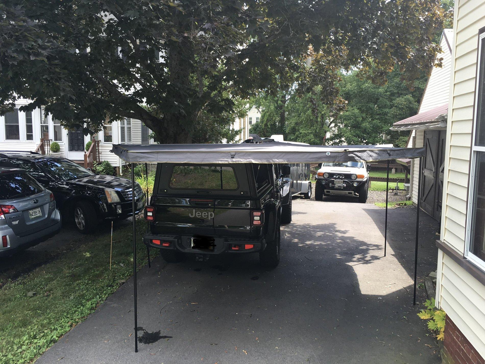

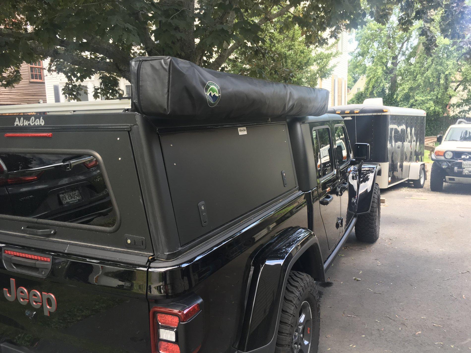

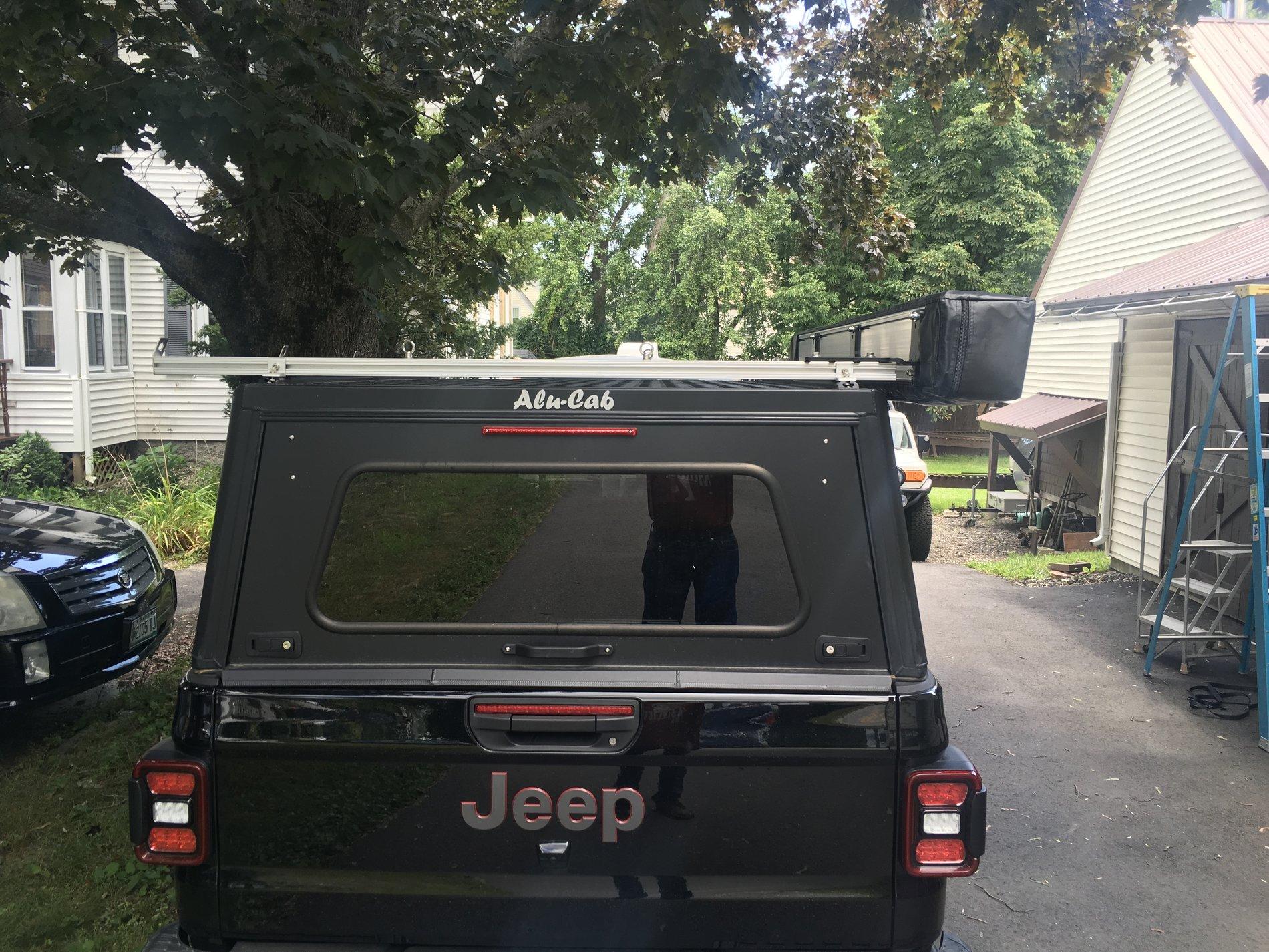

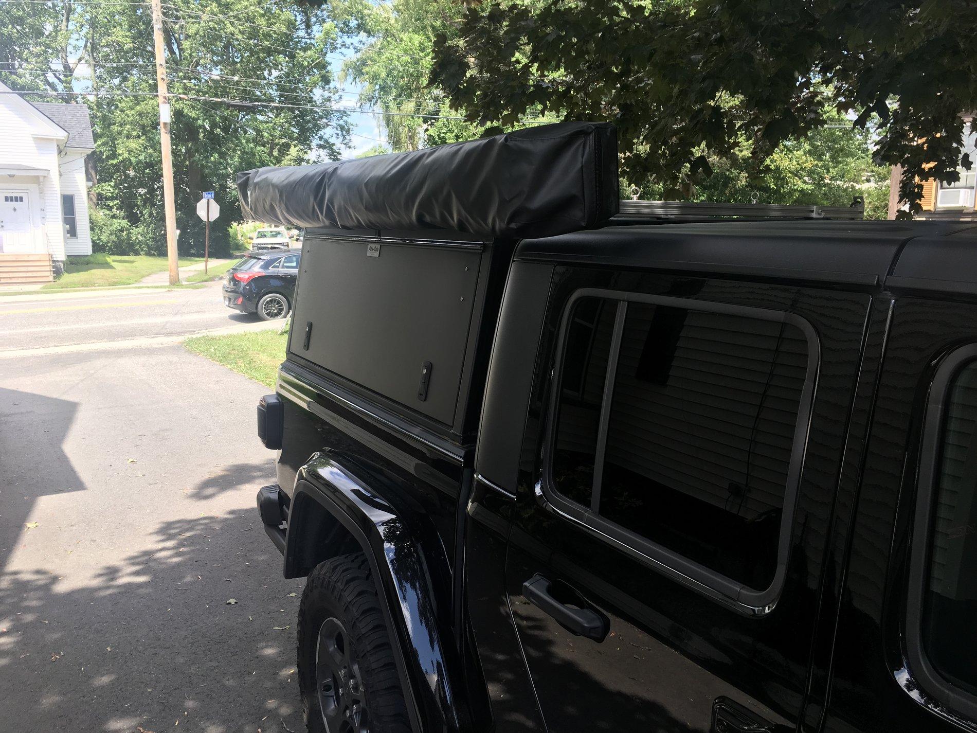

Got my new OVS 270 mounted up to the Alucab cap. This is a really nice awning. Impressed with the build quality. Deploys and stows easily. There is a lot of shaded real estate created. No interference with any of the cap hatches. Pretty stoked with the purchase!

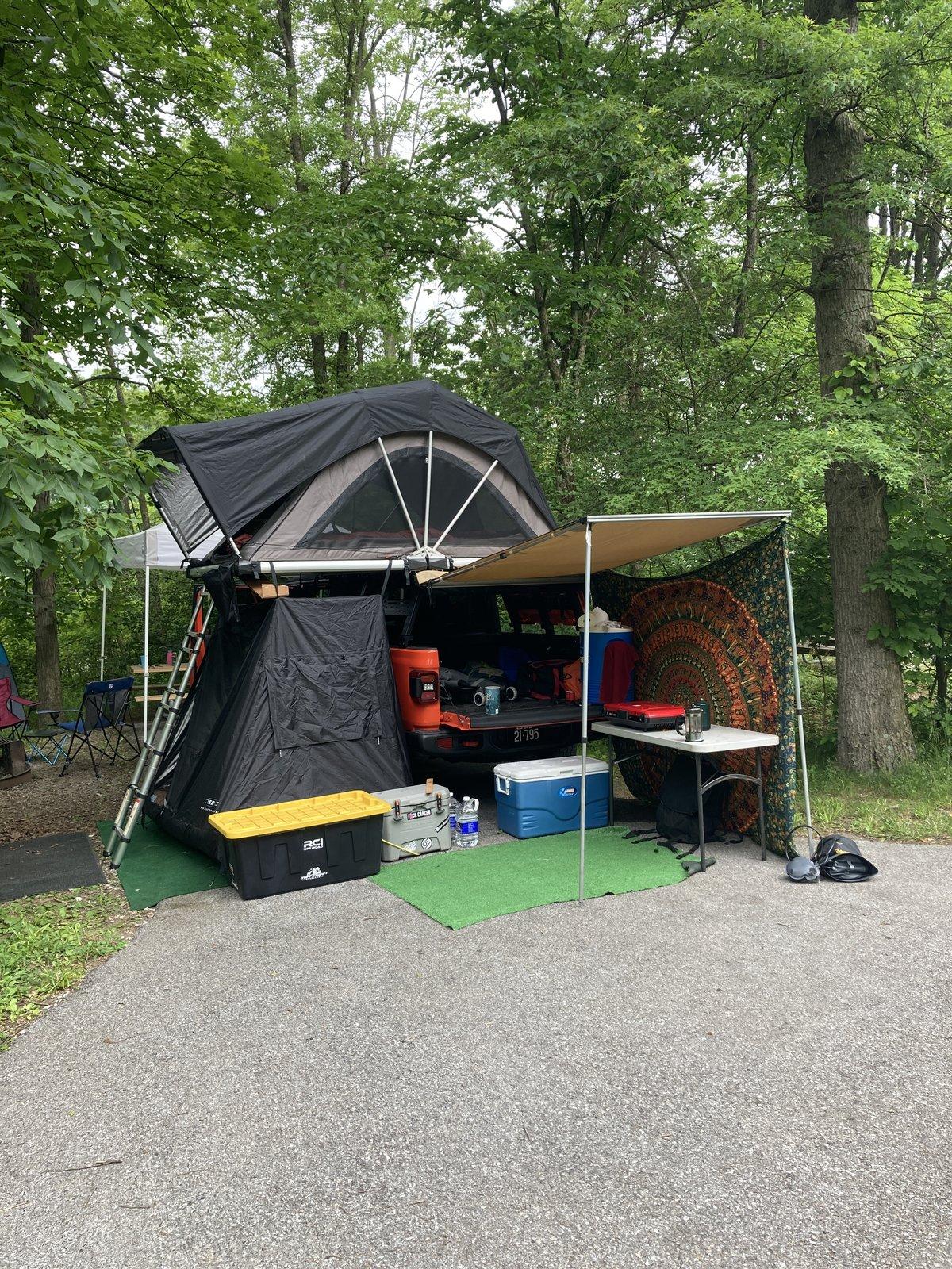

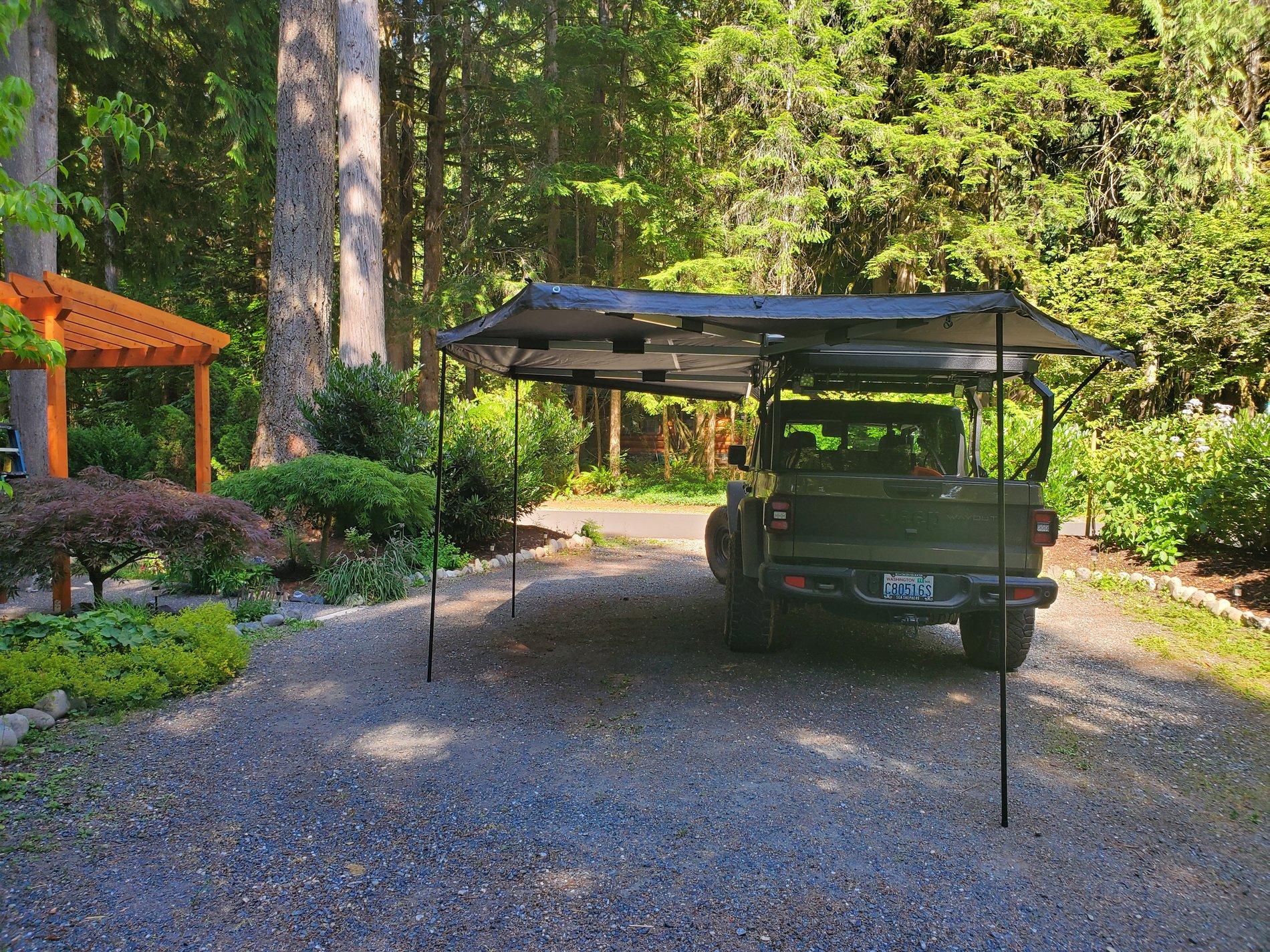

Got my awning mounted up too. It got 7' of head clearance. This thing is going to be a nice addition to my RTT & annex room for the next overlanding trip
So far the quality & durability look pretty well done.

I don't think it is a good idea to secure the front arms open tying off on the extension flap. Your strap should be going to the stout loop on the end of the arm. The flap is a separate attachment using one of the small ropes.

Hey thanks for pointing that out. Since it was my first set up I did not catch that. Wish the instructions would have been better at point that out. Could save alot of people's awnings in windy conditions.

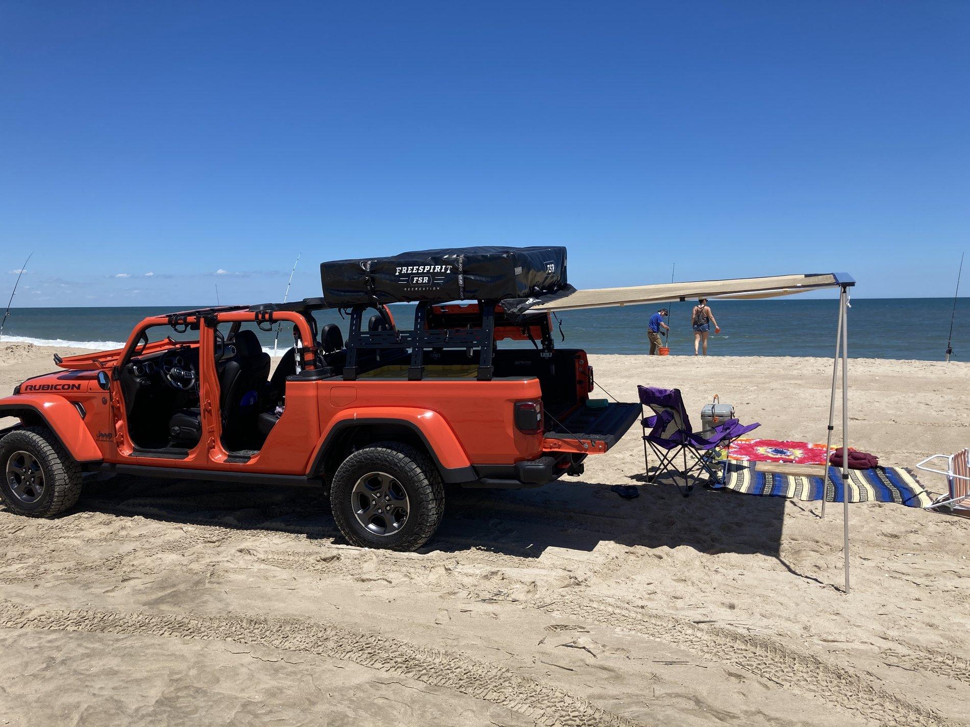

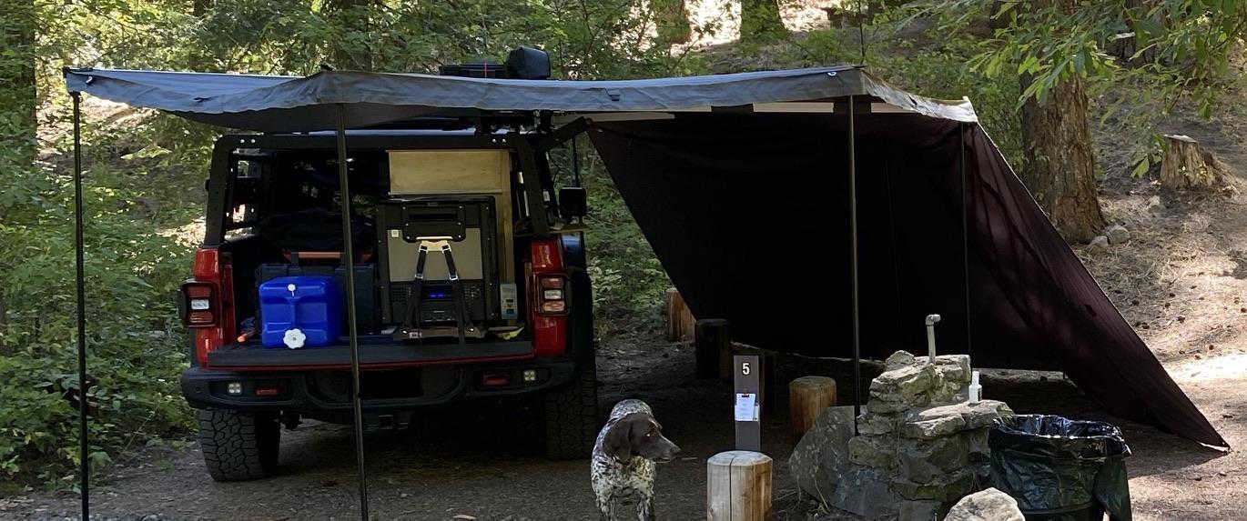

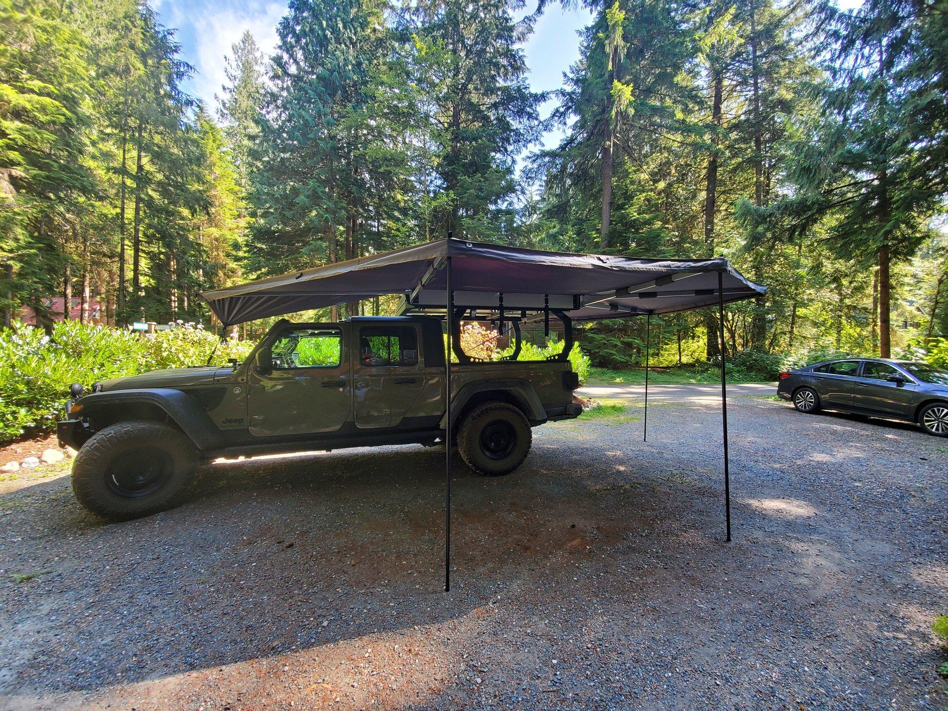

I also got one of the OVS Nomadic 270 awnings recently. Mine is mounted to a Frontrunner tray atop a ZROADZ rack. I've only used it once, but I'm loving this awning so far. Here's a pic with one of the walls installed. The walls really enclose a lot of space!
Jeep Gladiator Mounted Awnings 1597688202672

@bradxn, Is that Wall #1 you have set up in your pic? Does that have a door? Can't tell in the pic.... or is Wall #1 two separate pieces of which you only have one set up?
