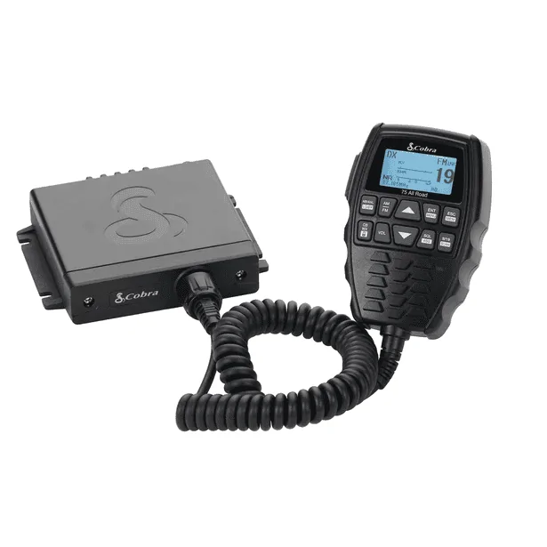

If you are trying to hide the radio and it must be CB .. I'd suggest looking at the Cobra 75 Little amp can be hidden under the kick plate below the steering wheel or behind the glove box. All the controls are on the mic ...
Jeep Gladiator Mounting a small CB in the center arm wrest 75_ALLROAD_3QTR_HANDSET_RECVR_615x
+1 on this suggestion.

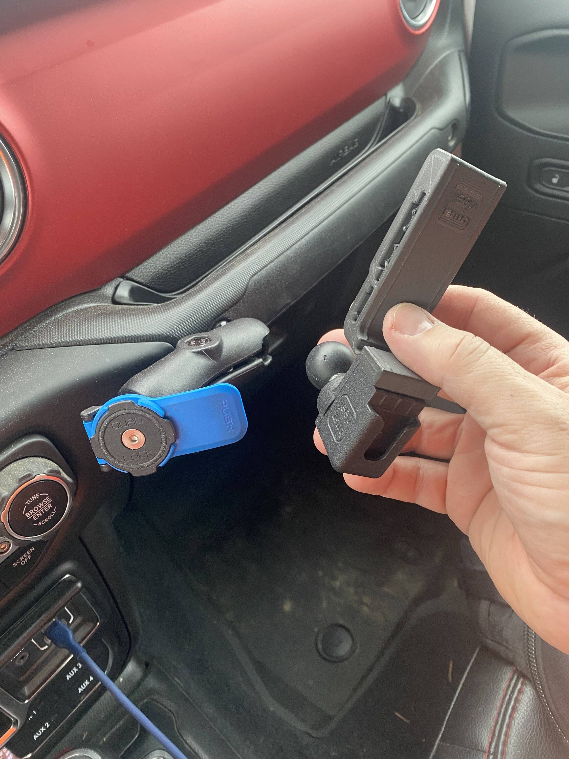

I have the older version in both of my JKUR’s and my JTR. Minimal footprint so they are mounted behind the glovebox and the handset is hanging off a CMM Offroad grab bar call mount. Honestly a very convenient solution.

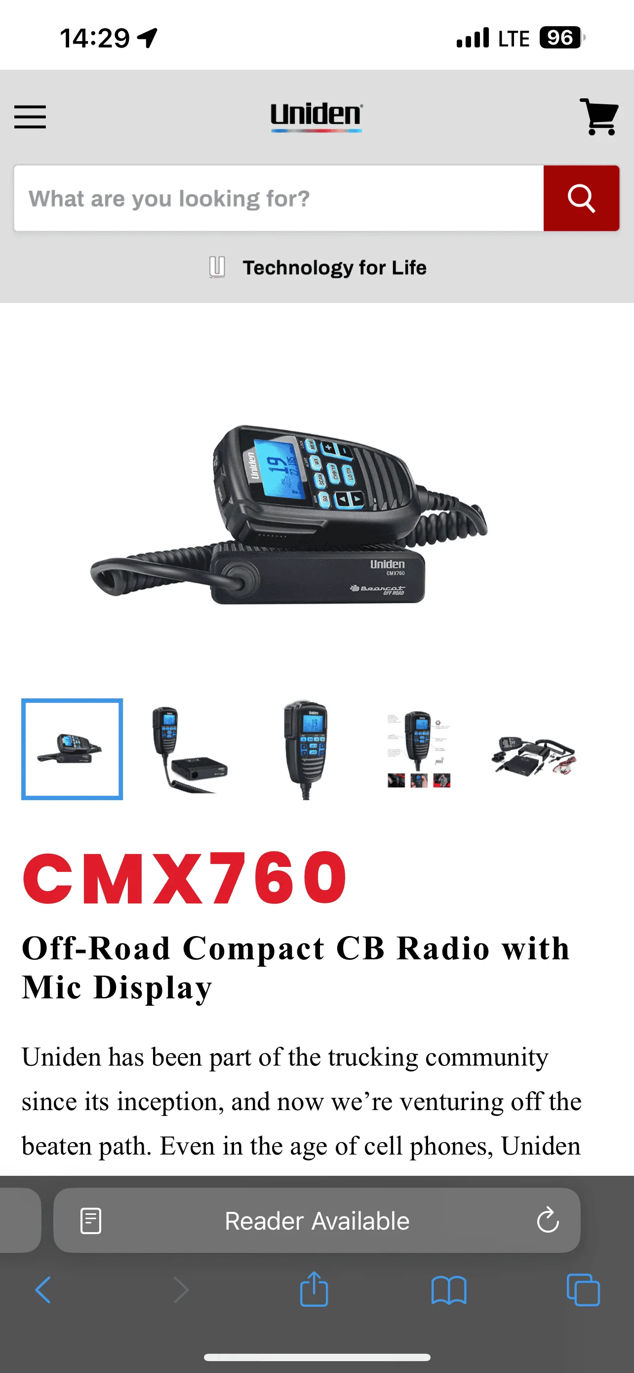

Uniden also has a small body option. i have this mounted and connected to a stryker antenna. Have not been able to do functional tests yet though

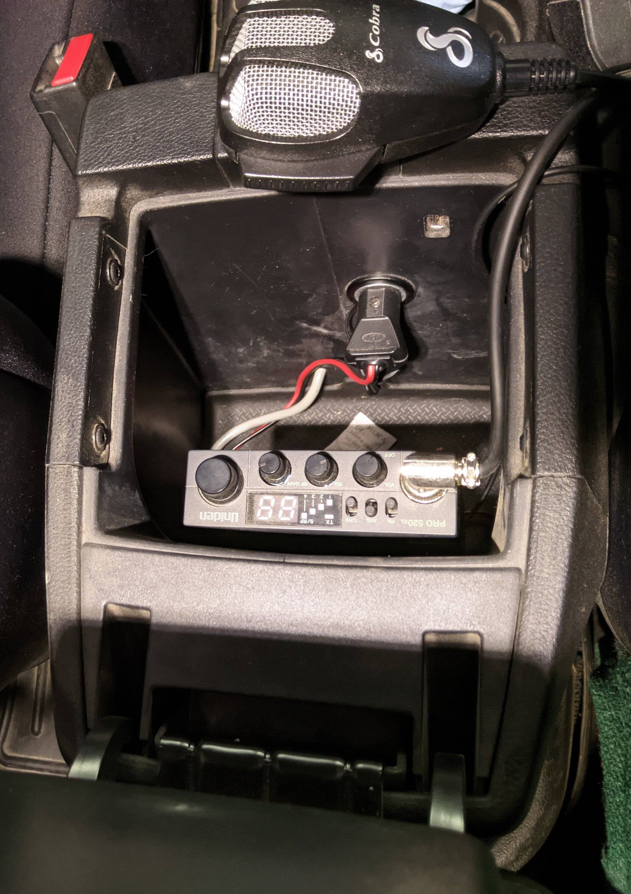

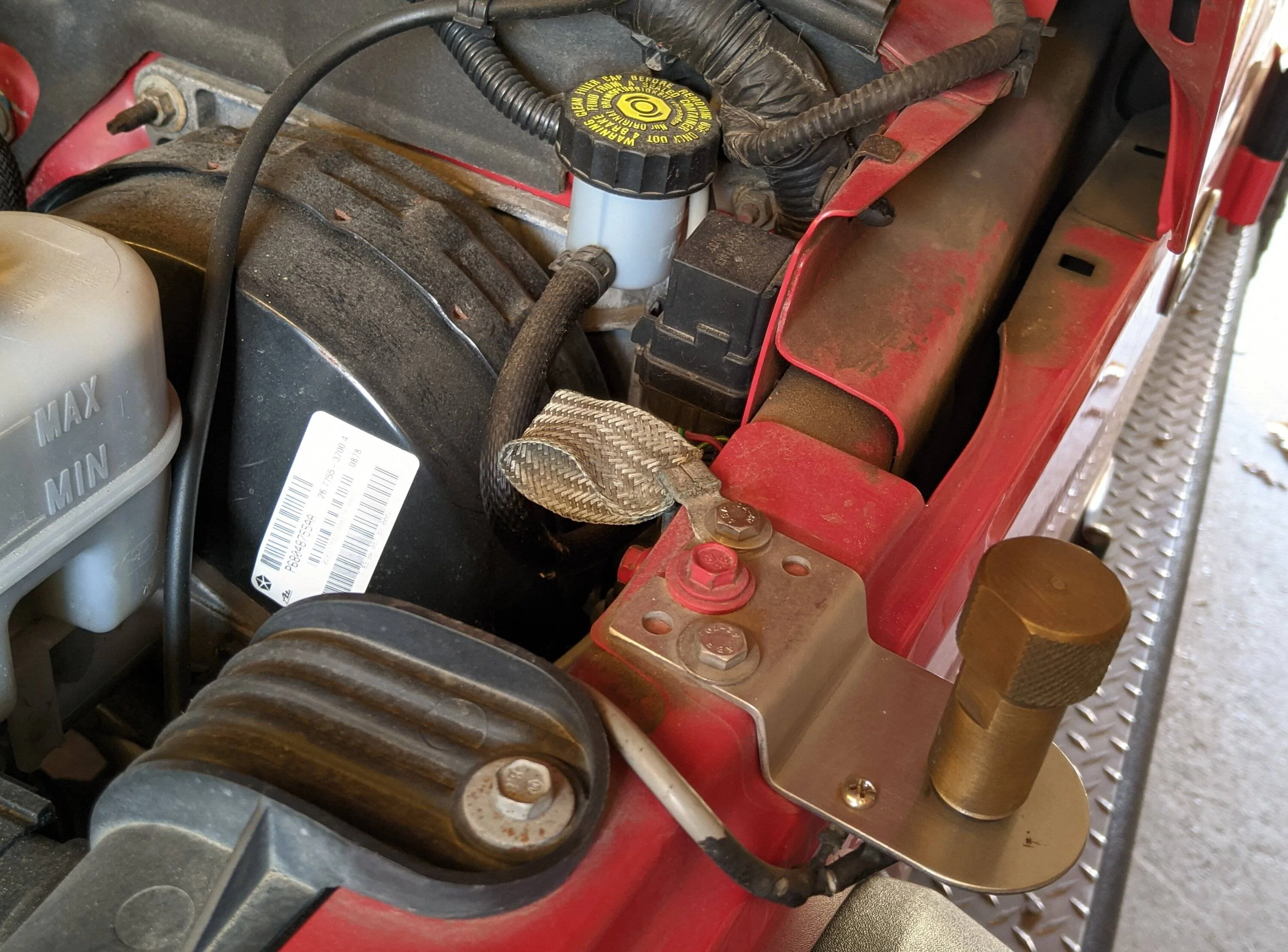

I mounted a Uniden Pro 520XL in my JKU center console for the same reason you are contemplating, although I never have used it much. My antenna is a steel whip mounted to the driver-side fender on a bracket that comes out from the hood gap. Not quite symmetric with the FM antenna on the other side. The JK center console is different than my JT console, though; it is deeper (The Uniden is 9" high even with a right-angle Mic adapter), and it has a 12v cigarette source inside. I only had to drill one hole near the bottom for the coax antenna cable. I use an aux 3.5mm stereo cable to plug into the JK's radio as an aux input. Radio itself is attached with velcro, which has stayed put for 10+ years.
This is actually exactly what I was thinking aboutdoing. Hadn't considered hooking the power straight into the cig lighter inside. Pretty ingenious tbh.

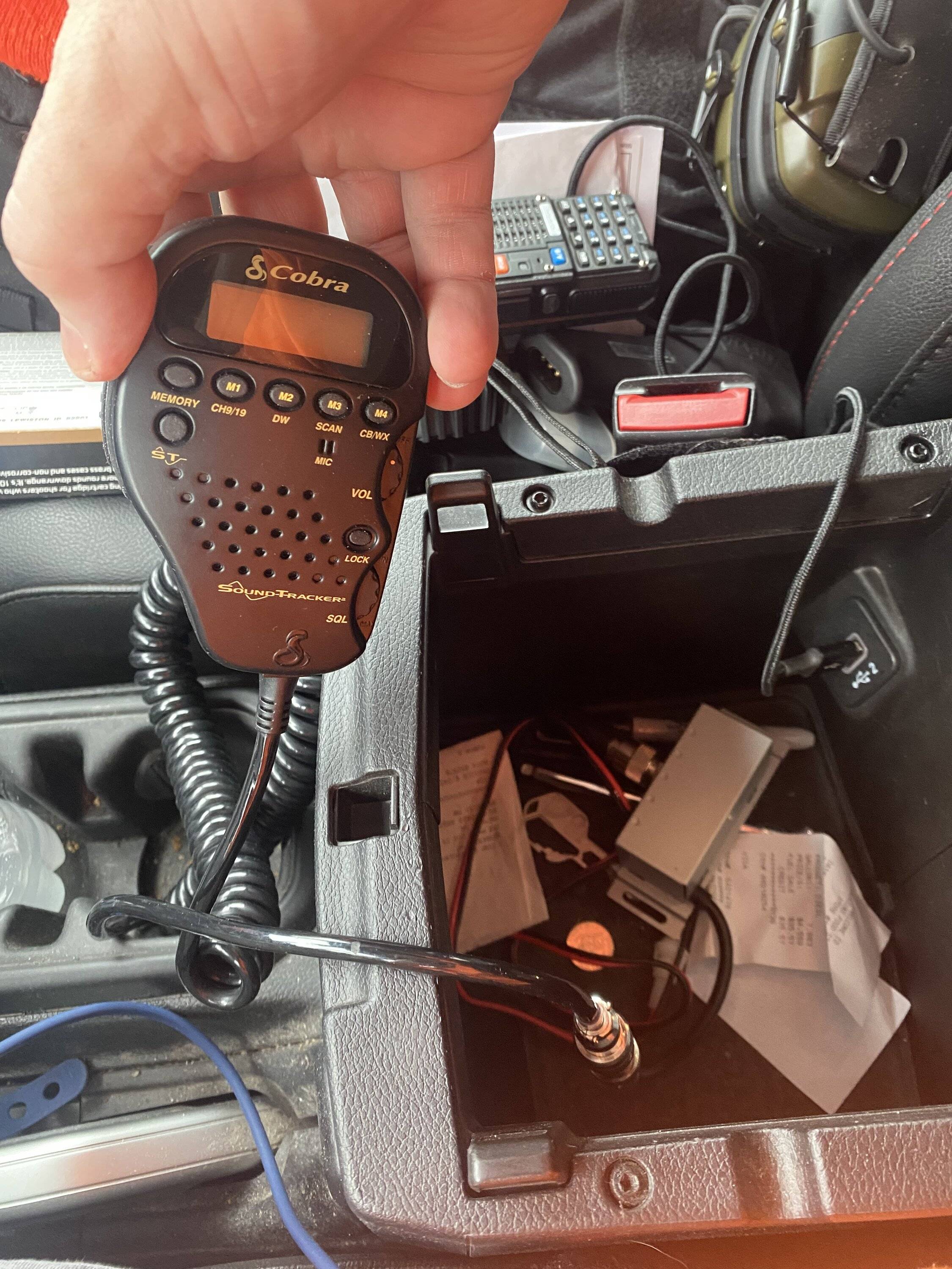

I have a Cobra 75. The box just sits in the console and when I’m wheeling I swap out the phone holder for a mic/handheld radio mount.
