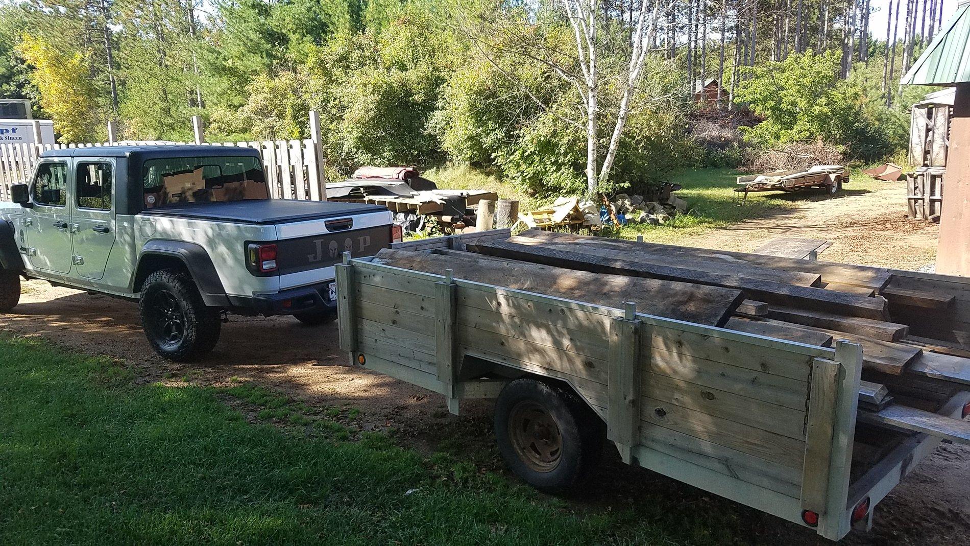

i haven't kept great track of my mileage so I won't fill out the form just yet, but what I found very interesting is that I picked up my dad's EMPTY 6x10 trailer and hauled it 5 miles to my house going about 75mph I got 12.3mpg. I then drove it about 20 miles to pick up a load of wood and was still at like 12.7mpg.
After driving back home 20 miles with it fully loaded 6'x10'x22" with wood, i had 14.5mpg. When it was loaded up i only drove 65-70.
So apparently wind/grade and speed has a tremendous impact on the mpg while towing with the truck.
Jeep Gladiator MPG and range 20190914_100429

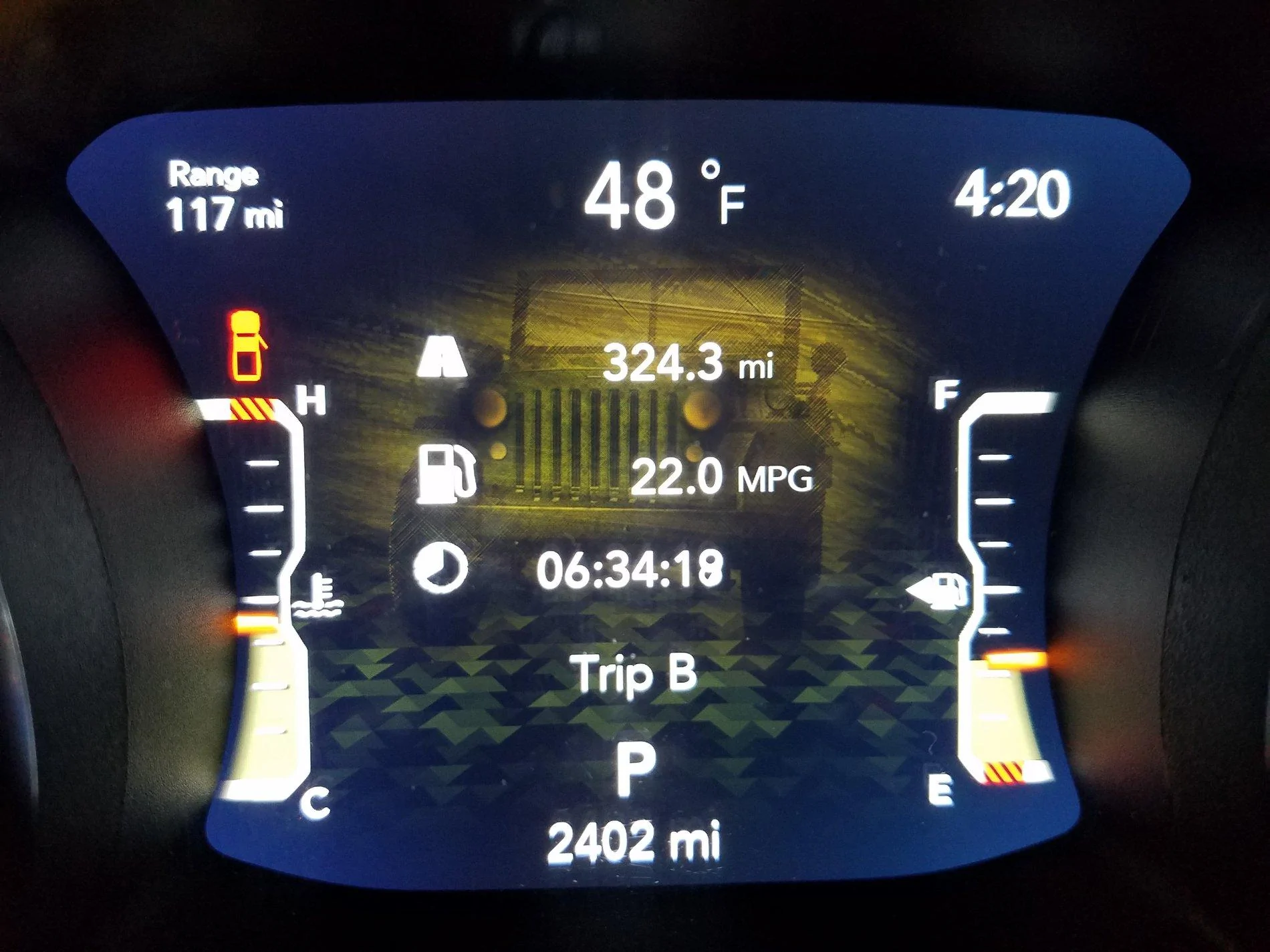

Jeep year & trim: Rubicon LE
Mileage: 2400
Engine: 3.6 pentastar
Fuel type: 87 octane
Lift: stock
Tire size and model: 315/70R17 BFG KO2 (35" load range "C")
Diff gearing: 4.10
Tuned?: no
Other add-ons: Tazer mini
Tire PSI: (36
Jeep Gladiator MPG and range 20190929_162047
Speedometer recalibrated? yes
EVIC or hand calculated?: EVIC
Trip conditions: Flat, hilly mountains, 300ft to 3800ft speed 55-70 mph
Average MPG: 22
Anything else of interest. Tonneau cover closed
