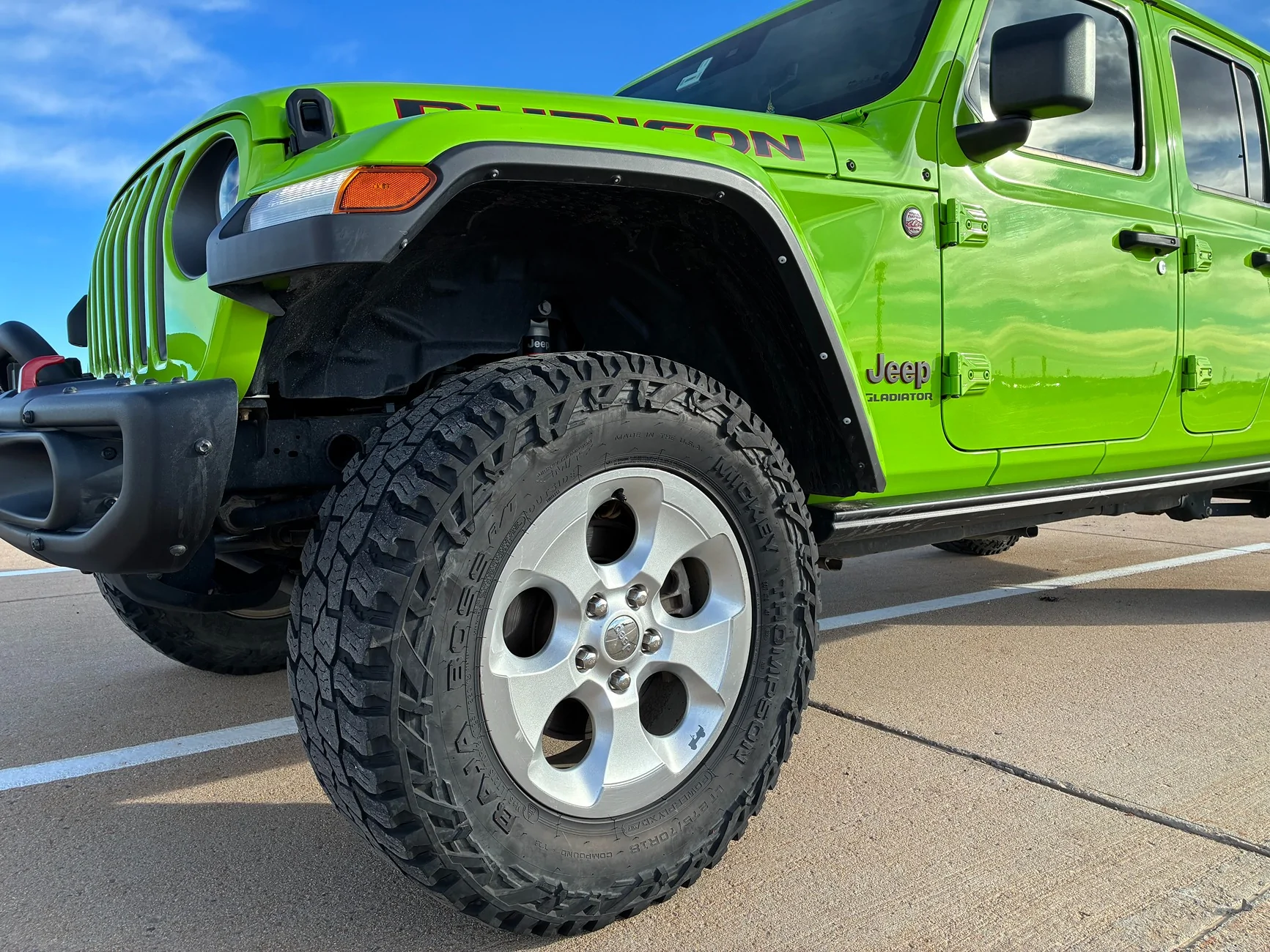

The Baja Boss A/T typically runs 8 to 11 lbs heavier than most of its competitors. I've been running a 33" set of these tires for the past 6 years and I've loved them, particularly their excellent performance in snow. 40,000 of those miles were on my previous 2-door JK and I've put another 9,000 miles on them when I put them on my new JT.
I'm just looking for some honest feedback about the weight of tires and mpg. I'm looking at some other A/T's that are again 8 to 11 lbs lighter and that's the main reason why I'm considering ditching the Baja Boss A/T's when I bump up to 35" tires here soon (even though I have really enjoyed them). Has the additional weight really been that big of difference in MPG over time when the truck is your daily driver? Are you really paying for it that much at the gas pump and has it been worth it to you?

I notice a dent in your door next to lower hinge is that on both sides do you know why it is like that my sport s is the same I see it on a lot of gladiators
