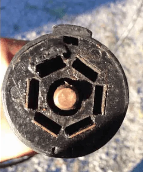

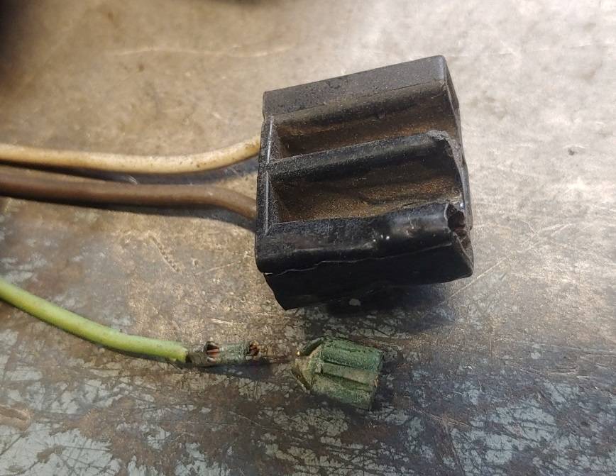

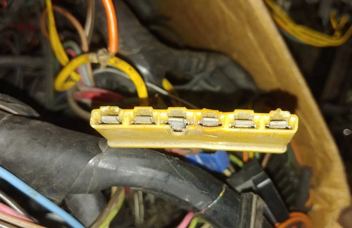

It's easy before the fire - you can see the results of poor connections, dirty connections, high voltage drop across a connection (and a fuse won't necessarily help this). I didn't have to dig at all in my stash of wiring harness issue pictures from stuff I've worked to fix over the years.
Jeep Gladiator My 2022 Gladiator burned down... how? 20220518_102616
This one "looks" ok. You can't always tell by looking at the connection. If in doubt, loosen, clean, tighten.
Jeep Gladiator My 2022 Gladiator burned down... how? 20220518_144348
Jeep Gladiator My 2022 Gladiator burned down... how? trailer4
