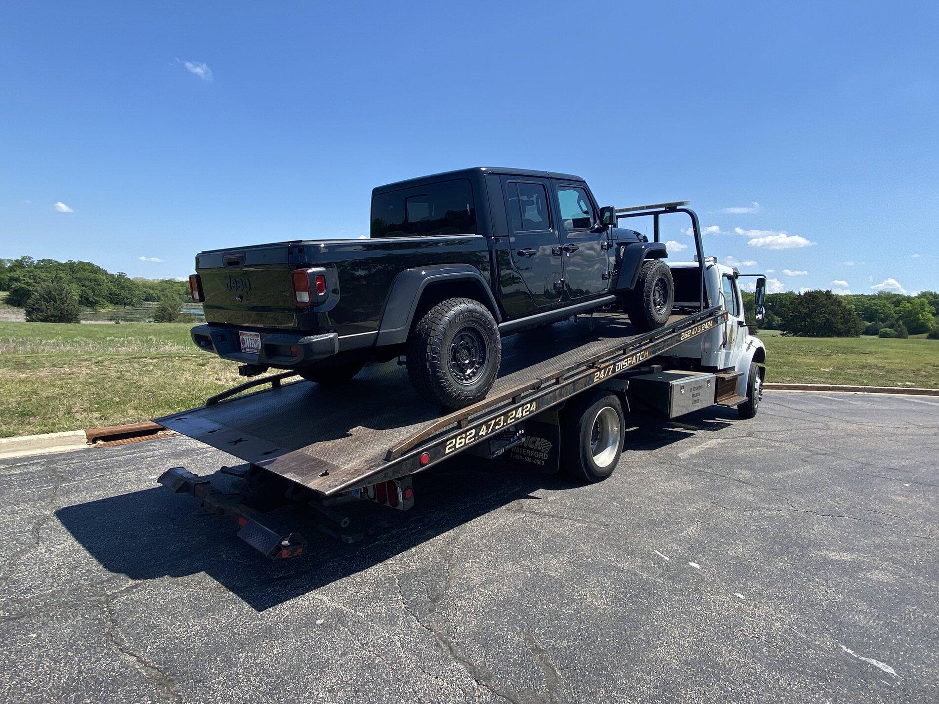

2021 Gladiator Sport S, 3.6 with auto transmission, 9700 miles. No mods other than new tires. Driving along on a cruise with my wife today when all of a sudden the screen starts going crazy! Luckily I was on back roads because I also lost steering control, it was shifting funny or not shifting at all, the wipers were going on their own, everything was nuts. Shut down it down and restarted it a few times, but it was still crazy. I tried manual shifting, still bonkers. All I could do was limp to a place I could safely park, I unhooked the battery and re-hooked it up to see if things would re-set. Unhooking the battery at least got it to drive normal but with a “Service Transmission” warning and check engine light. I'm so upset right now. I'm hoping my dealer can tow it in and find out what’s wrong. ?

Jeep went away to the dealer today. God help anyone that actually needs to use Mopar Roadside Assistance in a real emergency. Took them seven hours total to move my truck 30 miles.
