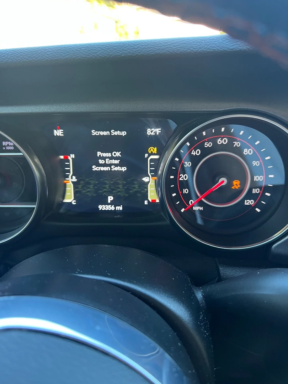

Post a pic of the lights you're getting, there's plenty of them and they can lead to different things, especially with a Tazer. Could be battery related, could be Tazer related. Post pics

Problem is getting to the AUX battery to test is not easy
Jeep Gladiator Having an issue with my Gladiator Mojave today IMG_1762

But not using the tazer. It Is the Z automotive rear differential bypass component. The Z locker. I out in 2 years ago.
also… the two lights you see in that pic went out next time I started the vehicle. B
