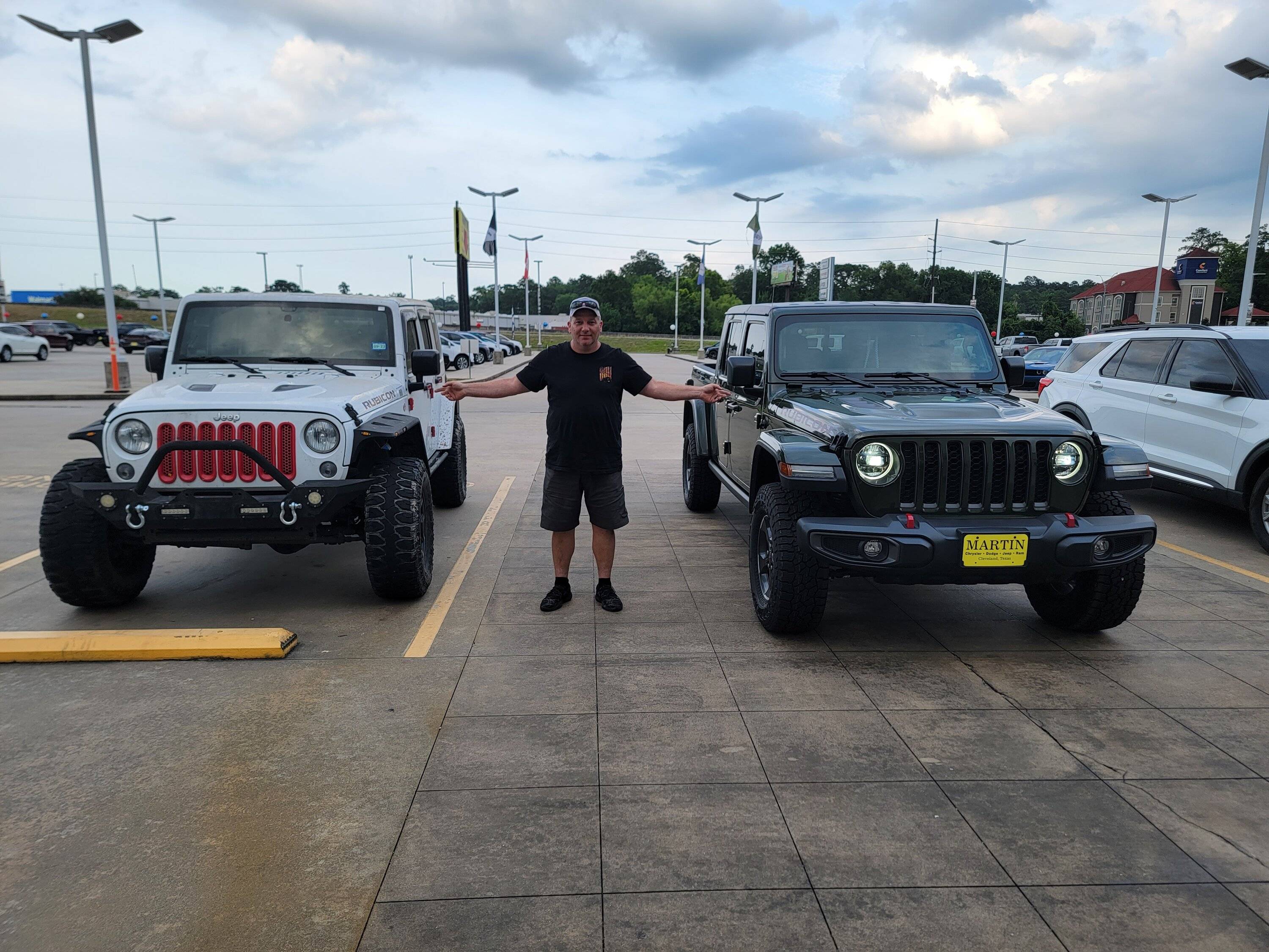

Greetings fellow Gladiators,
The warranty on my 2020 Gladiator Sport expired 7/14 and I thought I'd share my views on the vehicle. I love it. So far it's been a very dependable vehicle.
I went to Jeep.com the first week in July of 2020 and built myself a Sport and the 15th, I took possession. I didn't need all the bells and whistles. I checked off 13 options and found a Jeep with 11 of the 13. The only options I didn't get were the better speaker system and the spray-in bedliner. It is a no power windows or lock truck. It has the 5 inch radio. The upgrades were bolt-on. Gladiator rock rails, shorty antenna, air deflector, Rough Ridge soft folding top, Dee Zee rubber box liner and Dee Zee tail gate cover. The wheels are off my 2016 Wrangler. Just put new Coopers on it and wanted the wheels to put on the Gladiator because it came with black stamped steel wheels.
The time ran out before the mileage. I currently have 18k and some change on the clock. Had one recall, a misfire download, and one warranty claim, the back window leaking. Other than that, the truck has been flawless. Longest trip was to KC and I got 25 mpg. Suspension is stock and I scored 1 duck. Oil change is the only maintenance I've had to perform on it.
Summing up, I scored a nice truck that I plan on driving for many years to come. Keep on Jeepin'. :jk: :rock:
Date stamp on my camera wasn't set. :LOL:

2015 Hard Rock fully loaded... bought a year old with 36k on it. Installed after market steel bumper and winch boosted 1.5 inches. Ran 35s on stock wheels...( i liked the stock wheels)
No issues until...
At 180k the passenger side valve issues began and then broke something in there. Cant really complain.... thats alot of miles of hard driving and a 200 mile a day commute... yes 200 not fat fingered Traded for a 23 loaded Gladiator Rubi.
Loved that Hard Rock and paid 12k under blue book... Nissan dealership didnt know what a Hard Rock was hahaha. Wanted the Gladiator since it came out but had to wait.... worth waiting for
Jeep Gladiator My Views on my Gladiator as its Warranty Expires 20230623_191055
