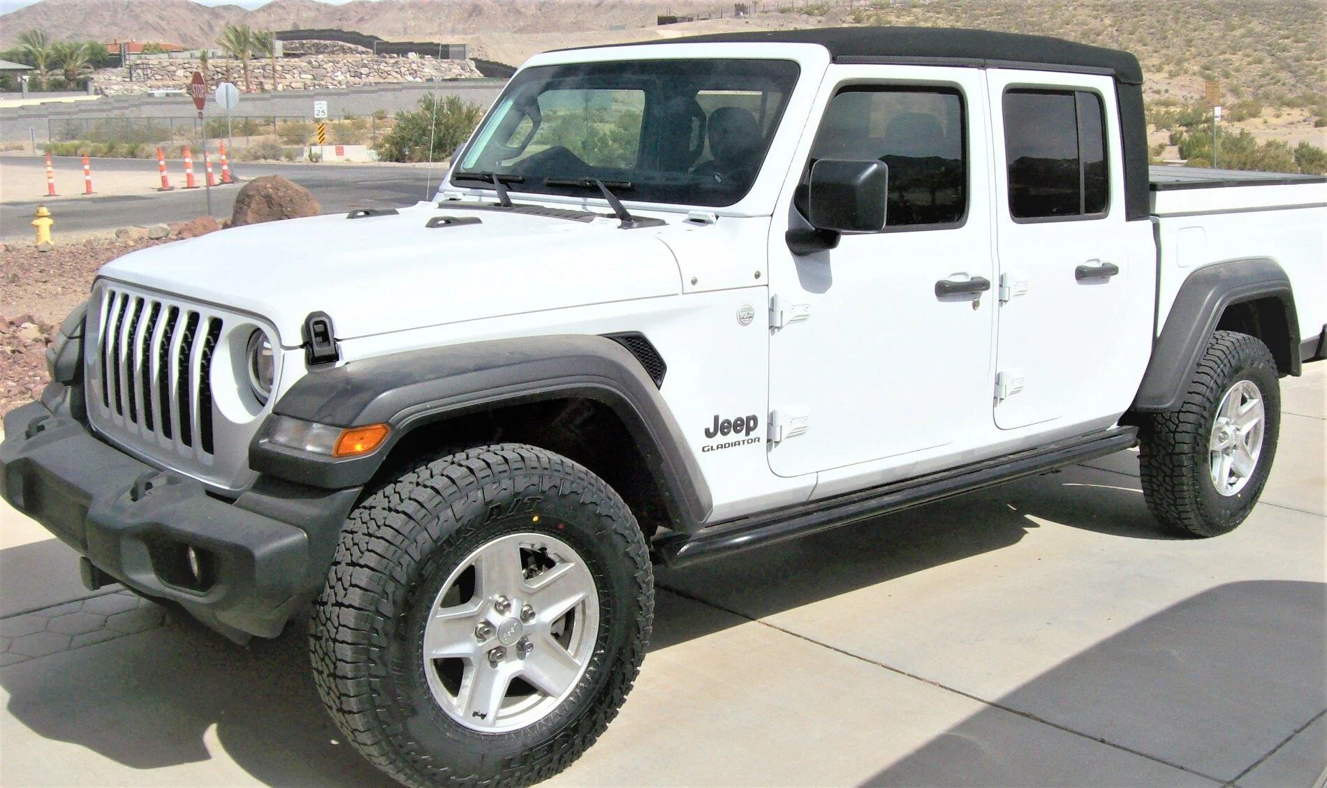

Looks good but 12.5" tires are too wide for the stock 7.5" wide rims.

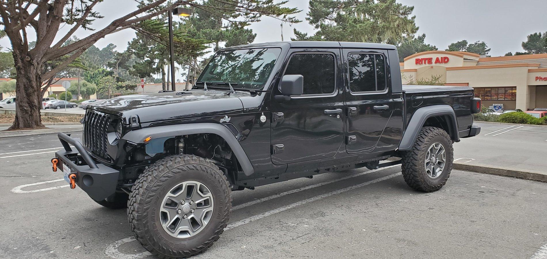

Would this thread apply to Sport S with the regular tow and a manual transmission? Not sure how different the maw tow is verse the regular tow
I have a Sport S with tow package (not max tow) but an auto. The transmission shouldn't matter. I'm running 285/75/17 Yokohama geolander M/Ts with no issues. I do have take off rubicon suspension but no spacers or lift.

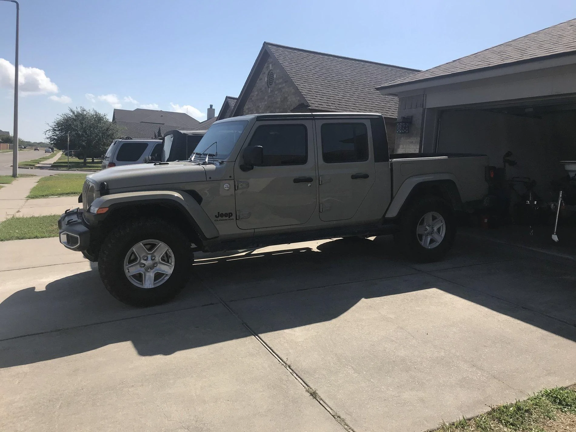

Looks great with the leveling kit, where is your antenna?
I do not listen to terrestrial radio (am/FM). I listen to only satellite radio, podcasts and audio books. The car wash I used on a daily basis would whip the antenna into the truck so I put it permanently behind the back seat.

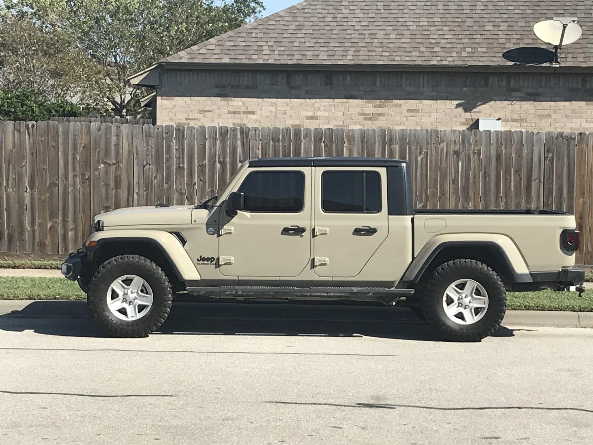

This is what I ended up with. 285/75 R17

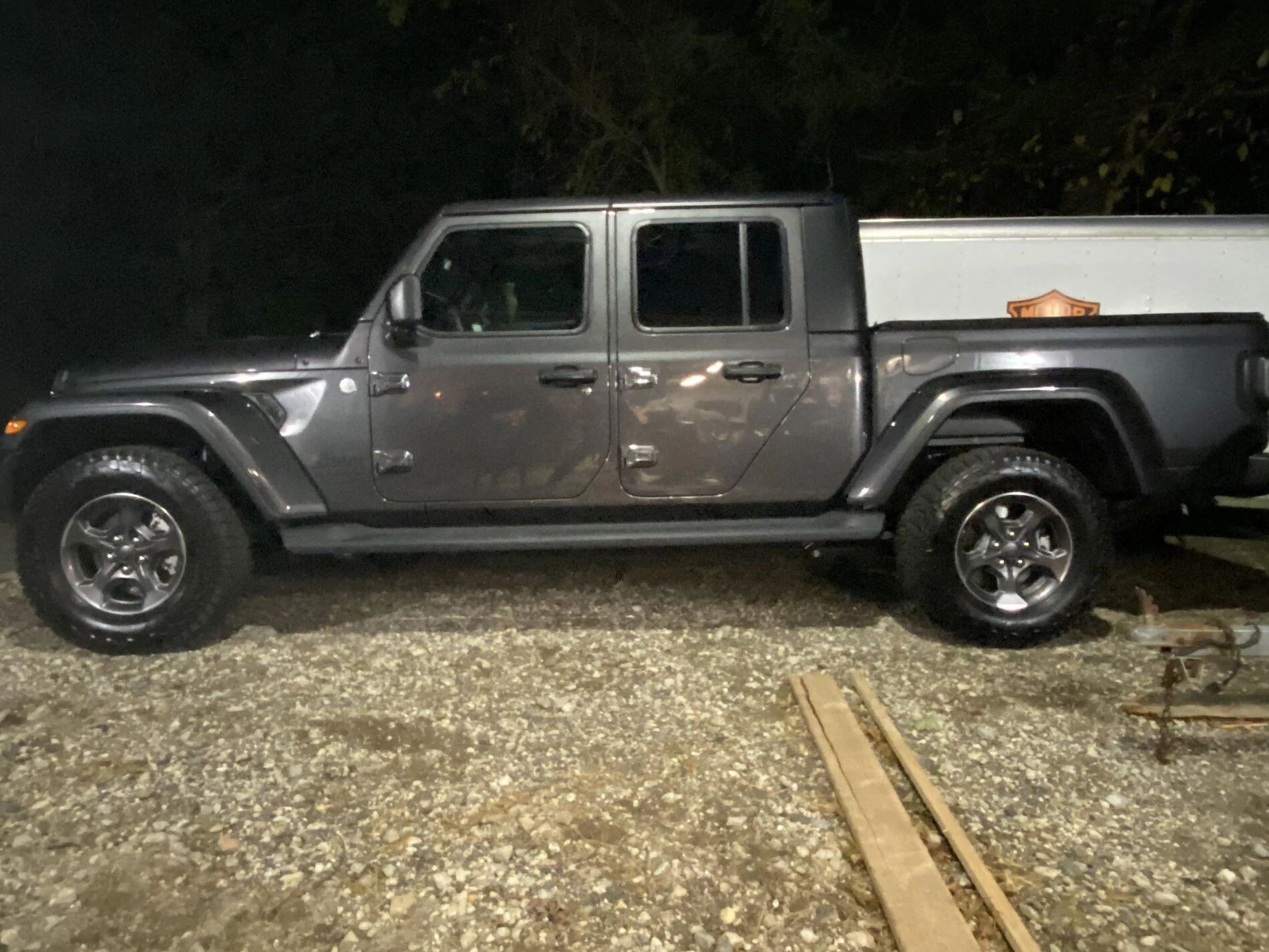

The only drawback with stock wheels is when adding wider tires. I have a Sport S and just didn't like the looks of the stock rims so changed them out for some quadratec Baja rims and 255-80/17 tires. Gas mileage dropped a bit with the heavier/taller tires but no more than .5 mpg. The Falkens are really nice tires

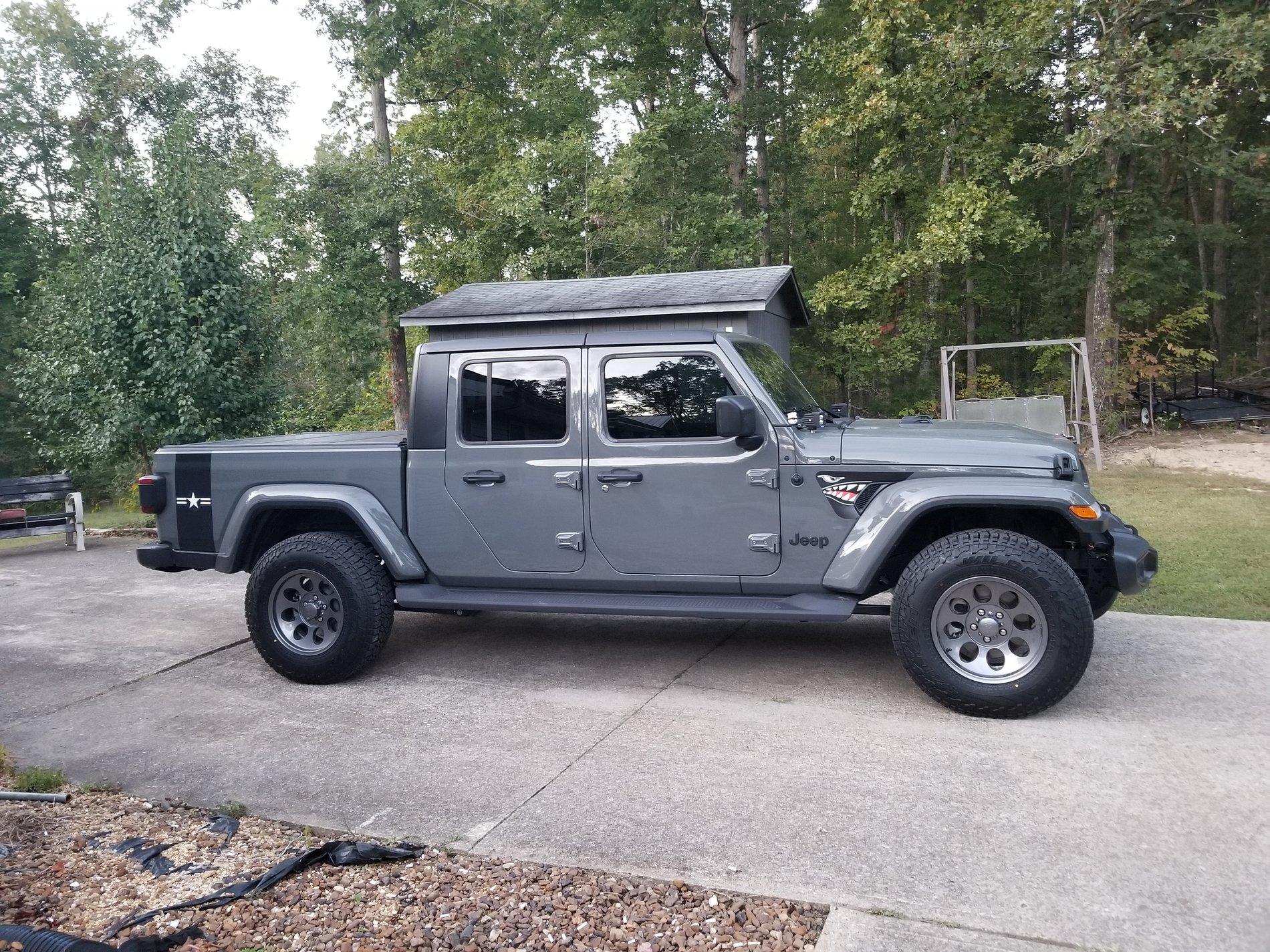

My 255-80-17 Falkens are stock width, just taller (33.1 vs. 31.5") and work fine on stock Sport S max tow wheels.
Got the same size based off another post of yours...thank you!

Glad my post helped you. I did not notice any change in mpg in mostly highway driving with the Falkens vs. stock tires. I have 4.10 gears, if that might matter.
