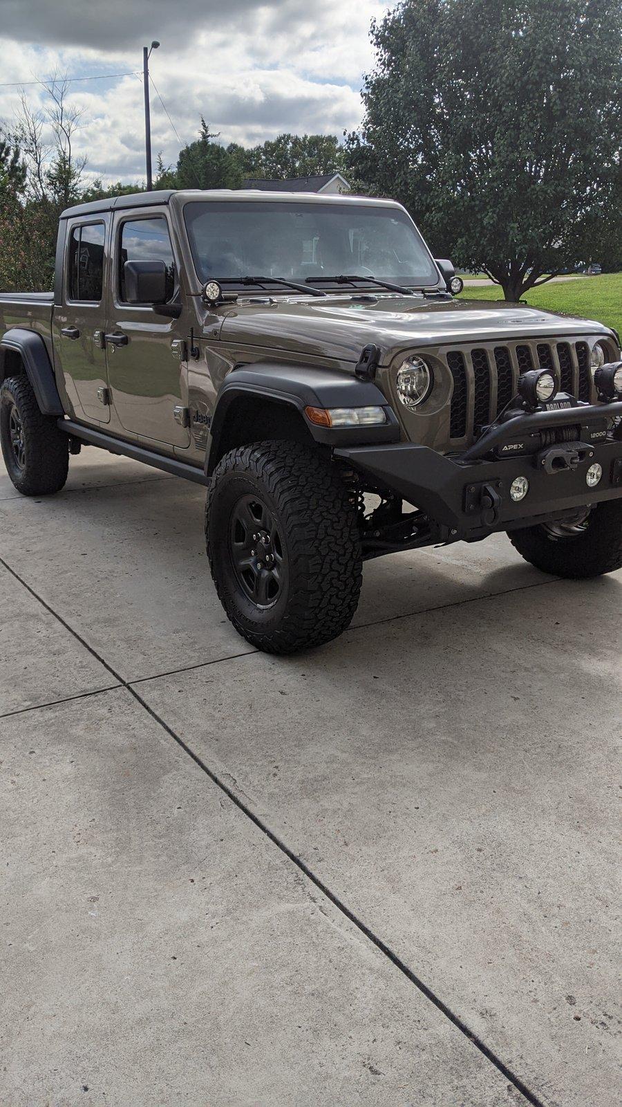

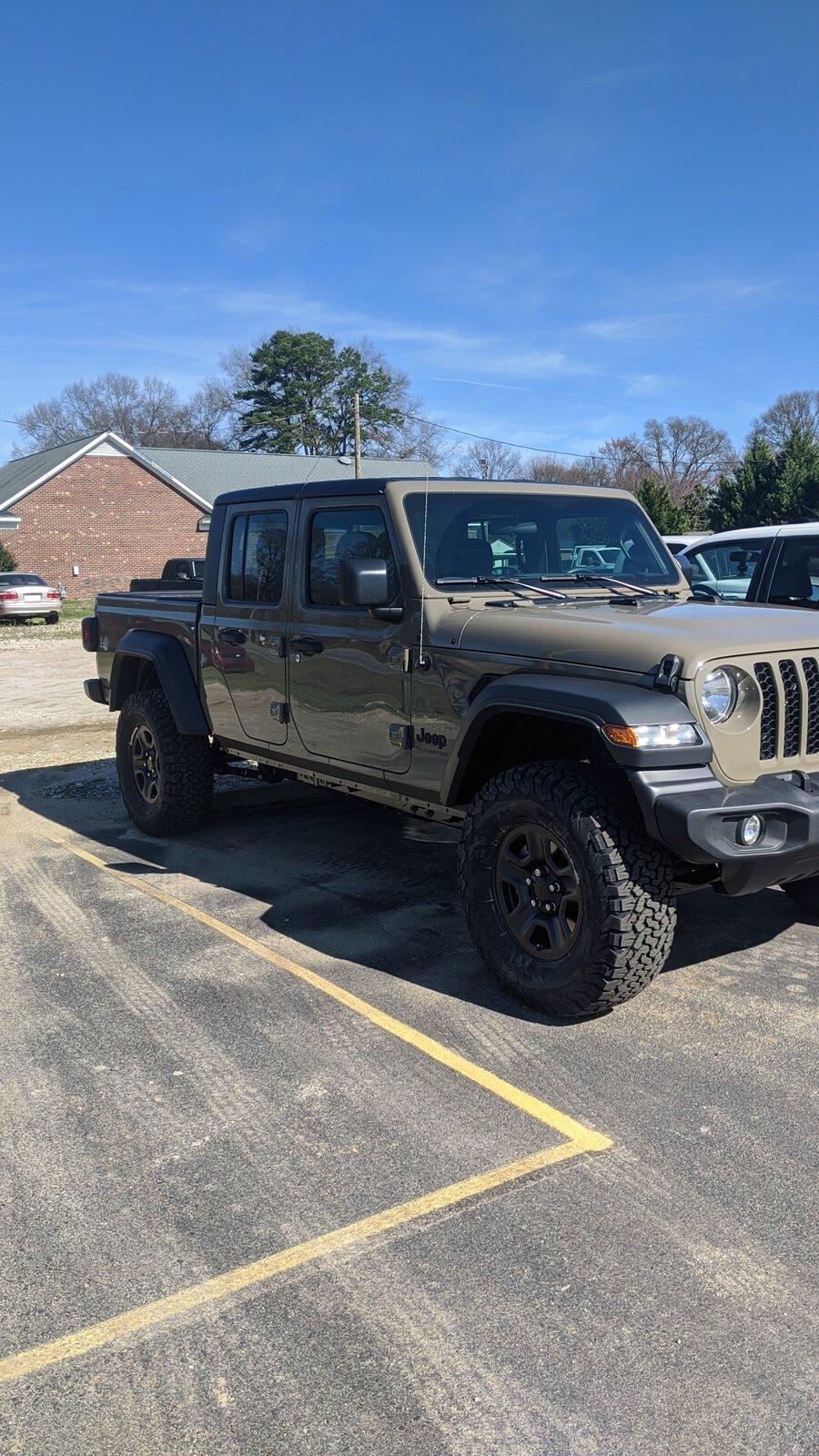

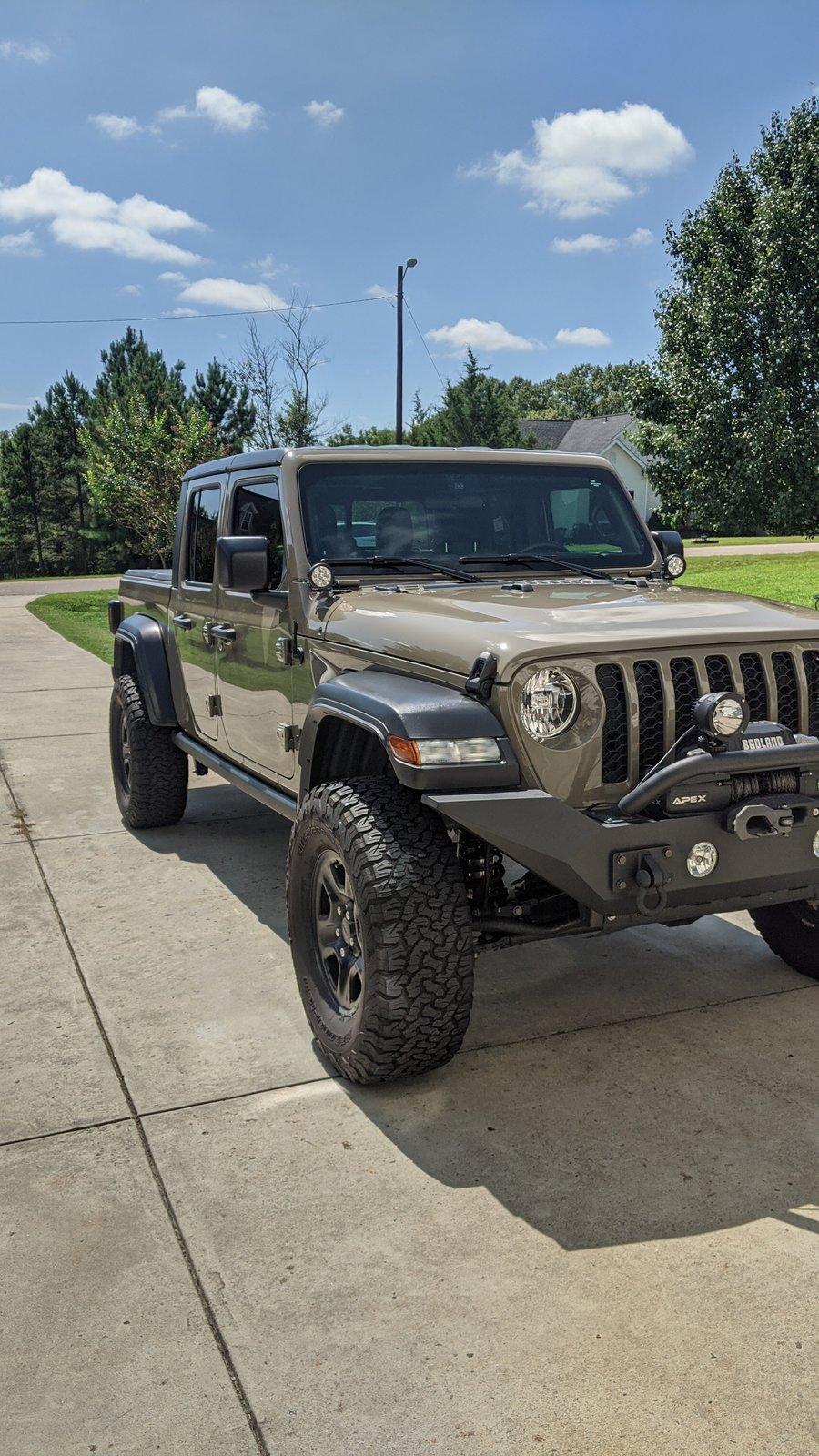

In that picture it's lifted with the 2.5" SST ReadyLift and Rubicon front springs on a sport Max Tow. Sport or Sport S doesn't matter as long as it's a Max Tow or Rubicon it has the wider axles and you want hit the bottom control arm at full lock with 35's or at least with KO2 35's. I'm running my stock steel wheels with 1.75" wheel spacers, but the wheel spacers are not required, I just wanted a wider stance. Before this I ran it stock in the 315's for 2 days. You have to trim around the air dam on the very bottom or remove it to prevent rubbing on 35's.
Here are pictures of mine sitting stock on the 315 70 17 KO2S, no rubbing at full lock after I trimmed a small section on the back of the air dam
Jeep Gladiator Need advice - Best "upgraded" tire size on stock Sport S rims? IMG_20200213_183207
Jeep Gladiator Need advice - Best "upgraded" tire size on stock Sport S rims? IMG_20200213_183153
WithThe lift added
Jeep Gladiator Need advice - Best "upgraded" tire size on stock Sport S rims? MVIMG_20200215_113302

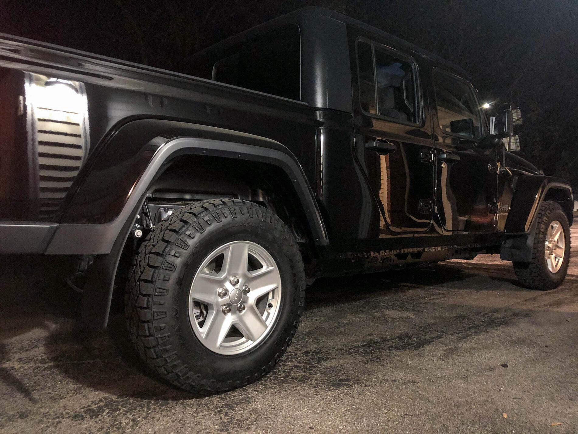

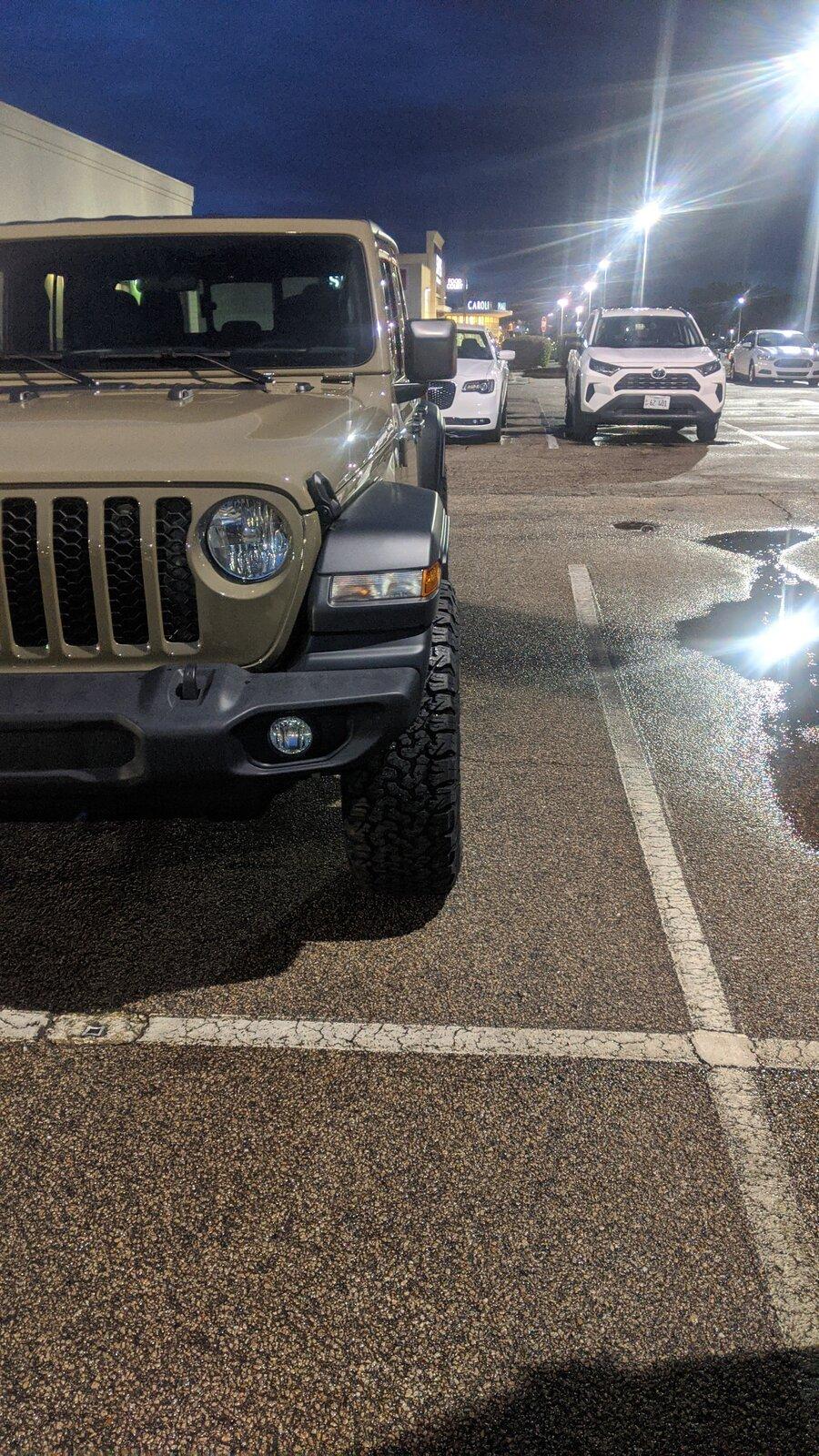

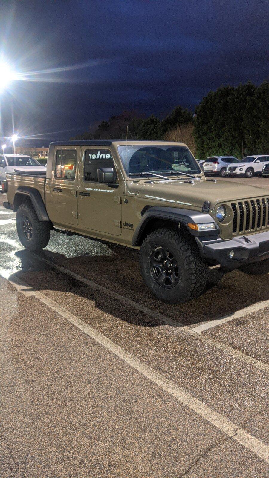

New to the forum and pulled the trigger on 285/70/17 Ridge Grapplers today based on reading some of the other threads here (thanks everyone!). Sport, no max tow, no lift. No rubbing and no noticeable increase in noise so far though haven't been driving at higher speeds yet. Next project will be to take a dremel to the bumper closeout panels, gas mileage be damned.

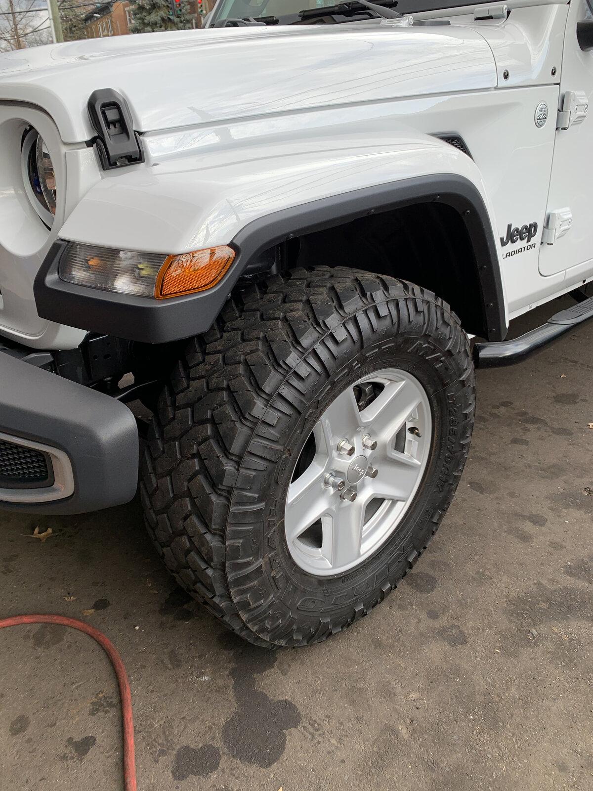

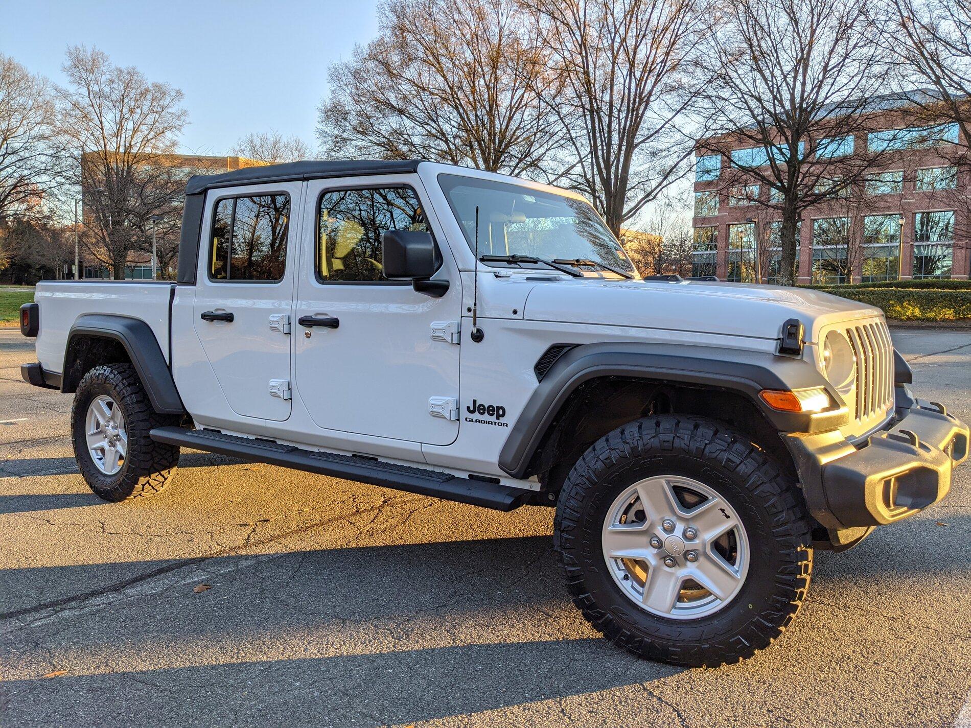

Sport S Max Tow. Tires are Firestone MT2 in 285/70r17. Load range E, I run about 33 PSI with good results. Love the tires and barely any change in performance from stock.

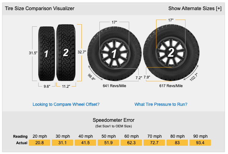

That reminds me I totally forgot to ask my shop if they recalibrated the speedometer [palm to face]. However, going from stock to 285/70/17 isn't much of a difference in speed per below. I imagine it's much more significant going from 31" to 35" or 37".
