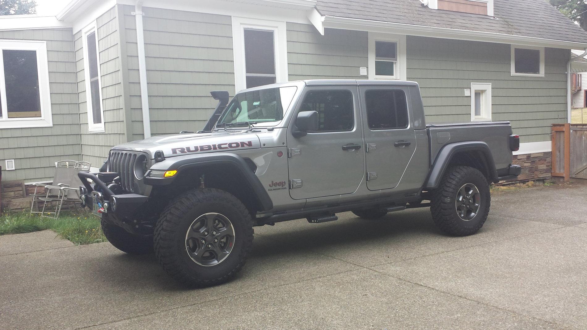

No side pic at the moment, will get one today.
Got a side pic.
Damn, that’s perfect. My kit was supposed to show up today but Brown let me Down so they will be here tomorrow

I installed the 1.5 daystar in the front only.....and it looks to sit perfectly level and I measured from the bottom of the fender.....and it was dead even front and rear....I think the rear is to keep the factory rake as some mentioned. I may have measured wrong but it looks good to me....I may add the rear later when I plan to tow more
