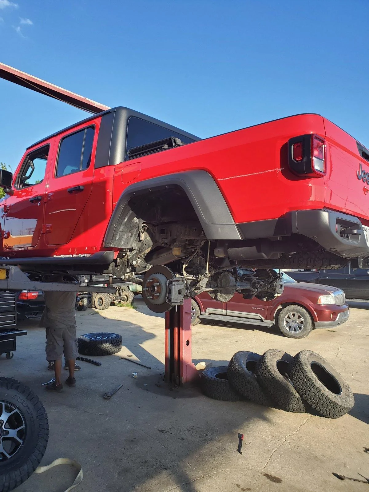

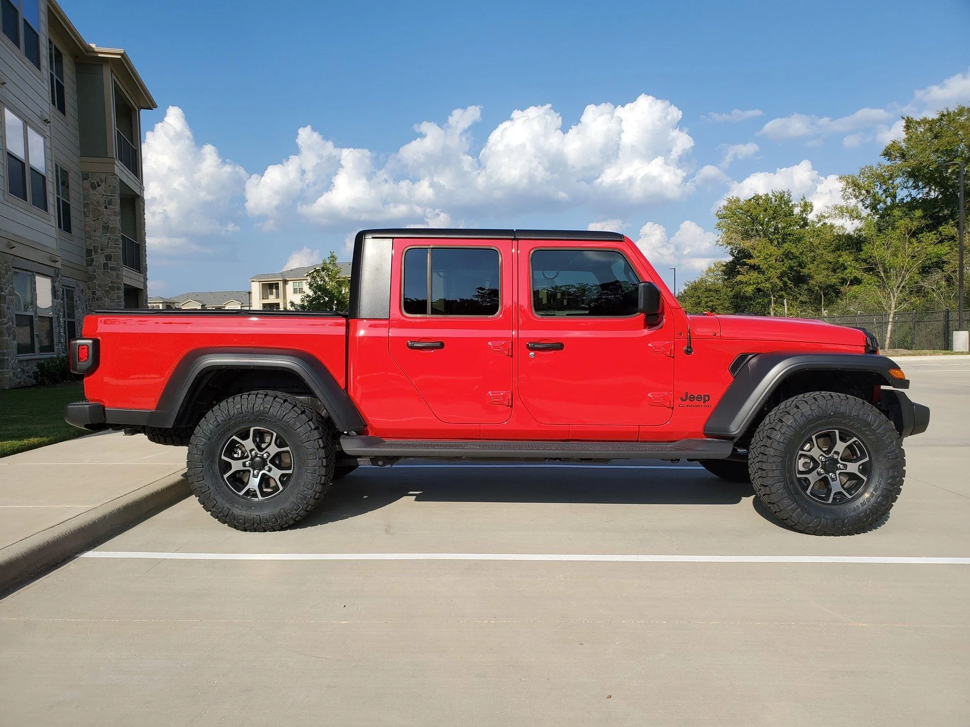

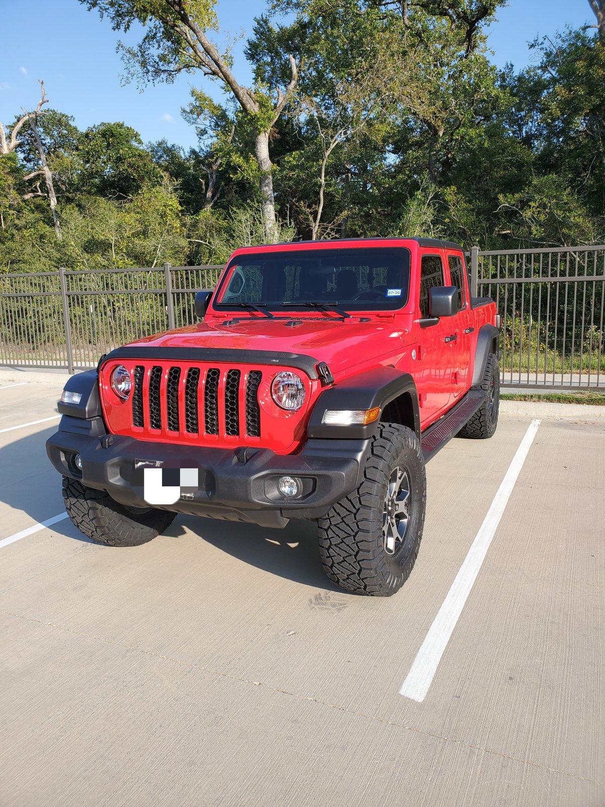

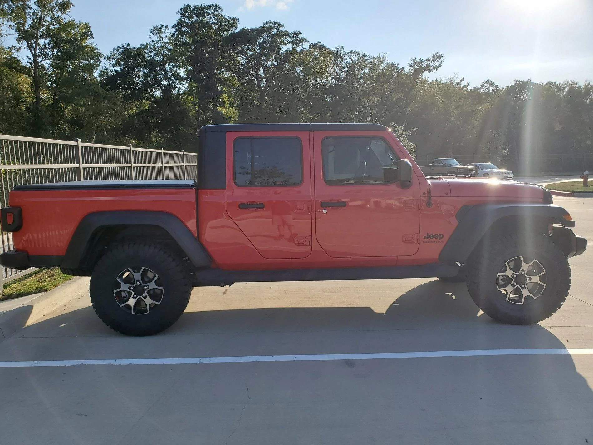

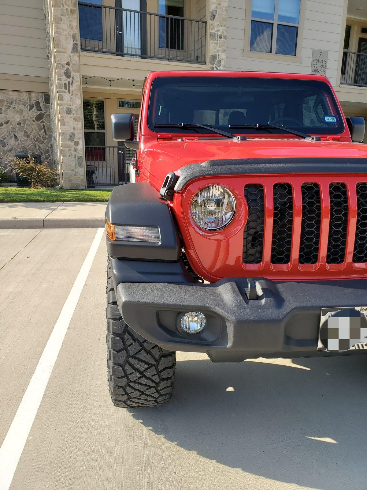

All done! I love it! There hasn't actually been any rubbing. Mechanic said he thought he "felt" it but may have just been the more aggressive treads on the ridge grapplers. There's still seems to be a decent amount of space in there and I don't see or feel any rubbing even at full articulation. Will keep an eye on it!
