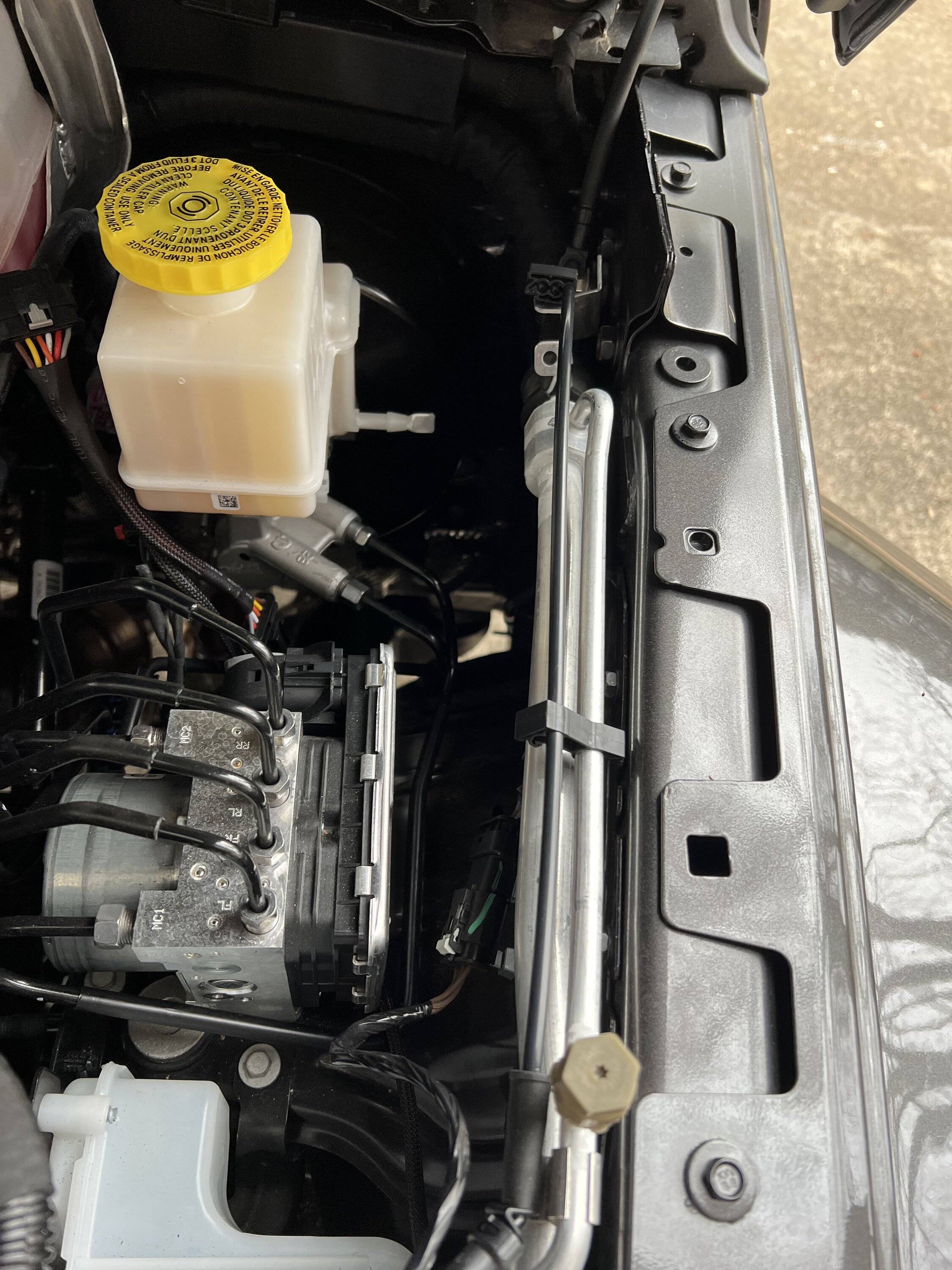

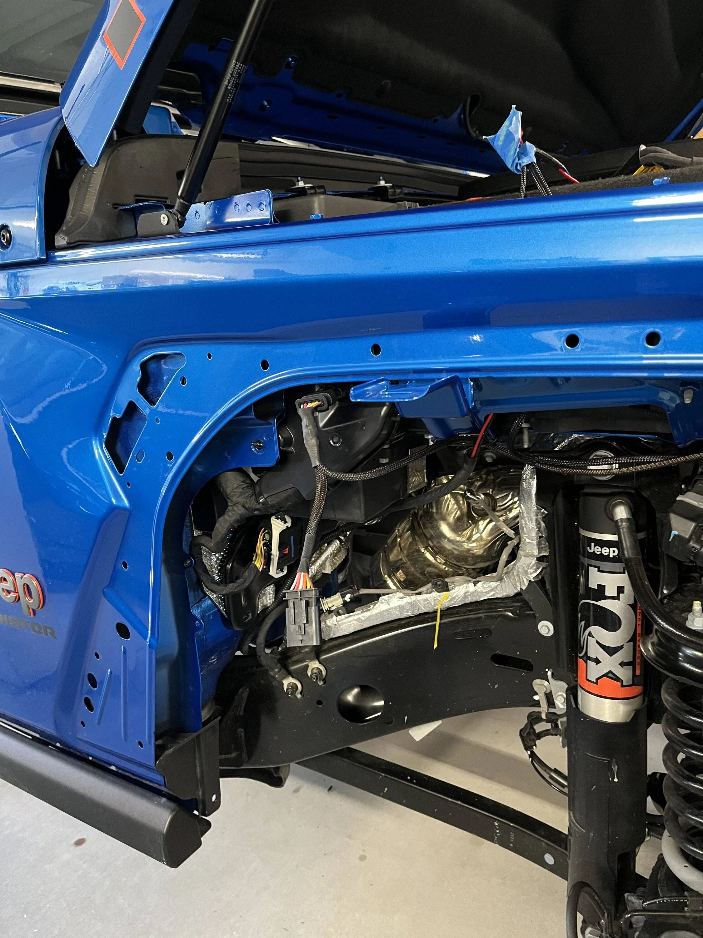

Mine came in this week and I’m trying to install today. I’m not seeing a fuse panel on the driver side to remove? I found the harness clipped to the fender, but I’ve never had this much trouble disconnecting a wiring harness before. Anyone else run in to this? 22 sport S, so not sure if the fuse box is trim dependent.

Fuse panel is on passenger side, at least for gas engine…

Fuse panel is on the passenger side for diesel as well.
The driver side you just need to unclip the fender light to put the turn signal sires inline with it.

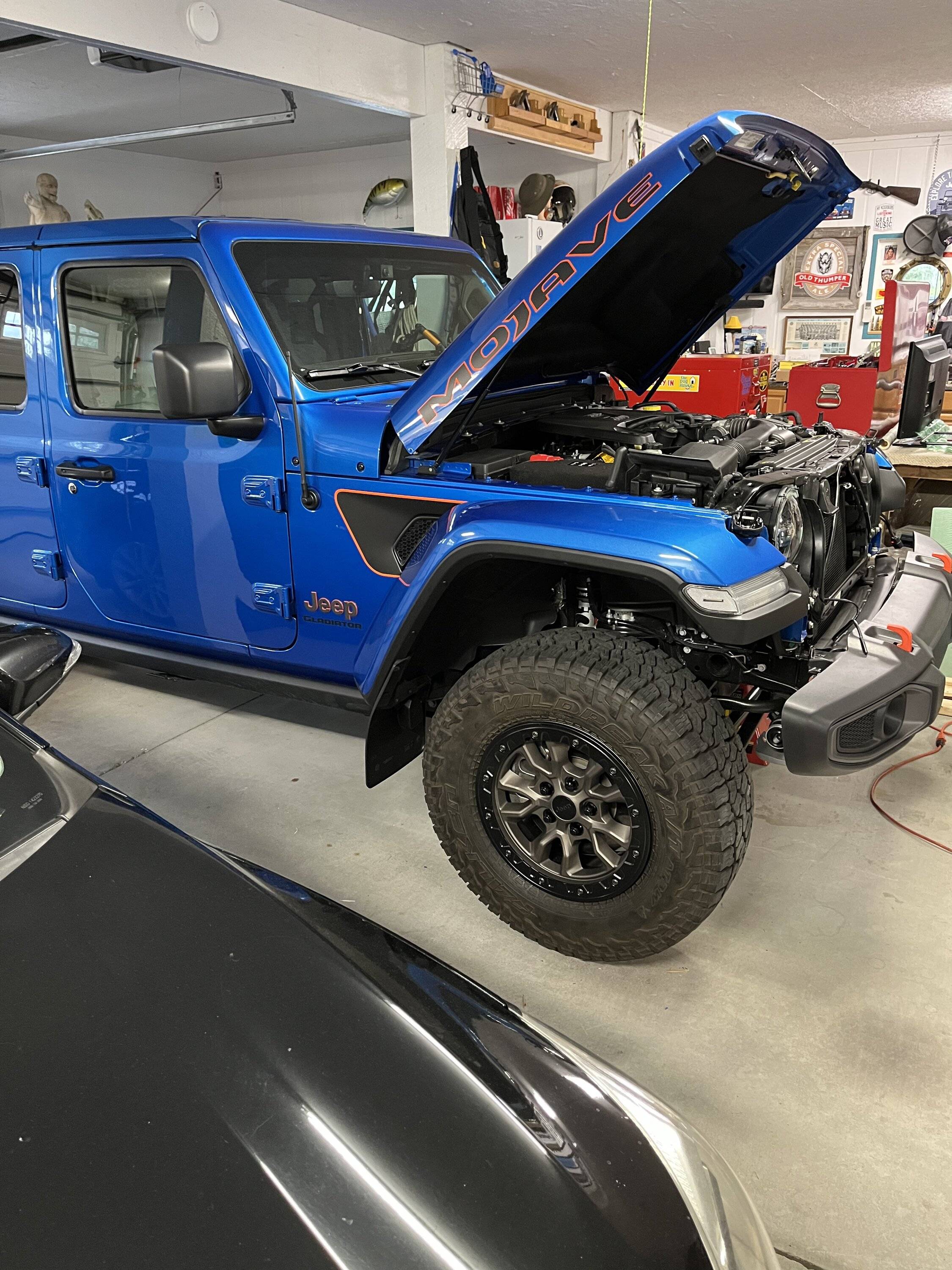

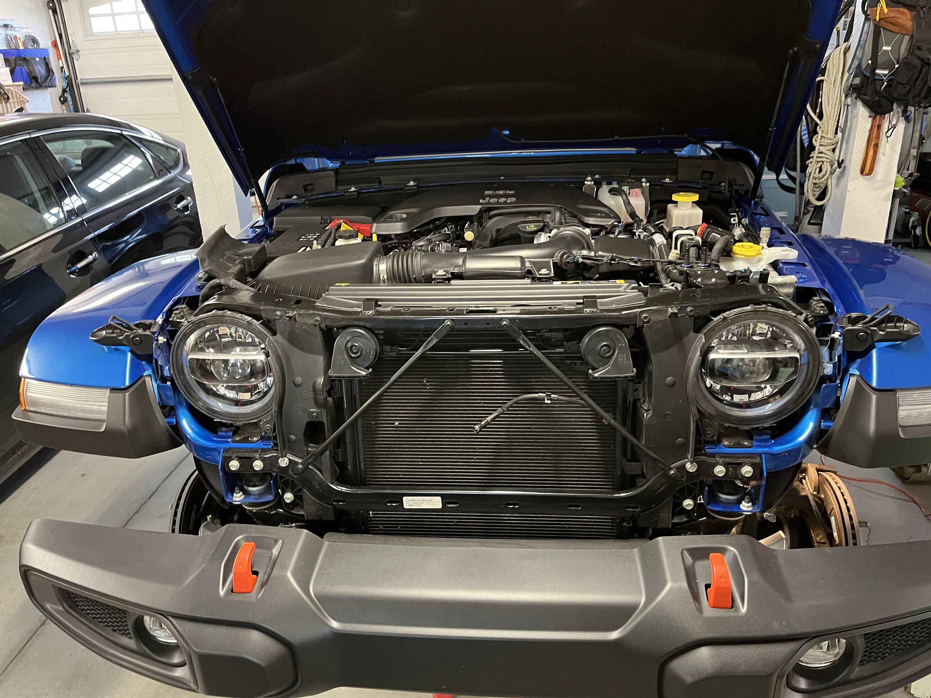

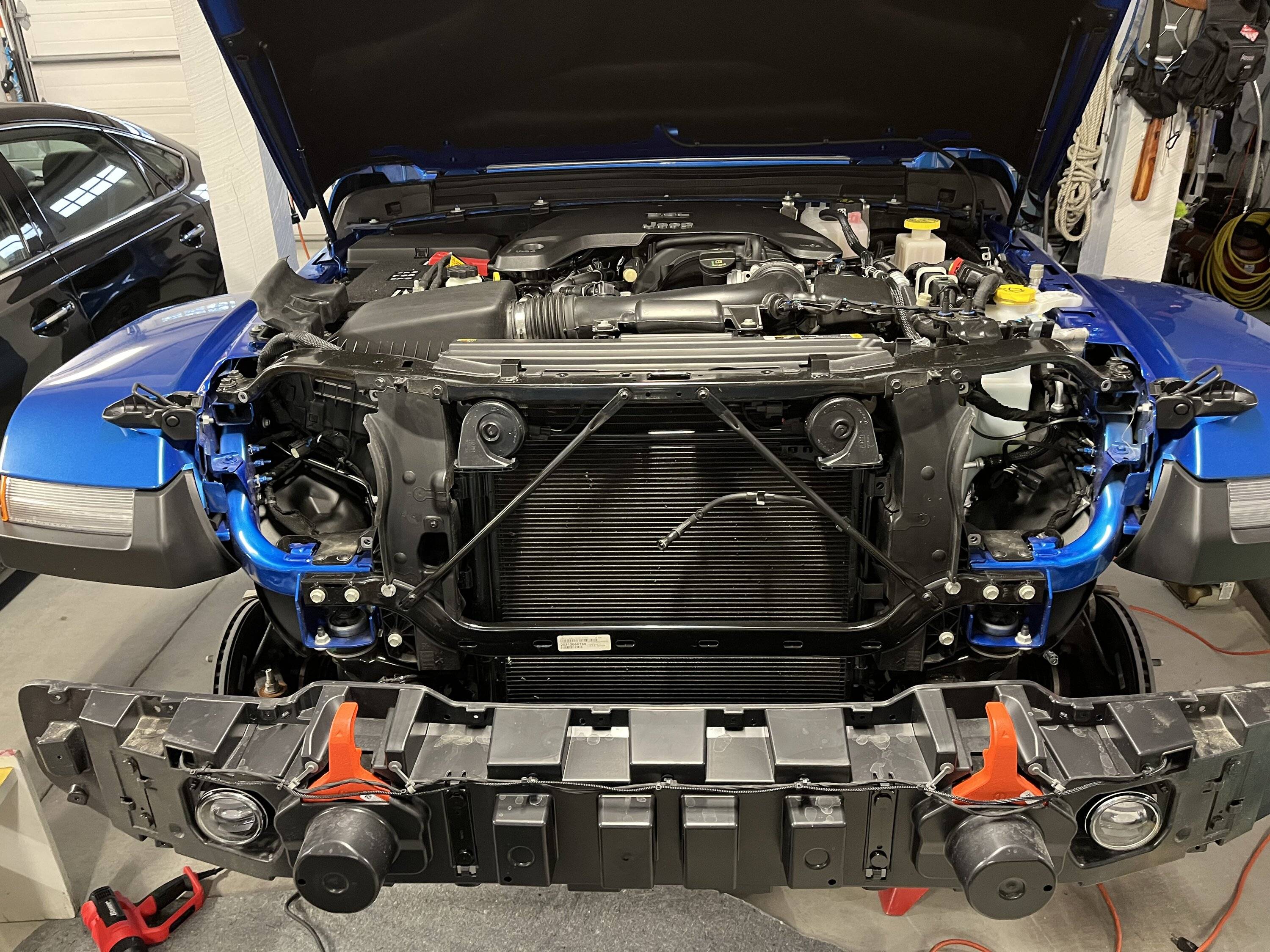

I just finished installing the Elite Max headlights, the Elite fog lights, and the clear side markers from Diode Dynamics. I removed the fender liners to gain access to the connectors that the supplied headlight harness plugs into. Easy with the liners out. The side marker screw and wiring is also easy to get to with the liners out. I also removed the fenders ONLY to install Underground Graphics decals. Fenders don’t need to be removed for the headlight mod - only the liners. I modified the fog light backlight wiring by running the drivers side backlight wire under the bumper cover (bumper cover had to be removed) to join the passenger side backlight wire with a heat shrink buttsplice. The two wires were inserted into one side of the buttsplice and a wire inserted into the other side was routed to one of the Aux switches giving me control of the backlight feature. There is enough wire to accomplish all this as the fog lights come with two sets of wiring harness. You use the set that fits your factory plugs leaving the other set for extra wire.
I wired the offroad headlight feature to another Aux switch.
I haven’t fired up the lights yet to aim the lights. Fogs will be easy. The drivers side headlight adjustment can be done with the fender liner out. The passenger side is another story. Either the airbox will have to be removed or the headlight will have to be removed and reinstalled after adjustment (maybe several times until proper adjustment us achieved).
The DD video instructions had a small panel to remove on the driver side also. Either way, in and working. Had to use JScan to set led to keep them from turning off after a few seconds like others have seen also.
