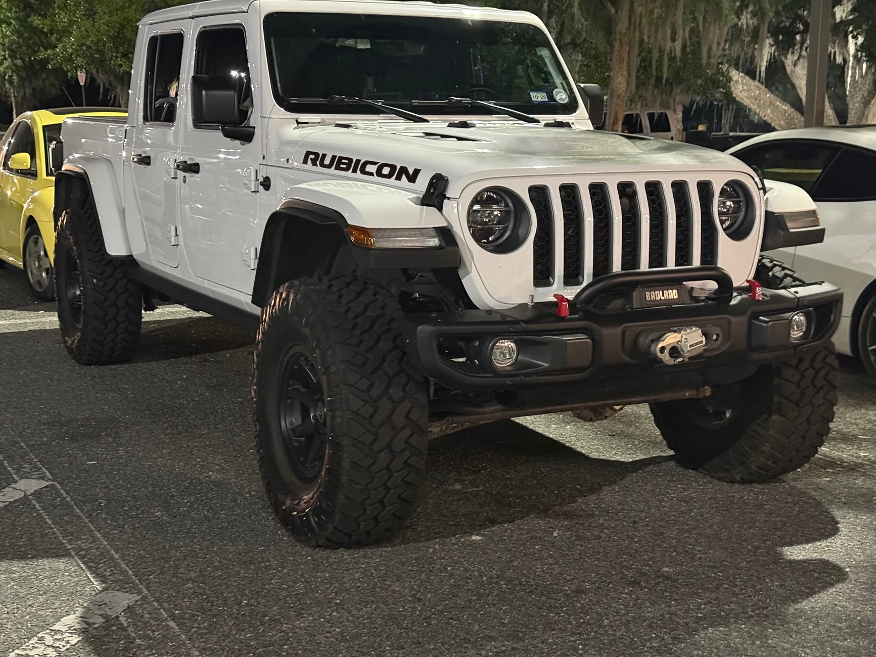

40s ? Looks good
Yes. Ran 37s on the same setup without the gutted fender for a couple years. Worked equally as well.

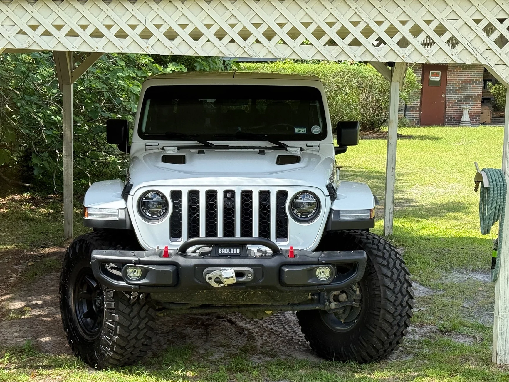

AEV HD diesel coils, plus 3/4" coil spacer in the front. In this configuration with the weight of the winch, rack, rtt, etc, it measures a 4" lift. I run the Fox 5110003 (3.5-4.0) shocks and I think they pair quite nicely. Those shocks fully drooped in the front are right at the limit of the factory front driveshaft.
I also run Core4x4 arms with Johnny Joints and a triangulated Rock Krawler rear which requires making certain aspects of the vehicle... lighter.
I drive it across the country, tackle some pretty hardcore trails, and drive it back no problem.
It's not budget overall but it's pieced together and I did it over time, buying a little here and there. The approach was surprisingly budget.
That's one good looking Jeep 👍

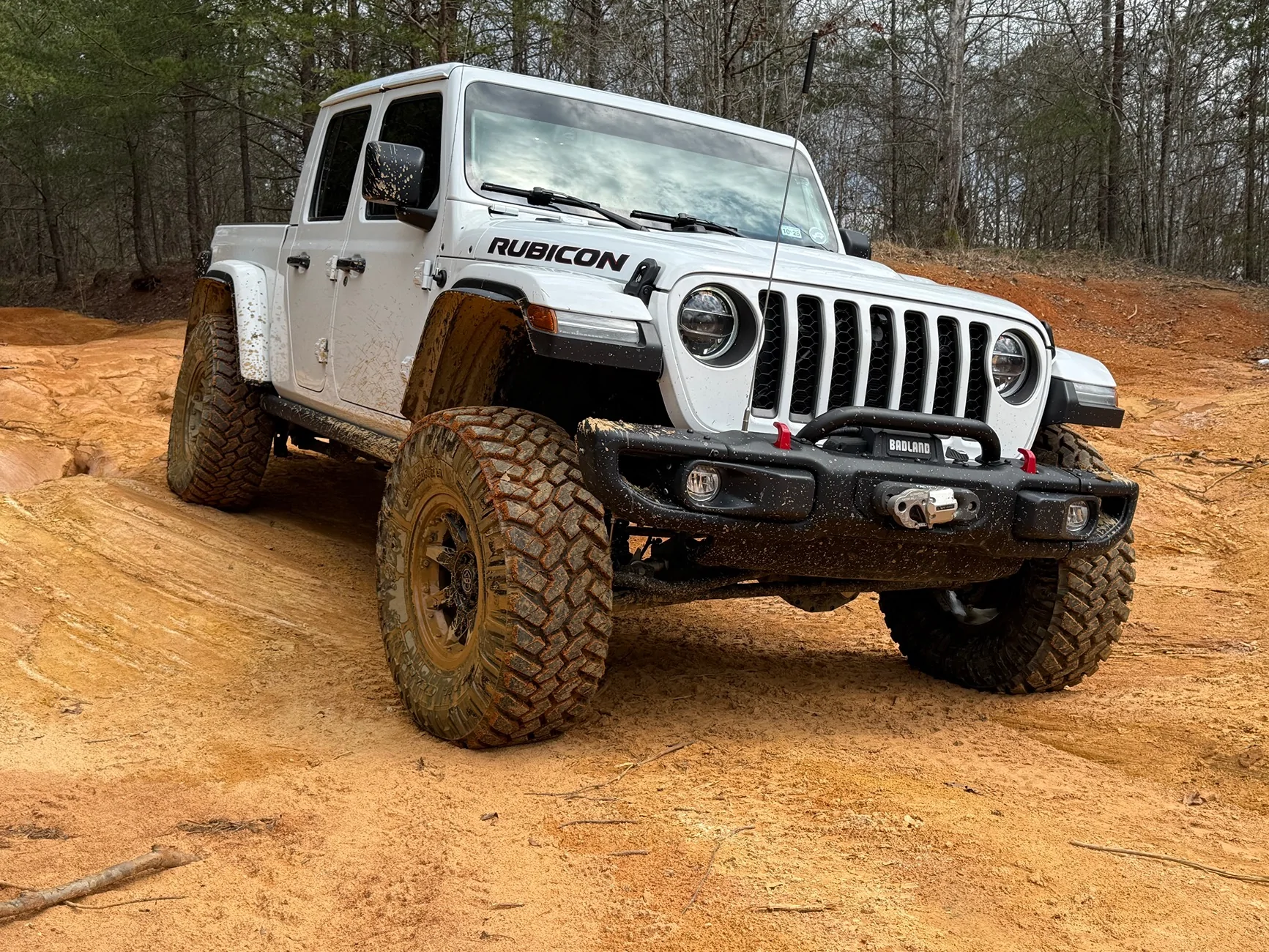

Definitely more of a crawler. The Foxes pair really well with the AEV coils, imo. I've got no complaints. They were only $755 total through Clayton when I bought them. I would think you'd want ones with external reservoirs at a minimum if you're looking for higher speed driving and washboards.
I had considered those 5160s as well but being in the north the steel body scared me away. Rusty shocks are ugly and don't last long. I've heard they ride great but rust quick.
Could just go all out with some Kings!

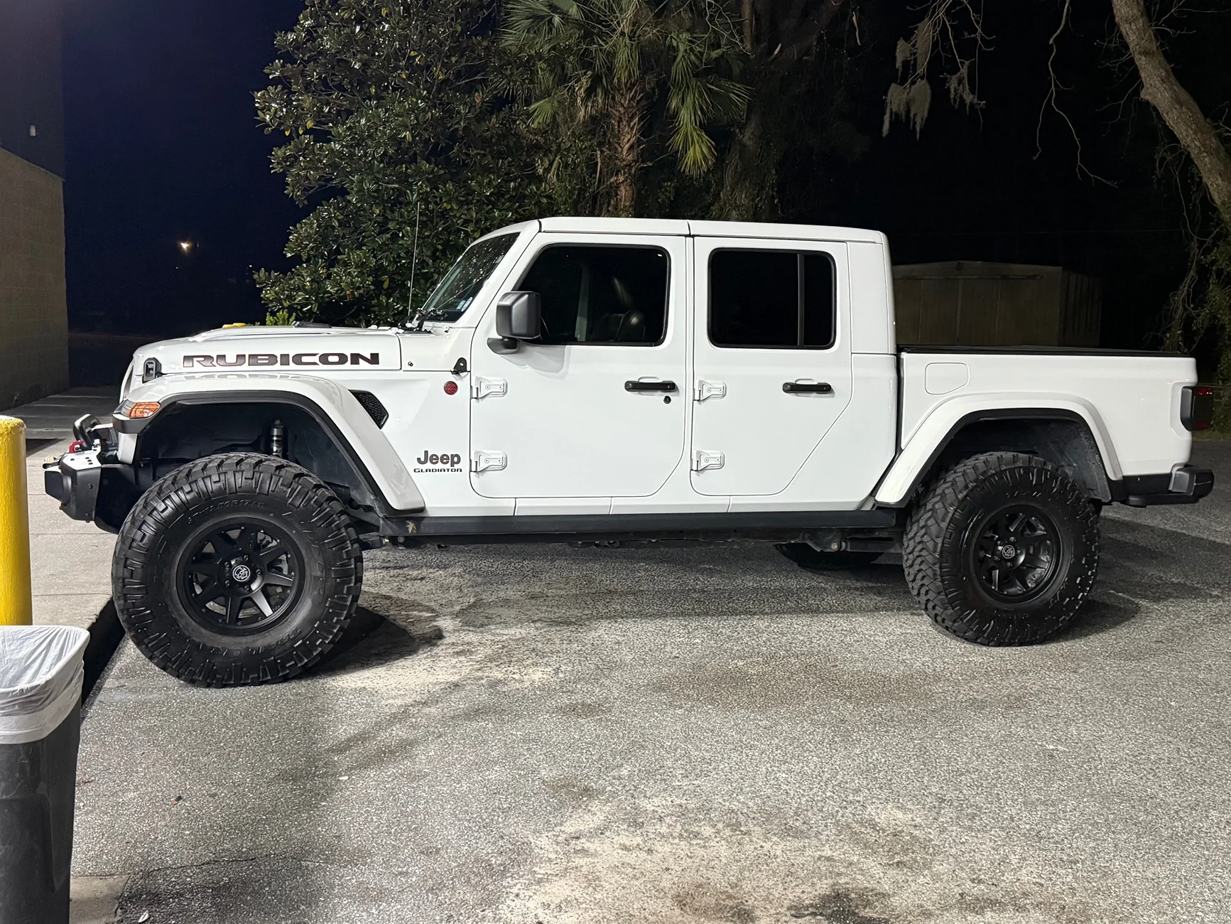

I 've had several lifts in the past (EVO. MC) and this time did the same as RustyPW on my JT. Went with Clayton diesel springs / kit 2.5" in front with JKS adjustable hydraulic bump stops so that I can adjust the lift and level everything and 3.5" HD diesel springs in the rear. Trussed the front axle, RCV's chrome/moly axles in rear. Really like the ride and handling.
Do you carry much extra weight in the bed or did you just want to keep a good rake? Any pics?
