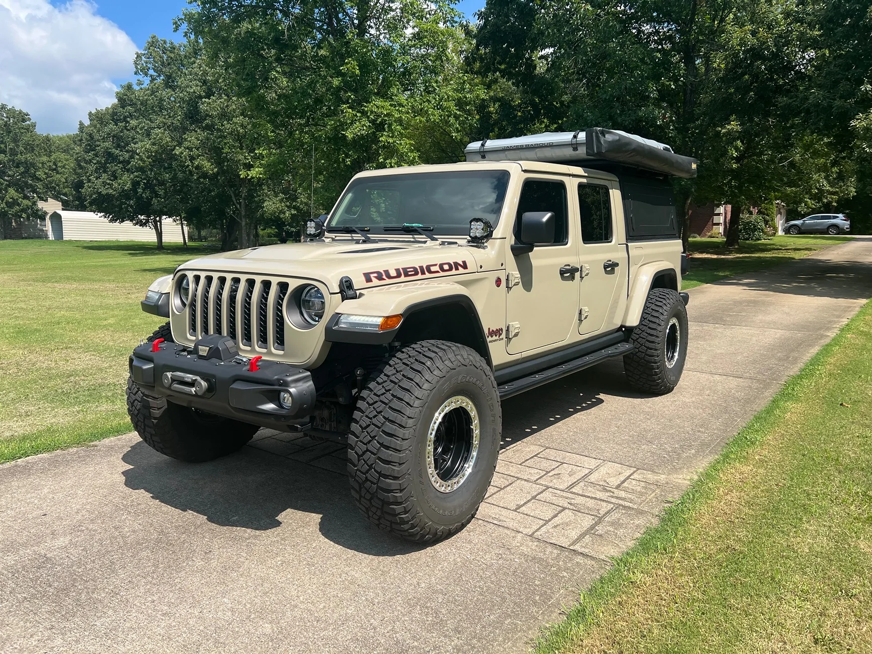

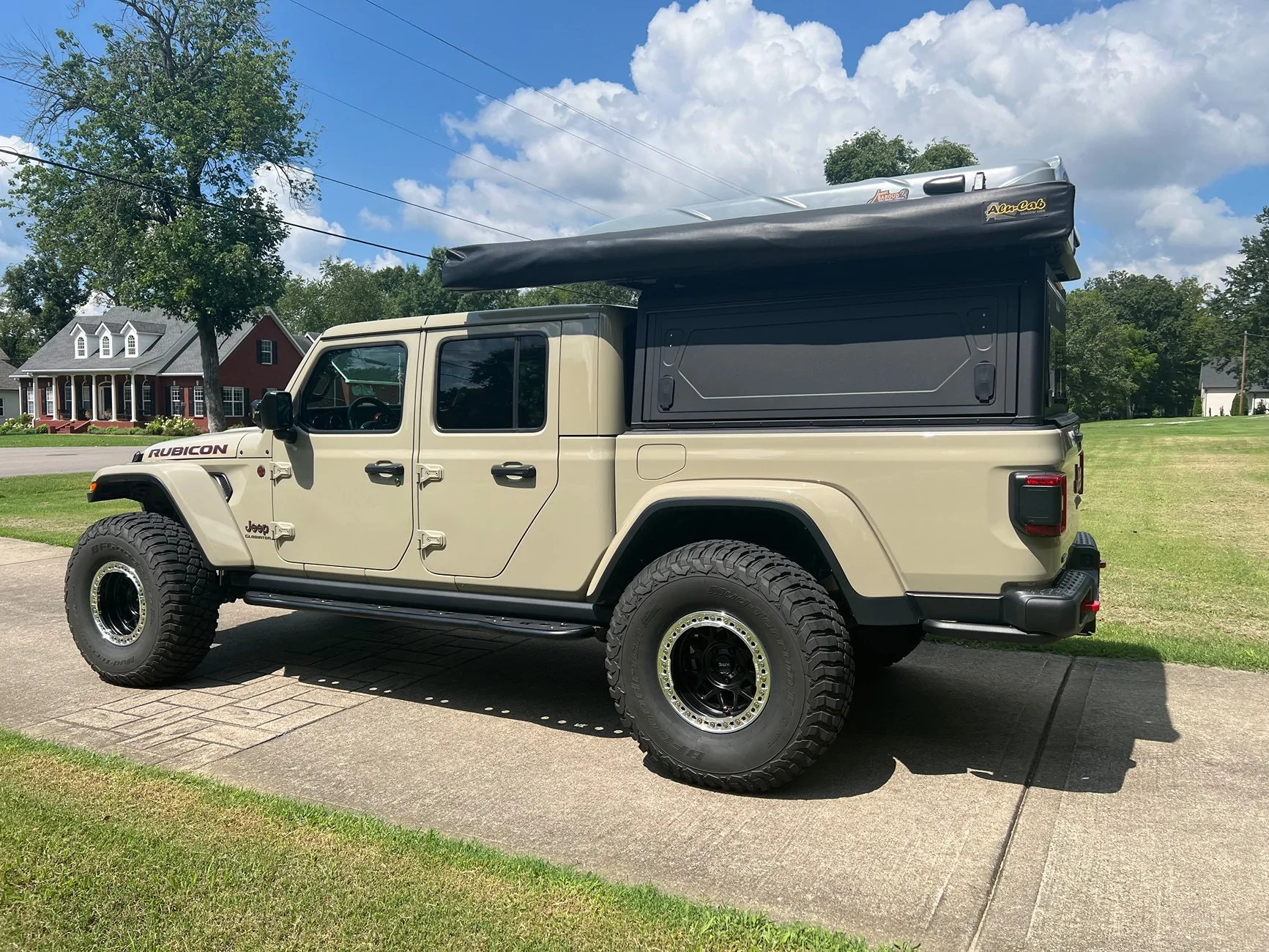

I’m running the Rock Krawler 3” Diesel specific lift on my JTRD that I built for Overlanding and have been real happy with it. I’m running a Canopy, RTT and Awning along with the AAL drawers and slides in the bed and it handles the additional weight great.
Jeep Gladiator New gladiator diesel owner- suggestions for budget oriented overland build IMG_5221
Jeep Gladiator New gladiator diesel owner- suggestions for budget oriented overland build IMG_5222

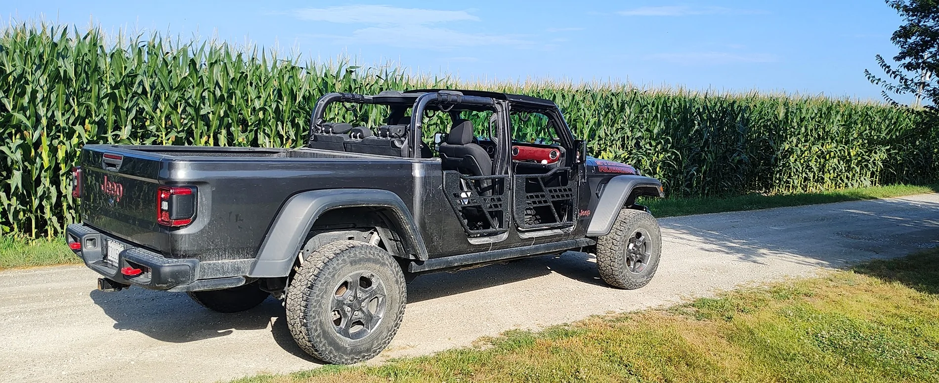

I run Clayton’s 3.5” front and heavy duty rears to handle the extra weight of my overlanding setup, Alu-Cab canopy, rooftop tent with canopy, and Decked system. Just completed the Rubicon last month and quite frankly, the Clayton’s did their job!
Jeep Gladiator New gladiator diesel owner- suggestions for budget oriented overland build IMG_1261

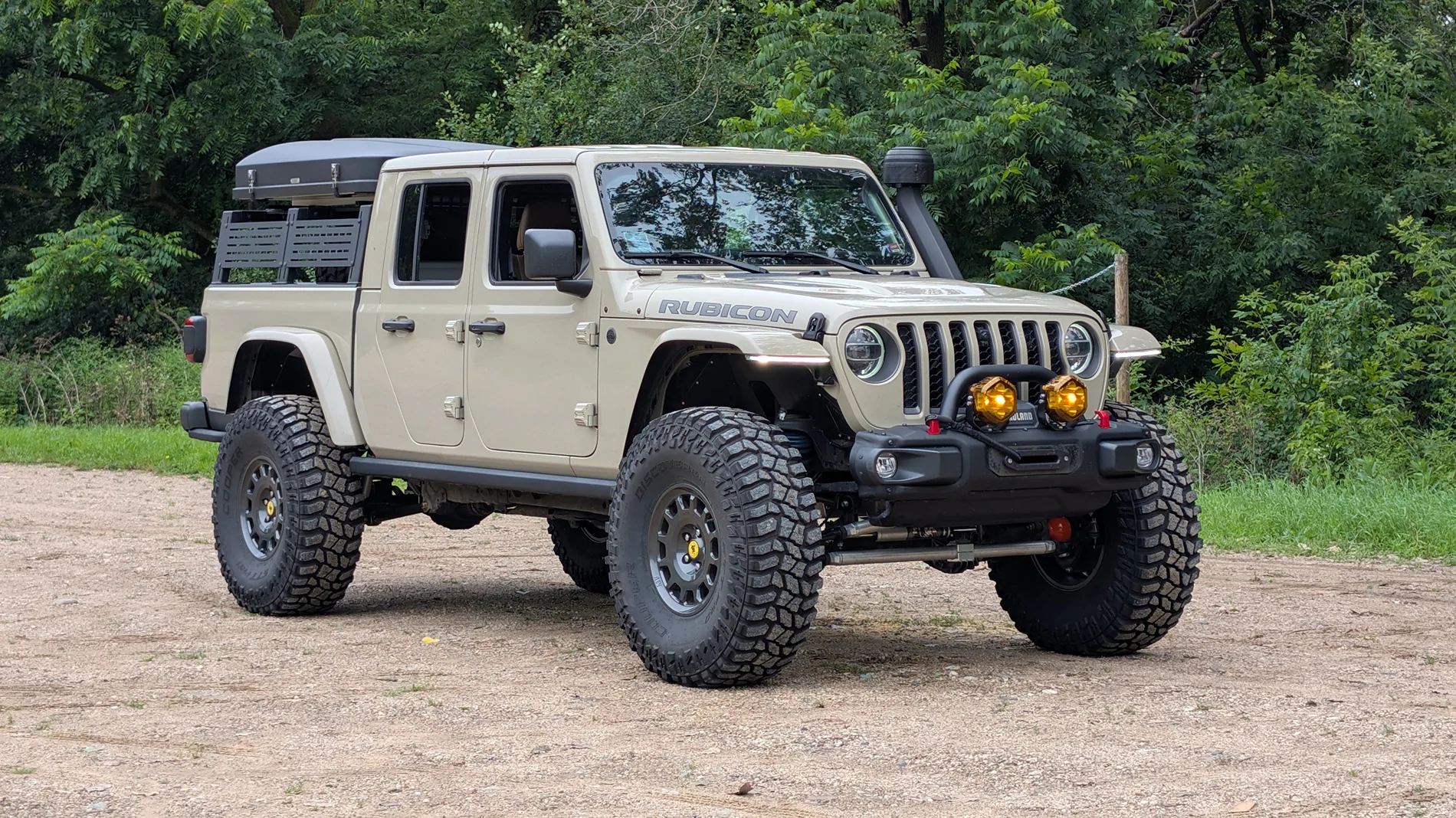

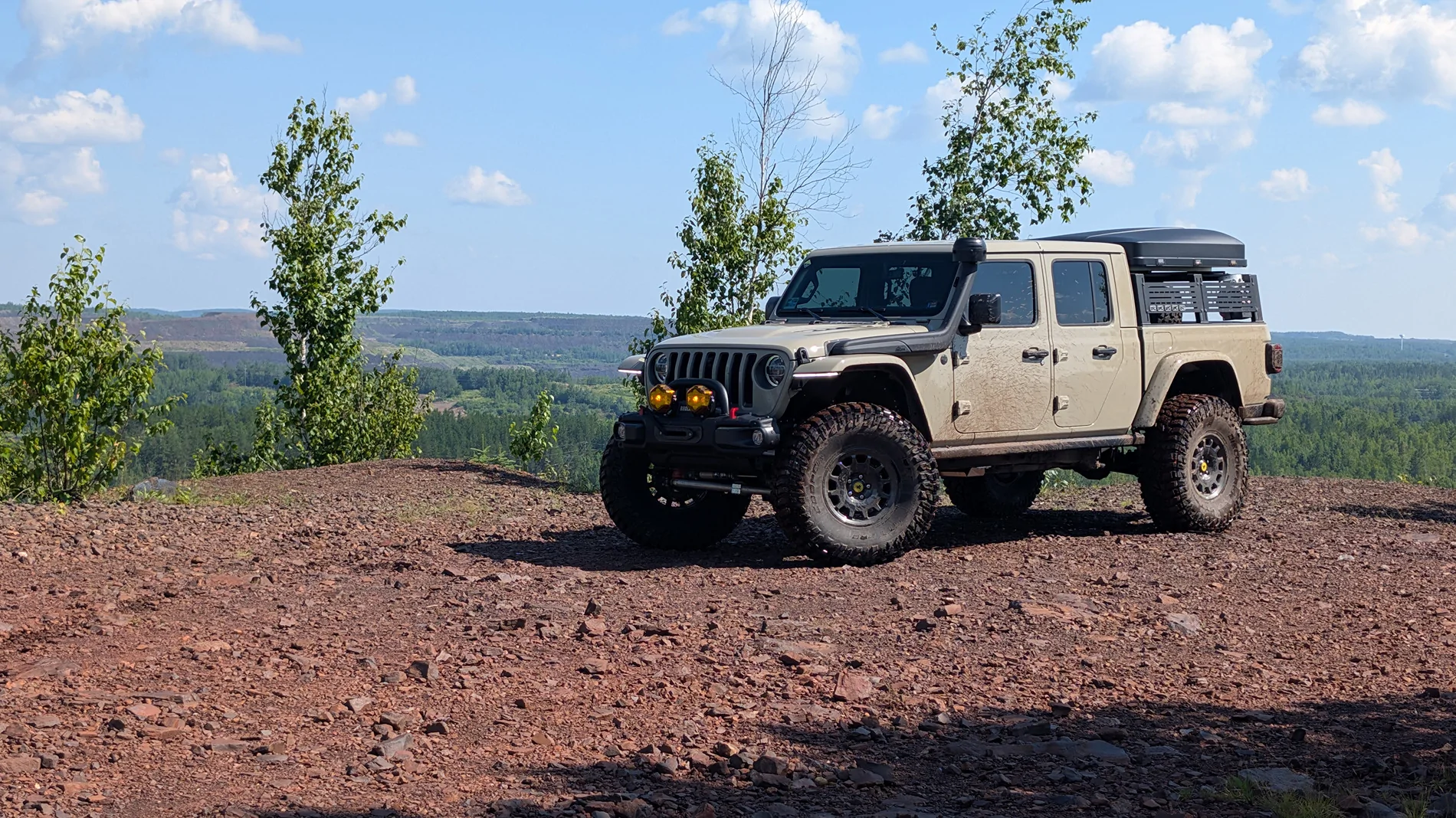

AEV HD diesel coils, plus 1.5" coil spacer in the front. In this configuration with the weight of the winch, rack, rtt, etc, it measures a 4" lift. I run the Fox 5110003 (3.5-4.0) shocks and I think they pair quite nicely. Those shocks fully drooped in the front are right at the limit of the factory front driveshaft.
I also run Core4x4 arms with Johnny Joints and a triangulated Rock Krawler rear which requires making certain aspects of the vehicle... lighter.
I drive it across the country, tackle some pretty hardcore trails, and drive it back no problem.
It's not budget overall but it's pieced together and I did it over time, buying a little here and there. The approach itself was surprisingly budget. But it's all relative, it's budget in the context of mods done to a new $60k vehicle.
Jeep Gladiator New gladiator diesel owner- suggestions for budget oriented overland build PXL_20250716_192712807(2)
Jeep Gladiator New gladiator diesel owner- suggestions for budget oriented overland build PXL_20250717_152140332
