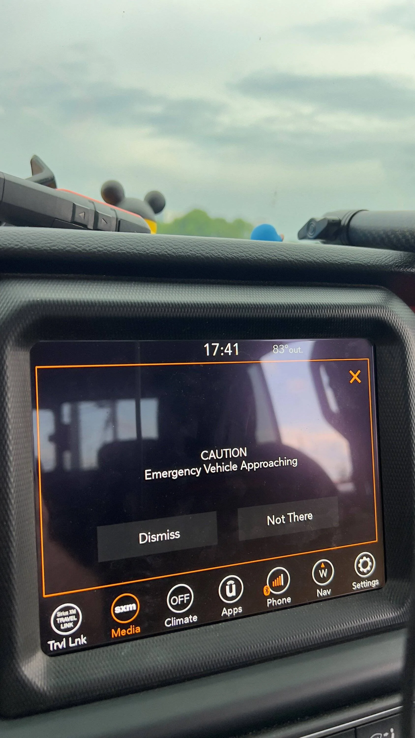

Never got an update but I see the "emergency vehicle approaching" warnings now. 23 w/ a build date of Oct 22

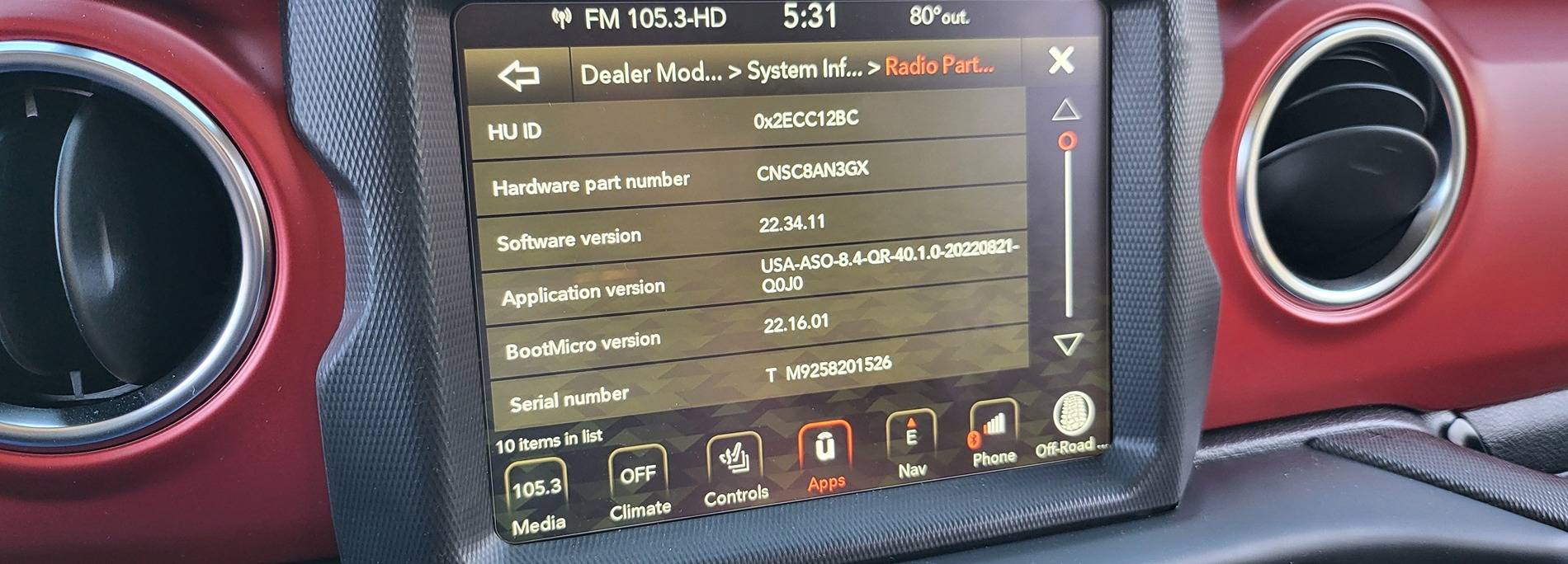

Yeah I got the update awhile ago.........let me check
20 April was my Update.
My build date was 10/22

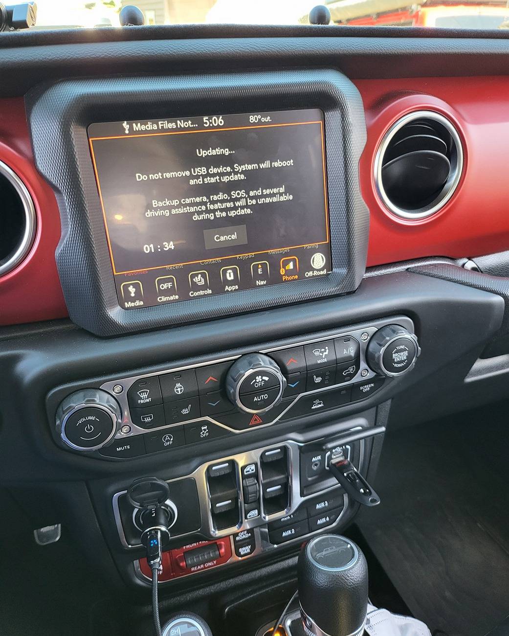

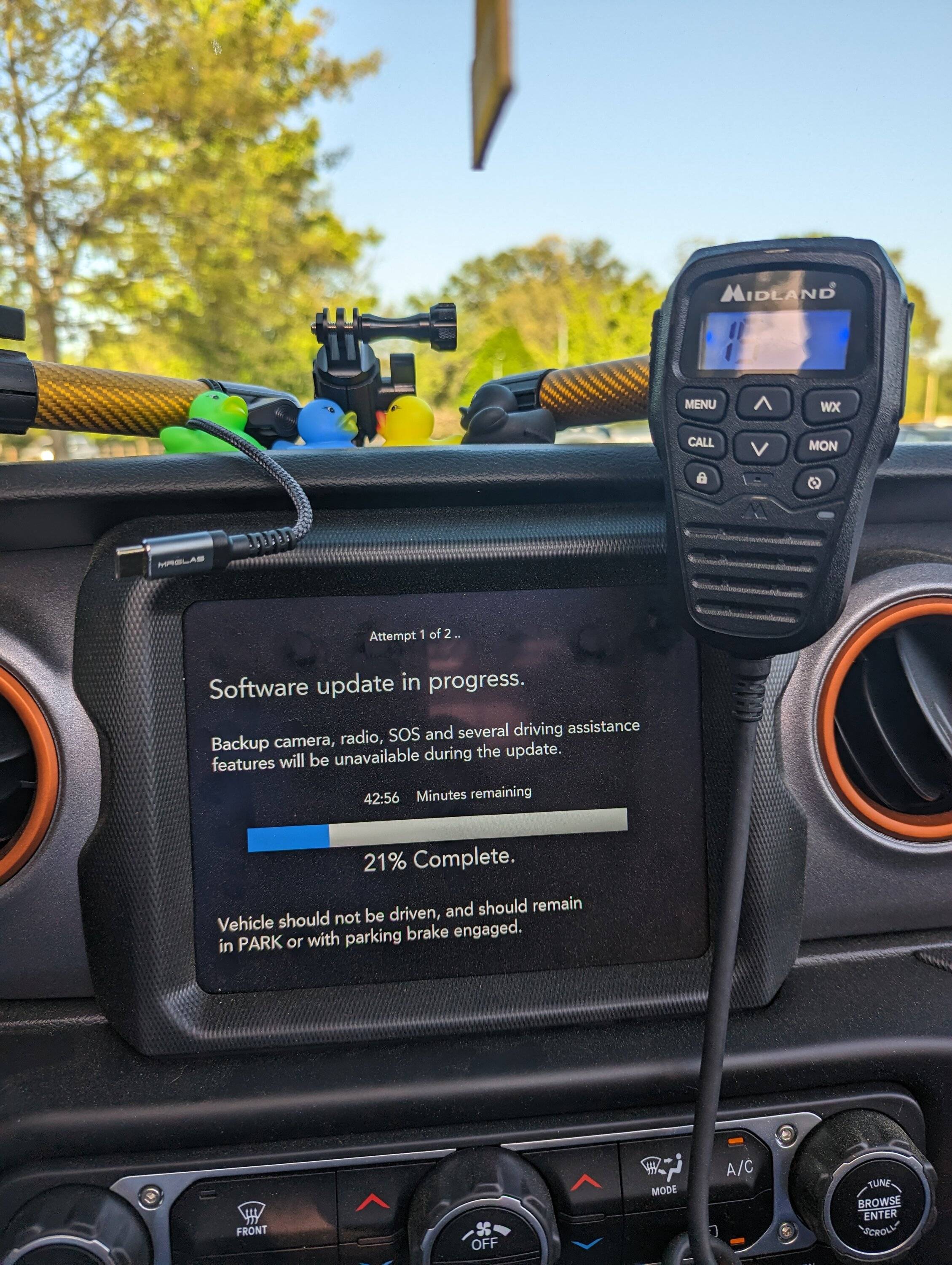

Just updated mine with USB drive..
Jeep Gladiator New Gladiator Software Update Prompt 1000011421
Jeep Gladiator New Gladiator Software Update Prompt 1000011433

Did you pay for a GPS map update and the get the USB stick to upgrade?
No. I bought a generic USB drive and copied the firmware into it.
I am planning on doing a write up once I have a good idea that I didn't break anything.

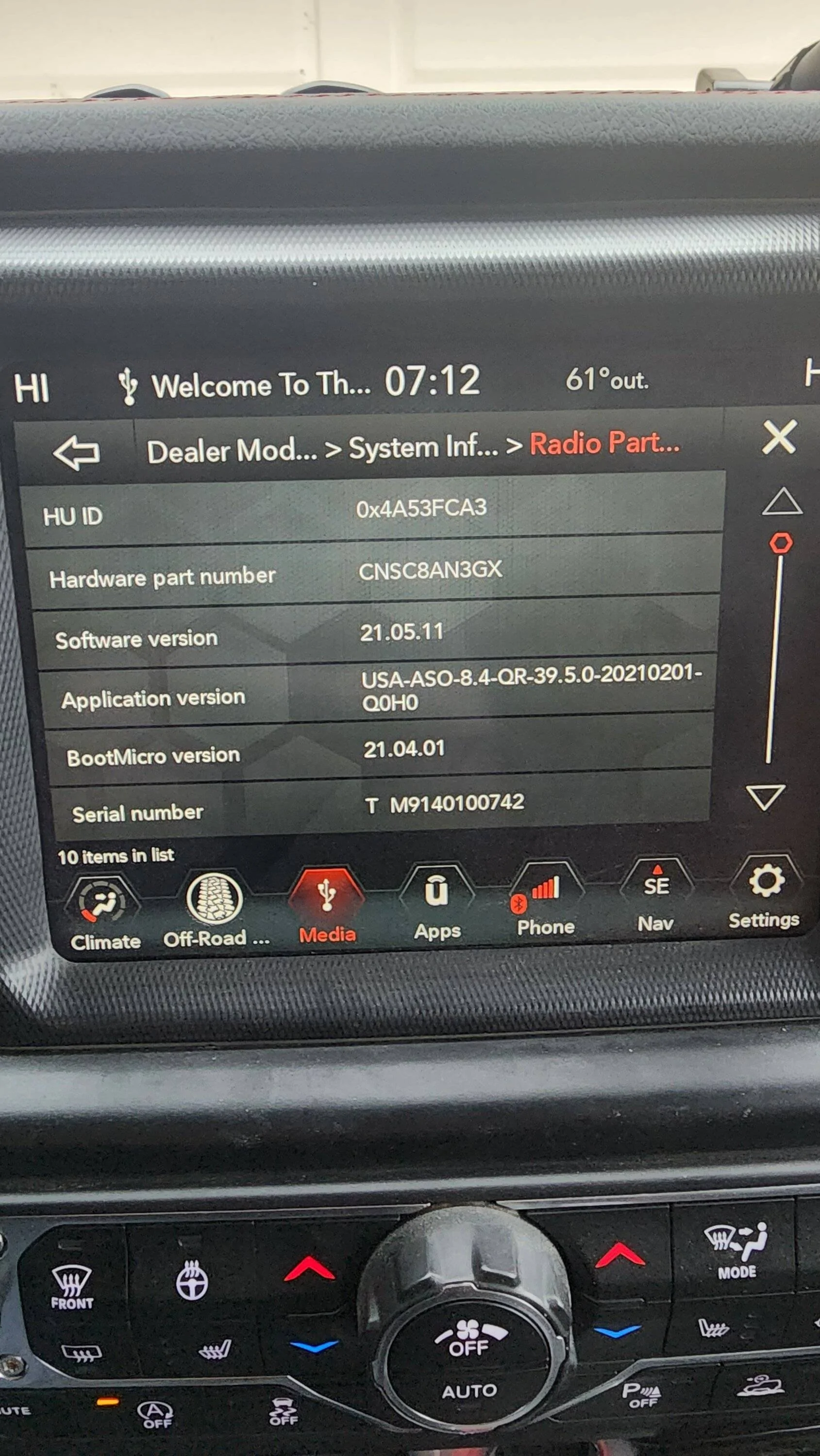

I have never seen an update on my screen. Does it matter which model or screen you have? 21 EcoDiesel 7" screen Sport S.
How do you check?
