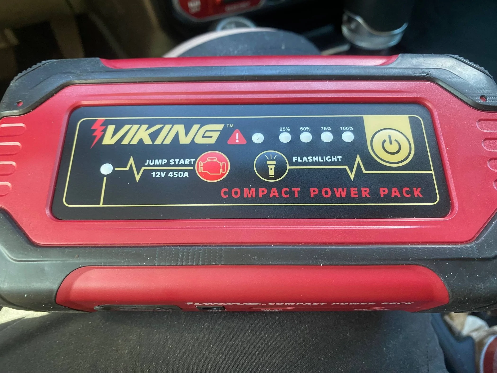

My Viking 450 jump box cried when I tried to start the 3.0 with 9.2 bolts showing on the v-meter

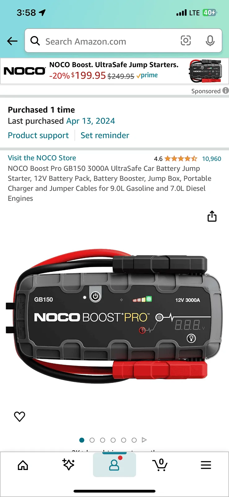

My buddy sent his son over to jump me off with his NOCO GB150 with 3000amps and the ability to jump up to a 7L diesel. It giggled at the 3.0. I swear it started before I hit the start button.
drove it to the dealer after 2 1/2 hours they came out and told me the batteries were fine but they gave it a good charge.
I made another Amazon purchase.
