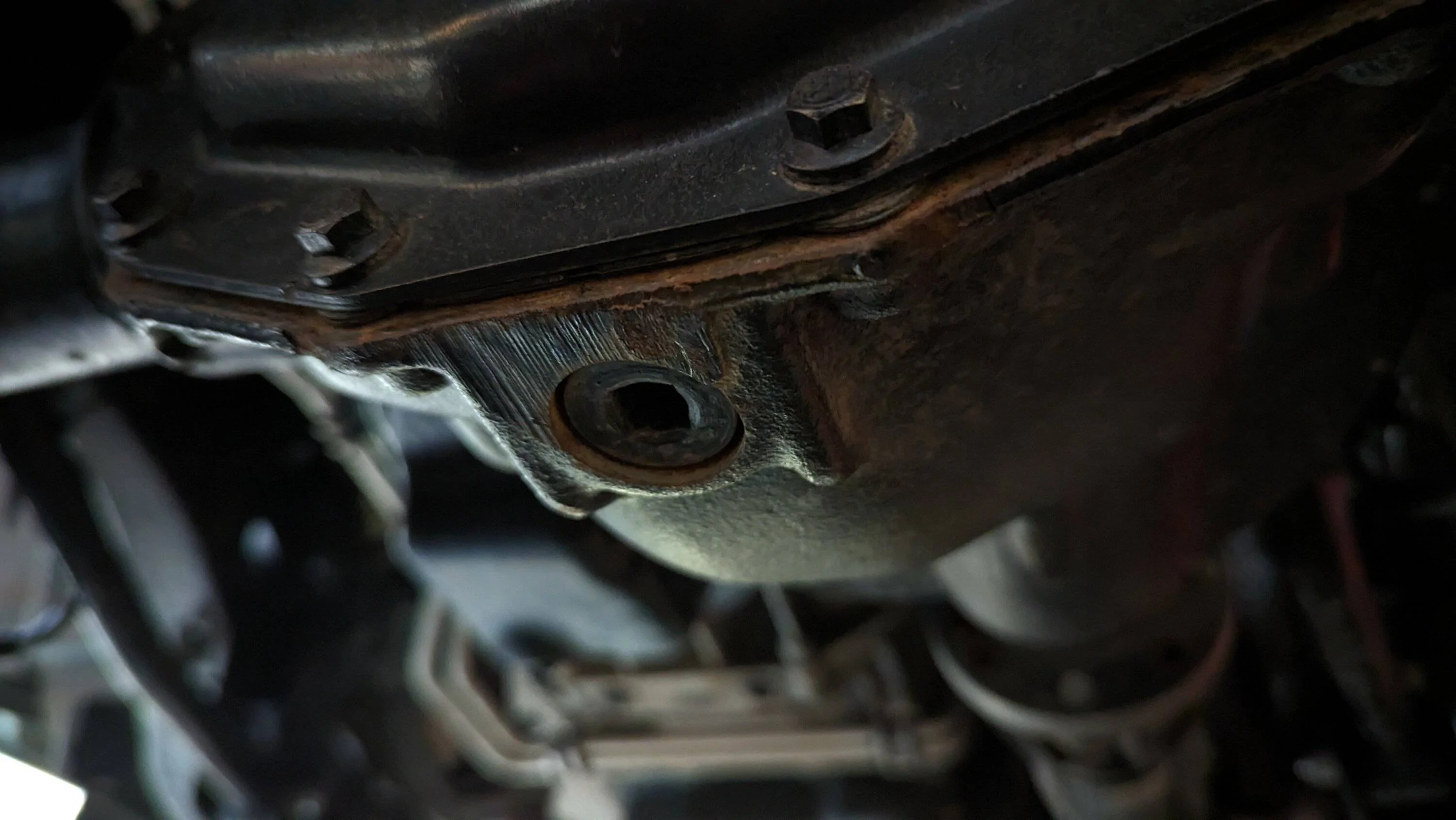

Here's some info for us people with drain plugs front and rear. The rear is offset and pretty much protected, the front could get scraped up at it's center lower location (like the picture above). There's a little skid made to protect the front drain plug.

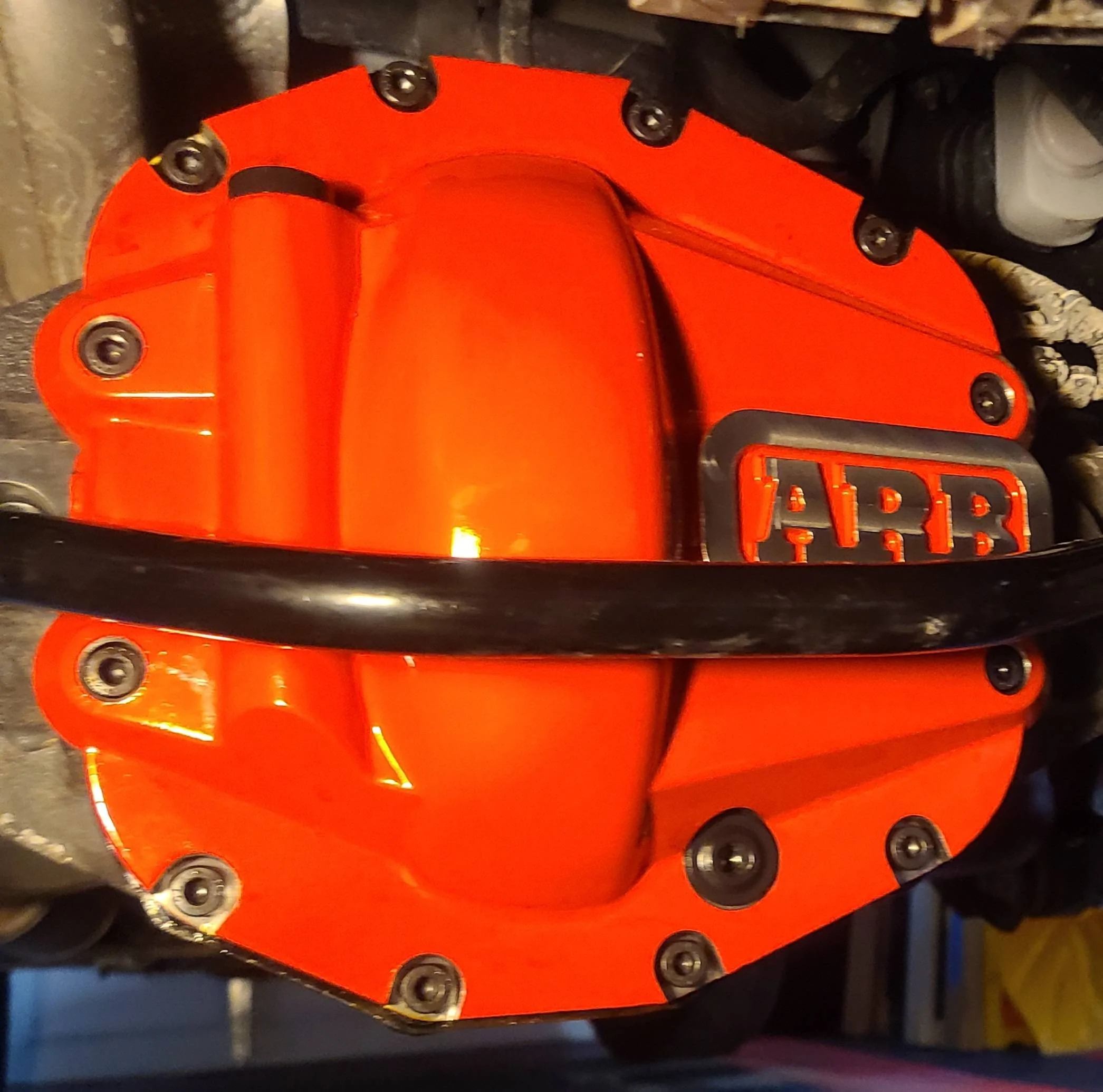

I haven't done my front yet, but my 2020 (May 2019 build) has drains on both axles. The ARB diff covers have drain plugs and dipsticks. They're heavy duty and reasonably priced.
Jeep Gladiator No diff drain plugs?! 20220207_164418
