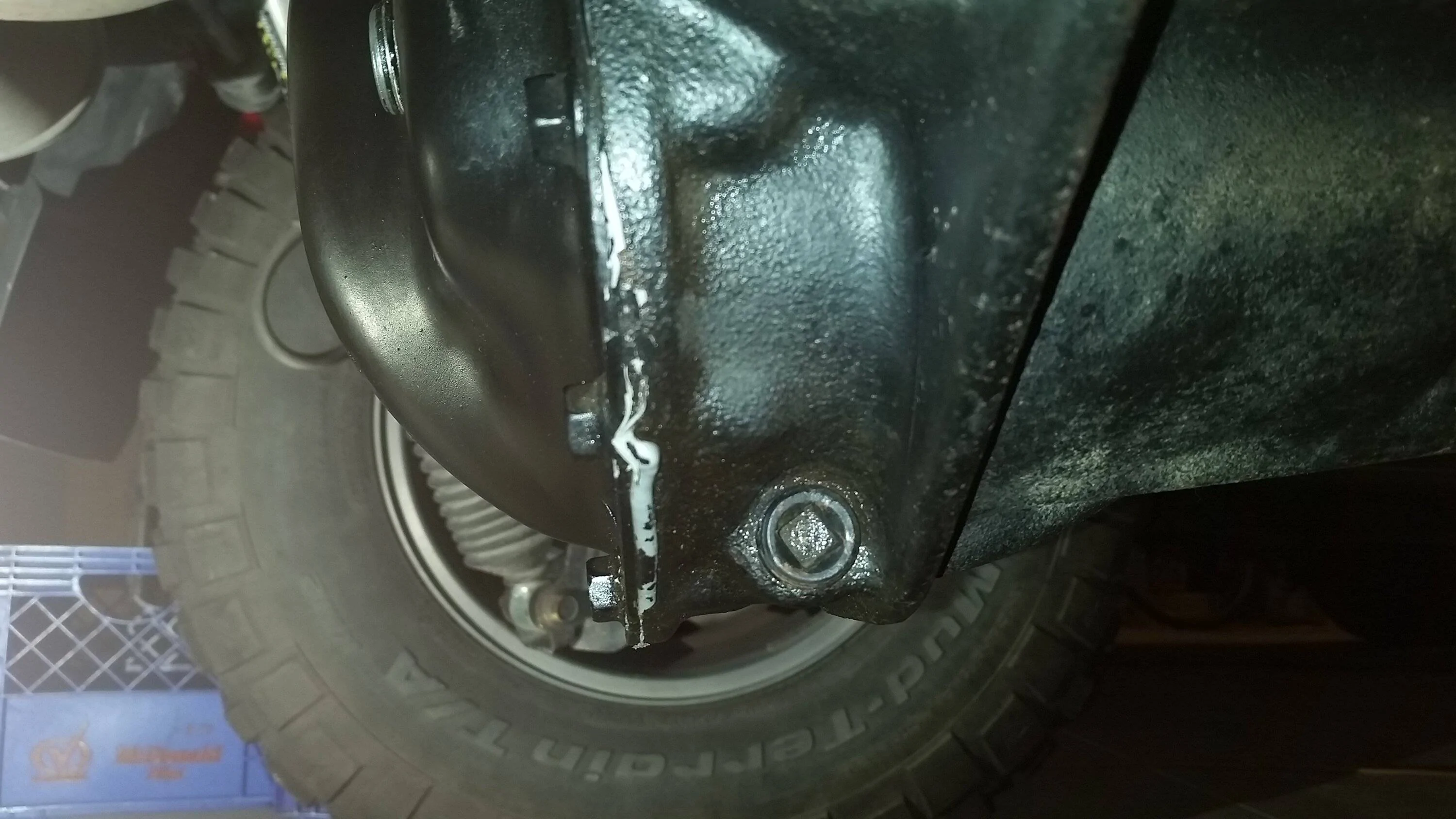

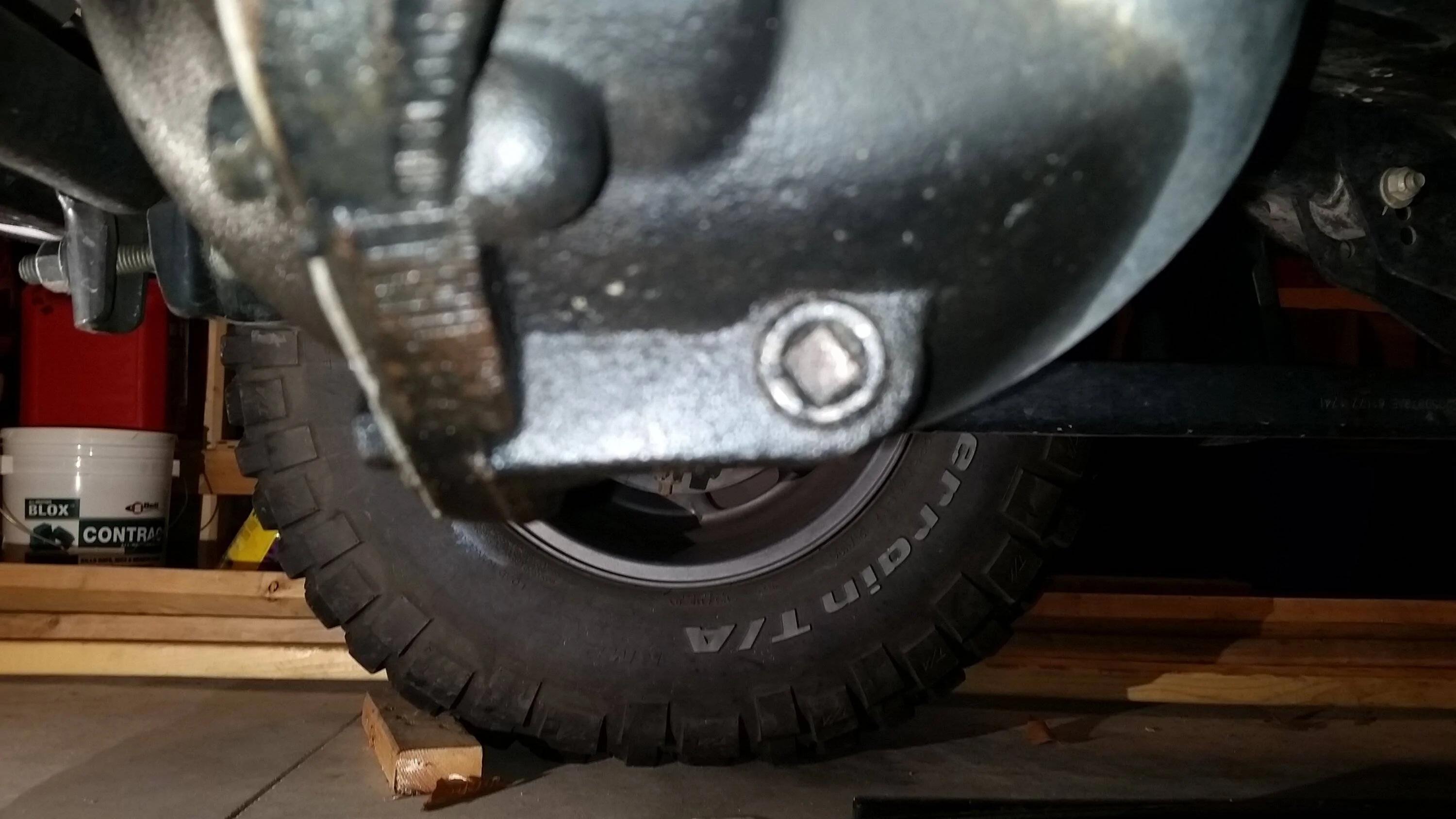

I have plugs. If I wanted to remove the cover I would drain it out of the plug first anyway and inspect the magnet. I personally think they discontinued it for cost savings but I have nothing to back that up.
This.
Also, I'm glad mine has the drain plugs. Pulling the cover when I don't have to sucks. For those inspecting your gears, rock on with your bad selves... but what if you find something bad? You're only slightly less screwed if you find out the hard way.
Too much metal in the flakings? Ring gear missing a tooth? Whaddya gonna do, regear it right there in the driveway? I wouldn't, and I actually did my own regear. I'm not saying inspecting your gears is a waste of time, but let's be real- it has LIMITED benefit.

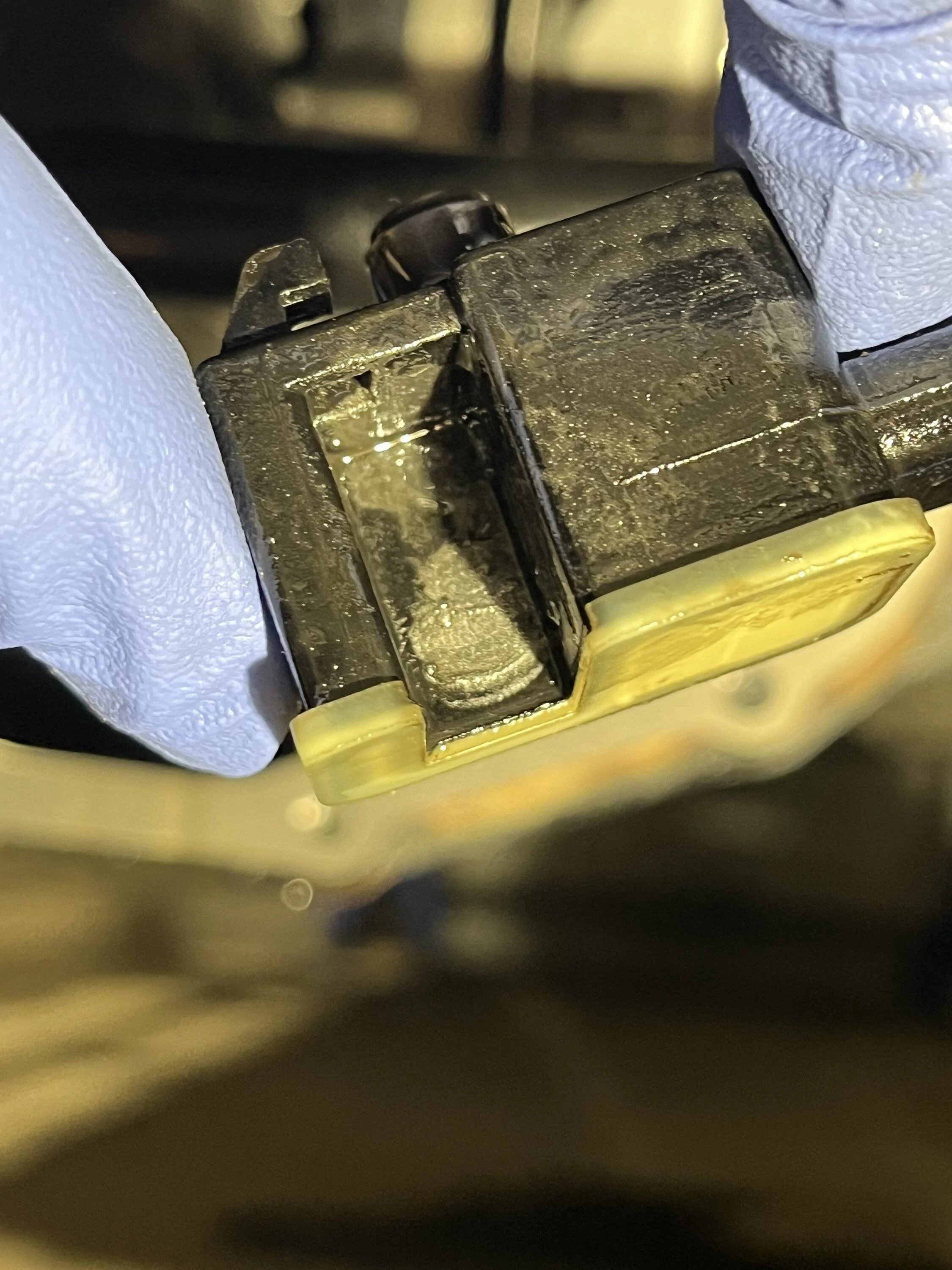

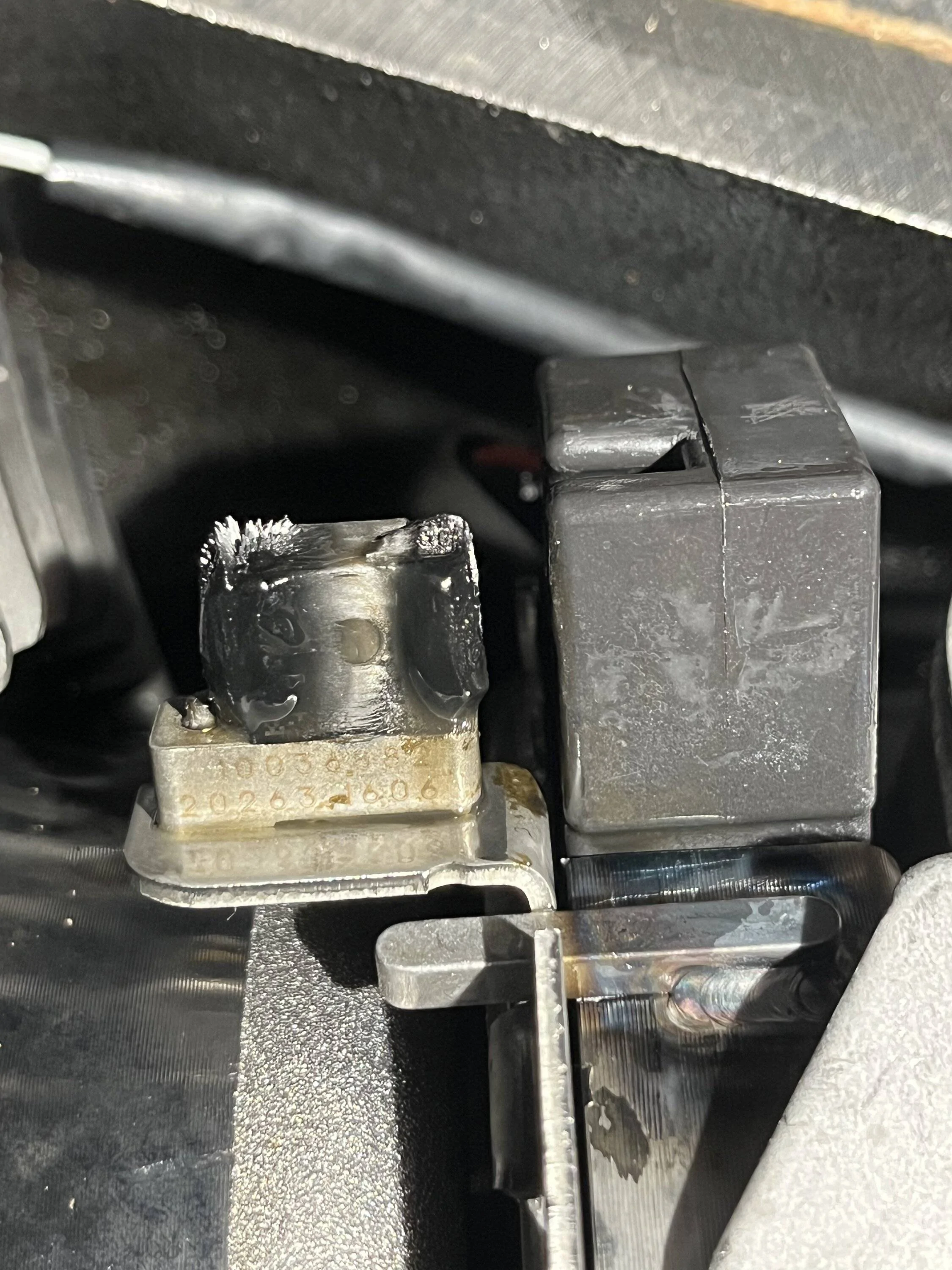

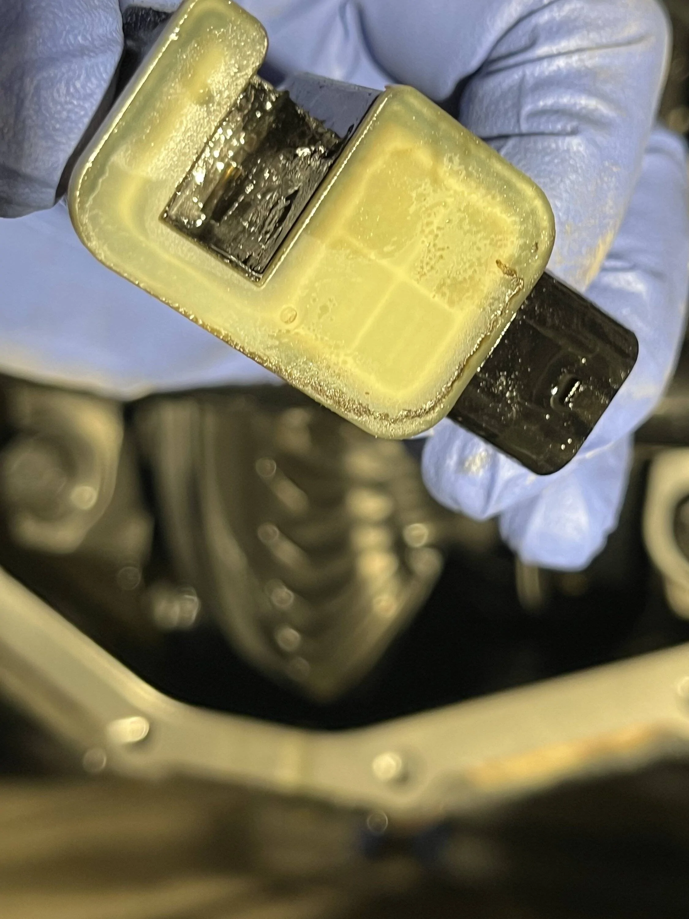

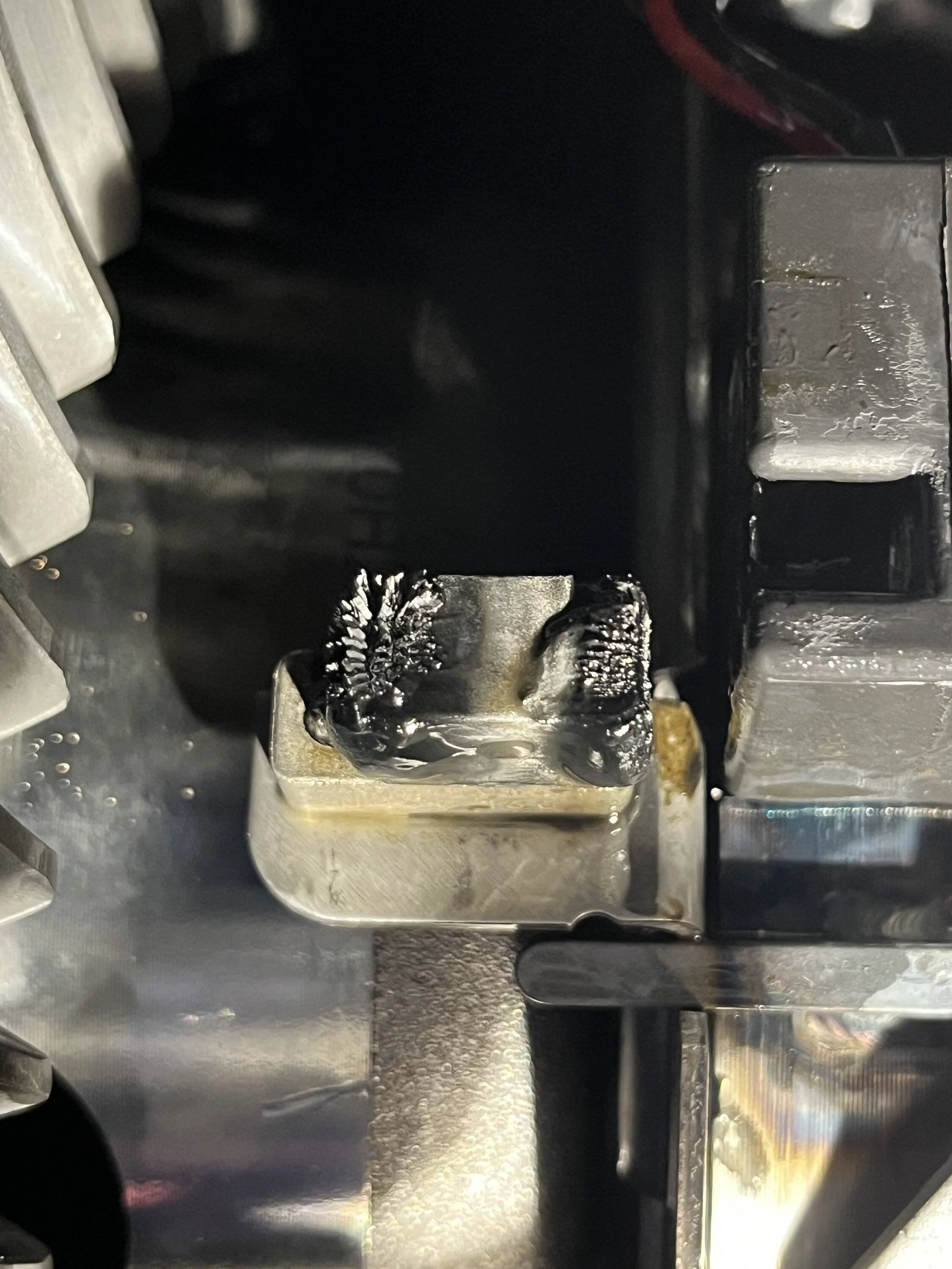

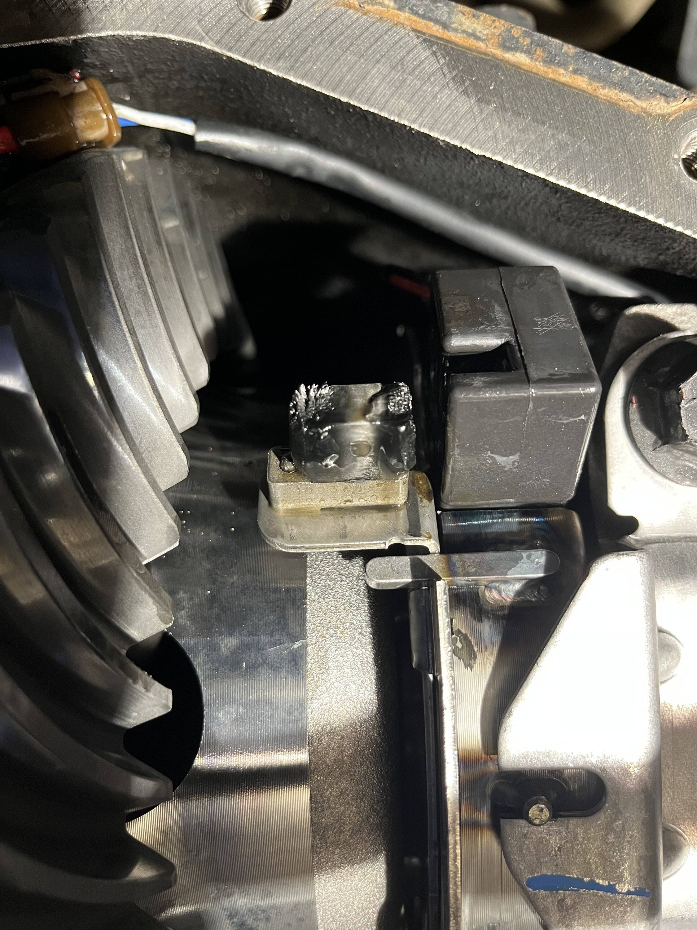

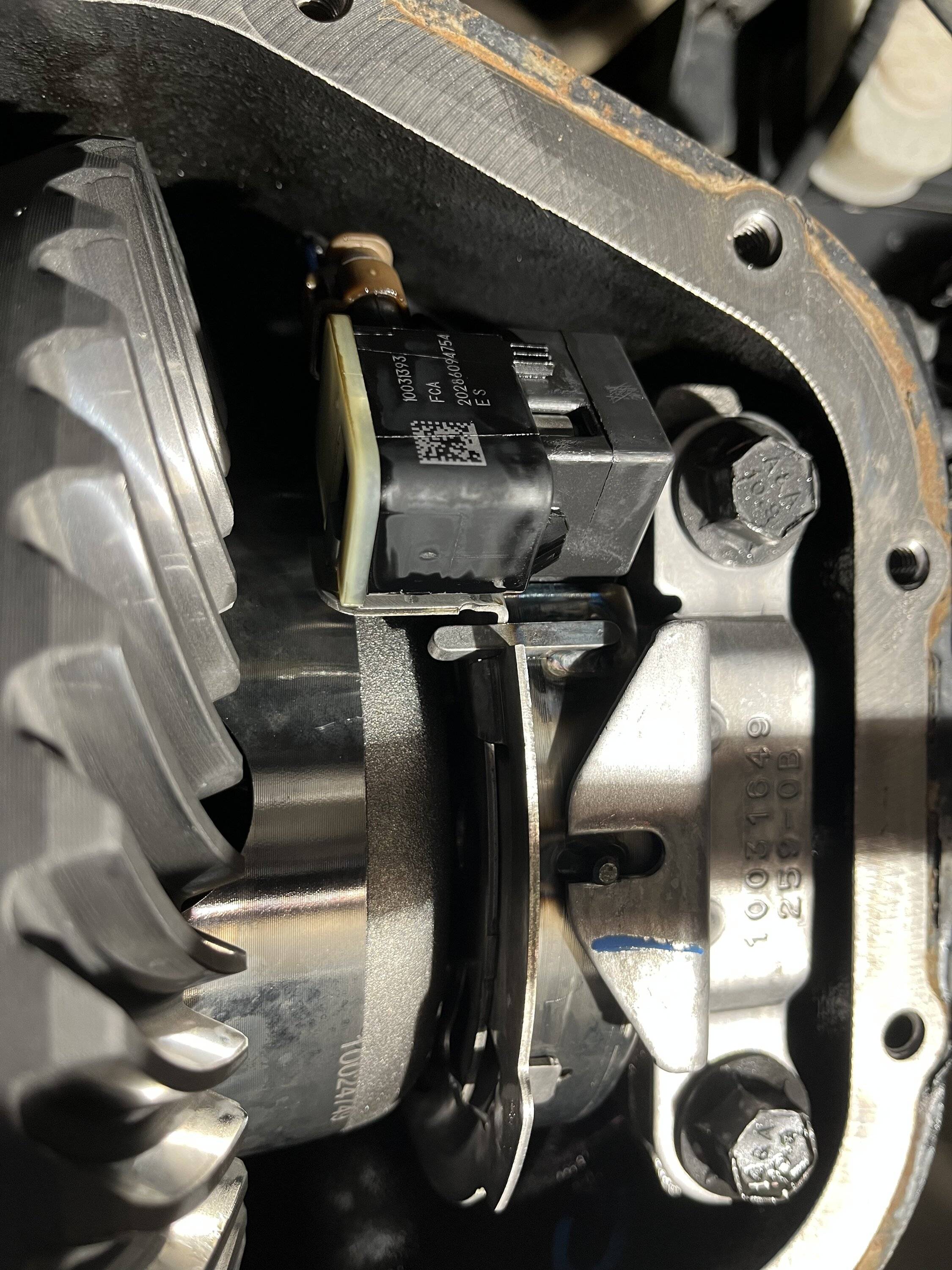

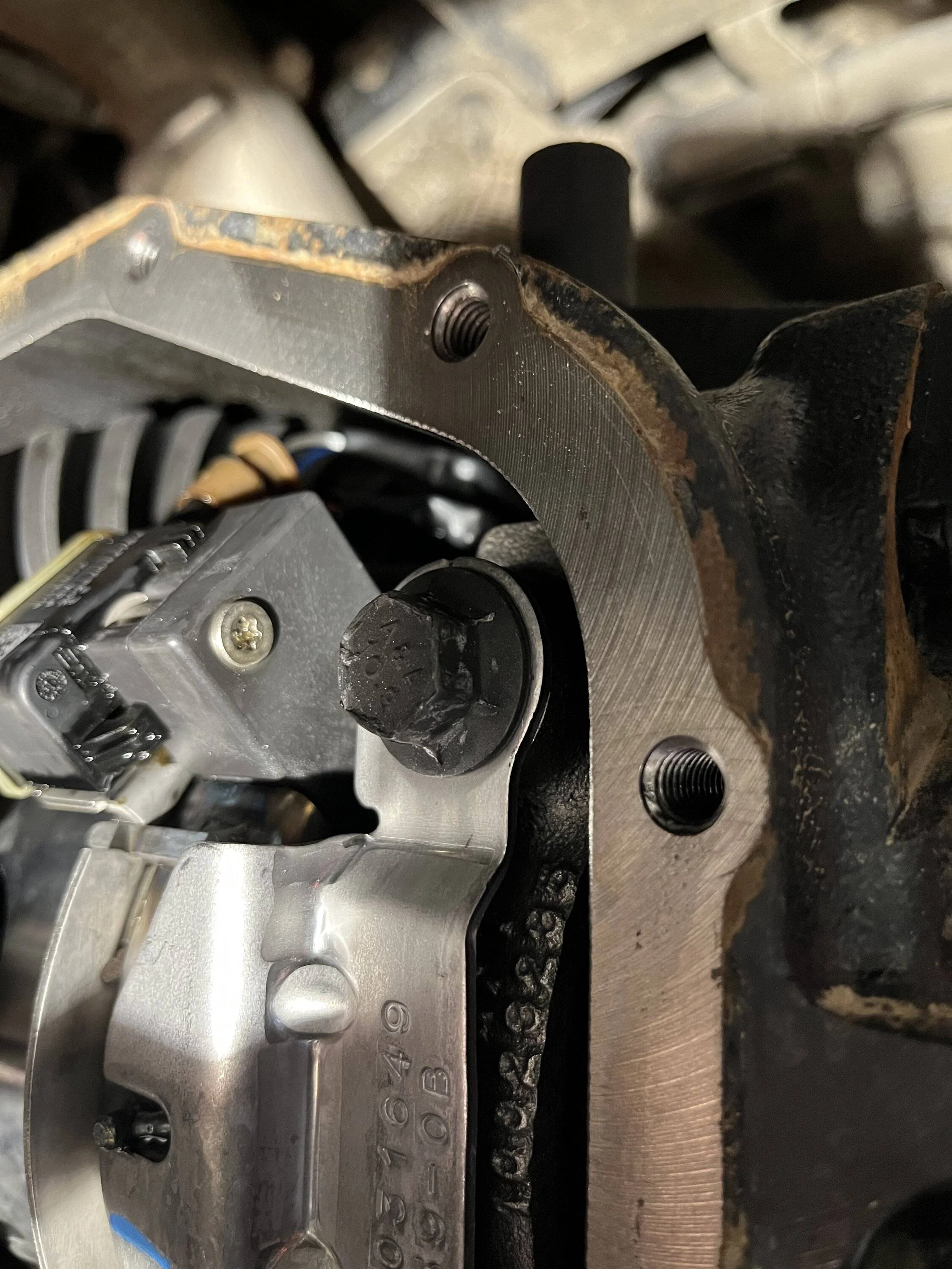

It’s a blessing in disguise actually. You’ll thank Jeep for making you pull that cover. WHY you ask. Because there’s a locker sensor in there that sits on top of a MAGNET and it’s plugging up with filings and magnetic gunk which effects how effectively your lockers engage and disengage.
While you’re in there taking off the sensor (one torx screw) you can see if the sensor has oil in it or not and maybe “pot” them at the same time. (Lots of great info on that and many of us have done that)
I just did mine. Cleaned the sensor magnet in both diffs on my 21 JTR and potted to sensors and the lockers now engage on the second dash signal blink! I’m not waiting any more like I was before for the lockers to engage. It’s now immediate! Disengaging is immediate. You’ll be glad you pulled the cover and found that sensor magnet packed full a crap.
Spray out the diffs with brake cleaner too. You’ll feel good to see it all clean.
