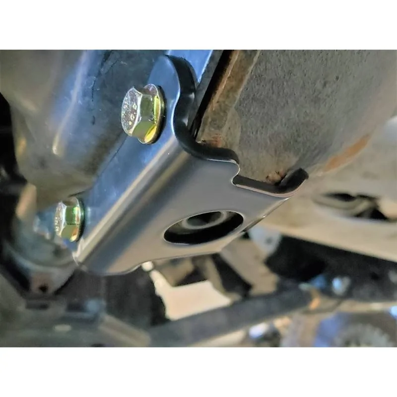

Here's some info for us people with drain plugs front and rear. The rear is offset and pretty much protected, the front could get scraped up at it's center lower location (like the picture above). There's a little skid made to protect the front drain plug.
Jeep Gladiator No diff drain plugs?! aximus-3-jljt-drain-plug-skid
A little expensive for what it is, $50. I'm a overland and trail type and don't need a whole lot of skids like the rock guys. I'm constantly trying to keep my rigs weight down and I like this little plug skid, it's definitely not for everyone.
That's a great looking option. Rancho has a diff skid with the plug exposed as well. Not sure if it is discontinued or not, because they did release a new front skid for models without the drain plug and the whole diff is now covered.
