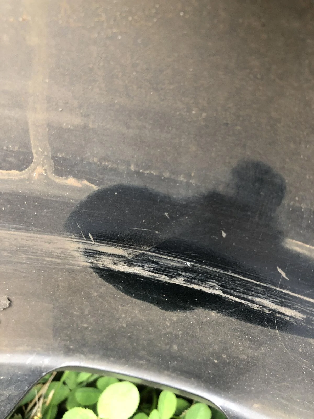

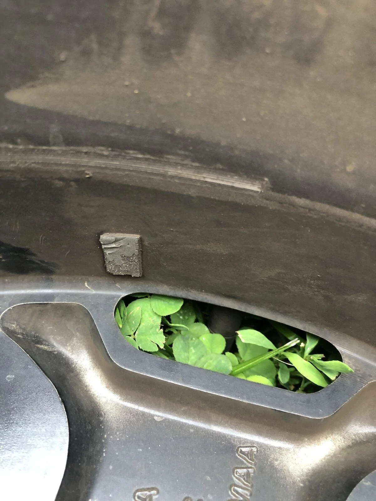

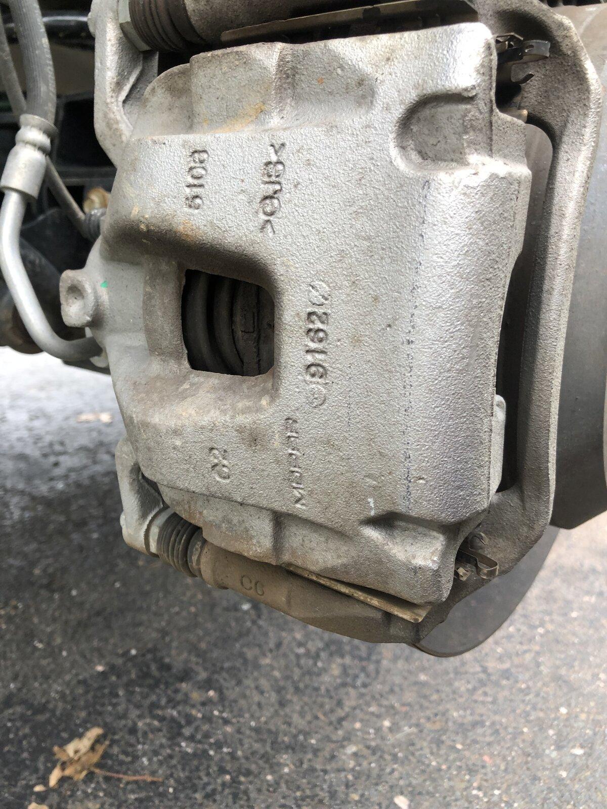

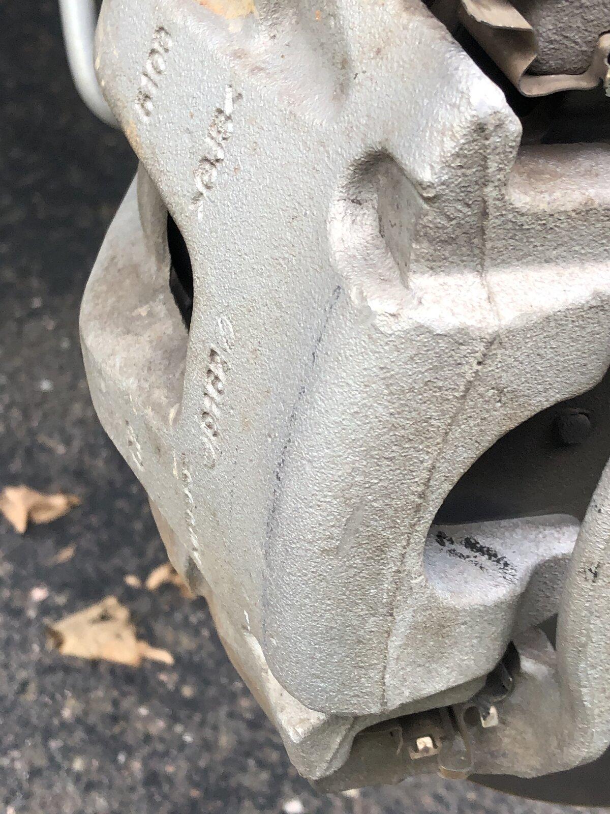

I'm glad you confirmed your pads are good to go.
I doubt your caliper is making contact with the barrel of the wheel. While the gap between them is small, there are many examples of less gap in wheel/brake setups. My GT4 is closer to the wheel than the Gladiator and it doesn't touch.
What it does do, and what I suspect you are seeing, is create a nice spot for rocks and stones to get stuck between the caliper and wheel resulting in that scoring you see on the wheel.
Possible, from looking at the pictures tho I do see a black line and some light polishing on the caliper which lines up exactly with the witness mark on the wheel, hopefully It was just some rocks or some wedges between. Just went for a quick ride, didn’t hear the grinding, keeping my fingers crossed…

Good point. And some shops use wheel weights that are lower profile than others. We've seen some use pretty thick weights and those get ripped off while the low profile ones clear.
Hadn't thought of the rocks and grit getting in there, even a twig could do it.
Yeah It looked like the weights were just barely missing the tightest area of the caliper, but then again the shop that did my MT/RS did quite a shitty job of balancing the wheels (weights all over the place), sort of got the idea they had never done a 35 before etc etc either way, didn’t see any marks on the faces of the weights and all weights look present, gotta go for a good 35/40 minute drive around noon, will update then.
Yep. I had a rock stock in one of my GT4 wheels. Scored almost the entire barrel and matched scratching on the caliper. Never heard a thing.
The wheels weights are also a good call and possibility.
