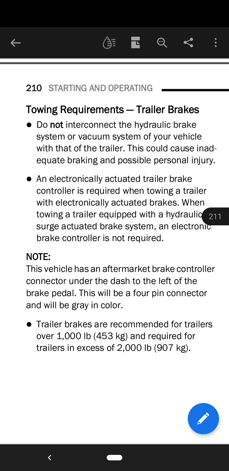

I saw this from the 2021 owner's manual. It seems I will need an aftermarket brake controller but it seems to be not required for trailers that are equipped with hydraulic surge brakes.

Correct if you are only towing trailers that have hydraulic brakes, you do not need an electric brake controller. That said my Boaton Whaler trailer has hydraulic disc brakes on both axles powered by a electric over hydraulic brake system controlled by my electric brake controller that was on my suburban, we'll see if the Mopar one works. It is not a bad idea to have the brake controller, you might need to rent a trailer, or borrow a buddies trailer , then you would be stuck without brakes.....Jack

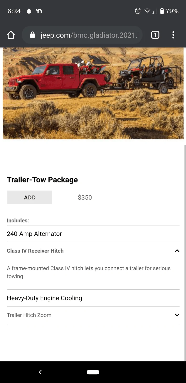

It seems the JTR with Trailer Tow package comes with Class IV receiver hitch.
