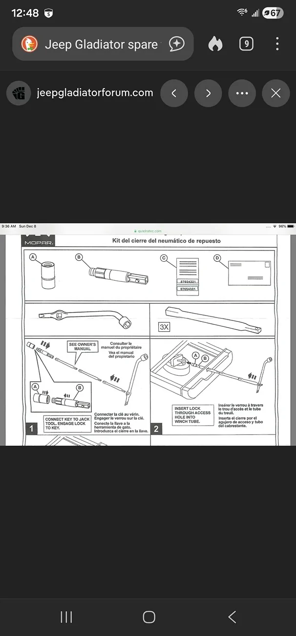

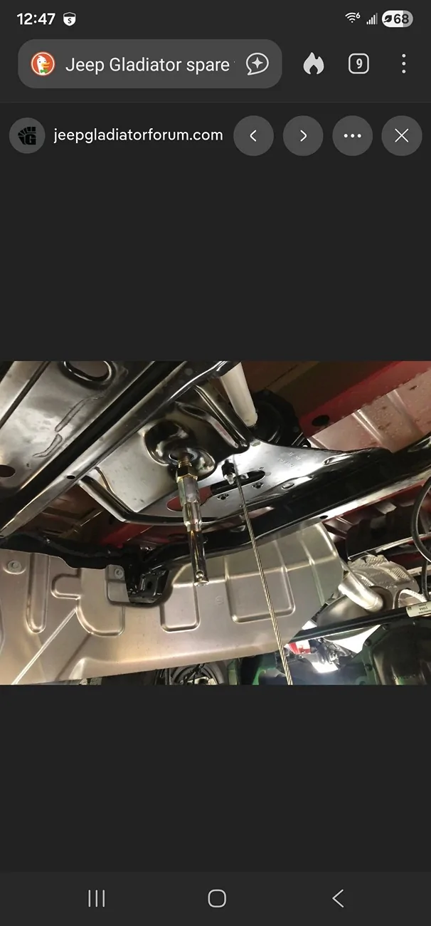

Is this lock on the bottom of the tire when you look up at the lowering mechanism? Or is this in the hole where you put the tool to lower it?
I found pictures that do it both ways and I didn't see it from the bottom of the spare on mine.
