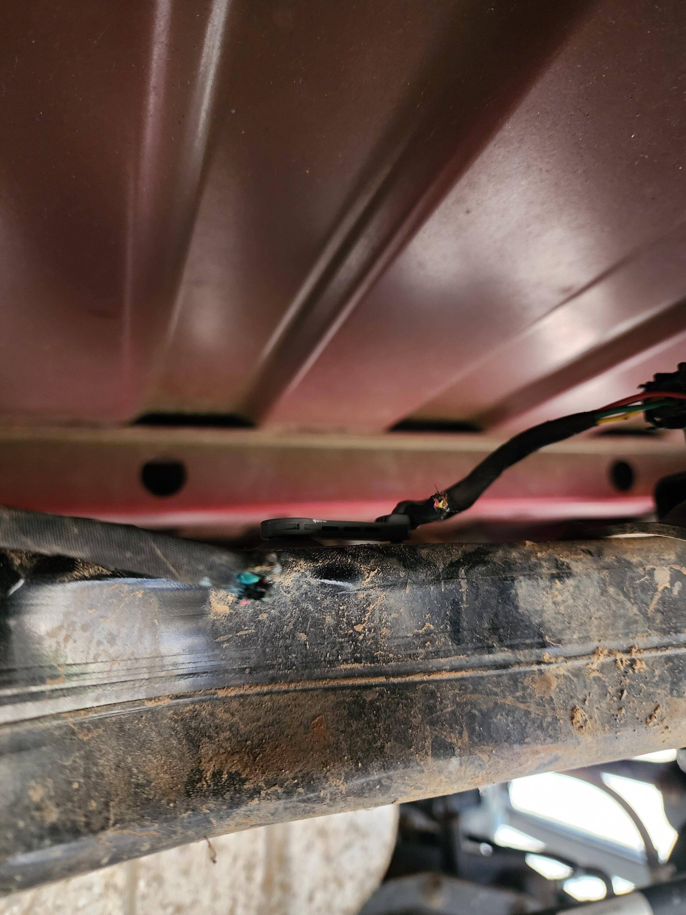

You could try unplugging it, and clean it with some electrical contact cleaner, then add some dielectric grease? I believe this would be the plug area:
Jeep Gladiator Not TPMS but TPMS ?? This was weird . 20221128_142758-
Not sure if this will work for you, but sometimes the simplest things can fix the most irritating glitches. Good luck!
Is that rear frame area ?

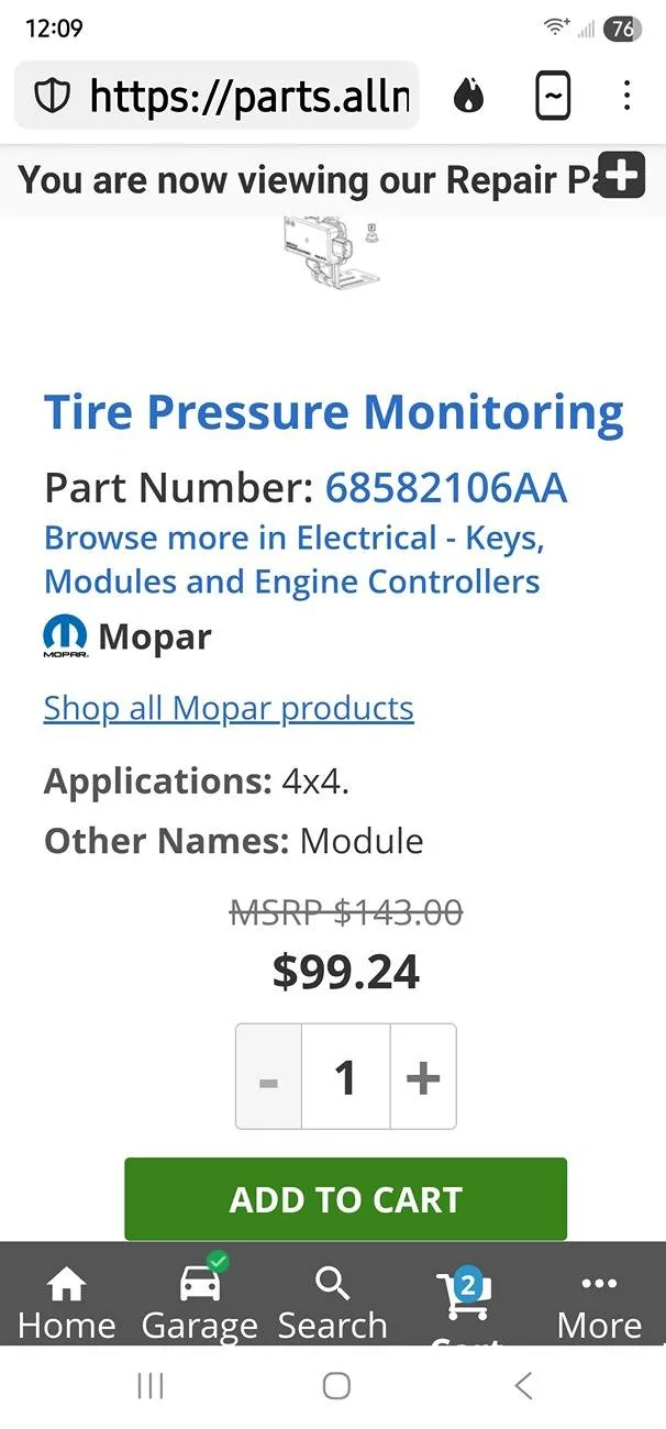

Well wonder if the TPMS module is cheaper than the RF hub?
I got to look up and see where the darn thing even is located
Jeep Gladiator Not TPMS but TPMS ?? This was weird . Screenshot_20250607_120941_DuckDuckGo
