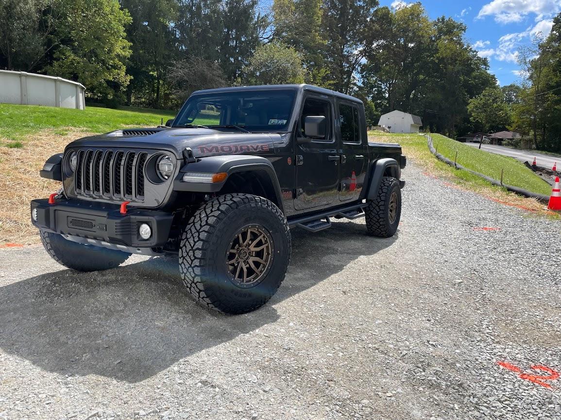

Hi all: I'm sure this has been discussed before but I'm getting conflicting info with a search. I just installed new wheels and tires on my 22 mojave and after about 10 mins the system lost the old sensor data as expected. How long until it learns the new ones? My JL learned them so fast. I just cant remember the relearn procedure and timing on these?
thanks!
pic for attention
