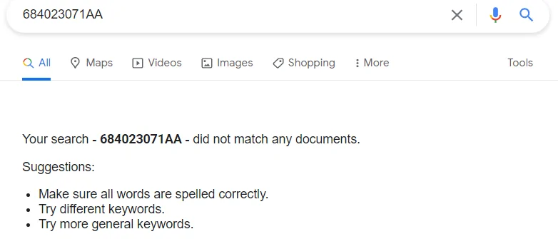

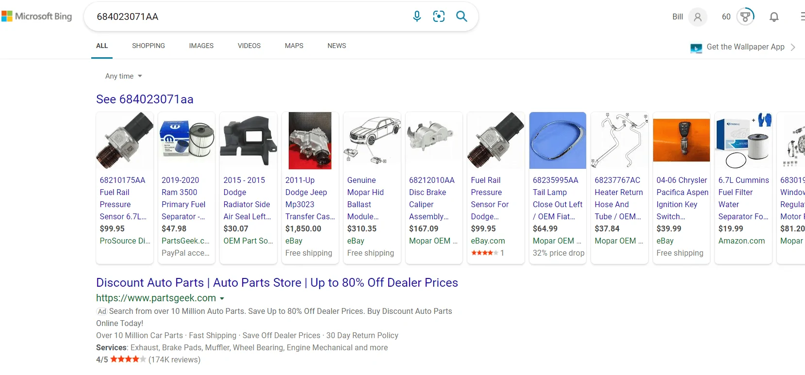

Search Google or Bing or any other for " 684023071AA" and the result is no results. I've had some issues with RA in the past..........
I actually did that before placing my order and it very quickly came up as a 2020 Wrangler listing. Actuality found some 3rd party vendors who list that part number for the sensors on all 2020 and 2021 up until the June cut off.
So why did Google and Bing give you results but come up empty for me?
