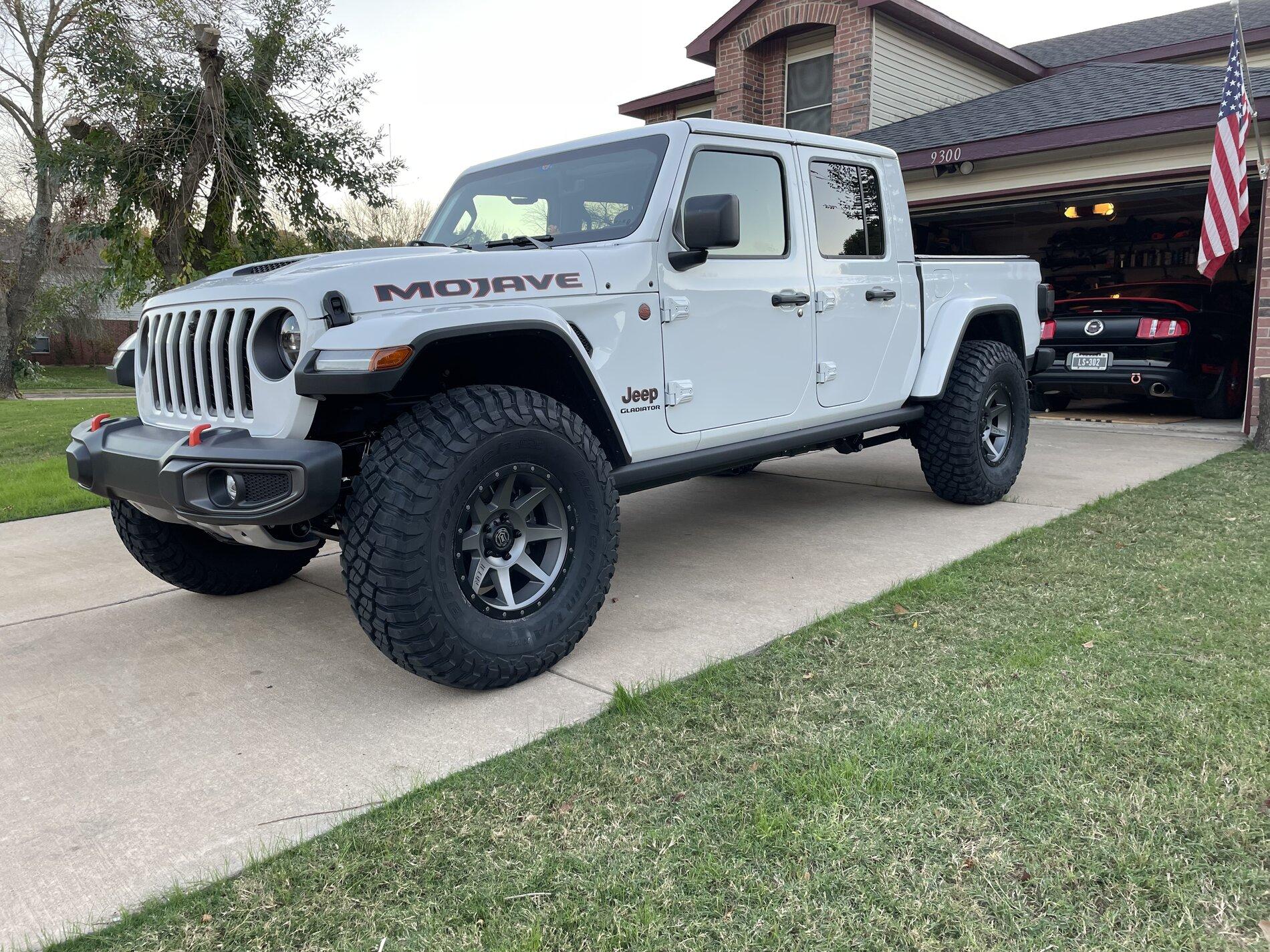

Ok I’m struggling! Looking for direction with keeping the TMPS married to the Jeep. I just installed a new W&T and every time I get them to communicate the only work for an hour or so.
I have a TAZER mini and have set them up per instructions. Looking for suggestions
