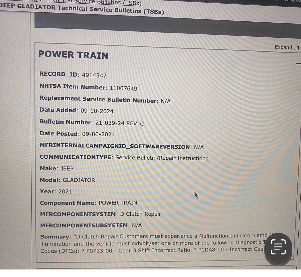

How long will it take to fail and what happens when it does. Is it safe to take on a trip. A clunk in the reverse and the drive clutch is going bad?
JTGuy
Pascual
Jul 23, 2023
1,748
1,680
San Dimas CA
20022 Jeep Gladiator
Manager
I have no MIL lights and it shifts normal. I could try a battery disconnect and ground to perhaps re start the trans learning but I fear the Tazer will also go nuts.
I backed it in last night so I was able to drive it several miles before testing the reverse clunk,,,, very little clunk.
It looks like anything other than a re flash is a very labor intensive project.
