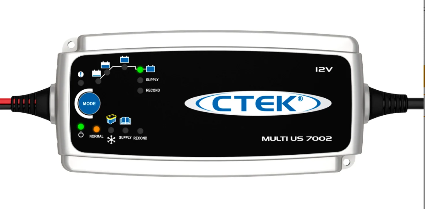

NOCO chargers are fine for generic AGM charging, but they do not follow Odyssey’s charging spec correctly during float/maintenance.
Odyssey AGMs are not normal consumer AGMs. They use thin plate pure lead (TPPL) construction and require a higher charging profile than most chargers provide.
Odyssey’s published spec calls for:
Bulk/absorption: roughly 14.7V
Float/maintenance: about 13.6V minimum, ideally around 13.6–13.8V depending on temperature
Most NOCO Genius chargers drop into a very conservative long-term maintenance voltage, often around 13.2V or lower after the battery reaches full charge. That is intentional for broad compatibility and to reduce overcharge risk across many battery types. The problem is that Odyssey batteries do not like sitting at low float voltage for extended periods.
What happens:
Battery slowly sulfates
Resting voltage gradually declines
Capacity and cranking performance degrade over time
Users think the battery “failed early” when it was actually chronically under-floated
This is why Odyssey themselves historically recommended chargers like CTEK, EnerSys-approved industrial chargers, or other units capable of maintaining the correct float voltage continuously.
CTEK units — especially models with AGM mode — typically maintain a float stage much closer to Odyssey’s required voltage profile. They also use a more appropriate multi-stage algorithm for TPPL batteries.
The result is:
Better long-term state of charge
Less sulfation
Longer service life
Higher resting voltage retention
People confuse “charger says AGM” with “charger is correct for Odyssey TPPL AGM.” Those are not the same thing.
A standard AGM profile:
Works for Optima, Interstate AGM, Duralast AGM, etc.
An Odyssey TPPL profile:
Requires higher absorption and higher sustained float behavior
That distinction matters.
You can still use a NOCO to recharge an Odyssey battery after use. The issue is long-term maintenance/storage charging. If the battery lives on a maintainer for weeks or months, a CTEK is generally the better choice because it actually maintains the voltage Odyssey specifies instead of dropping into an ultra-low standby float.
This is the one I use:
https://www.ctek.com/us/battery-chargers-12v-24v/multi-us-7002
Jeep Gladiator Odyssey Battery Warning 1779298757021-h6
If you have an Odyssey, you put it in the "snowflake" mode which correctly maintains an Odyssey. There is no NOCO that does.

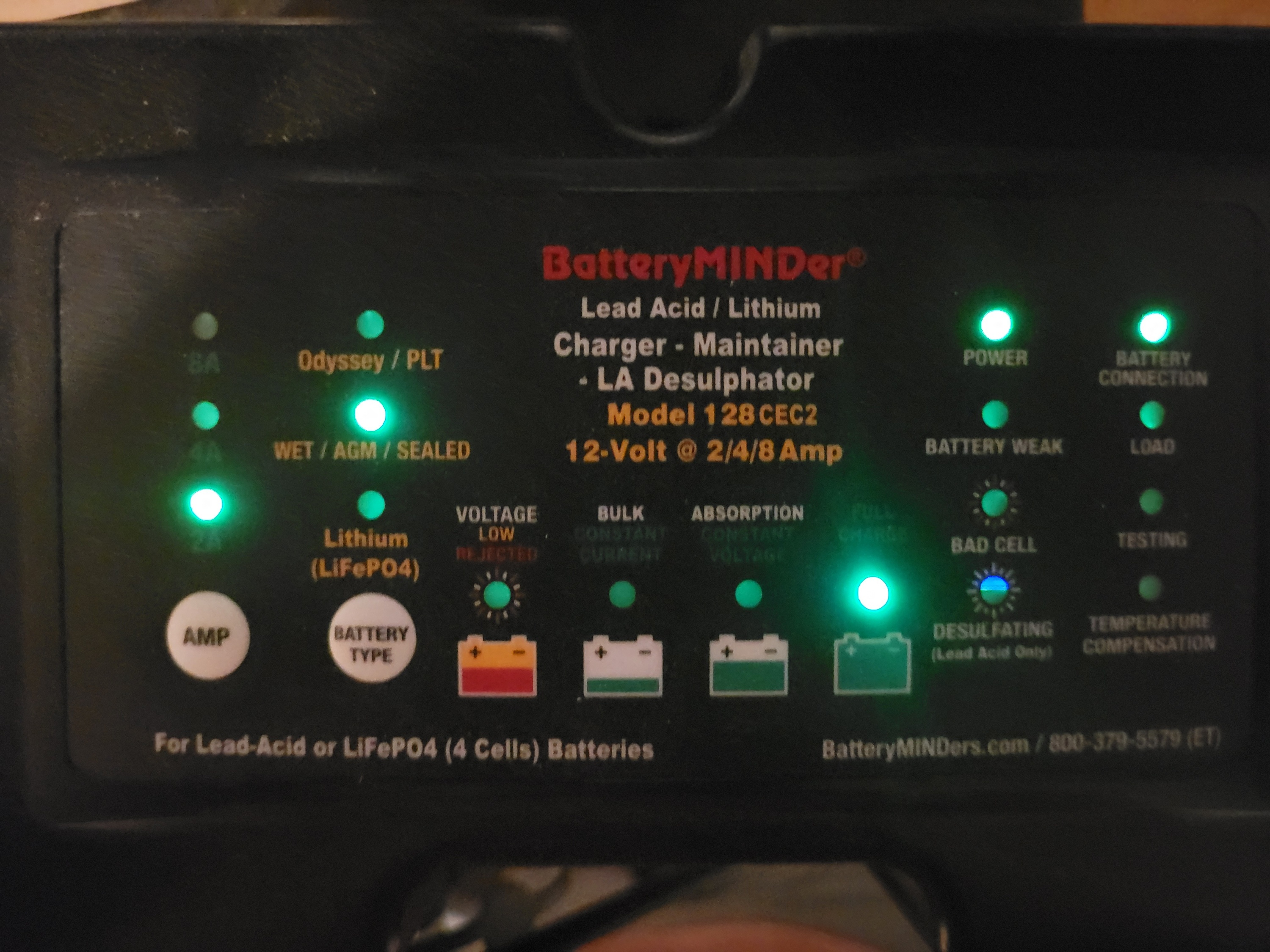

I went out to the garage and took this picture. As you can see, there is an Odyssey calibration. This particular charger/maintainer/desulfator is connected to the OE batteries in the Jeep Gladiator EcoDiesel, so it's currently set for the standard AGM.
Obviously, I'll switch to the Odyssey function when charging, maintaining, and desulfating the Odyssey battery in the 2015 EcoDiesel.

This discussion is has been had many times in this forum and I am too lazy to find the post I made or retype it so I just had AI do it for me
What happens:
The result is:
Less sulfation
Longer service life
