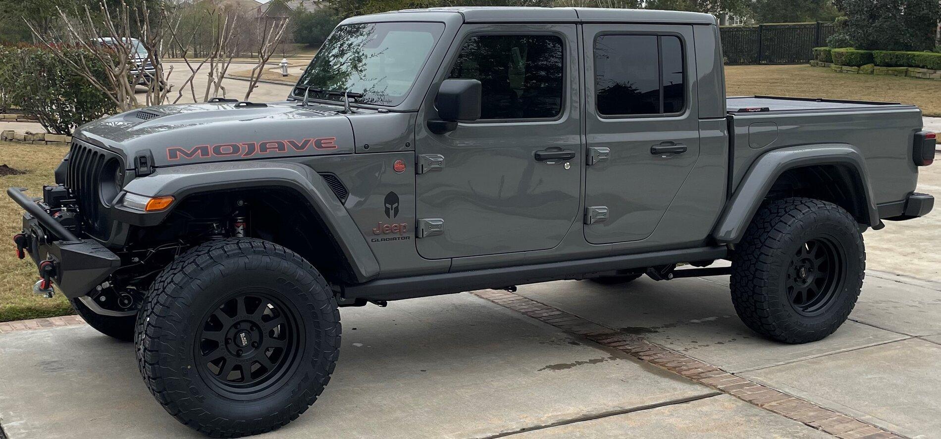

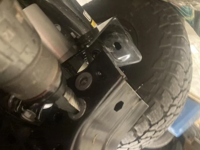

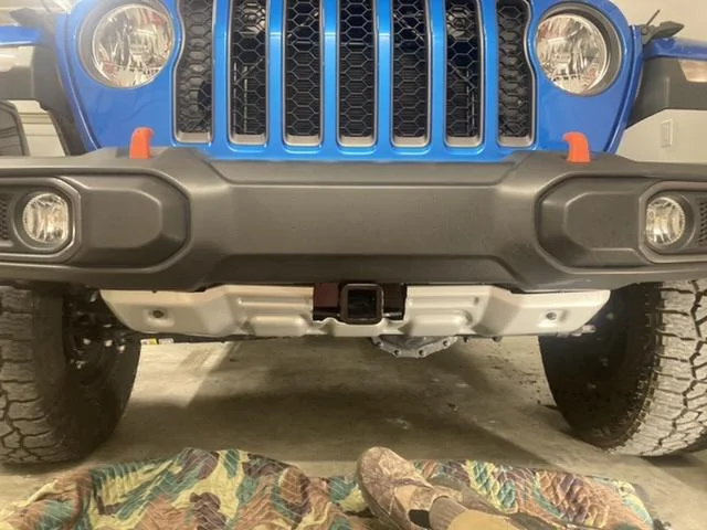

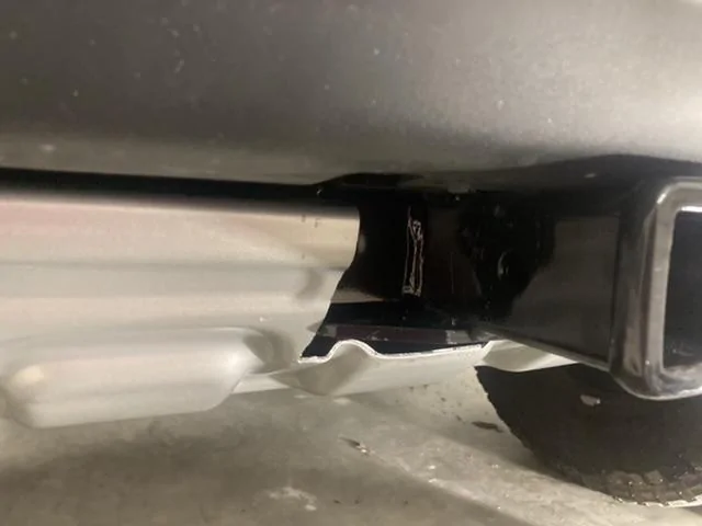

Front receiver hitch from Curt fits on Mojave, had to trim the remote shock bracket and lose a bolt on each bracket. Went on very easy after drilling out the nutsert for the bracket bolt that was eliminated. Had to use a bolt and nut at bottom mount as there is no nutsert where they show one. The skid plate fits but you have to cut out a pretty big square and the hitch is tight up against the bracket, but it can be done, all four skid plate bolts fit.

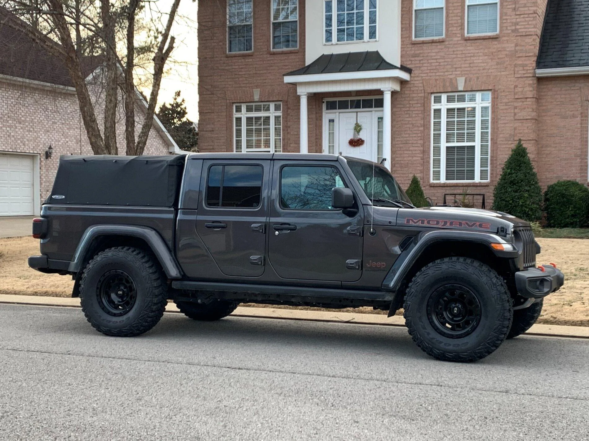

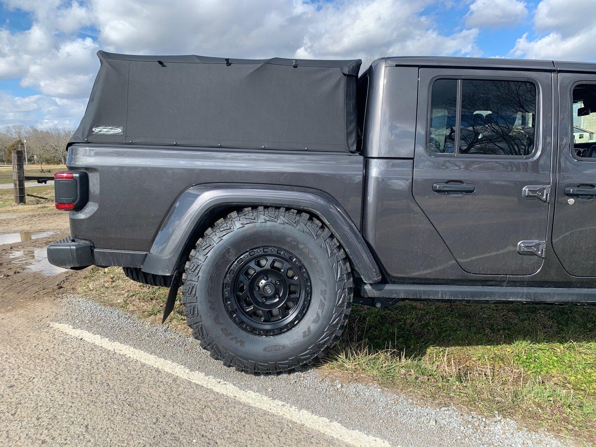

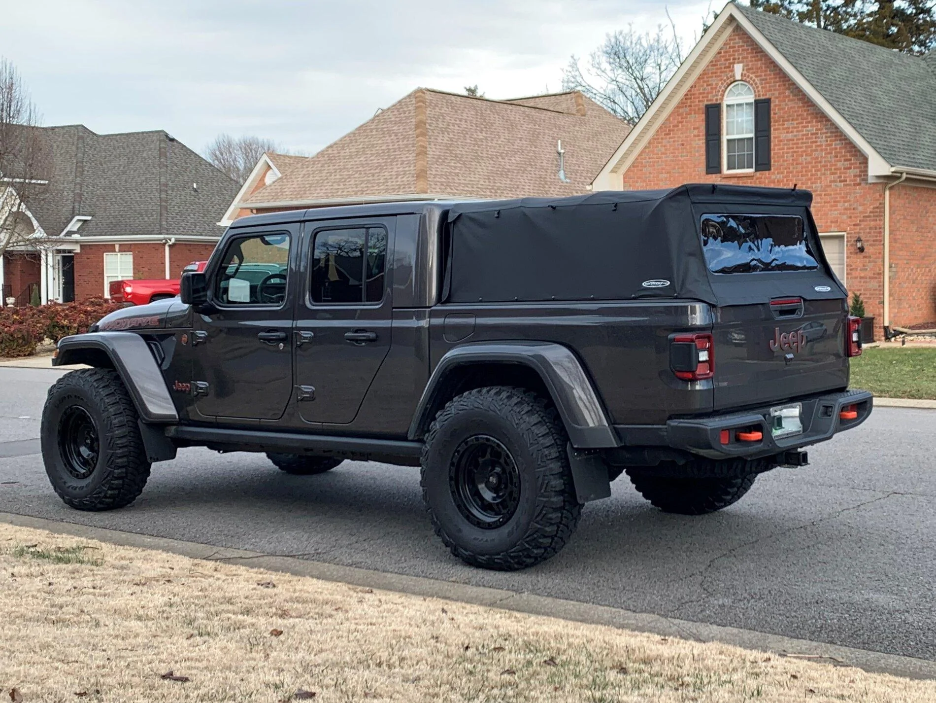

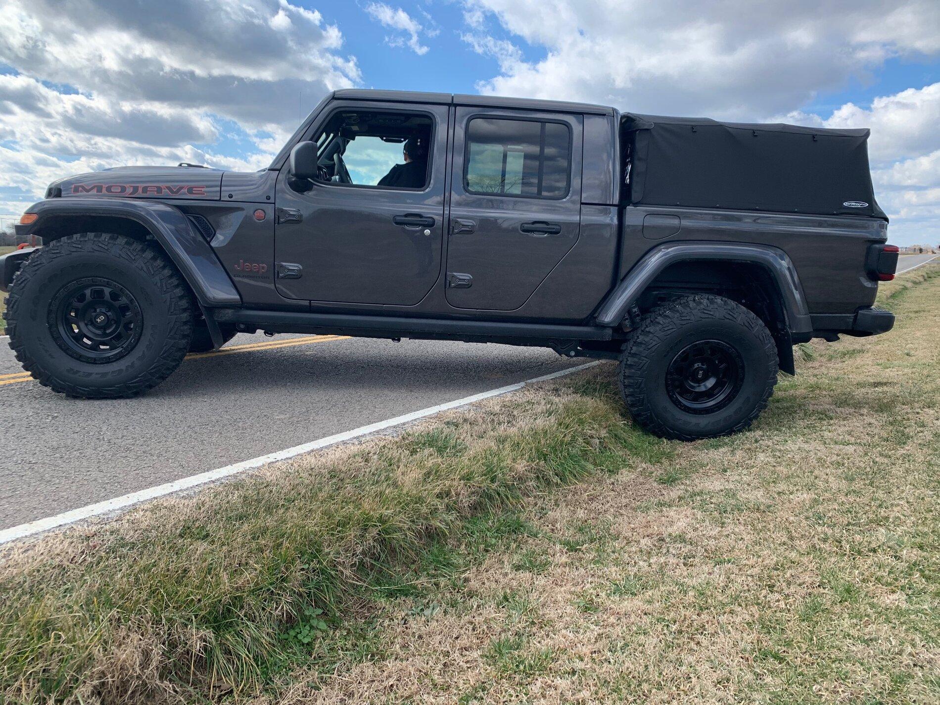

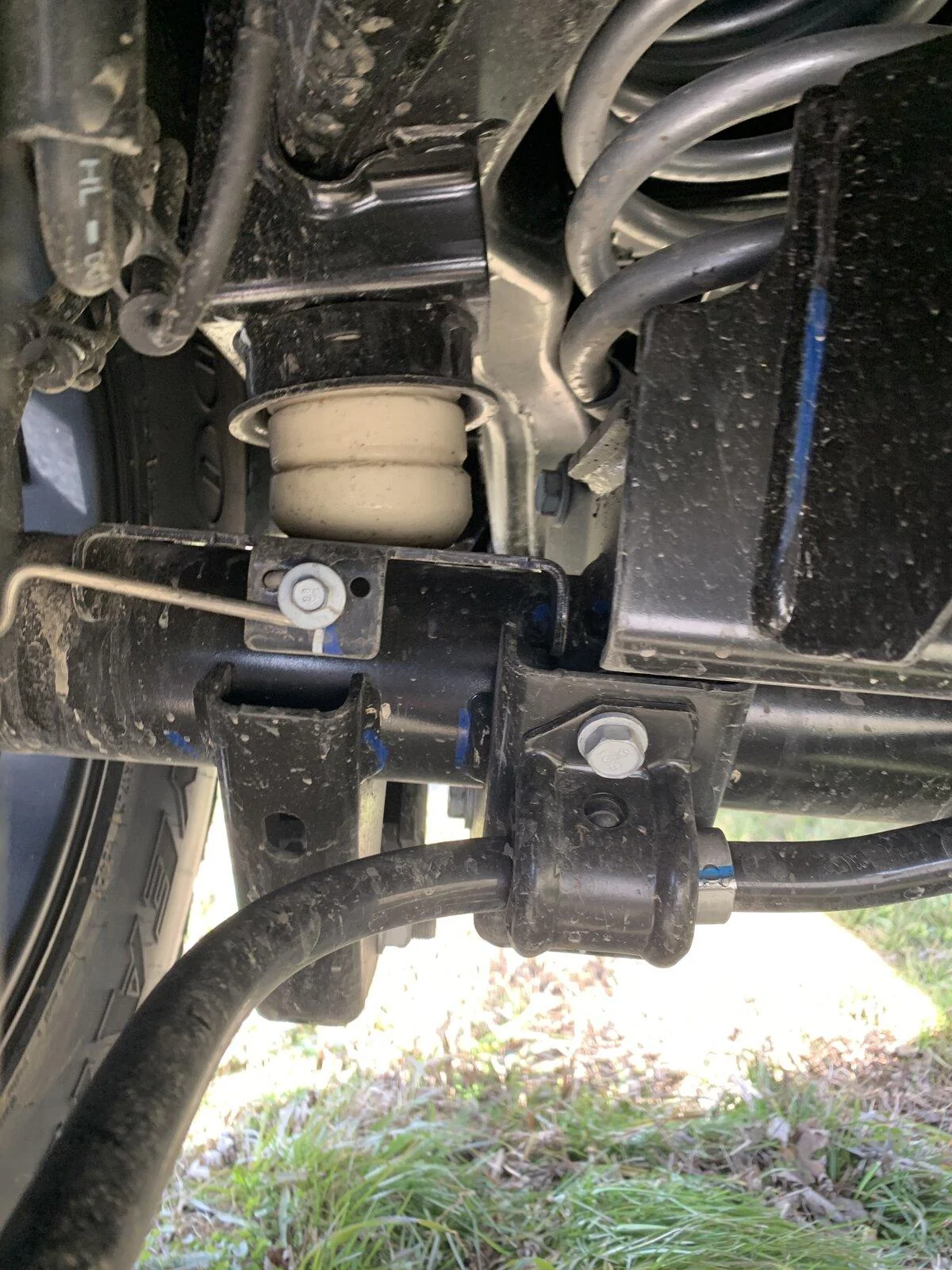

Here is my Mojave. Just did some flex testing today to see how much real off-roading I can do without a lift (on stock suspension).
I already know there is no rubbing whatsoever on street and also no rubbing with minor off-roading. I was pleasantly surprised that rear hits bump stops before it would do any real rear fender damage (if one goes slow).
I plan to do a "proper" 2" spacer lift w/ front lower control arms (to maintain the awesome stock suspension performance & components) one day as time/money allows.

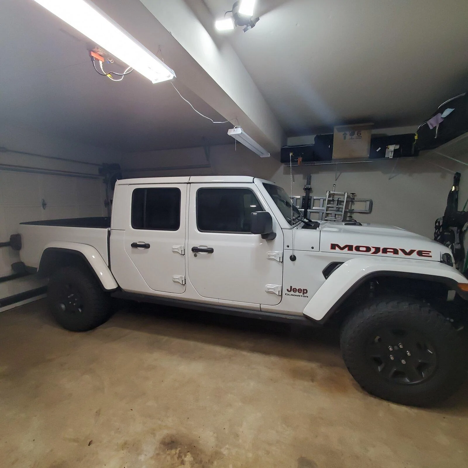

Congratulations! I also have an all white one. You will love it!
What are you planning to modify?

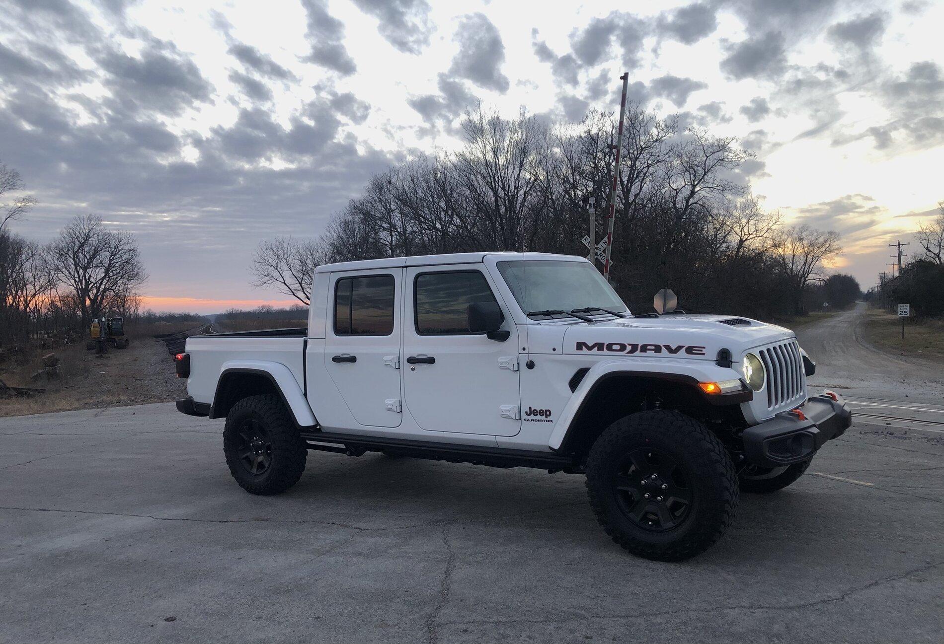

I think I want an ARE topper and maybe some rokblokz as I live on a gravel road.
Sweet! Ordered the Rokblokz in XL/Original black with orange logos. They should arrive tomorrow.
I am not on a gravel road but these pick up tons of dirt and sling it on the car. It's hard to keep the white paint looking good without them.

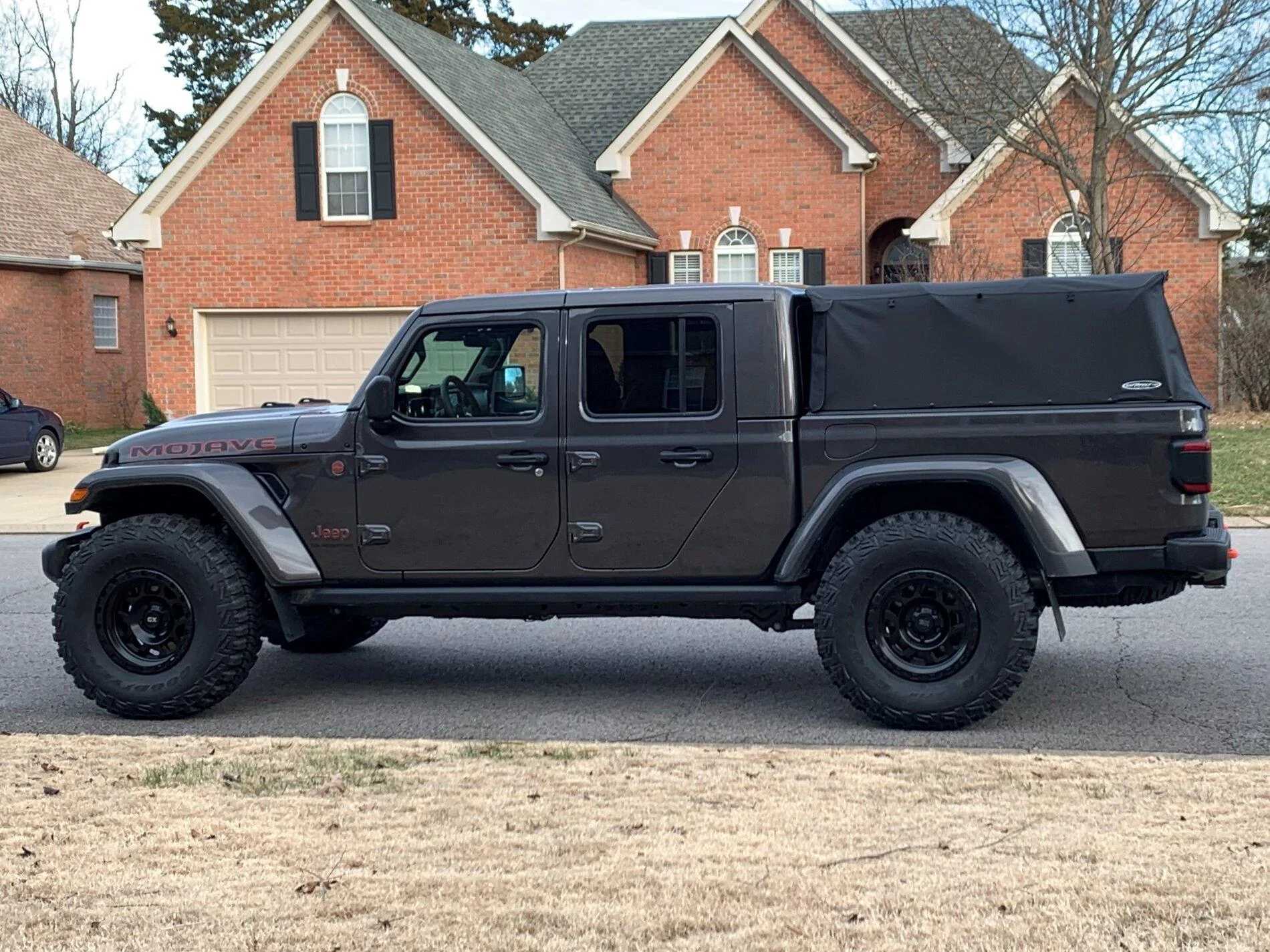

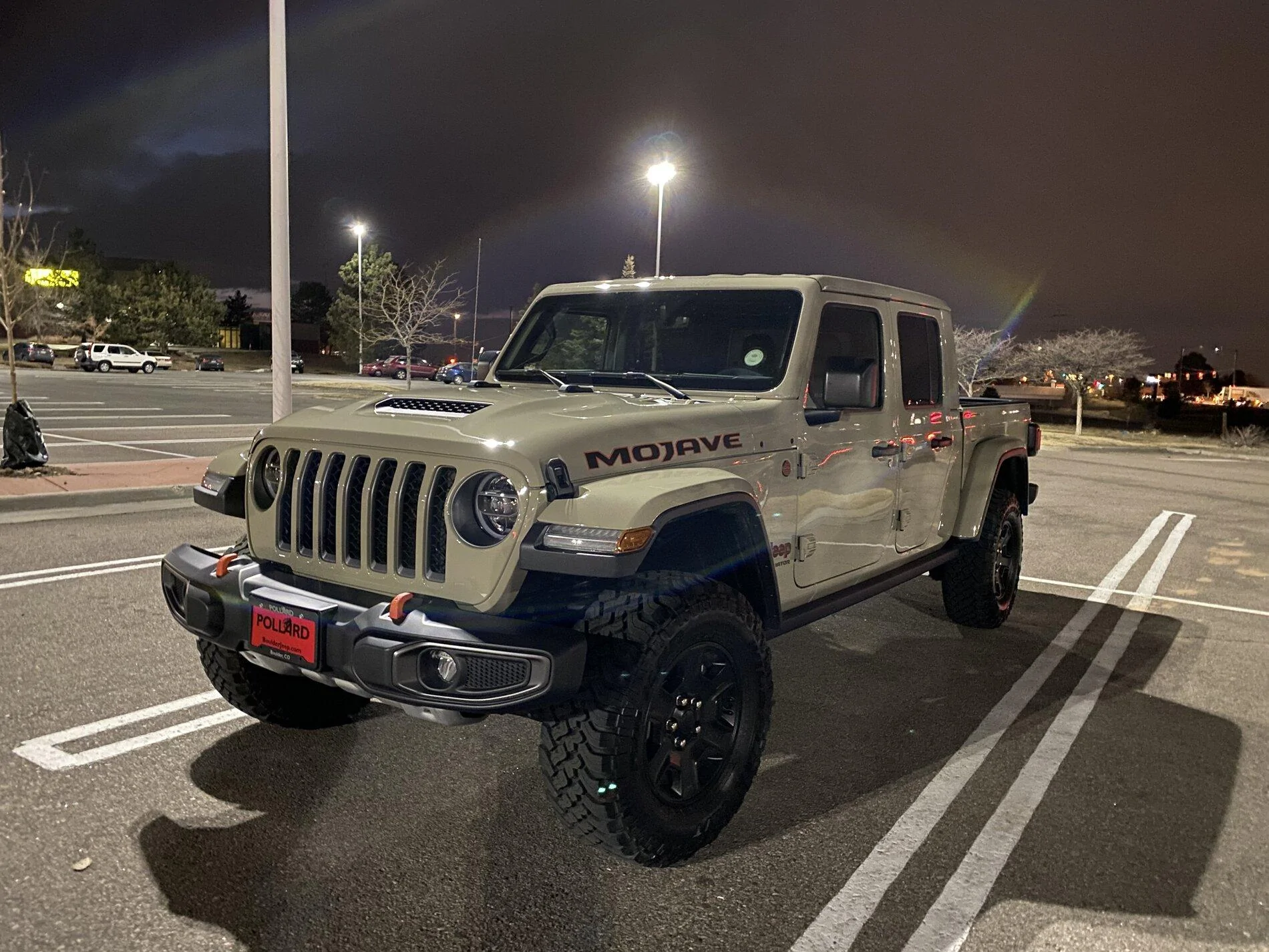

Looks Good, have the same color coming, only black fenders and top. What wheels and tire setup you running? Thanks.
Hey there, thanks! They are 18in Black Rhino Stadiums with Toyo Open Country AT 35's
