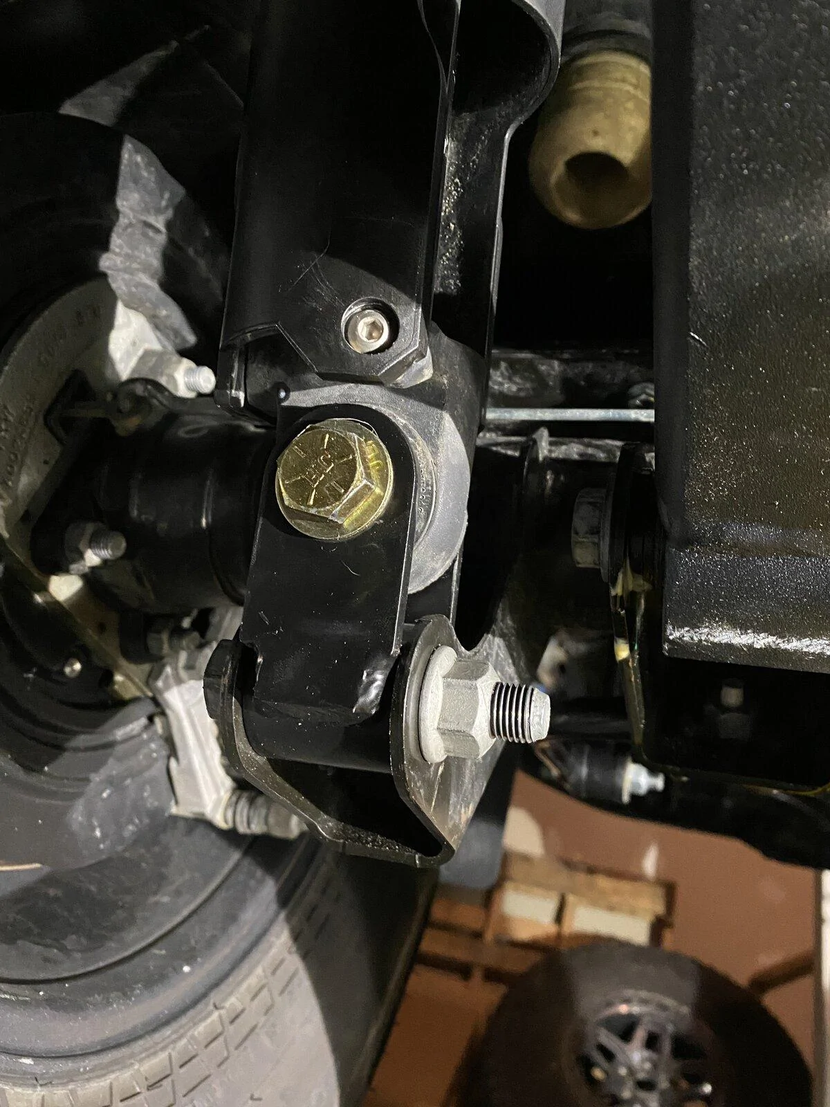

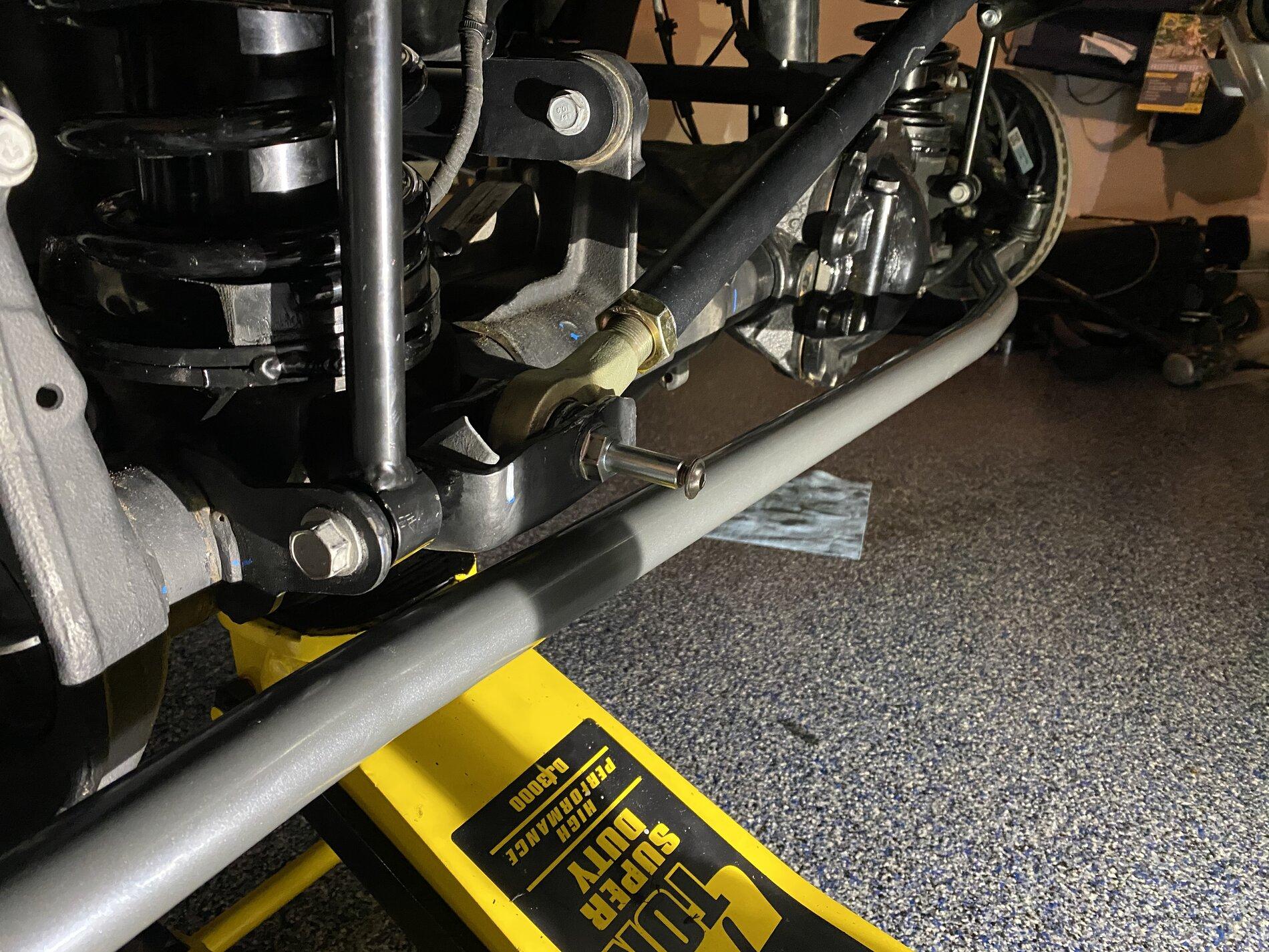

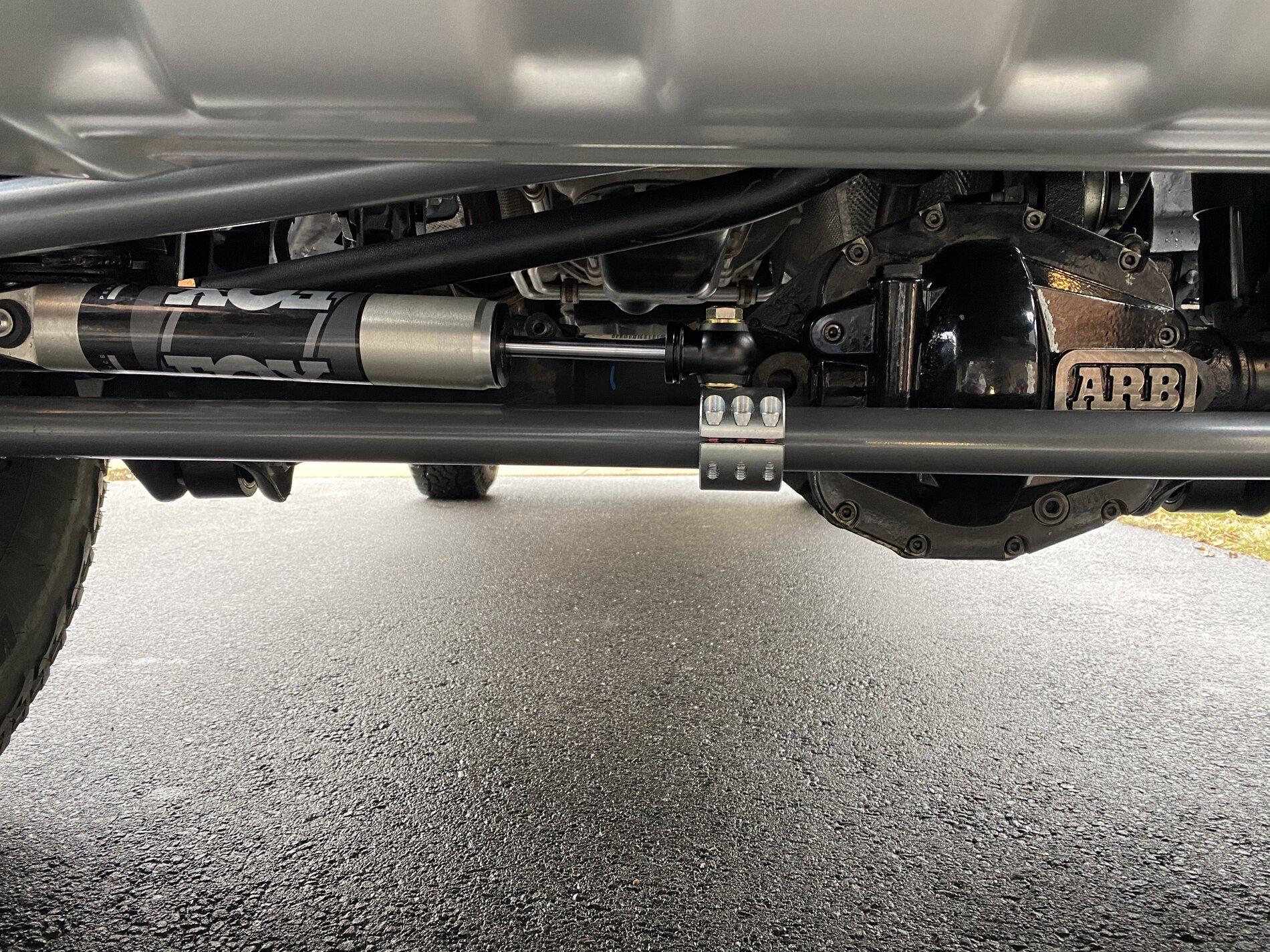

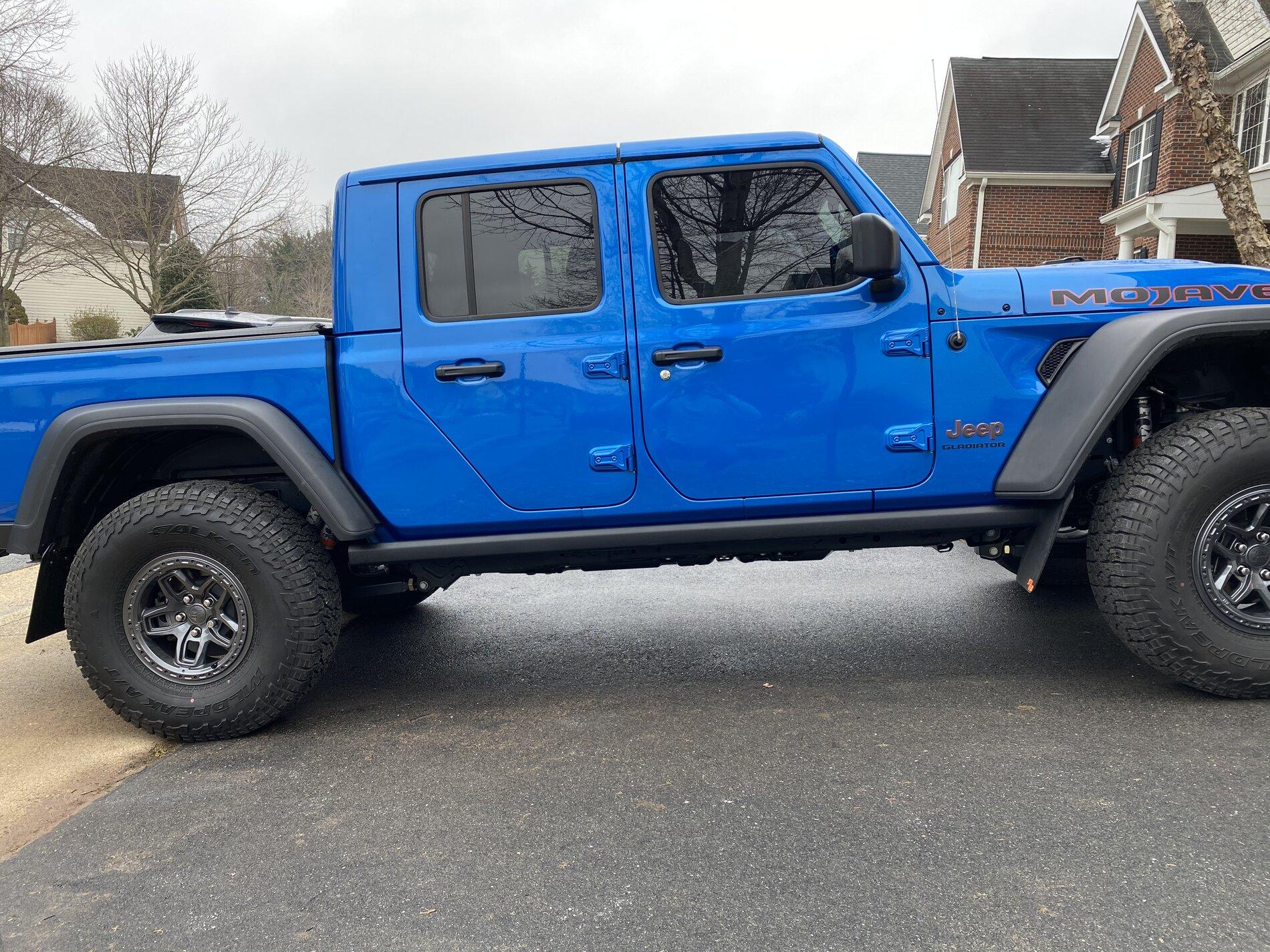

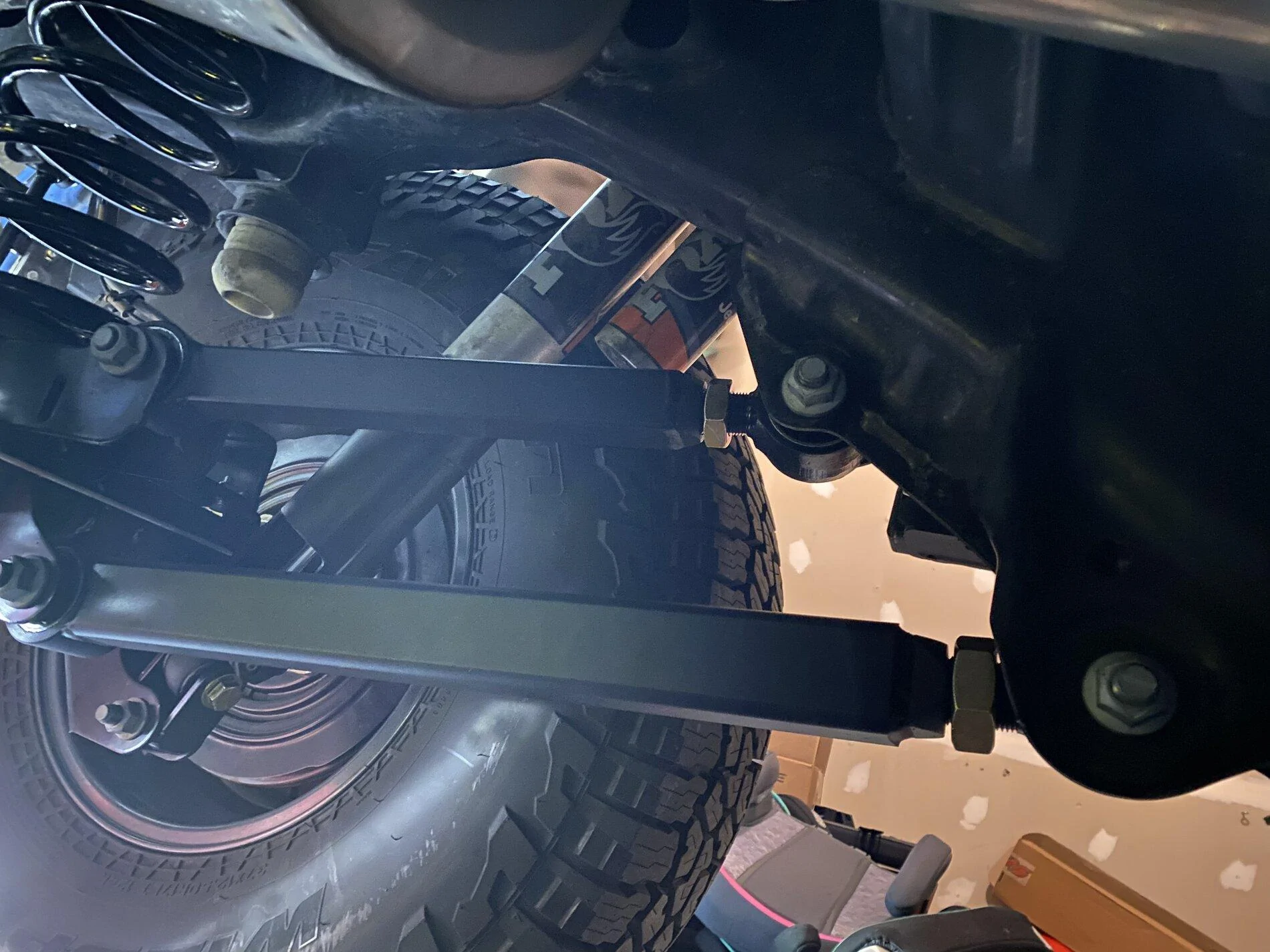

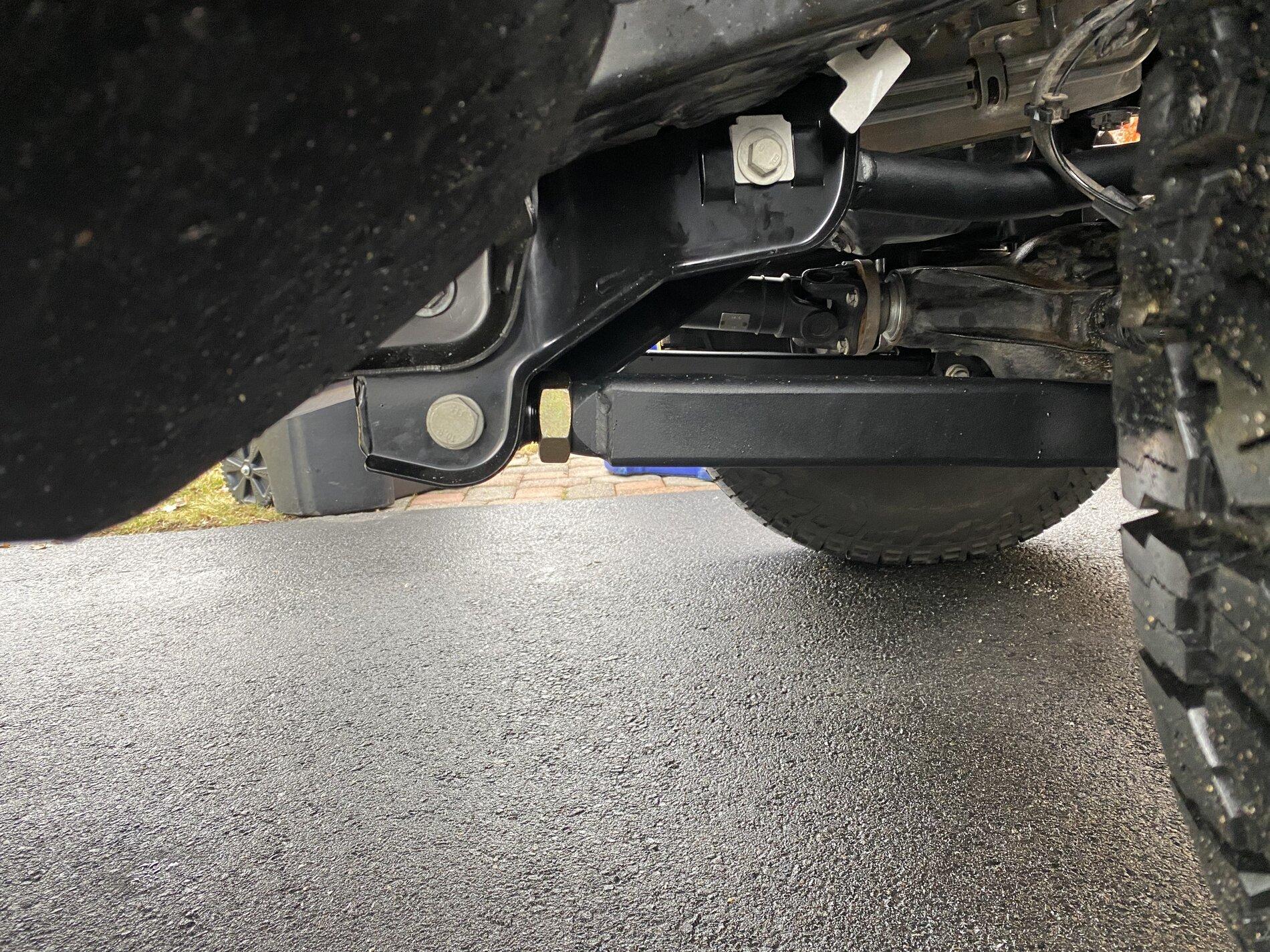

Well Kurt and Son and Buddy, we are waiting for the pictures and set of pants drive test review!

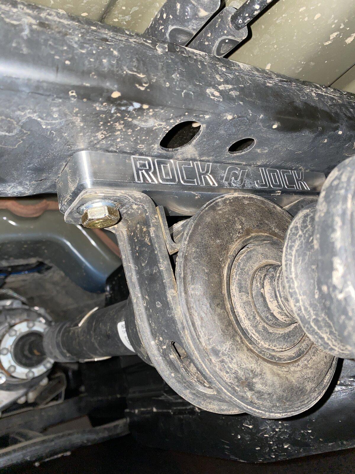

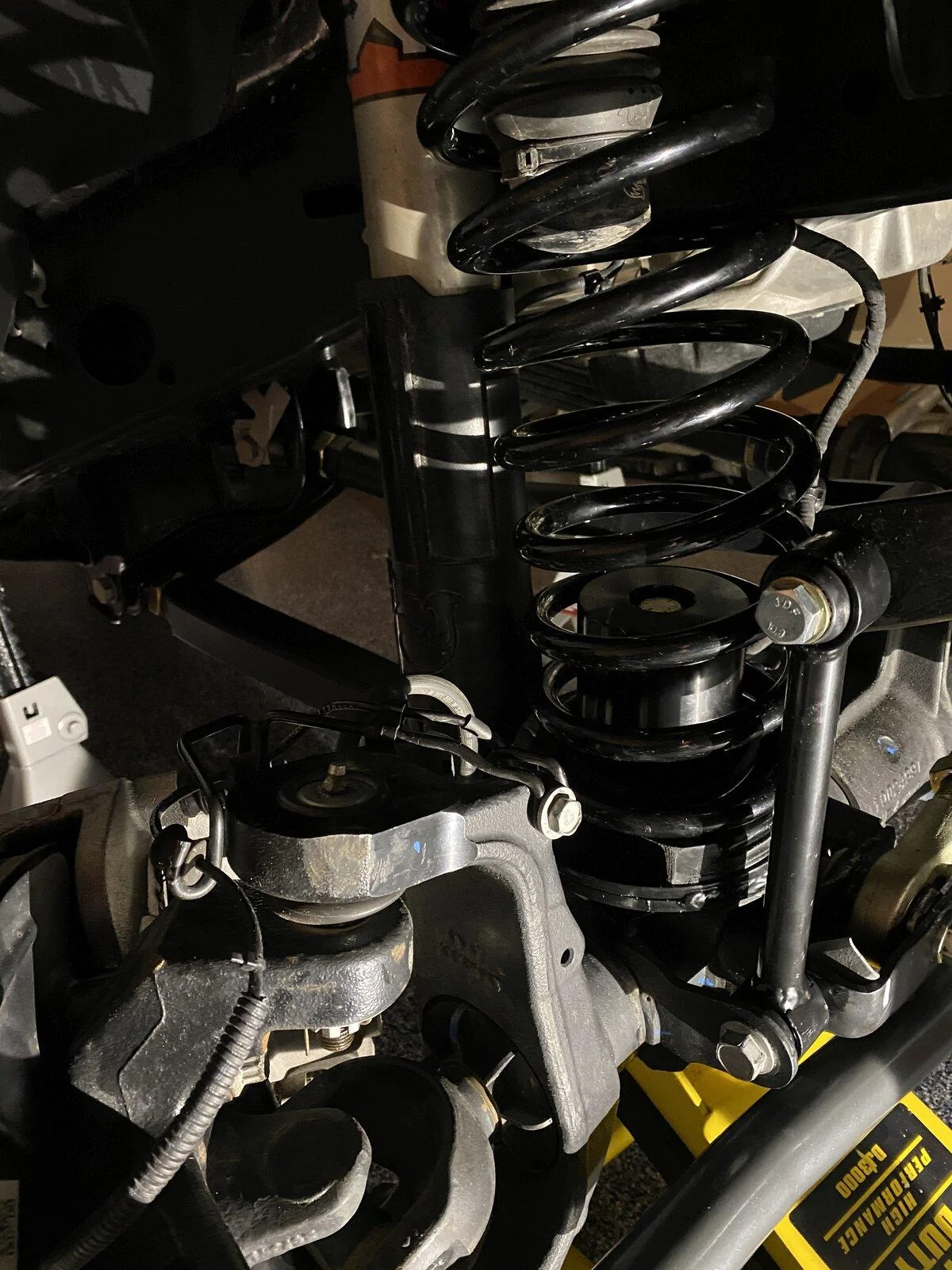

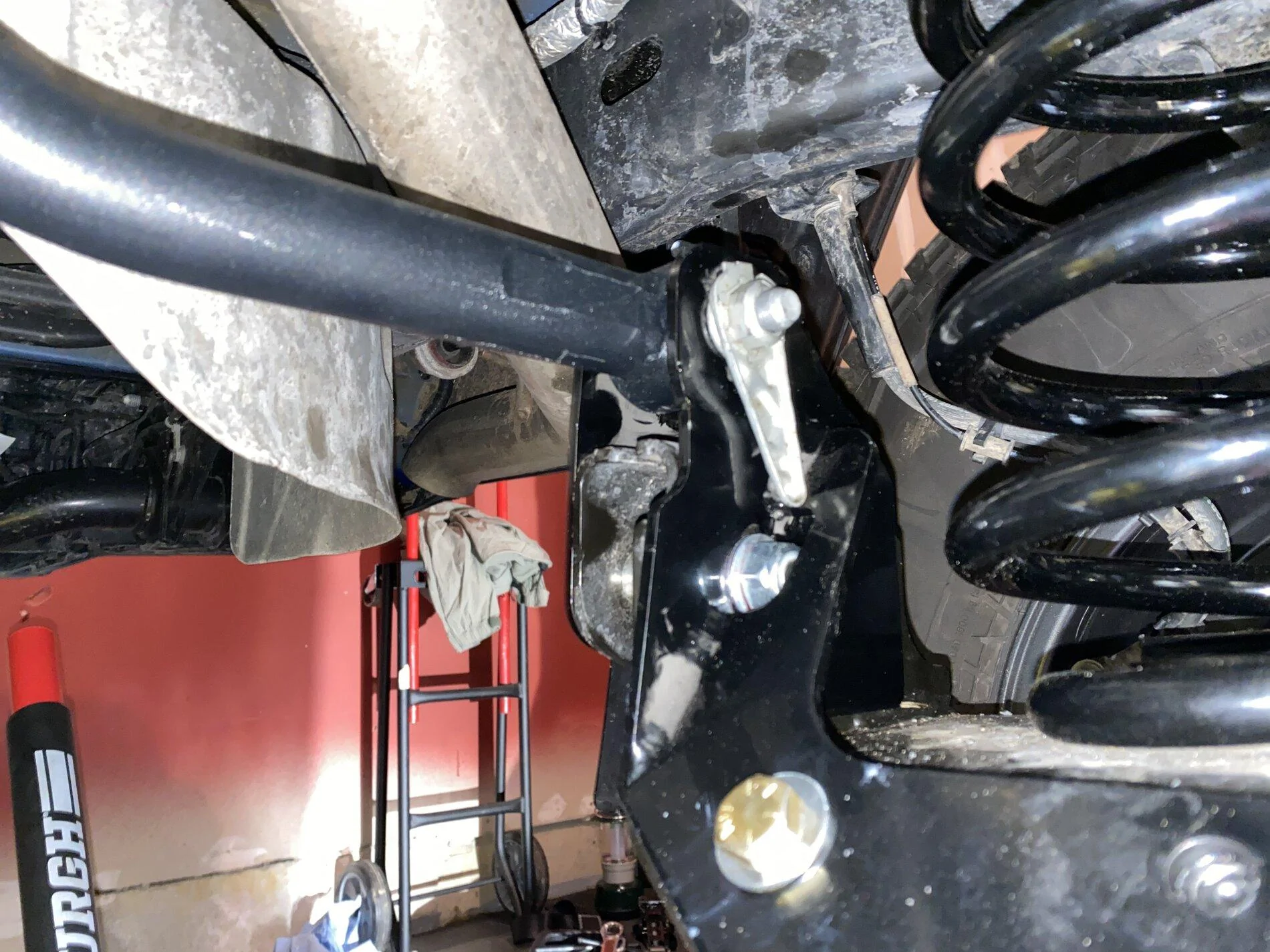

Its been one issues after another. Theres been tons of “oh and by the way, this needs to be modified”
So far:
Teraflex Track bar relocation bracket didnt work with the rest of the set up and had to be tossed. Synergy TBRB is on order. Wont be able to drill out to do drag link flip until this new bracket comes. Rear spacers didnt show up up time, so part of the rear will have to be redone.
Its also been one thing after a fucking nother of “oh by the way; these 10 things have to be modified too....” and the fabtech instructions are literally one step better than “open box. Remove parts. Install lift.”
We have in:
-drive shaft carrier bearing drop
-springs and seats
-shock extensions
-Clayton control arms front/rear upper/lower
-bump stop extensions
-brake line relocations
-sway links
-Rear track bar relocation bracket
-adjustable rear track bar
-front adjustable track bar
-caster roughed in
-pinion angles roughed in
-wheels centered in wheel wells
Whats left for tomorrow:
-center front axle left/right
-set and adjust tie rod
-set and adjust drag link
And so far? The truck looks fucking TOUGH.
