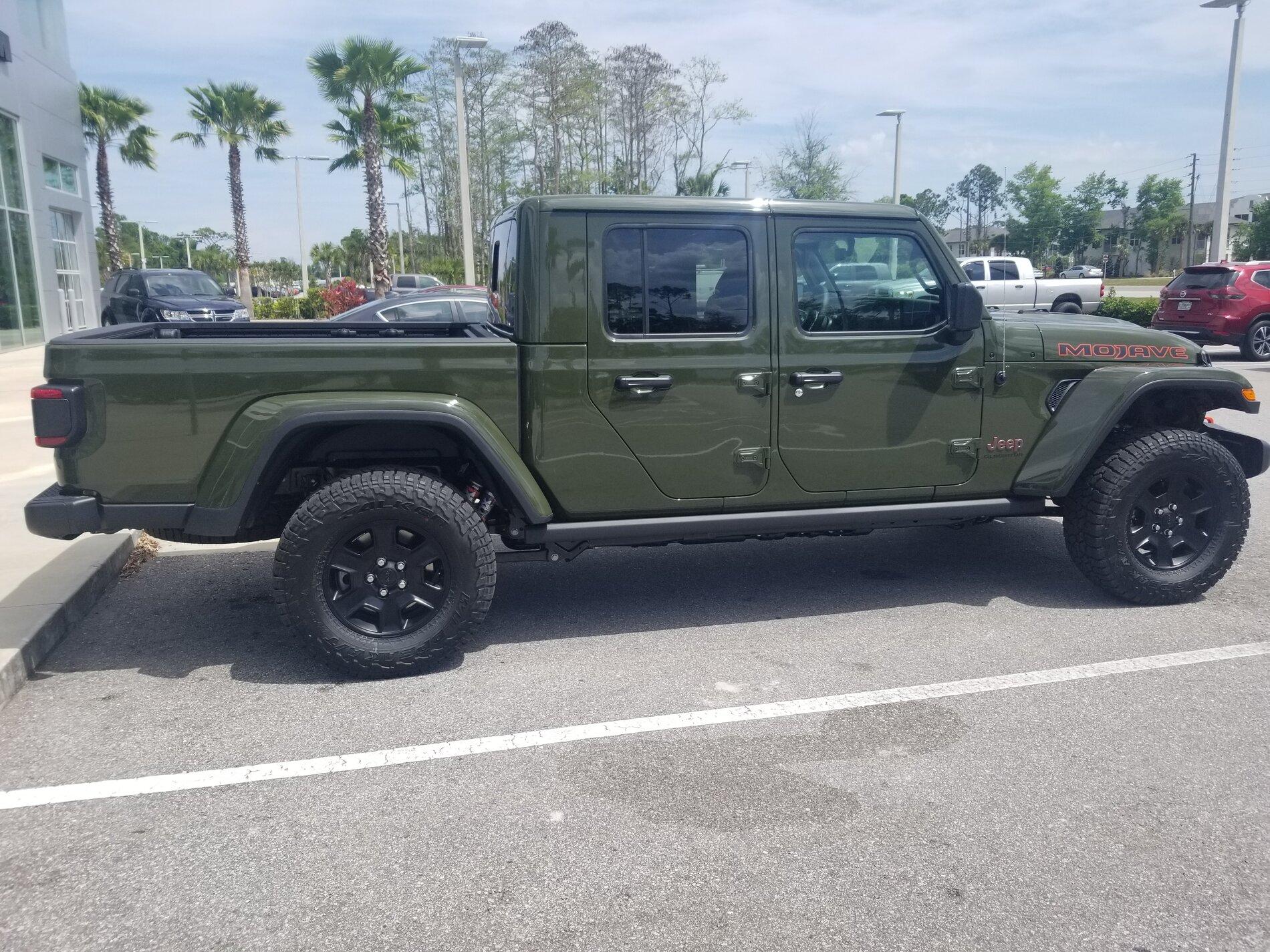

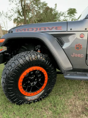

Here is a 17x8.5 with 12mm offset wheel. Tire is 35x12.5x17 No problem!
Jeep Gladiator ***Official Mojave Thread*** Lets talk Mojaves New Wheels frt qtr panel

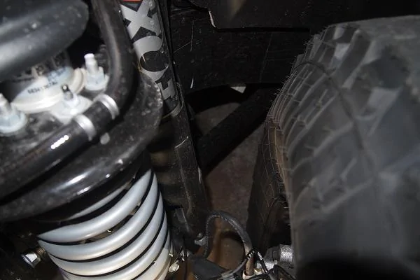

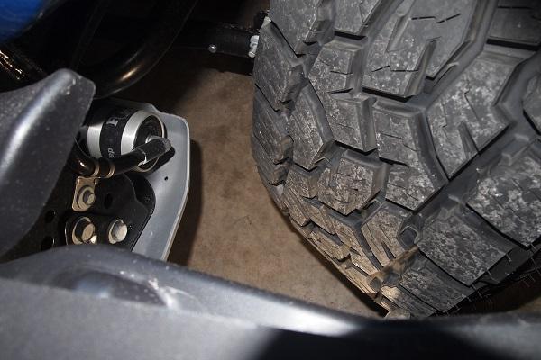

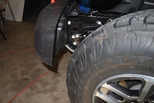

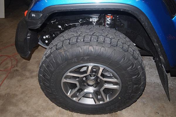

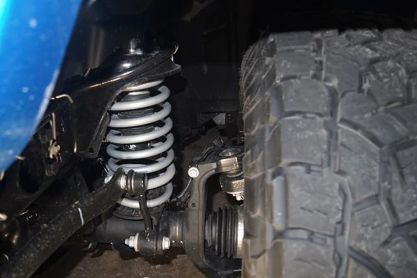

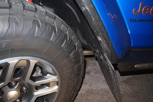

The Mopar Gear Wheel (77072471AB) you are looking at shares the exact same dimensions as the Mopar Offroad Wheel (77072494AB) pictured here on my stock height 2021 Mojave. The only difference between the two wheels is the styling of the spokes.
As you will see in these pictures, there is absolutely no reason to add any spacers to mount these wheels even with a 35" tire.
The first two pics show the wheel in the straight ahead position. As you can see, the spring tower is a long way from the inner sidewall of the tire, so is no clearance issue
at all.

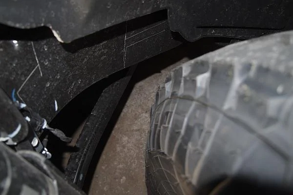

The next three show the clearances at the front of the tire with the wheel turned all the way to the right.

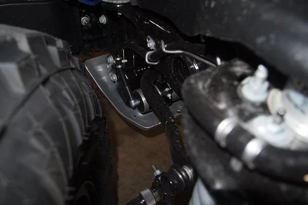

And the last three show the clearances at the rear of the tire with the wheel turned all the way to the left.
Again, these pictures show the Mopar wheels with Toyo 285/75R/17 Open Country A/T3 tires mounted & measure 33.8" dia./11.3" max width inflated.
If you go with a 35X12.5X17 tire having a 34.5" dia. and 12.5" width, the clearances shown in these pix will only be reduced by approx. 3/8" for the diameter, and approx. 5/8" in the width.
Even if you go to a 315/70R/17 which has a 34.4" dia. & width of 12.7", the diameter will be reduced by just under 3/8", & width would only be reduced by approx. 3/4".
For a full side view of the truck with these wheels, check out post #477 on page 32 of this thread.
Hope some of this is a help.
