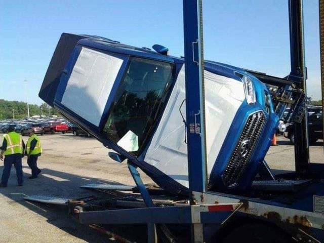

Whoa. That’s single stage. I worked in the car biz for years and it’s alarming how many vehicles get damaged in transit and it’s never disclosed to the customer or often even the dealership. I’m sorry that you’re dealing with this. I hope it’s isolated to a small area and easily addressed.
Like this?
