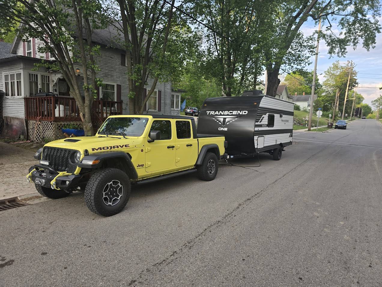

Have put about 3000 miles on my Mojave towing a similar weight camper.
0-20 factory recommended oil changed every 10k at the dealer.
Oil temps get up to ~240 uphill trying to maintain 65, which I can't necessarily do all the time, or won't put my Jeep through.
Jeep has 37,000 miles on it now. Will have my dog update when I die from not playing oil scientist.
