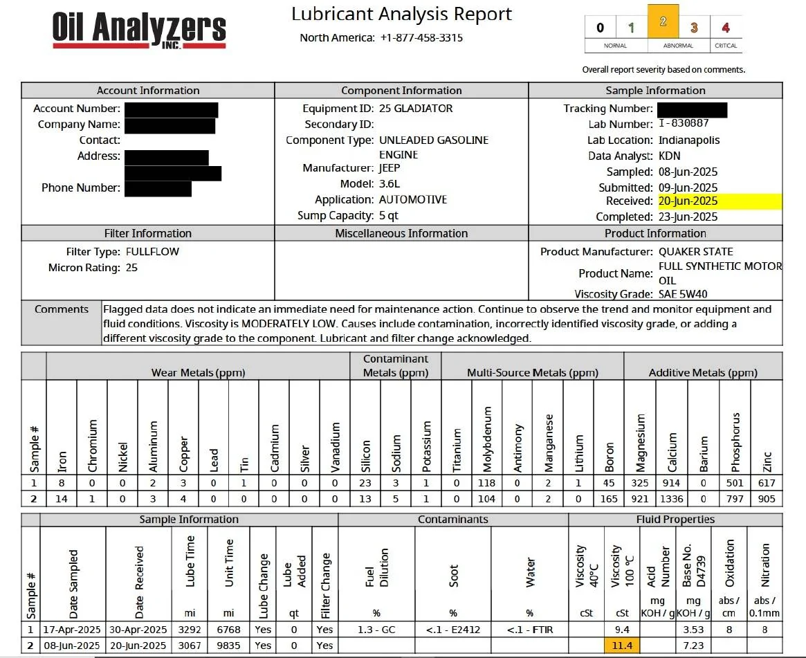

Second oil analysis showed up in my email inbox this morning. This was a run of Quaker State Full Synthetic 5W-40 Euro oil for about 3K miles. Oil viscosity was flagged for being slightly out of grade as that was not unexpected given I did use about 0.5 quarts of Valvoline 10W-30 for top off due to the slight extra capacity of using can oil filter and my Baxter Performance adapter. Still was a high ranger 30W grade.
Tick increase in Iron, Aluminum and Cooper from the previous sample but still well within expected universal averages. Silicone has dropped even more which is a good sign most if not all of manufacturing debris has flushed out.
Replaced with 4 quarts of Chevron Delo XSP 5W-40 & 1.5 quarts of Valvoline 10W-30 and a Purolator Tech TL12222 oil filter.
Jeep Gladiator 2025 Gladiator 3.6L Oil Analysis 25-Gladiator Oil Analysis

Curious as to the mix of 5W-40 and 10W-30? Just topping off with what you have on hand? Also, why 5W instead of 0W?
I use a Baxter Performance oil filter adapter and the filters I use add about 1/2 quart to capacity. When I put in the Quaker State Euro 5W-40, that was a 5 quart jug and the replacement Delo 5W-40 was a 1 gallon jug and remaining makeup oil was the Valvoline 10W-30 I have in 3 gallon box/bag. While I do try to make a reasonable effort to not mix oils, I am not adverse to it.
As to the 5W vs. 0W, I use what I have on hand. I buy my oils on sale and sometime grade selection available is narrow.
May have mentioned it in this thread or maybe elsewhere but I am not putting myself out there as an example to follow or defending what I am doing is ideal. Just sharing the data point for others to make their own decisions.

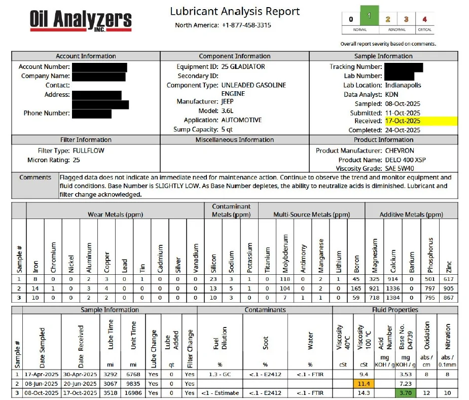

Third oil analysis came back using Chevron Delo XSP 400 5W-40 for 3,518 miles. Wear metals Iron, Chromium, Aluminum and Copper all dropped. Base Number was a tick low but considered acceptable. Happy to see fuel dilution down from the first sample.
Used a Precision Parts PPG2500 oil filter. Cut open can be see at the link:
https://bobistheoilguy.com/forums/t...pg2500-premium-guard-cut-open-10-8-25.400528/
Replaced with Castol Edge 0W-40 and a FRAM DRIVE FD10575 oil filter used with a Baxter Performance adapter.
Jeep Gladiator 2025 Gladiator 3.6L Oil Analysis 25-GLADIATOR-10-8-25_Redacted

250
40,624
54,314
Iron down very nicely. Looks like a good number there, IMO
