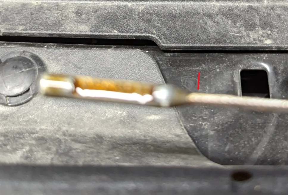

Question for you on that............... 5 quarts, and that is an exact 5 quarts minus what won't drain out of a jug, puts my oil OVER full on the dipstick. It has done that on every JT I've had - 5 quarts means over the aluminum bit onto the cable itself, by at least 1/8" or more.
If you put in the 5 quarts, and an extra half quart (since these call for 5, and you say it adds an extra half quart capacity) where does it end up on your 3.6's dipstick?
Stock, 5 quarts after waiting 5-10 minutes, level is at the top of the cross hatch section barely kissing the upper bulb part.
With the Baxter Performance oil filter adapter, 5 quarts lands right middle of the cross hatch section. With the recommended compatible size can filter, an extra 1/2 quart brings it right back to the top of the cross hatch section.
My drain time is also probably 30-45 minutes before I close it for refill.
