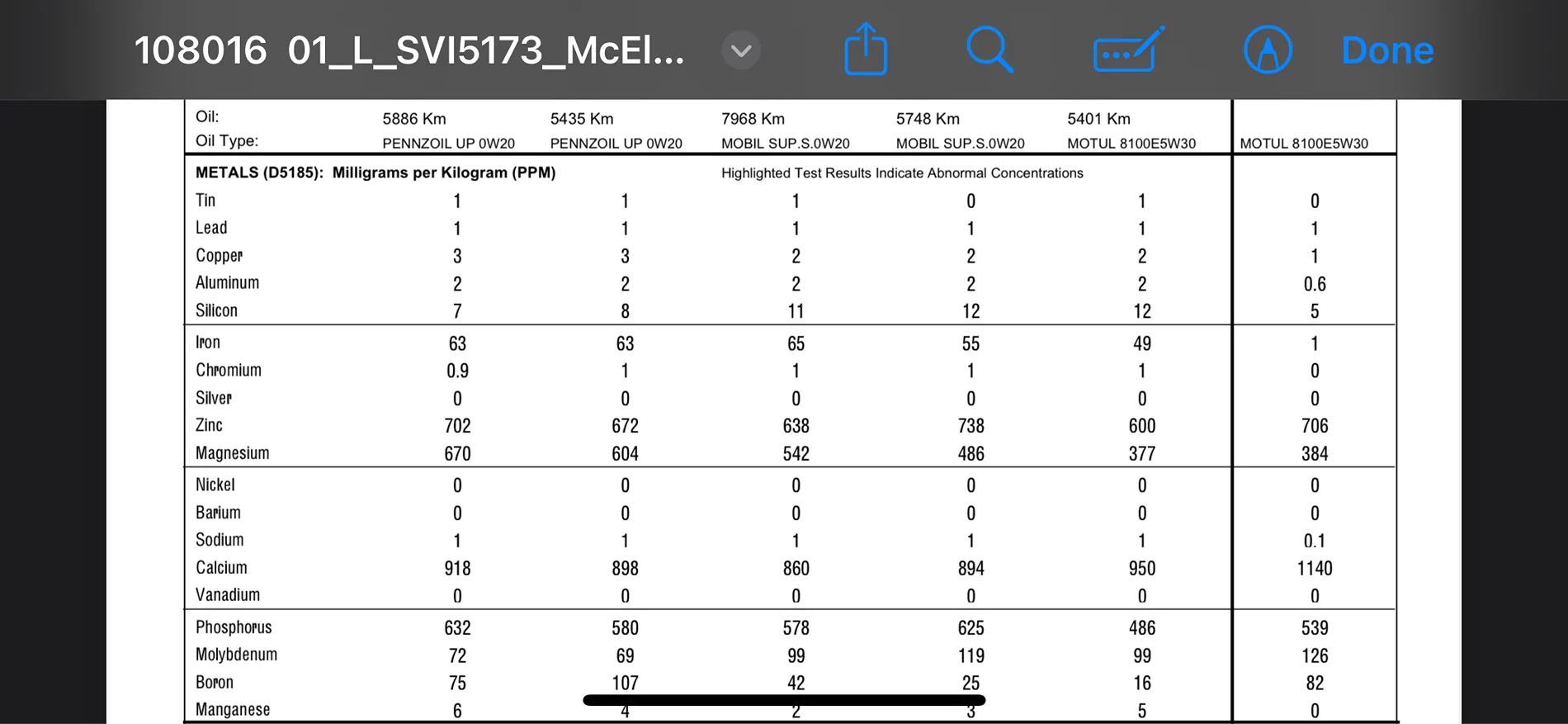

Had a look at my first silicon levels for both engines.
#1 90 + coolant detected
#2 47 (but had over double the oil) so maybe would have read 94 ? After all this time and 131k kms (80k miles) silicon reads 7
(and yes, I use a K&N filter, @ShadowsPapa favourite 🫣💥😉)
How many miles was on that oil sample? That's the real tell - not how much was in there, but how much per thousand miles.
So if you had 7 after say, 3,000 miles, and I have 12 after 7,100 miles, I have a lot less silicon than you, meaning that number is higher than mine per thousand miles, so I'm better off with 12 than your 7.
Ya, you’d be doing better by a few points. Your math is right. So I guess it’s good I’m doing earlier changes and keeping the numbers lower than running longer and my numbers surpassing you.
I don’t think a higher number that’s run longer is better than a lower number run shorter. I still have less contaminated oil than you when it gets changed. But it may be interesting to just go swap out for a paper OE filter to see what happens

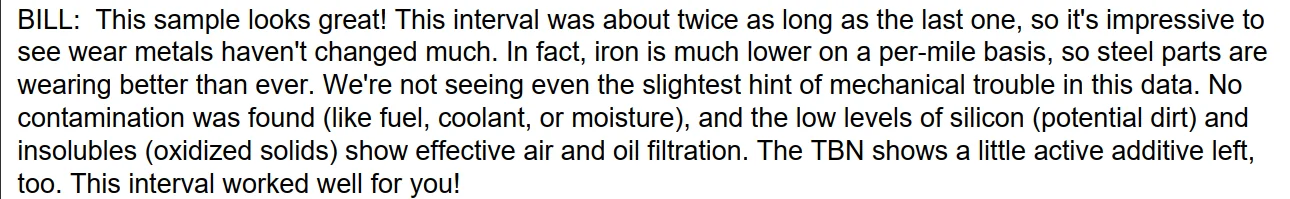

It's contamination per thousand that matters - even by the lab comments.
If you are getting more per thousand miles than I am, then my report is actually better. That's one reason they want to know how many miles are on a sample, to break it down.
If my silicon numbers were higher per thousand miles, then my engine isn't doing as well but it's lower per thousand than yours, meaning potentially less dirt pulled in for every thousand miles driven (although that's NOT the only source of silicon in modern engines, it's an indicator of filtration i general).
So yes, if mine at 7,158 miles showed more silicon than yours at 3,000 or 3,5000 - as long as mine isn't double your number, then mine is actually lower at 3,000 miles than yours.

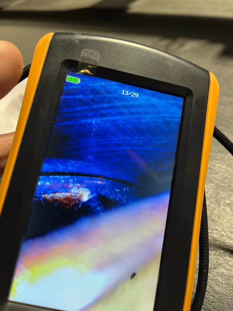

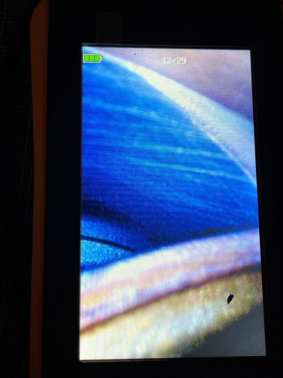

@ShadowsPapa, let’s examine for a moment some facts and let’s make a best guess from that. Firstly, I’ve always run K&N since high school and have maintained them through proper cleaning, drying and oiling. This engine has had it from day one.
Let’s take your argument that my filter is letting in more abrasives than your paper filter. Let’s even agree on it.
The first rubbing in and grinding of this abrasive material is going to hit the rings first, right? What material are the rings made of and what material are the cylinder walls made of? Would this reflect in the numbers you see in my report posted above?
If my numbers are so high because of this abrasion taking place in my cylinders, should I see cross hatch on my cylinder walls?
There are so many ways or reasons our numbers will vary from each other - don't second guess yourself. I suspect your OCD-like habits may make up for any product shortcomings, or you negate them in your own methods. It's working, don't mix it up now.
Low tension rings are going to leave cross-hatch patterns clear into the 100,000 mile range, even higher.
As far as "should I see"............ yeah, very possible. And maybe the oil is doing a good job, it matters.
You aren't in any danger zone - higher than mine per mile doesn't mean bad, just different. Maybe there's other factors, like the oil used. Don't sweat it.
Your numbers are good and don't worry because someone comes up with some that are "better". (for one thing, mine are 'better', but not astronomically better, nothing to brag about, just that I'm in really great shape in that sample.)
Time for another sample as I just went through harvest season here, and I want to get a new baseline before snow plow season, or even colder weather sets in.
Keep up the OCD on your air filter, make danged sure it SEALS (a mistake too often made) and don't sweat it, don't dwell on it. This may be your good luck engine. The one that breaks your losing streak.
