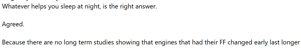

BITOG has almost daily discussions on the topic and the consensus is - there is no consensus other than it's a "coveted" thing, you are one of the elite if you do the early dump as they call it while others are on 300,000 miles doing it by the book.
So, whatever makes you feel good is the right answer. There's no evidence supporting either method, no long-term studies, no data collected over time and even if there were such studies, it would be meaningless unless all were treated identically in a lab.
So do whatever makes you feel good.
