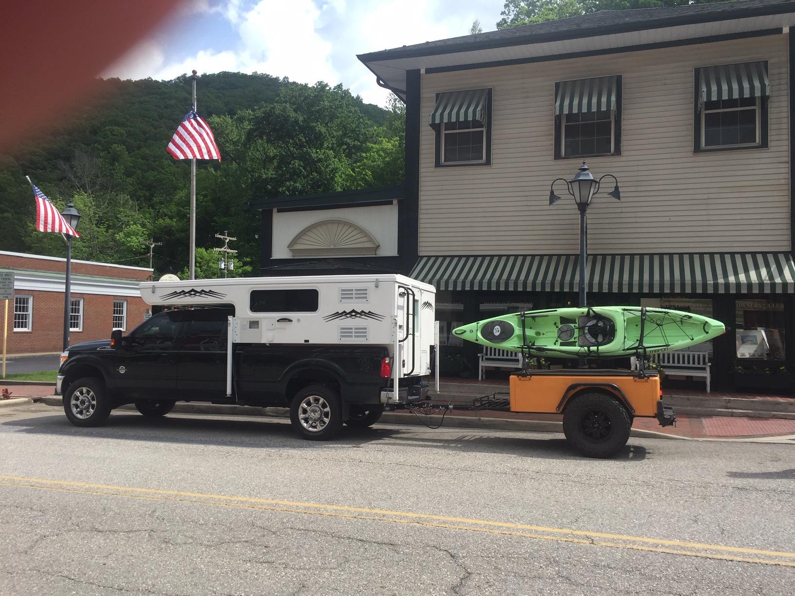

Jeep Gladiator Overland or Rubicon - Can't Decide 5B7A4C31-9914-46CB-934A-C0C2F6614EEB
Good stuff! Im thinking of getting the manual Rubicon. The trailer I want has a max weight of 3500 but only weighs 1500 empty. My question is about hitches. Off road articulating hitches specially. How do they handle towing vs regular ones vs weight distribution hitches?
I have one of those articulating hitches on my offroad trailer that I either haul our kayaks on or a RTT.
I have towed it 400 miles to the beach for a camping trip up to 70 MPH and have not noticed any issues with it. It does not rattle or behave in any unusual manner.
Highly recommend! In fact we are taking it from VA to CO on Tuesday in the hopes of finding some trails to run on... Here’s a picture of it behind our truck camper...

I like that trailer
