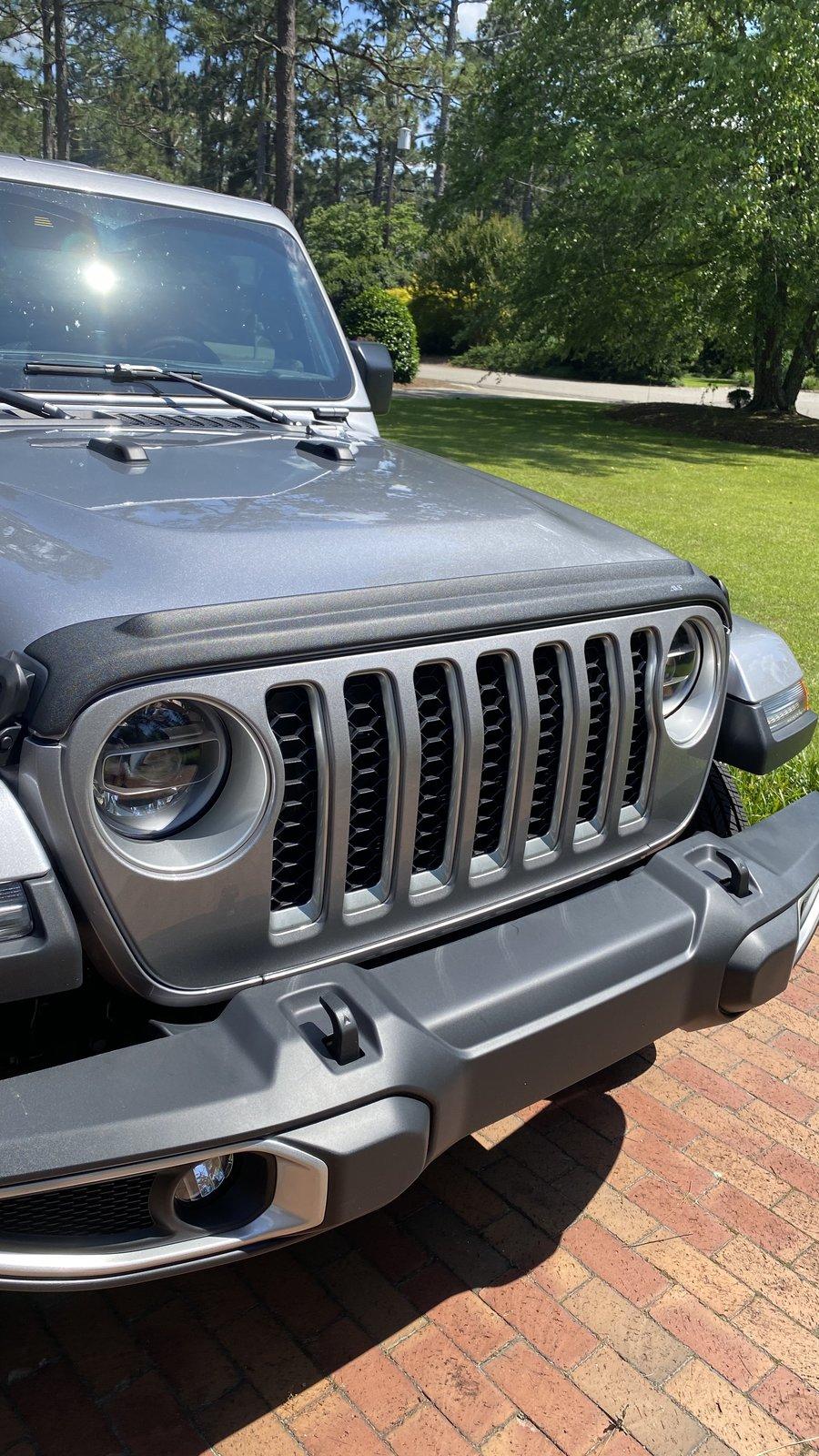

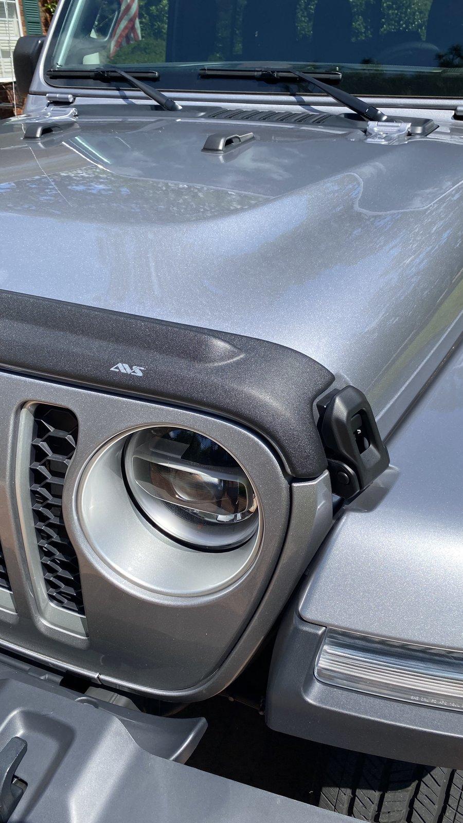

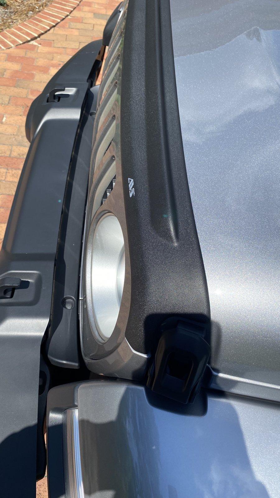

Nice lip on the hood! Where did you get it? Is it a bug/rock shield protection? Any front pictures?
