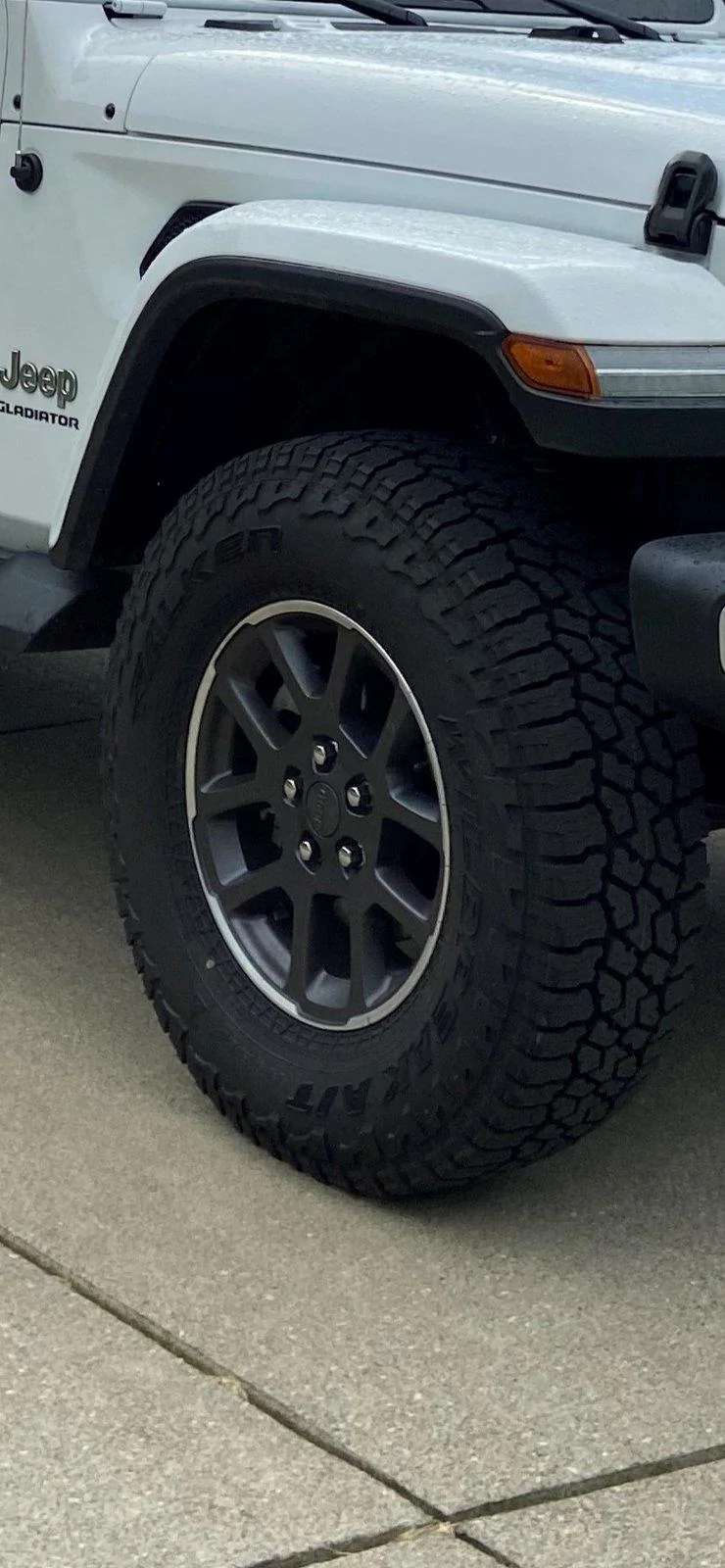

I'm running Falken 35's (285/75/R18) at 36 PSI on the stock 18 inch rims with a 2 inch Iron Rock lift with DT8000 shocks. You can see the thread here: https://www.jeepgladiatorforum.com/forum/threads/iron-rock-2-inch-lift-kit-installed.28591/
No sluggishness and getting between 19 and 21 mpg on the highway - 20 to 21 at 70mph with mpg decreasing above that speed. Consistently got 22 -23 mpg when JT was stock. I'm predominately on flat ground and not under load most of the time.
When pulling a 5x10 utility trailer with 800lb load, only the higher gears drive the RPMs up before shift.
When pulling a 3500lb camper, there is some sluggishness and higher RPM before shift... that's to be expected though.
EDIT: Used a Tazer JL to adjust tire size and pressure settings for new configuration.

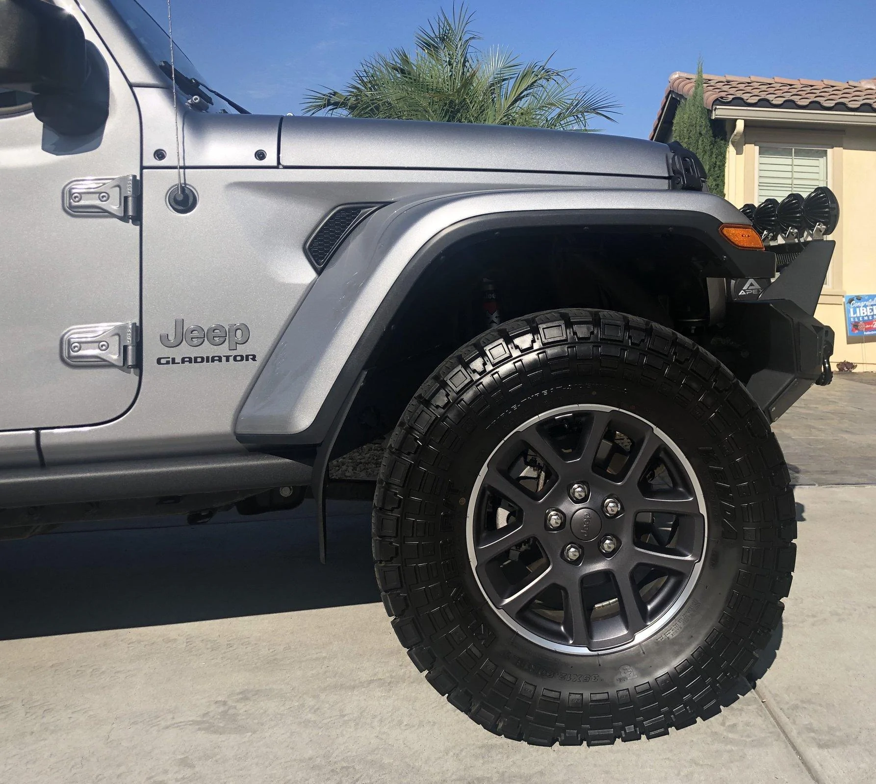

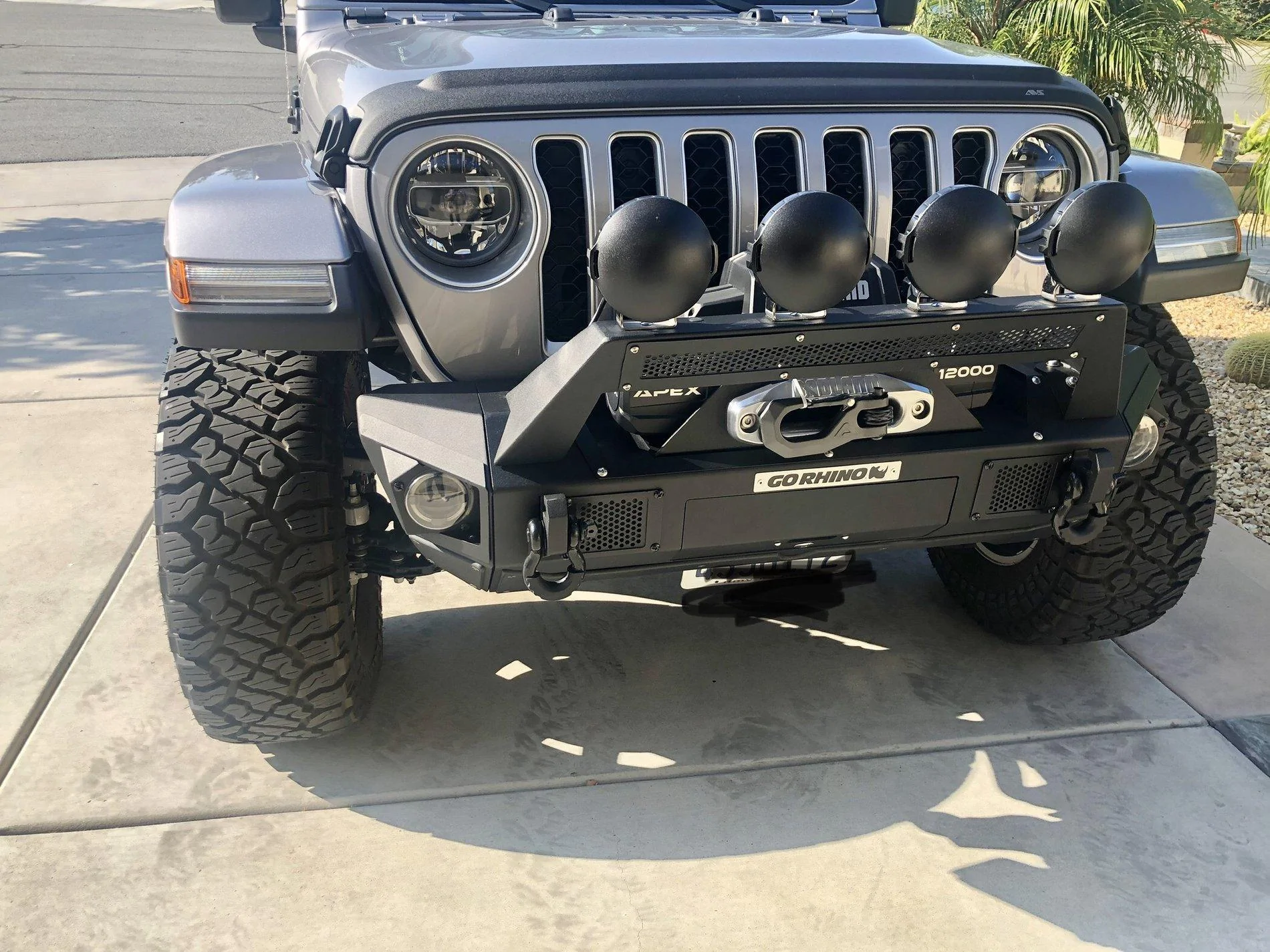

I got 35s on my overland. A bit more sluggish, but its fine for city and hwy driving. MPGs took a hit, averaging 16-17. 8th gear is not used as much as other mentioned.
It handles just fine.
Jeep Gladiator Overland owners who switched to 35 & 37 tires IMG_0383
Jeep Gladiator Overland owners who switched to 35 & 37 tires IMG_0386
