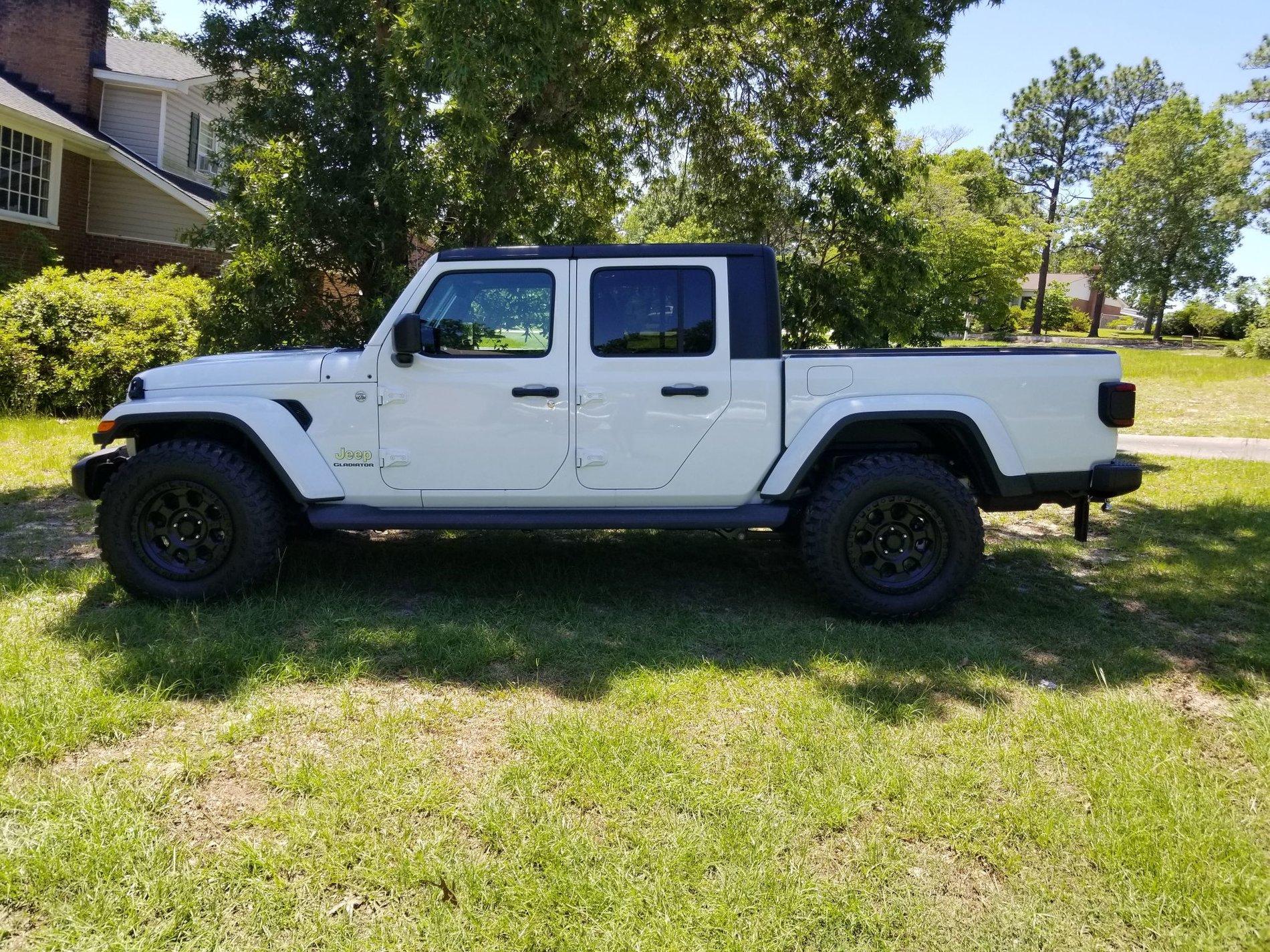

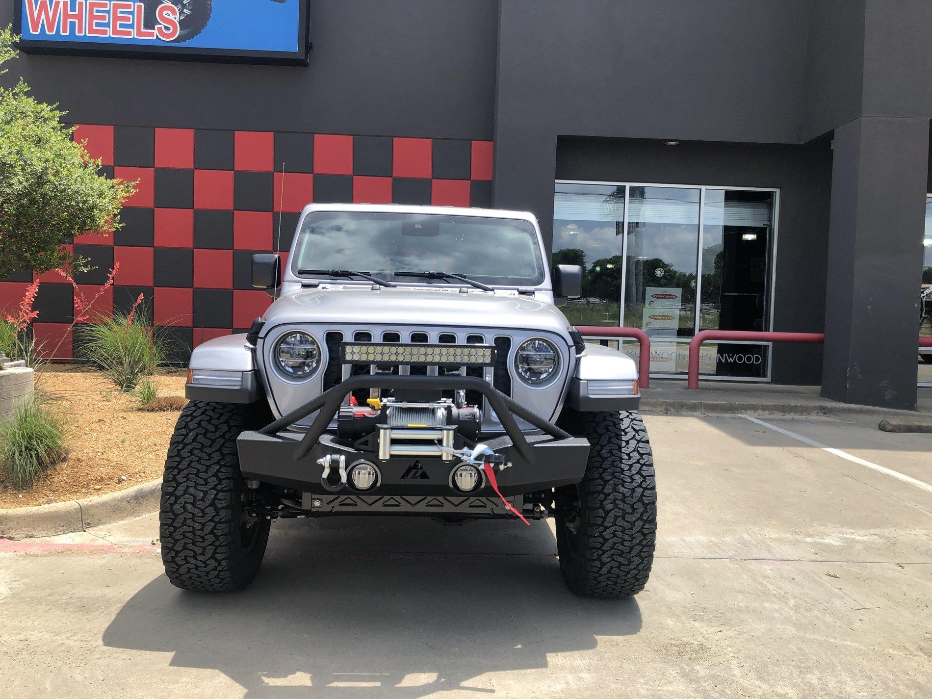

18x9 American Racing ATX with Mastercraft MTX 295/70-18 on Stock Overland Suspension. Rides good, handles good, and no rubbing.

It's pretty amazing how dramatically both Wranglers and Gladiators change with a decent set of wheels & tires. (Or how ugly they are with "street tires.")

Any chance you could measure from center cap of wheel to fender? Those tires look perfect and I’m just curious the rake.

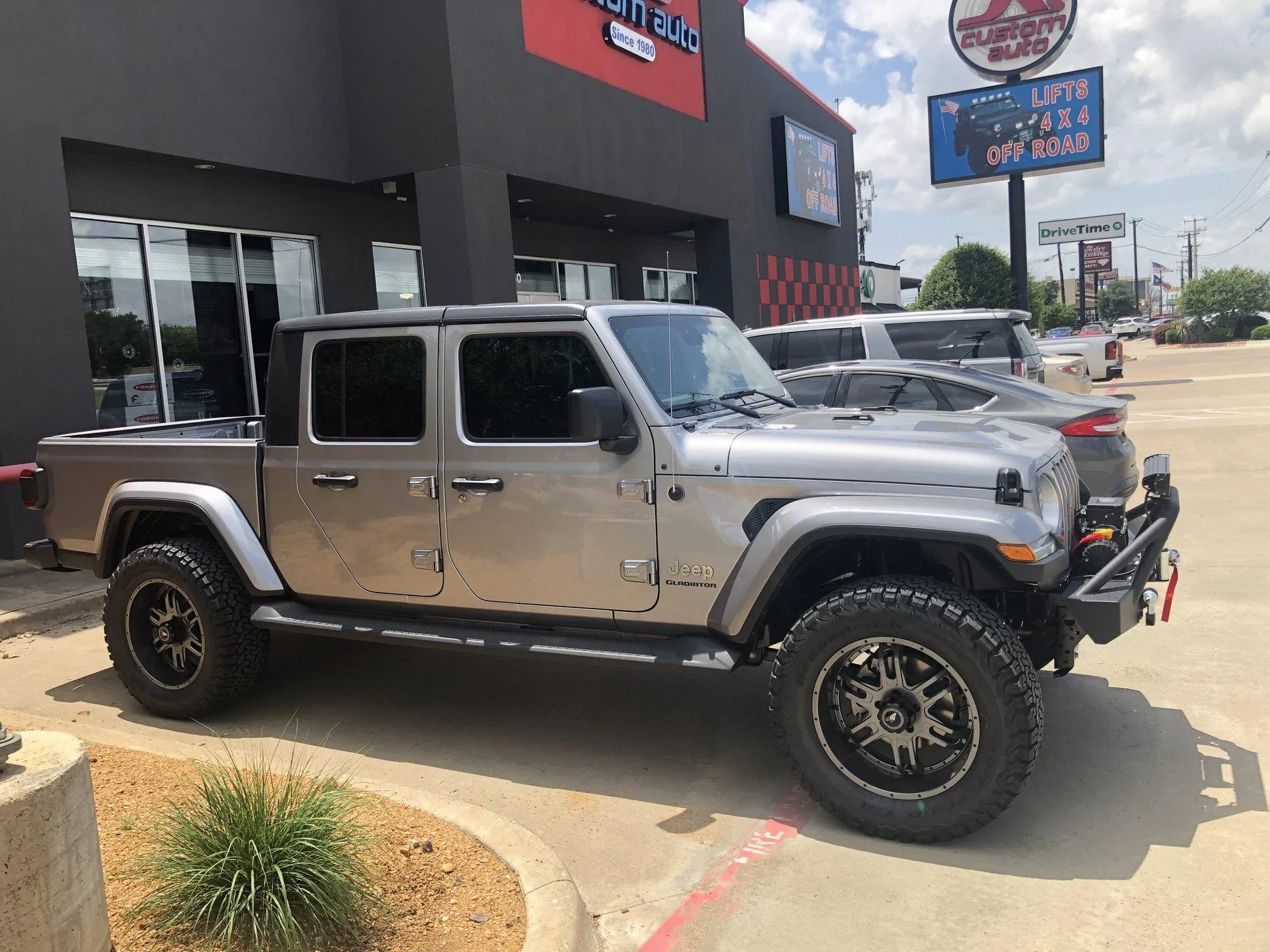

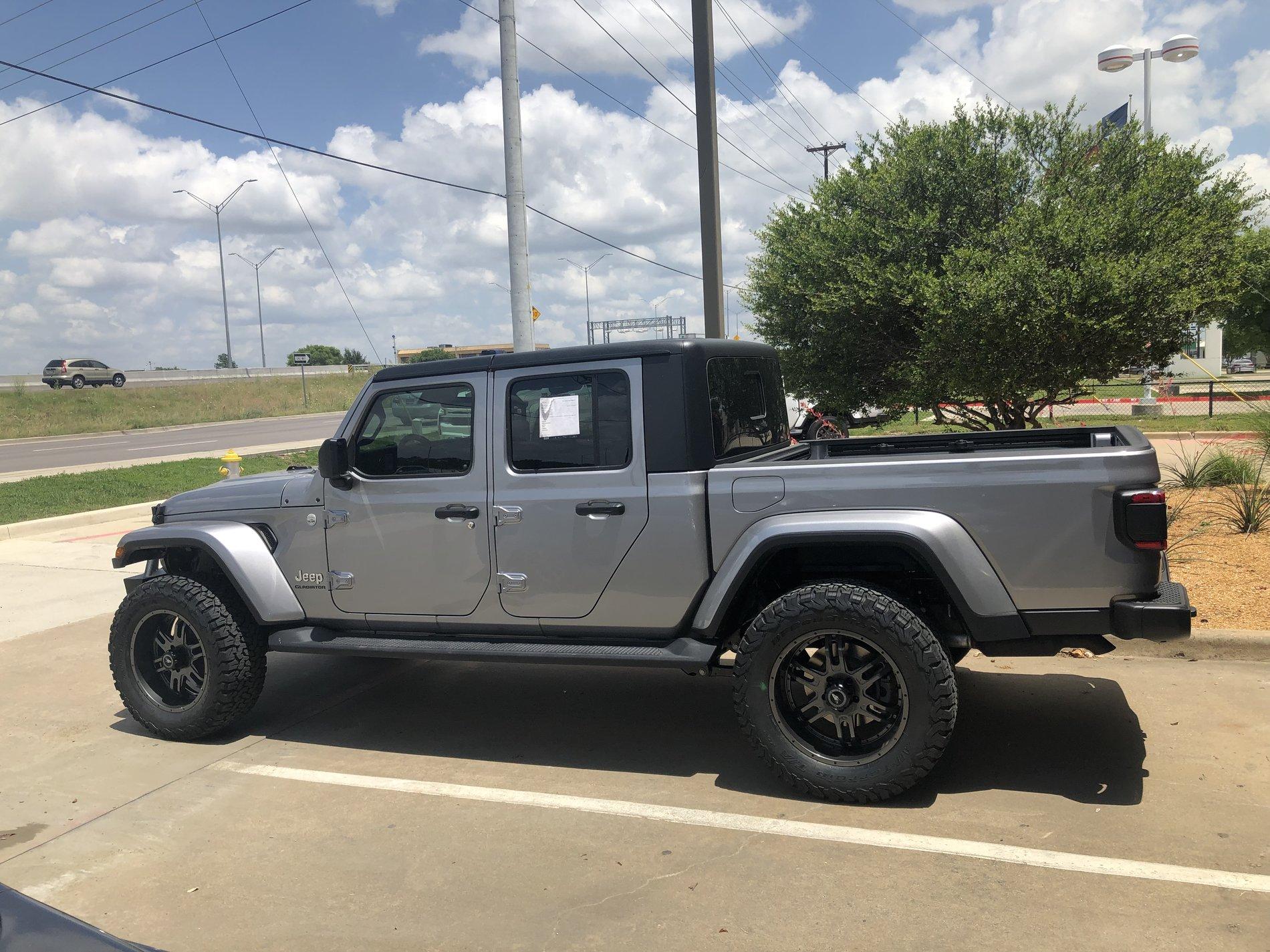

saw local tire shop added small front lift and 35” to an overland. Looked pretty good.
Off topic i know... but does anyone know what the brand on that front bumper is?

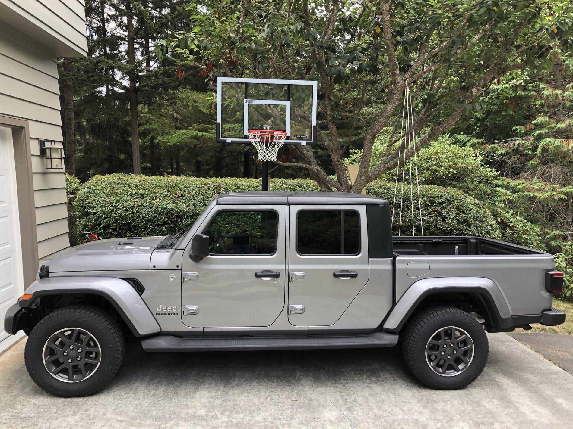

Is it a big deal to recalibrate the speedometer if I change to a bigger diameter tire? Will it mess with warrantee? It’s not that I have to go bigger, I just thought it might look a bit cooler. I just want to upgrade the tire to more AT....

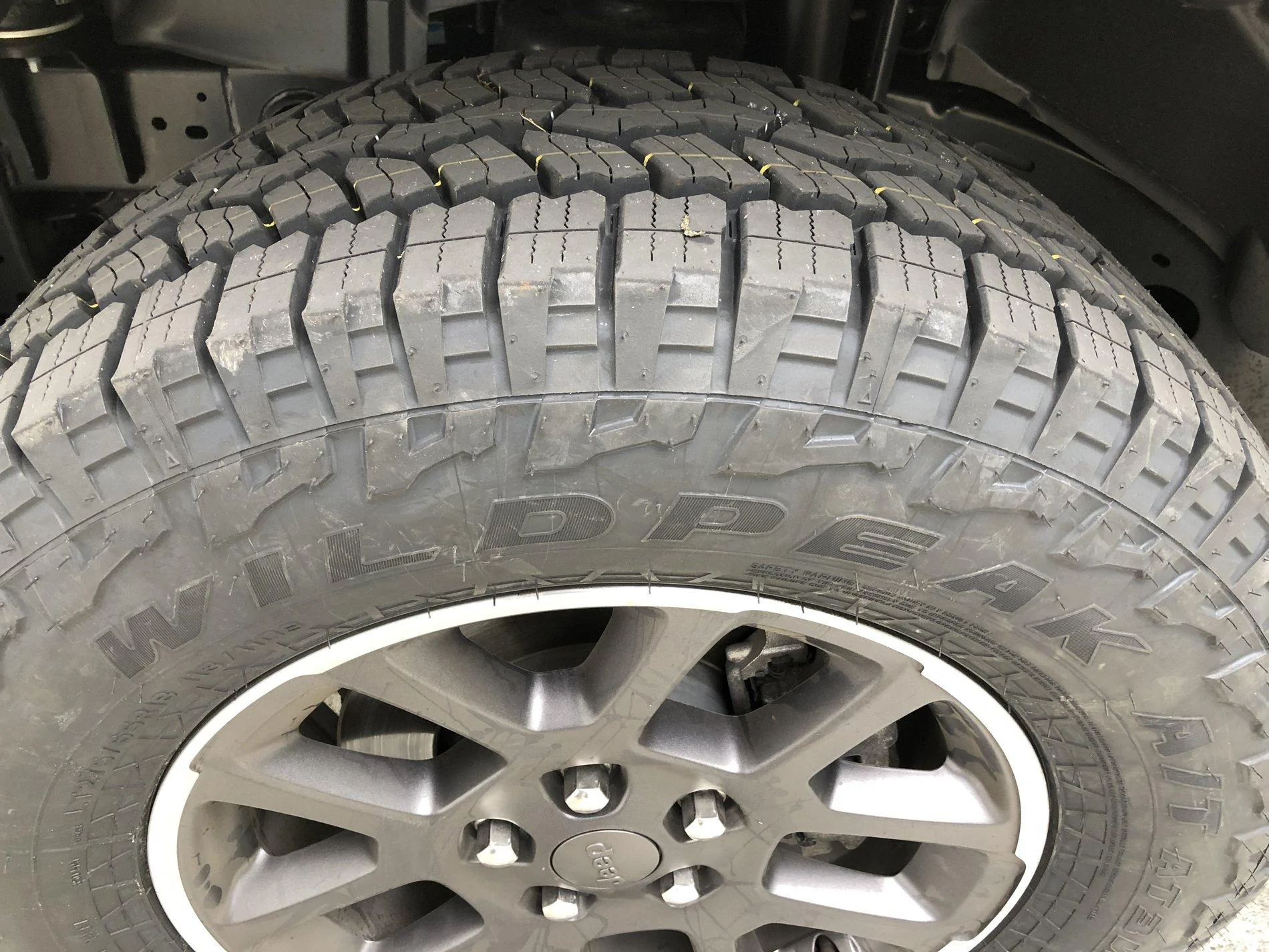

There are several very good size comparison websites. I like the one on Discount Tire website. I will be going with a 275/65R18 AT. Gives me a wider stance, aggressive tread and most importantly for me, the same height. So I don't have to worry about a change in speedo or calibration issues. Just need to get the best deal on a brand.
I like this idea/size for 18” Overland wheels. When I looked up all terrain 275/65R18 on Tirerack the obvious/popular choices are BFG KO2 and Falken Wildpeak A/T 3WA. However the BFG KO2s are E rated while the Falkens are C rated. Everything I’ve read on this forum say stay away from D and E rated tires because they give a harsh ride. So are the Falkens indeed the better choice between the two?

I have always liked the BFGs. But I would avoid the E ply.

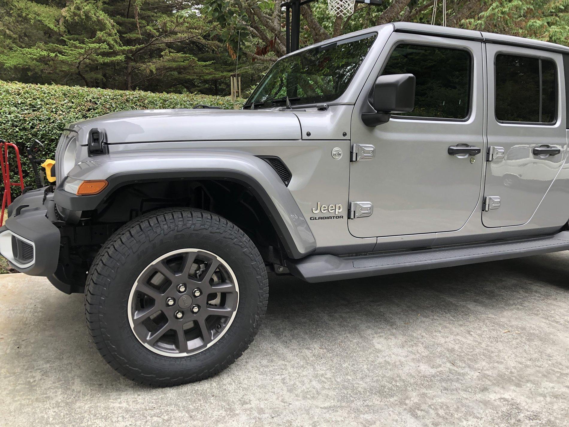

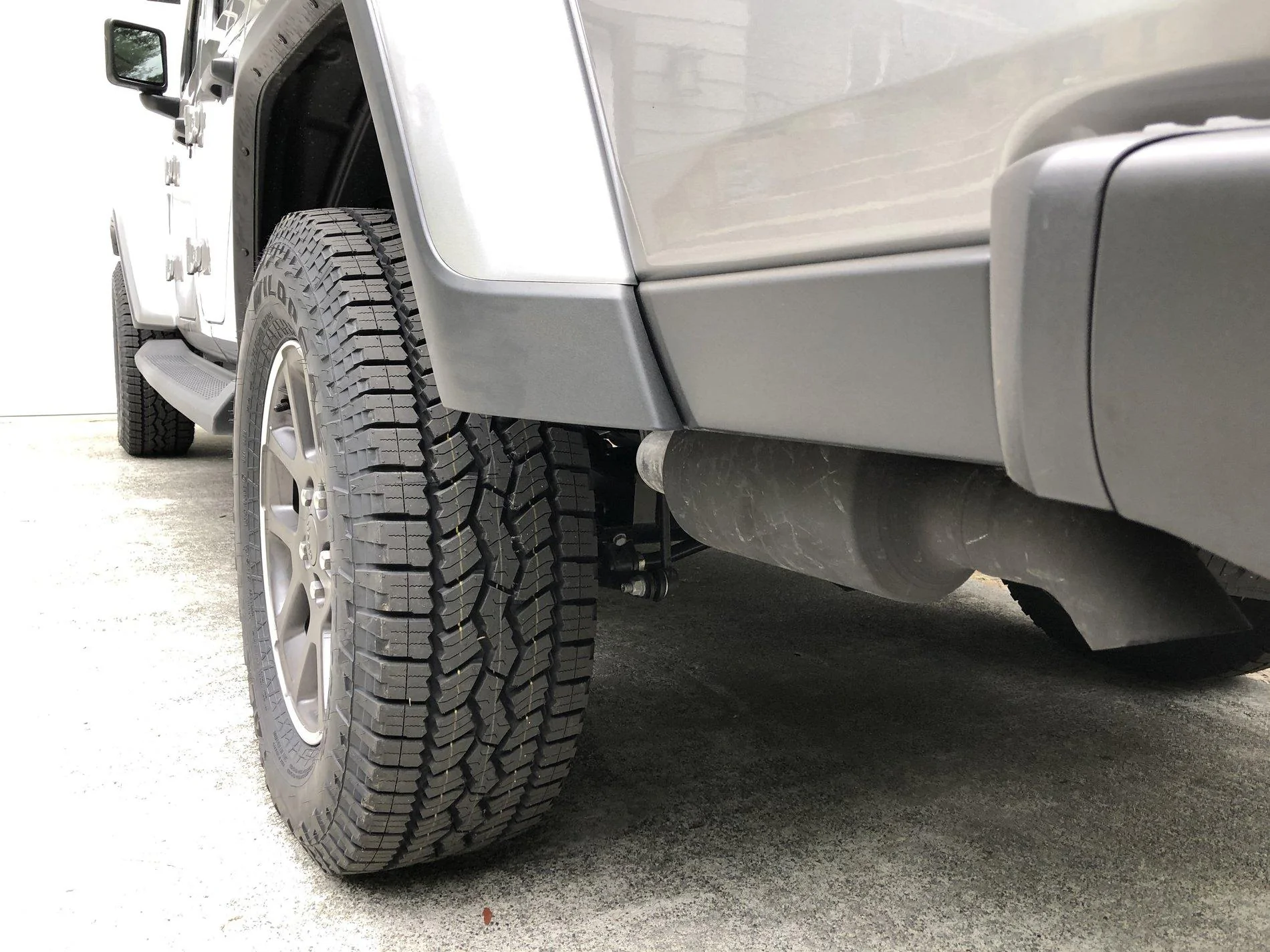

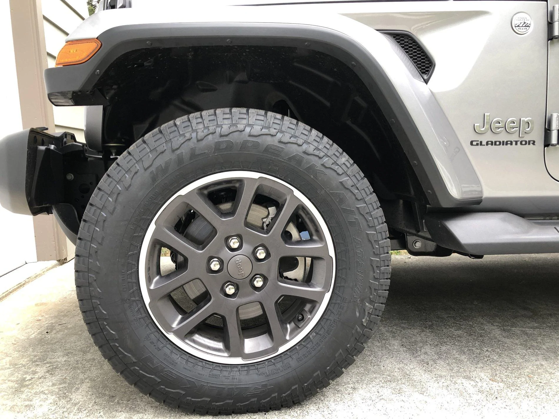

Per the posts above, I went with a set of 275/65/18 Falken Wildpeak A/T:
I like the look.
How’s the ride?
TYJ
Jan 24, 2019
378
524
California
2020 Gladiator
I'll report back after a few thousand miles, but my first impression is that they really don't feel much different than the OEM street tires as far as on-road manners, comfort, and noise. Pleased so far.
