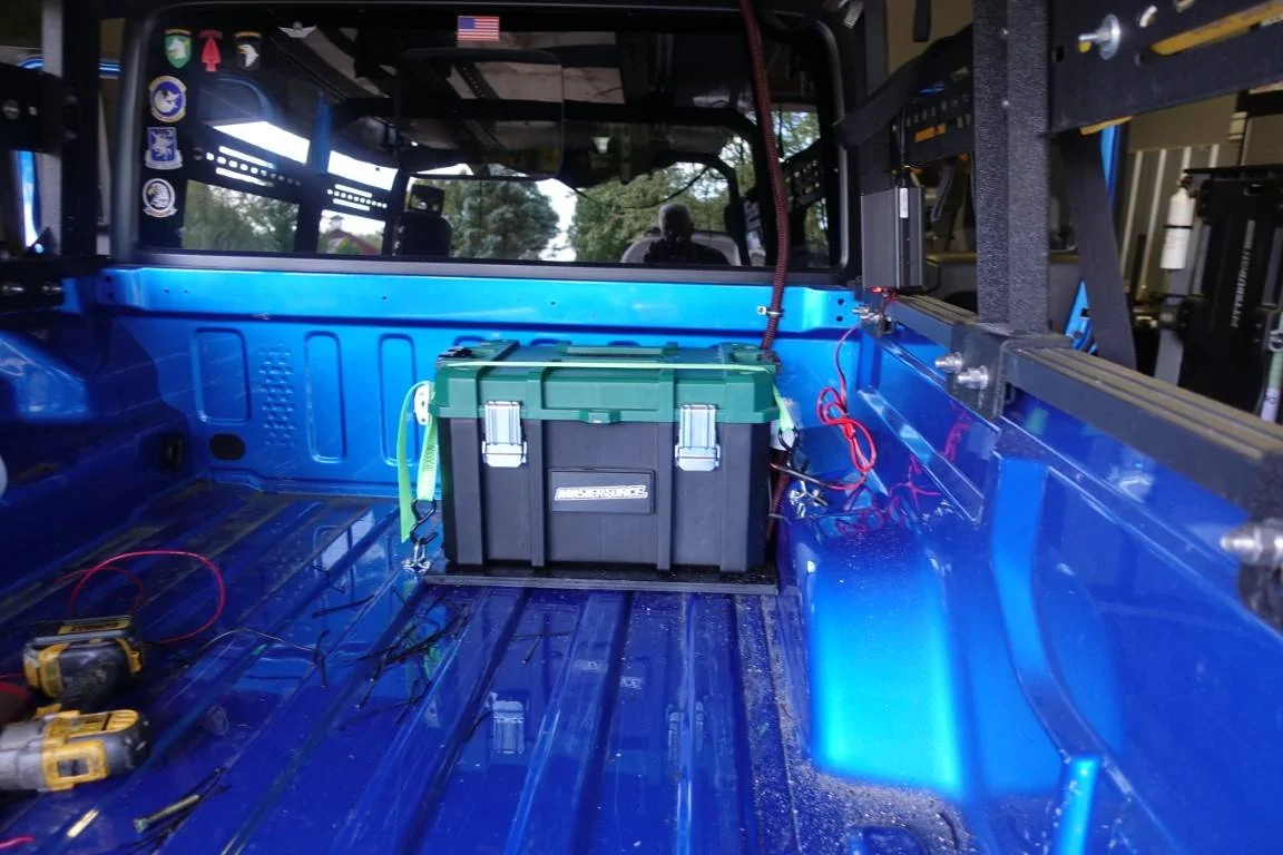

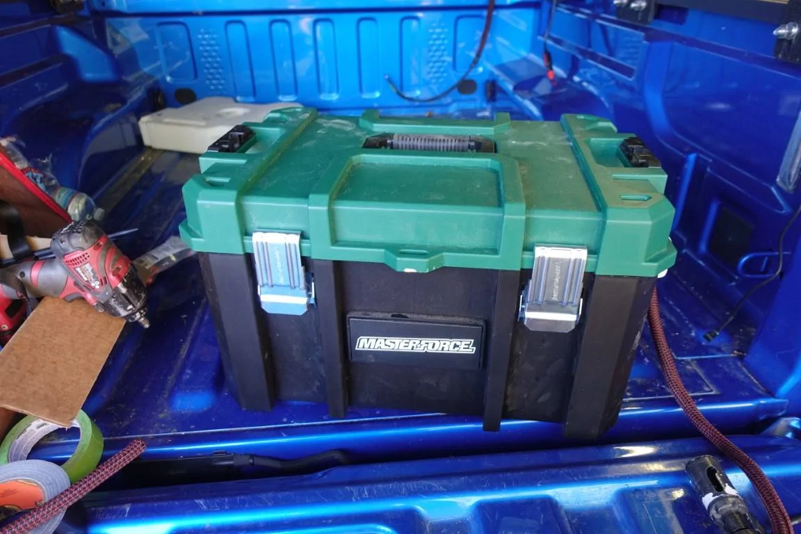

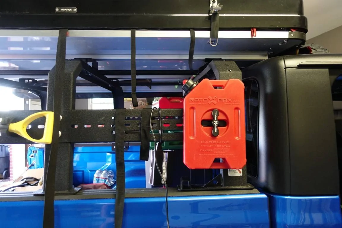

The box is nearing completion at this point. It will find permanent residence in the right forward corner of the bed.

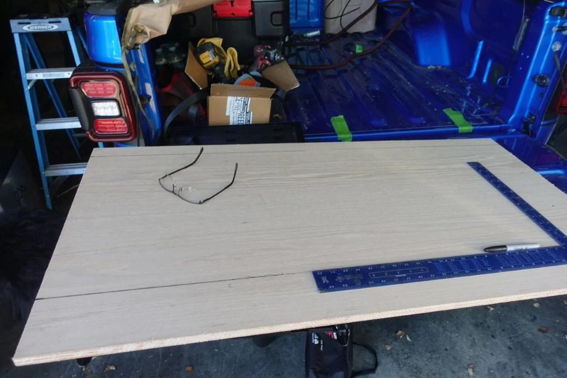

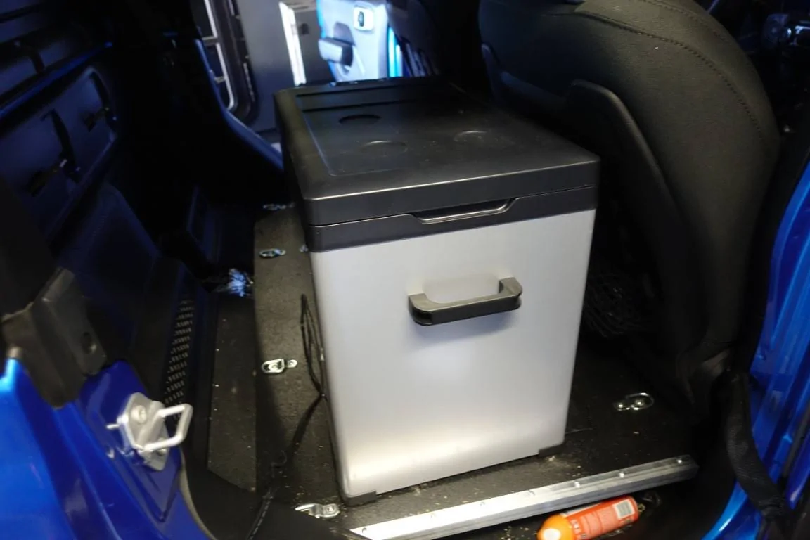

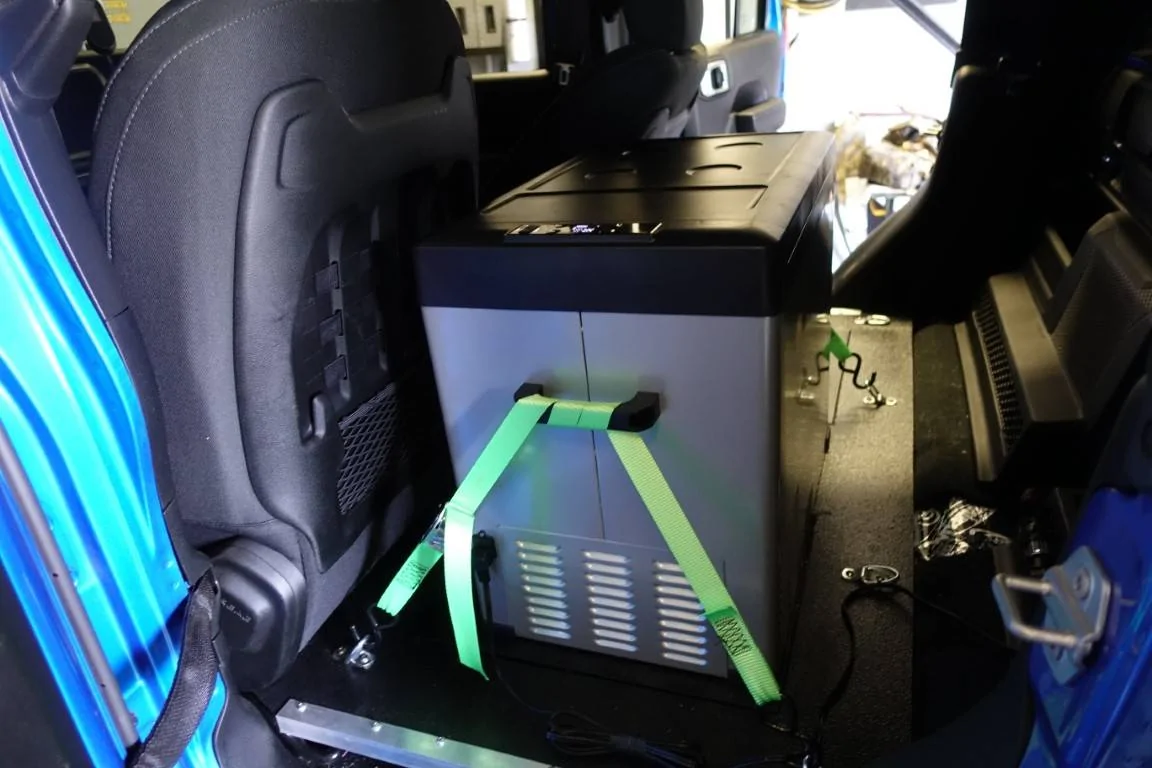

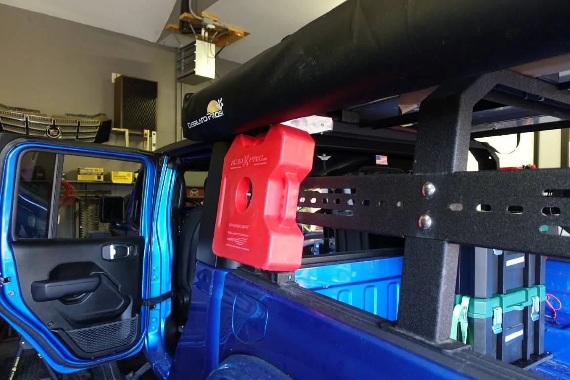

Although I purchased the IronMan fridge slide, I ended up not using it. Look, the thing is massive. It has to weigh 40 pounds and has a really big footprint. That sheet of plywood was going to be the base to which I bolted the slide...after boring a ton of holes into my pristine truck bed. I opted to just toss it and secure the fridge on the back seat platform. No added weight, no unnecessary permanent anything flopping around in the Jeep, and it works!
Simple, Done!

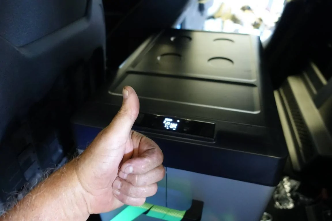

Oh, and this is kickin' butt!

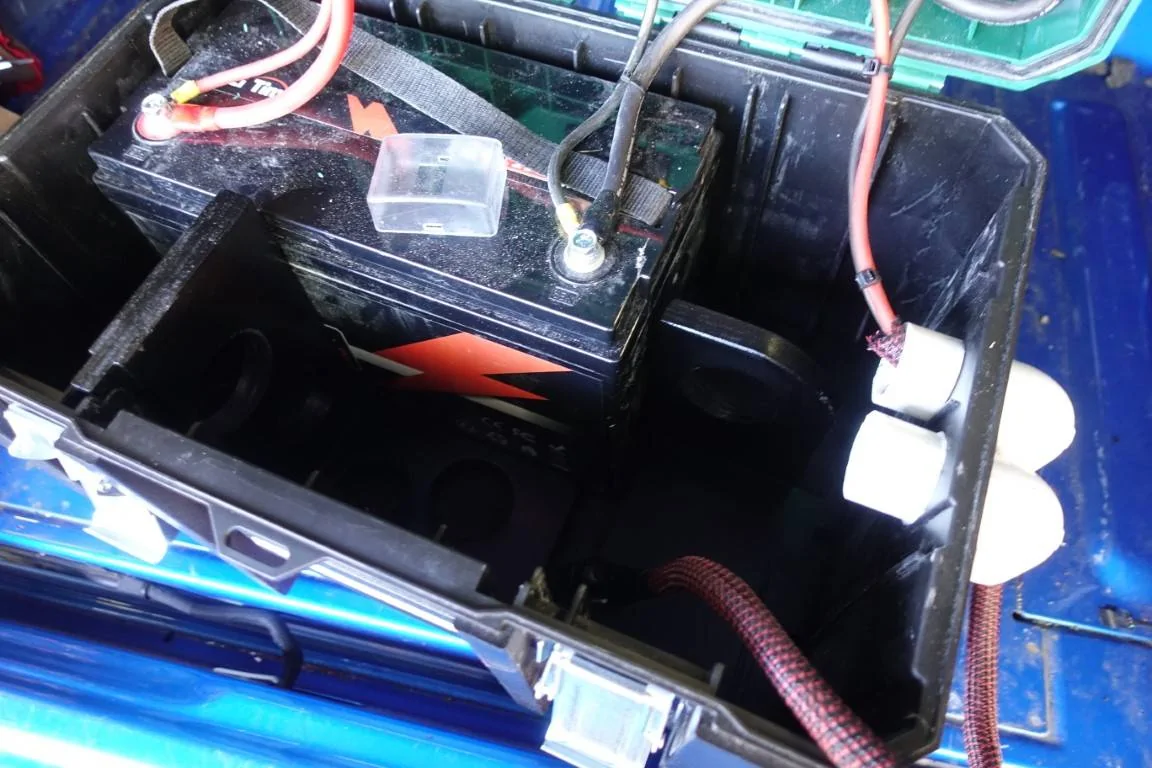

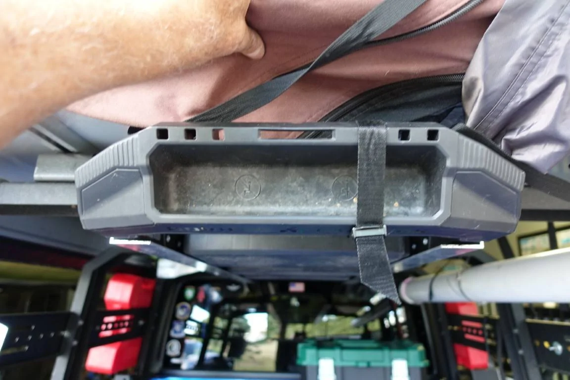

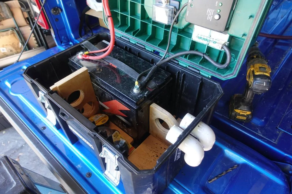

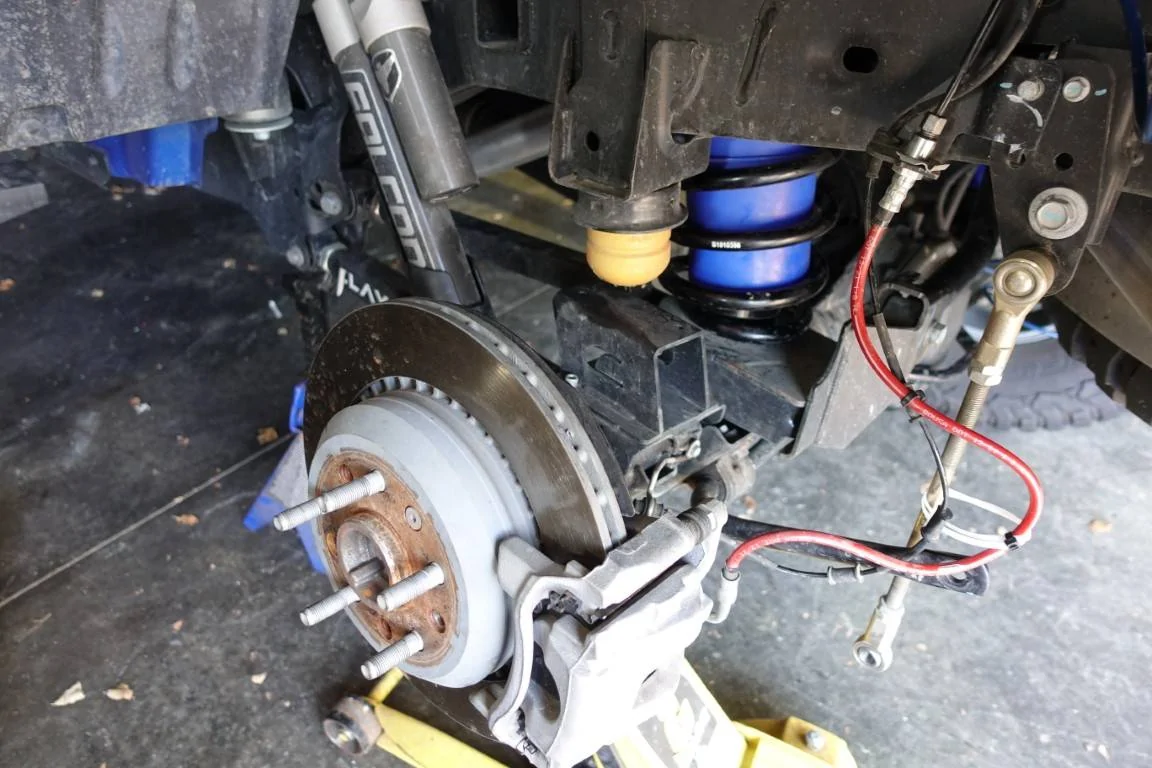

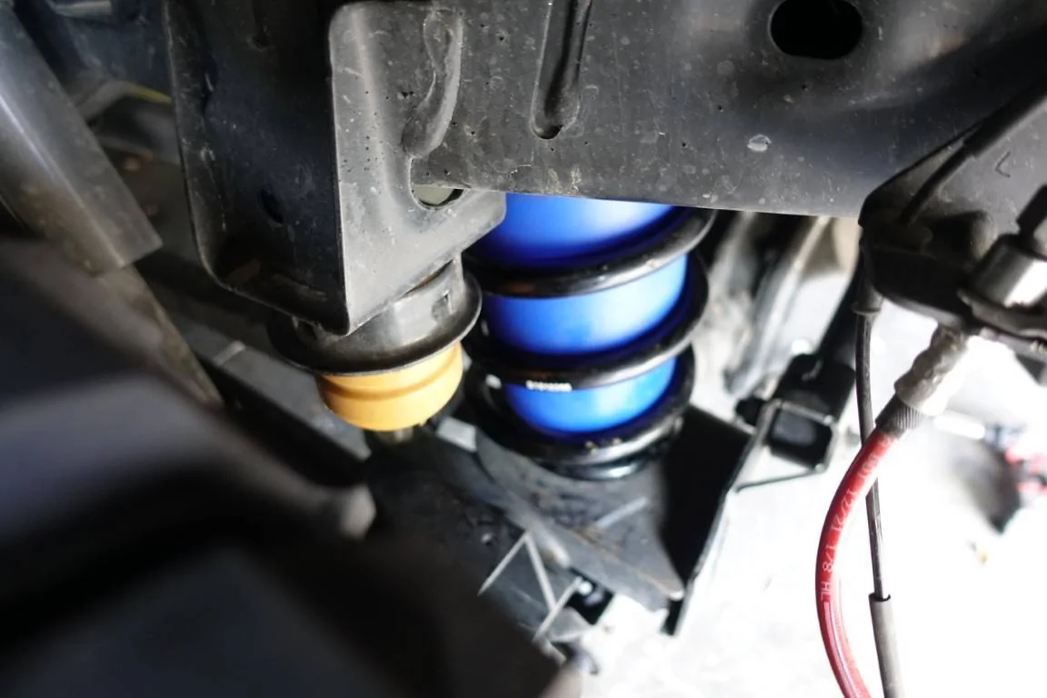

Progress is a bit slow due to some nagging Arthritis, but I am getting there.
Airbags are in
Rod carrier is in
Auxiliary electrical system is installed and functioning
A handy step ladder storage rack went in today
Had a new two-piston air pump (heavy!) delivered today.
Blast off is in 10 days for the San Juan mountains, then over to MOAB. Still need to change oil, rotate tires, repack everything, sort out propane/hose/stove, and go through the toolbox to see if I can delete some stuff to lighten that up some more. Oh, and I need to test fire the heater, which I think I just might need if we overnight in the high alpine instead of camping lower in the valleys.

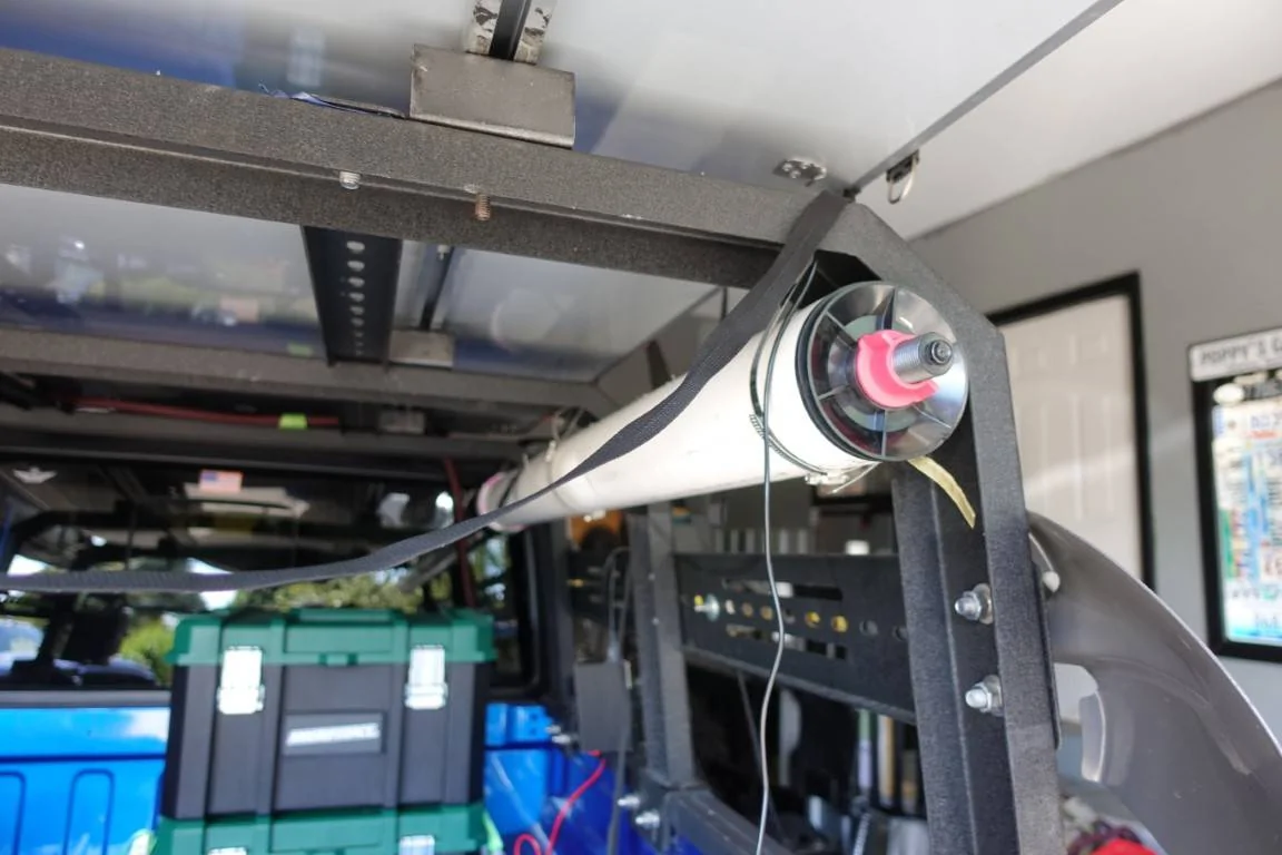

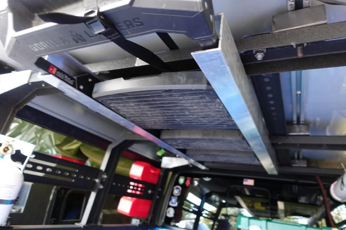

Getting closer to leaving
Update of progress:
New twin cyl air pump
I settled on a single-burner Blackstone
Fabed a Diesel heater temporary mount and ran a hose to the tent.
Reconfigured the recovery gear kit.
Redid the toolbox to make it lighter.
Coming down to the final loadout configuration

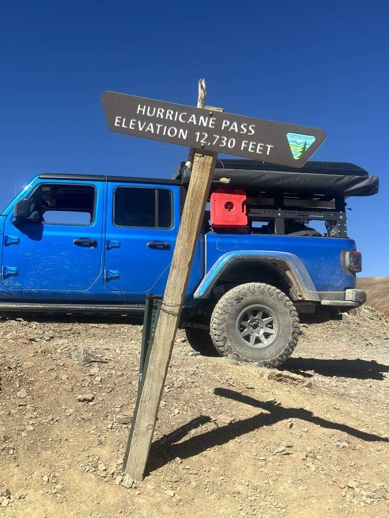

Photos of (some of) the passes
Had a good one on top of Corkscrew. That was one creepy descent. Very narrow and pretty steep, like close to sliding steep in spots.
