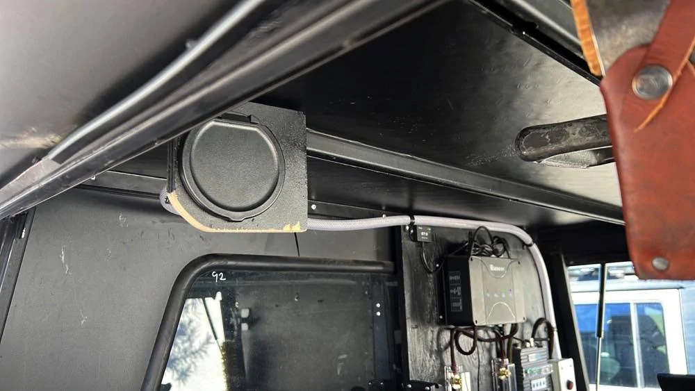

Flexible panels #...hmmm makes me wonder if they will attach to the fiberglass shell of the IKamper???
They tout that the flexible panels are made for just such an application. I went a different route with my install. The flexible panels can actually drop in efficiency when they get hot. A lot of info out there with folks gluing them to the roofs of RVs and seeing lower performance when they heat up. I opted to mount mine on a roof rack so that there could be air flow/circulation underneath.

A couple of takeaways. Flexible panels #...hmmm makes me wonder if they will attach to the fiberglass shell of the IKamper???
Knowledge is power and the charting of battery use/life remaining could be enormously helpful.
Dedicated vs removable???
I use 3M vhb double side tape. Been on there for almost a year. I did rough up the area where I wanted to tape it to. Also built the battery in a battery box for portability.

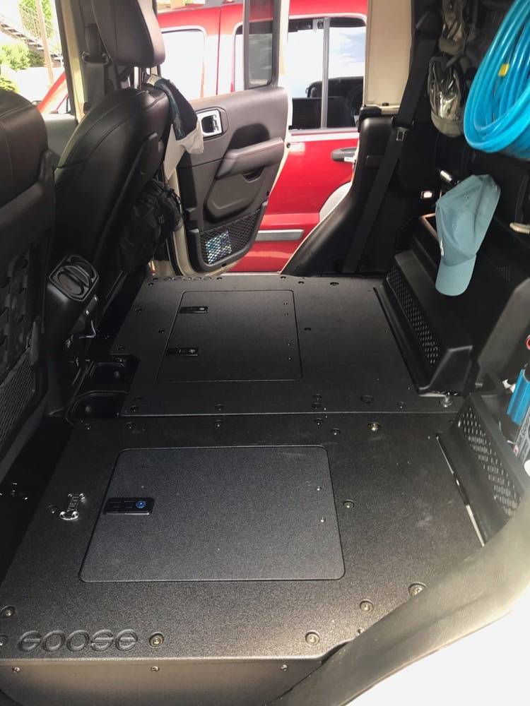

Let's start with the Passenger Rear. We did a rear seat delete because this is a dedicated overlanding vehicle (we have an empty nest and 2 other 4 door cars). Ideally, we place clothes bags and things we don't want getting dirty/wet behind the passenger seat and backpacks (which will be dirty) behind the driver seat:
Jeep Gladiator Overlanding build out/Adventures 05_RearSeatDelet

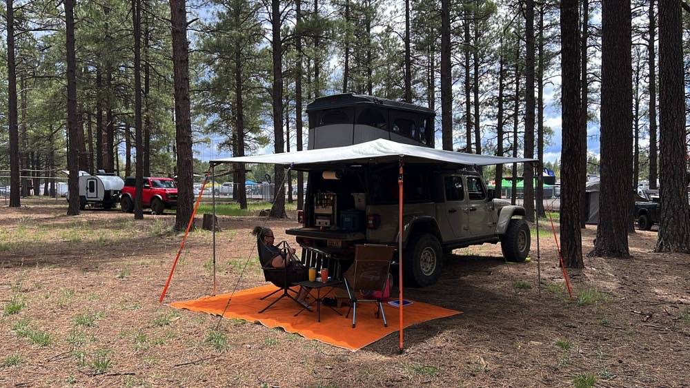

Staying on the passenger side, we have our awning which is the main "outdoor living space", complete with my wife's required ground mat:
Jeep Gladiator Overlanding build out/Adventures 73_JeepPos

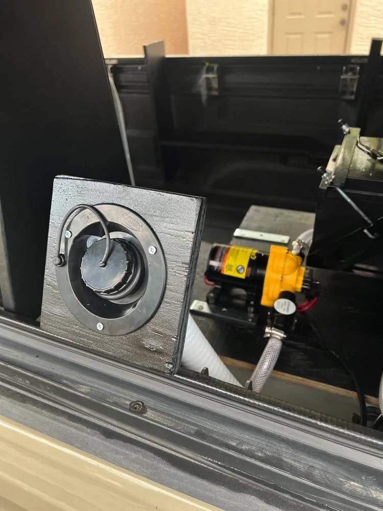

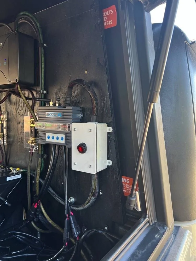

The passenger side also is the access point for my electrical control center, water fill, etc.:
Jeep Gladiator Overlanding build out/Adventures 24_FillPort
Jeep Gladiator Overlanding build out/Adventures 19_PanelInstall_5

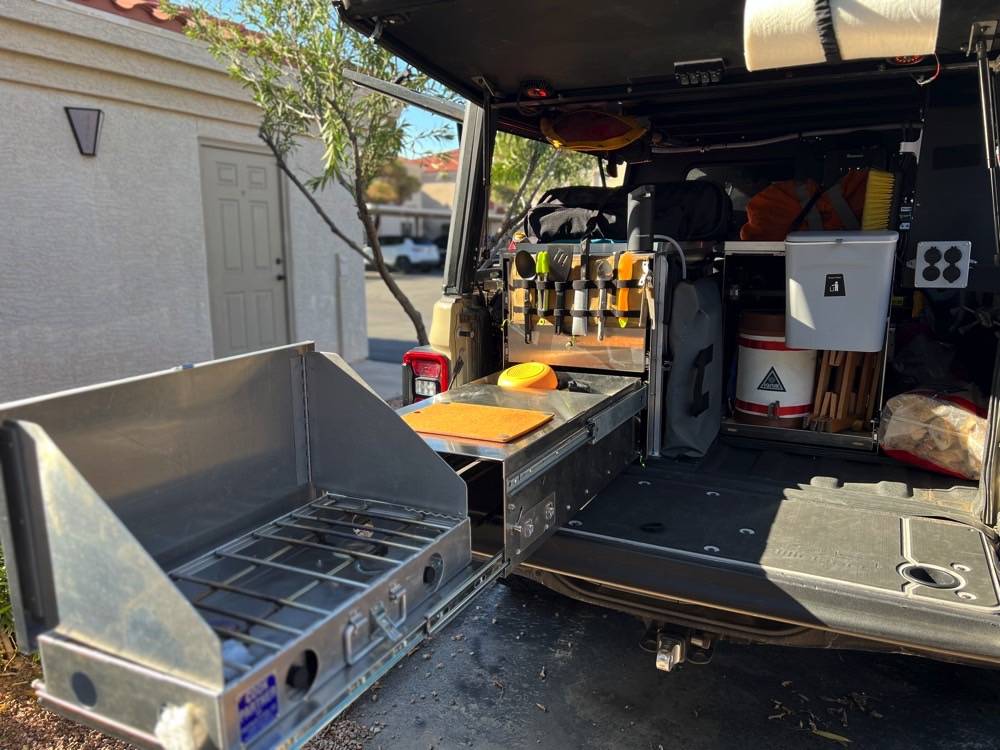

Moving to the back, my kitchen is arranged to work from and have access to the "clean side":
Jeep Gladiator Overlanding build out/Adventures 46_KitchenExtended
When we are done cooking, I'll boil some water, wash the dishes in my collapsible sink and then my wife will rinse on the dirty side (which means she stands on the driver's side of the kitchen "island") with my water hose/sprayer that is set up on the driver (dirty) side. You'll have to use your imagination here, but that is a standard RV port for an outdoor shower attachment (during install so not fully painted).

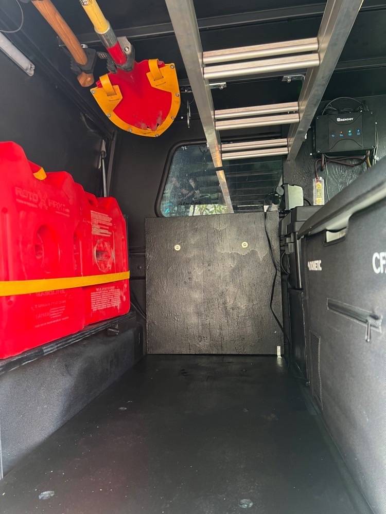

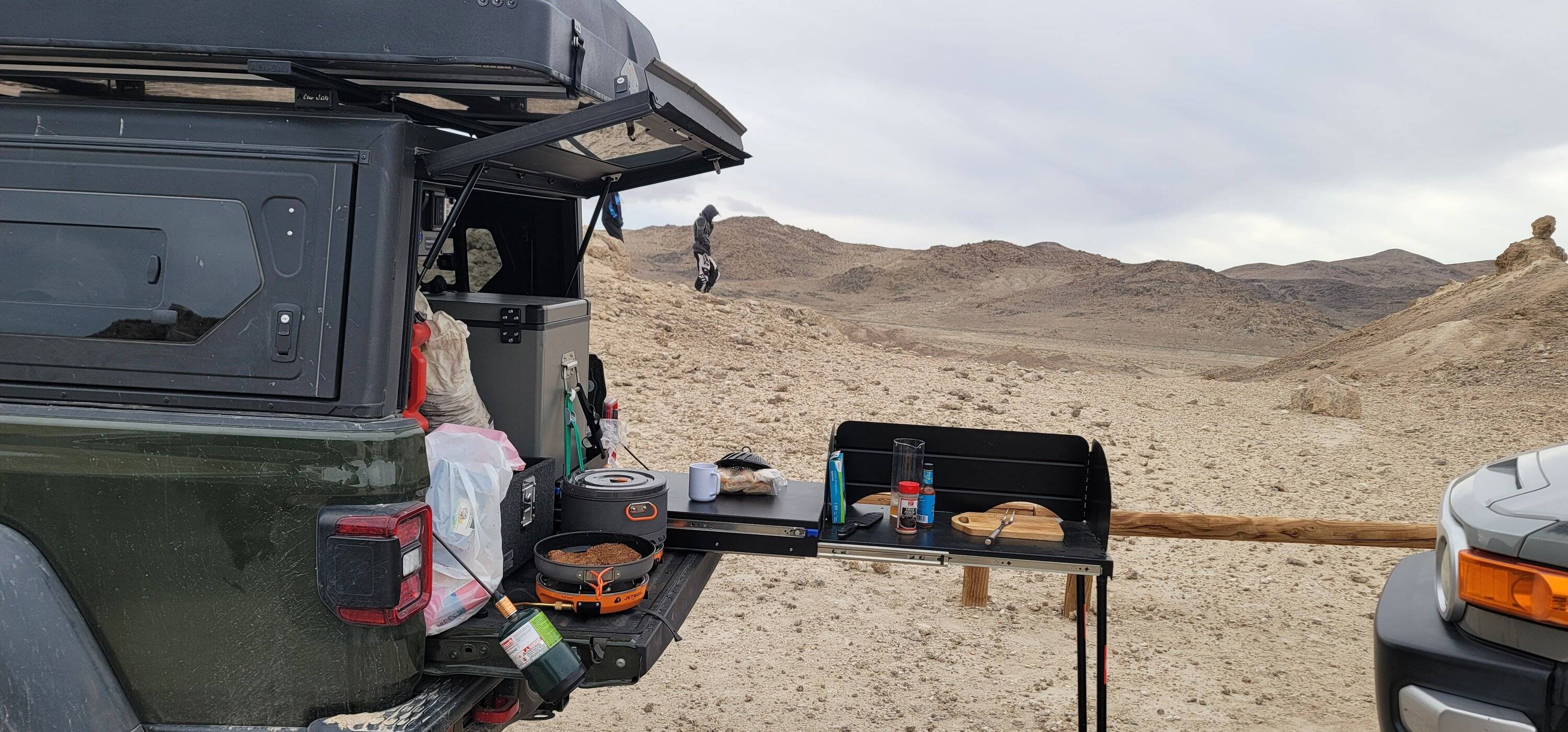

Continuing with the "dirty" theme, on this driver's side is where my spare fuel is also stored (this is before the kitchen was installed). This mounting location allows me to use a fuel hose with a jiggler fitting to put gas straight in the gas tank without removing the RotoPaxes:
Jeep Gladiator Overlanding build out/Adventures 43_KitchenPlatform
Please note that the gas cans are actually more securely mounted than what is pictured here. This was during fitment checks just before the kitchen install. Also that ladder mounting location was just an idea but it's not there anymore and we actually use an entirely different ladder for the RTT now...so please ignore that nonsense. Shovel and axe are actually mounted there though.

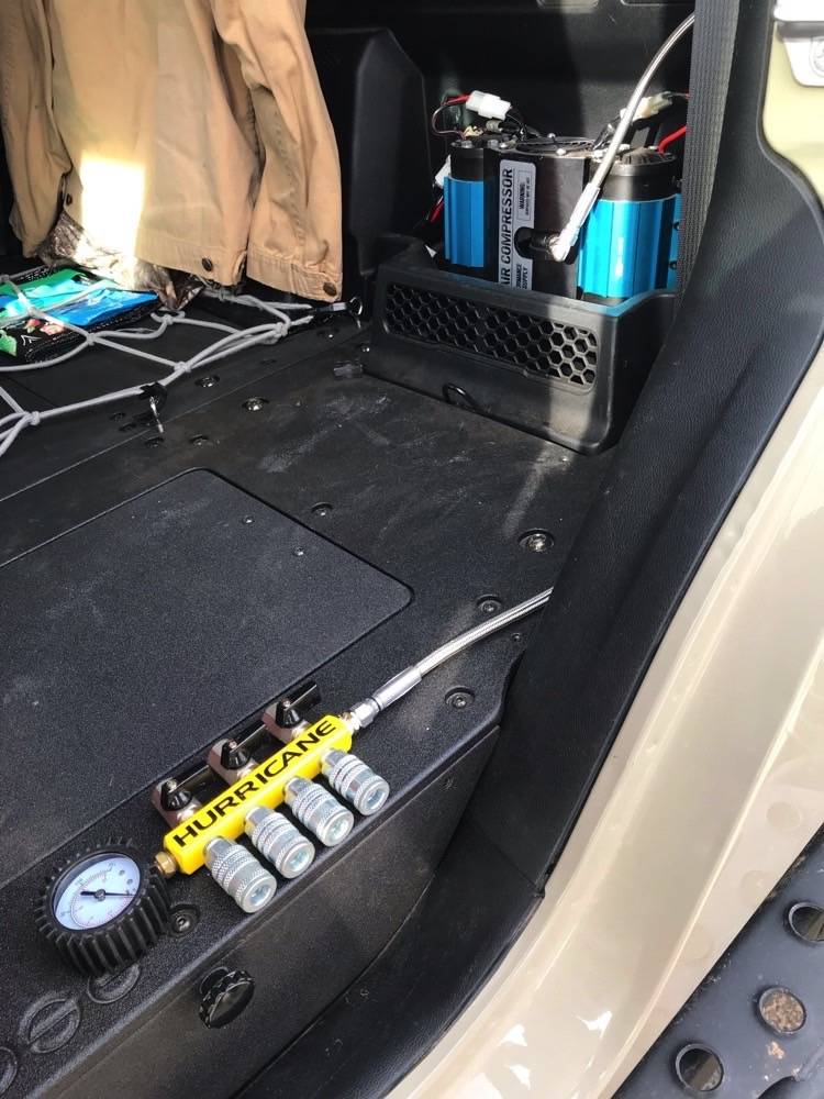

Continuing the "dirty side" theme, my air compressor and it's manifold are installed in the driver's rear:
Jeep Gladiator Overlanding build out/Adventures 08_Compressor_2

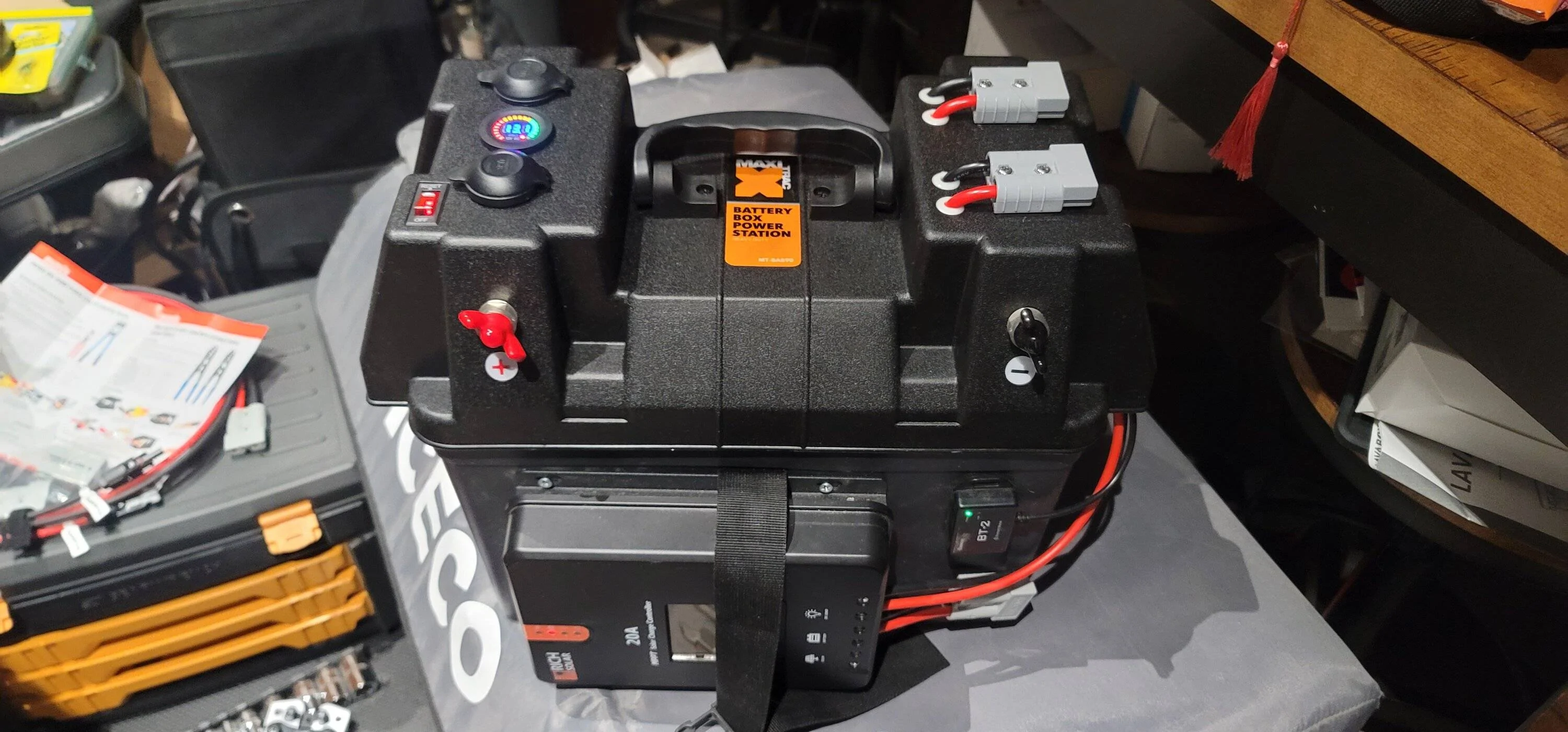

I'm still working on my final setup. It's gone through a couple of reorganizations as needs and desires change. I've come to prefer quick setup and easy break downs. One of my favorite piece of gear is the fridge/table slide. I've used it on every single trip for cooking and prepping. Very convenient.

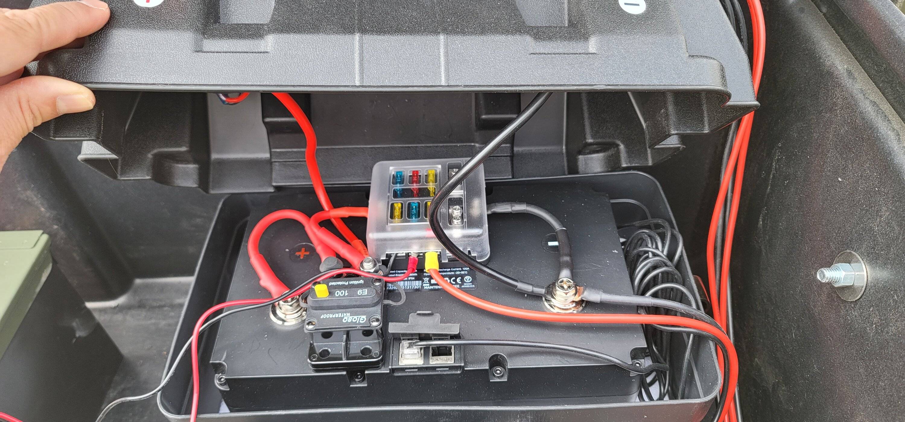

Also, found this battery box from Ironman 4x4. Makes building a battery system super simple and I like built in fan. Has all the usual outlets including a couple of anderson connectors which I use for mppt charger quick disconnect. https://ironman4x4america.com/portable-battery-box/
Here's a photo of the inside of my battery box.
Jeep Gladiator Overlanding build out/Adventures 20221231_141219

The fuse panel within the battery box is clever!
