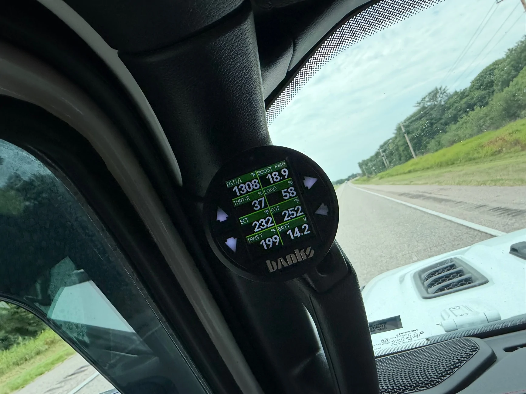

Update on my issue. After dropping from the tow tune to optimized stock, I drove 30 miles at noon towing the trailer without issue. Other than a different tune, ambient temperature was a few degrees lower, 96 rather than 102 but same trailer, same speeds and a similar South wind.
The highest onboard temps I saw Wednesday with P00AF were oil at 248 and coolant 226 when it went into limp mode. Today the oil hit 252, coolant 232 and transmission stayed around 200. I will try another short tow tomorrow or Sunday before risking a longer trip. Moving to the lower HP tune seems to have made a difference on mine. If the next test doesn't throw the code or limp mode I’ll try the 600 mile drive to New Mexico next week.

(my 2 cents) Your tune is not the issue. I have derated 2 times. Once not towing but driving into a 45 mph head wind going 85 mph on I-90 across South Dakota. Once towing a 3500lb Rockwood GeoPro travel trailer. I had every code under the sun including the P00AF. I cleared the codes and have driven about 20K miles without another code coming back. The biggest impact to not derate is the ability to watch your EGT (exhaust gas temps). I got the banks idash and mounted it on a pod on the A Pillar. I now have the tow tune plus the trans tune and am running on 37" Toyo RT's with 4.56 gears. I do not have any derating or limp mode issues because I religiously watch the EGT and the oil temps and adjust my driving while towing accordingly. Search Wolf Overland on youtube as he has a ton of content on EOC and EGT issues. I went another direction to fight the EGT/Oil temps while towing. I just installed a Snow Performance Water/Methanol injection. It has dropped my oil temps where am consistently running around 225 to 230 degrees on my oil temp.
Looking at your EGT temp of 1308 and oil temp of 252 you need to drop a gear and possibly slow down. I usually run under 1000 degrees on the EGT's by dropping to 7th or 6th gear and running between 65-70 mph. With the water/meth injection my EGT is stay pretty consistent around 860 to 960 on incline/hills.
Thank you for the information. That is definitely a number I pay attention to. That picture was taken right after accelerating up a hill trying to recreate the problem. I was going 60 mph at the bottom and a little over 70 at the top. That was the one hill in yesterday’s test that I expected to cause a problem but it didn’t. I drove hard trying to force an issue, not like I normally drive when towing.
For the next run I’m going to travel around 140 miles while driving much more conservatively. There’s a turnpike 40 miles away that will be a great test. I can get on and run 30 miles or so with several big hills. If it handles that without an issue I feel like it will be safe to take the travel trailer to New Mexico.
