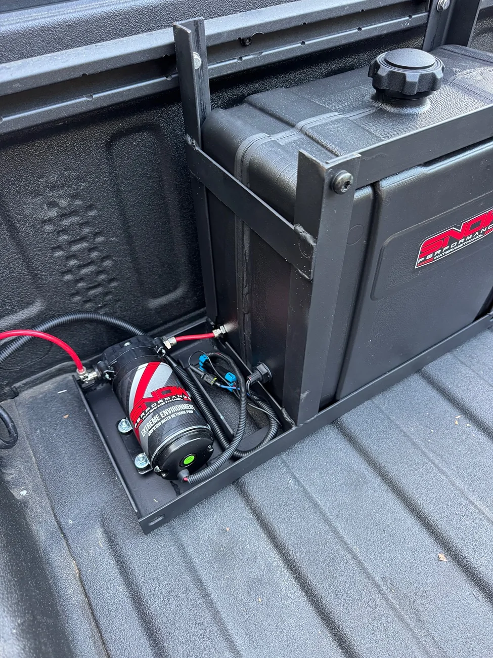

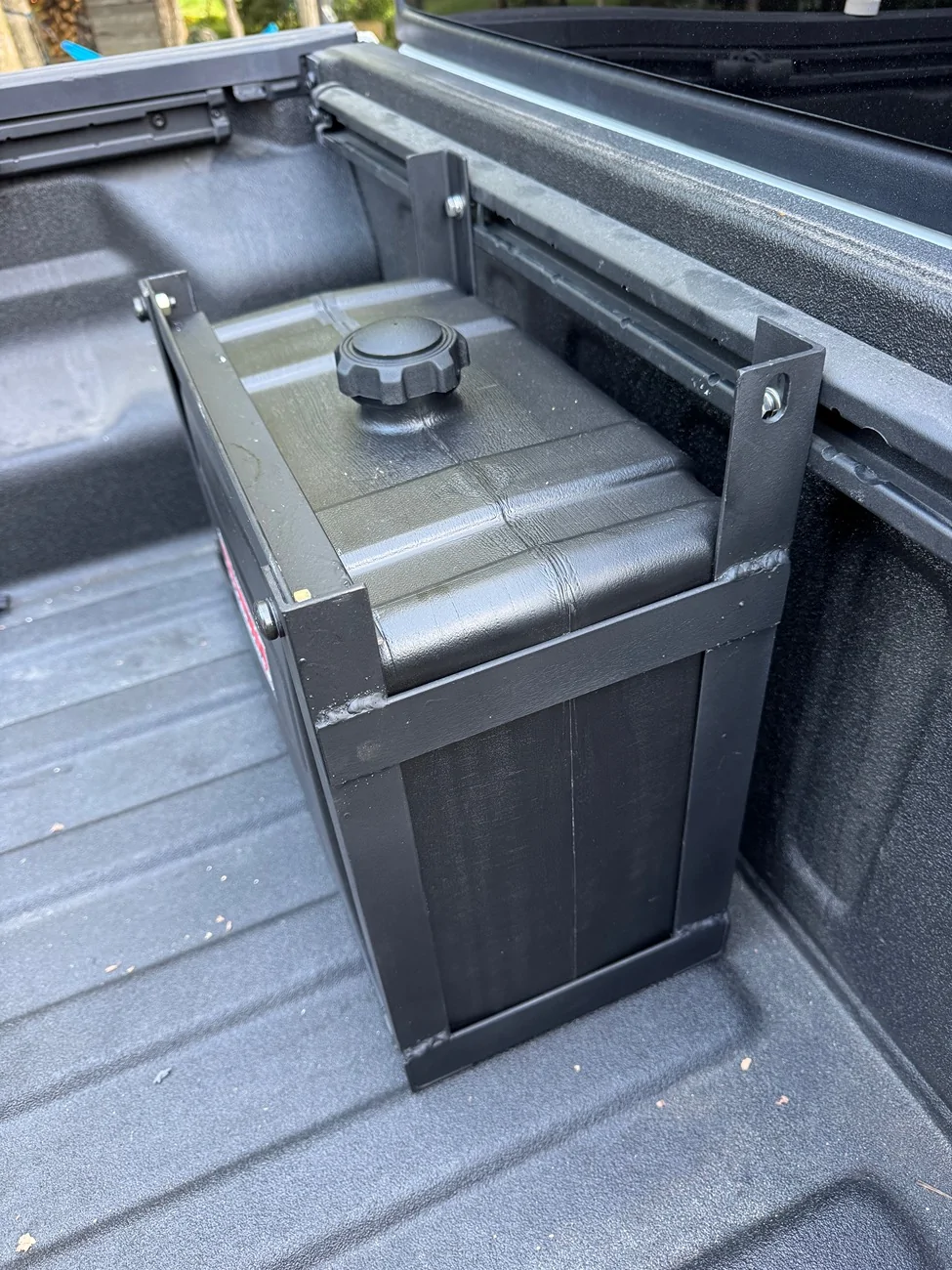

Snow performance stage 2 kit, you need afe charge pipes for the install, some sort of custom mount for a tank, I run a 2.5 gallon in the bed currently and looking for a larger one. I use about 2 gallons of washer fluid (which is 33-35% methanol) per tank full Using a 1 gallon per hour nozzle. no increase in mileage
I have the AFE charge pipes. The work perfect as the have the threaded bungs for the pressure sensor for the boost and the injection nozzle. Will start a new thread just for what I am running. There is very little on line for the water/meth injection on any of the Gen3 ecodiesels. I am running a 50/50 mix of distilled water and methanol. Post more later today or tomorrow on it.

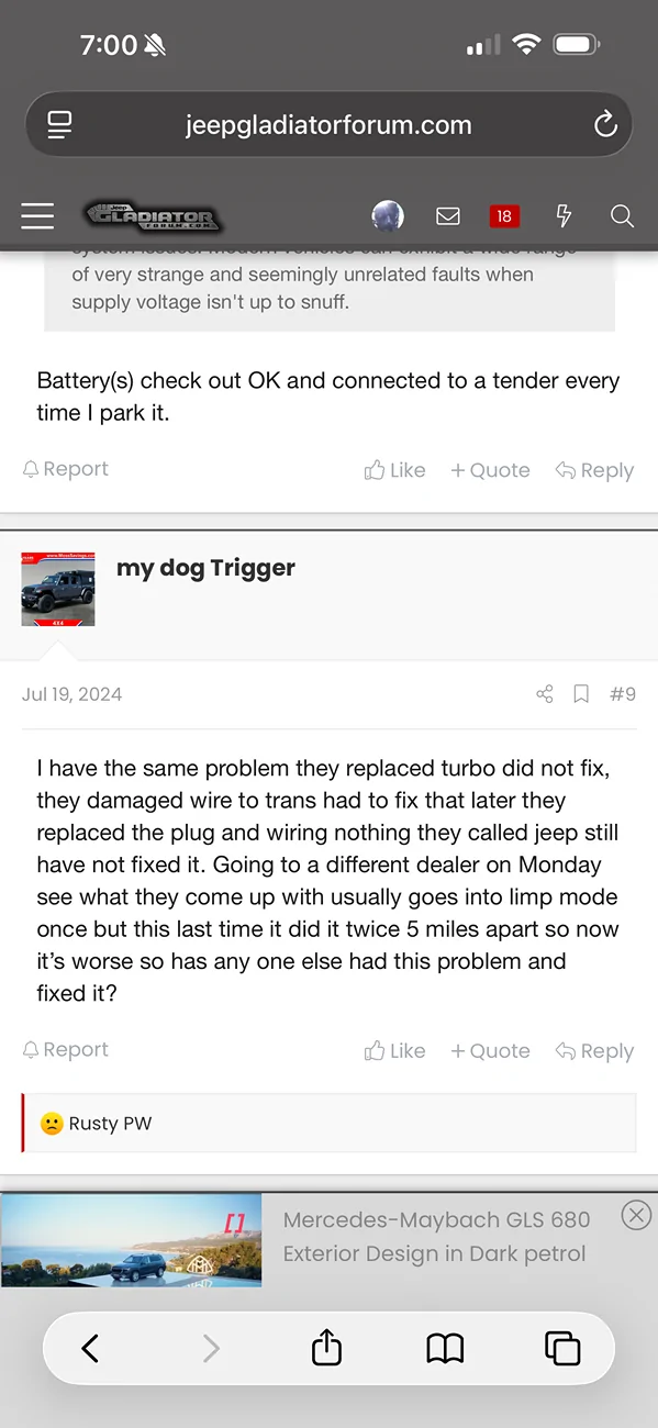

The actuator is the issue, but the actuator isn't sold separate. This is why Stellantis replaces the entire turbo.
Yes, 100% of the people who've replaced the defective turbo haven't had any more issues.
Doesn’t look like it has worked for everyone. As well, I have seen 2 reports in JLs of it still coming back after replacement.
