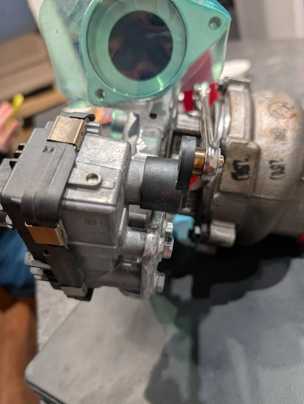

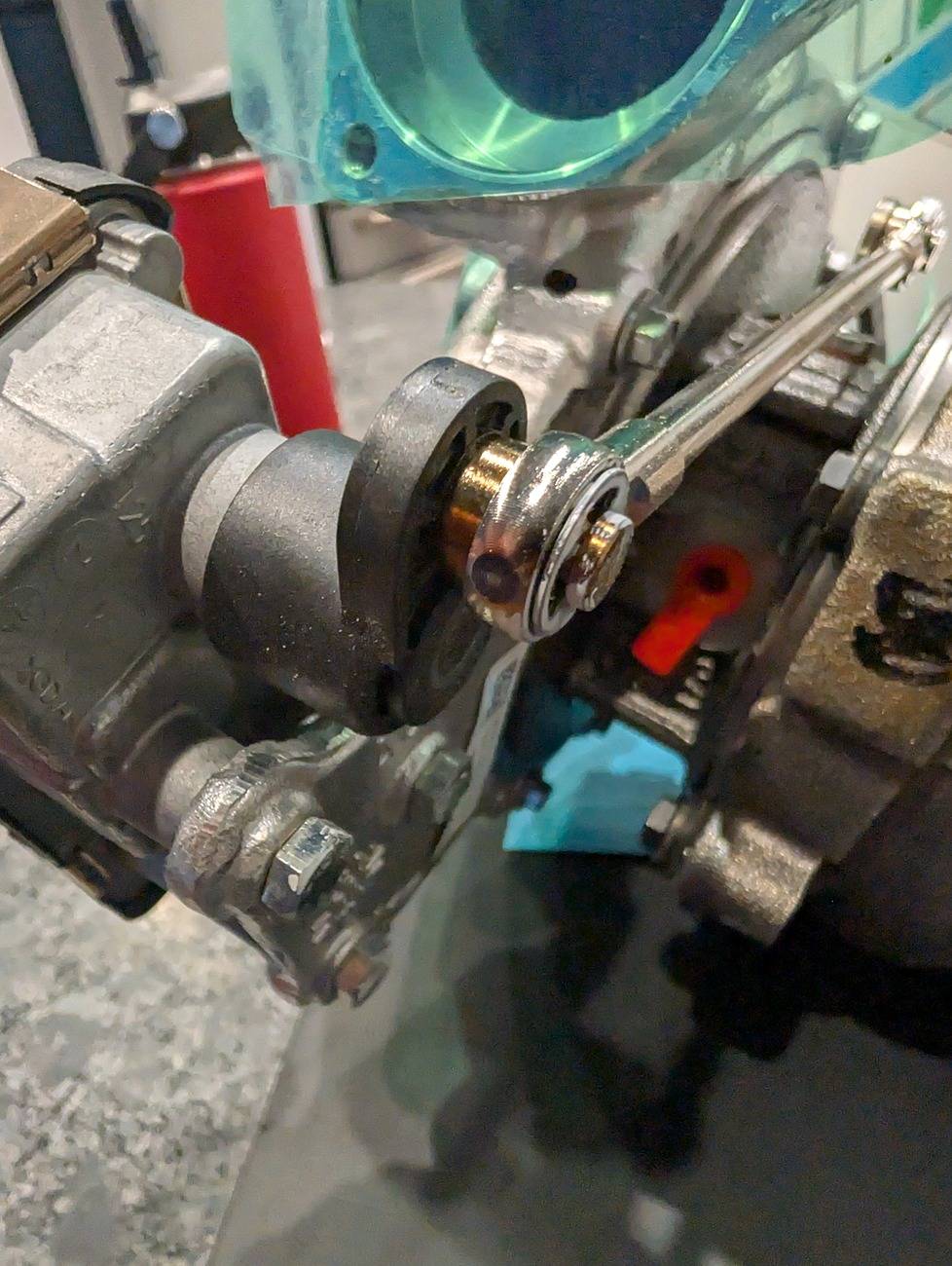

I agree with your belief in a QC issue. I was initially going down the path of designing a heat exchanger for the turbo vane actuator but ditched the effort once I determined a lack of correlation.
I ultimately have assumed its a QC issue with the vane system or the actuator.

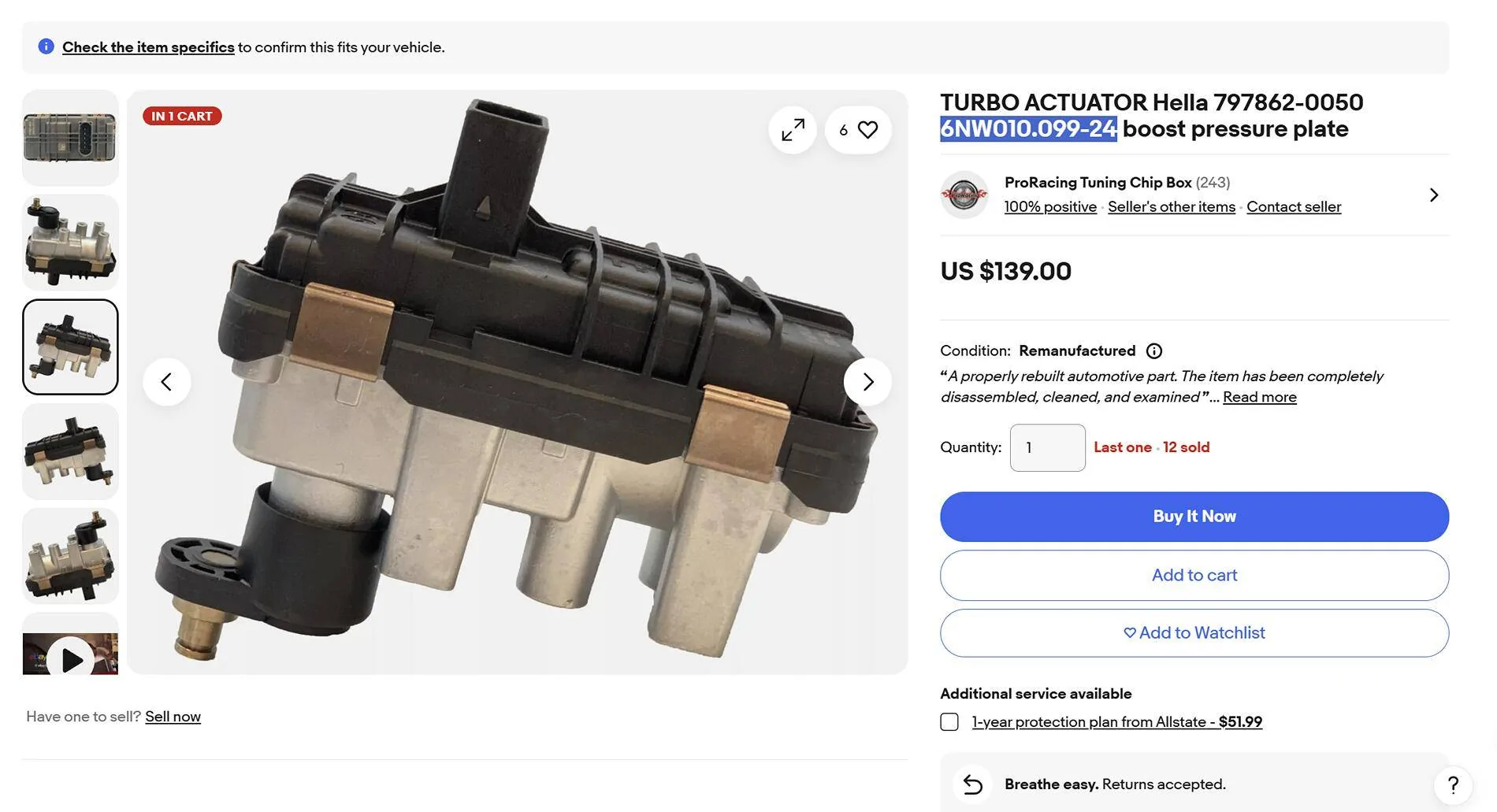

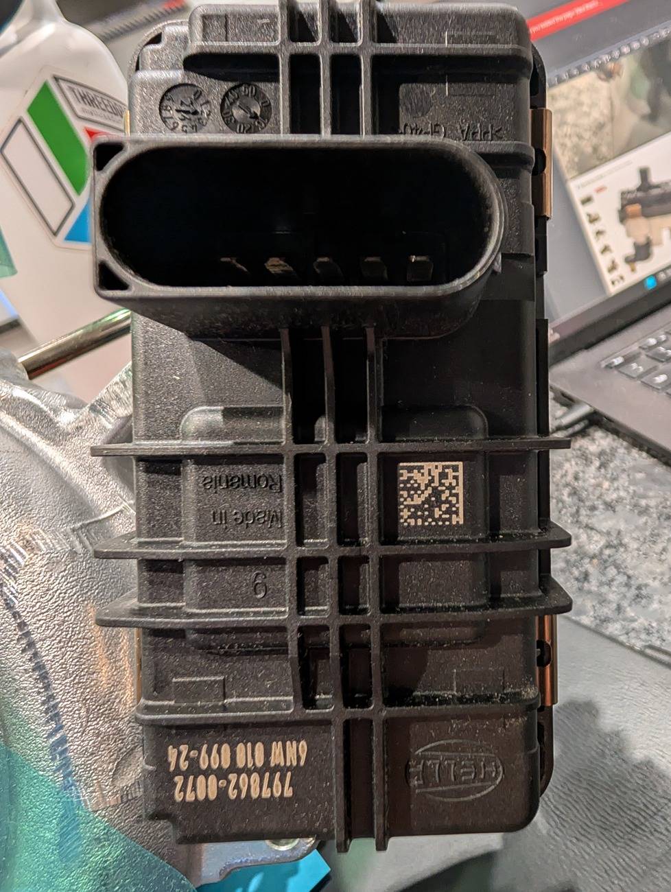

It's also crazy to me because these actuators are replaceable, I haven't found why folks haven't replaced them. In fact, I might purchase a new actuator and swap the one on my currently installed turbo first.
Photo are from my replacement turbo, yet to be installed.

Do you guys think the P00af code is related to vanes? I recall this video a while ago where a duramax was having turbo issues related to vanes and essential the vanes got got gummed up and and the controls couldn't actuate it. Granted this is for a duramax, but we also have variable vanes, and either through manufacturing or soot contamination the vanes could become a issue and not work right.
I recall a post on here where one guy and the control servo all chewed up aka black dust.
maybe when the p00af code hits you can use a scan tool to see if it can report the vane position?
Let me know if you find a part number for the actuator.

Agreed, but to your point about QC, if the clearances are to tight and the part gets to hot, the clarance can go down to zero and act like a gummed vane.
My point is has anyone verify vane position when this occurs?
On a turbo that is replaced because of a p000af one could open the bad turbo and look for wear/rub marks or even actuate the vanes for smooth action similar to the video above to verify causality.
especially someone who has been shunned by FCA and denied warranty, they now have a fancy desk ornament.
