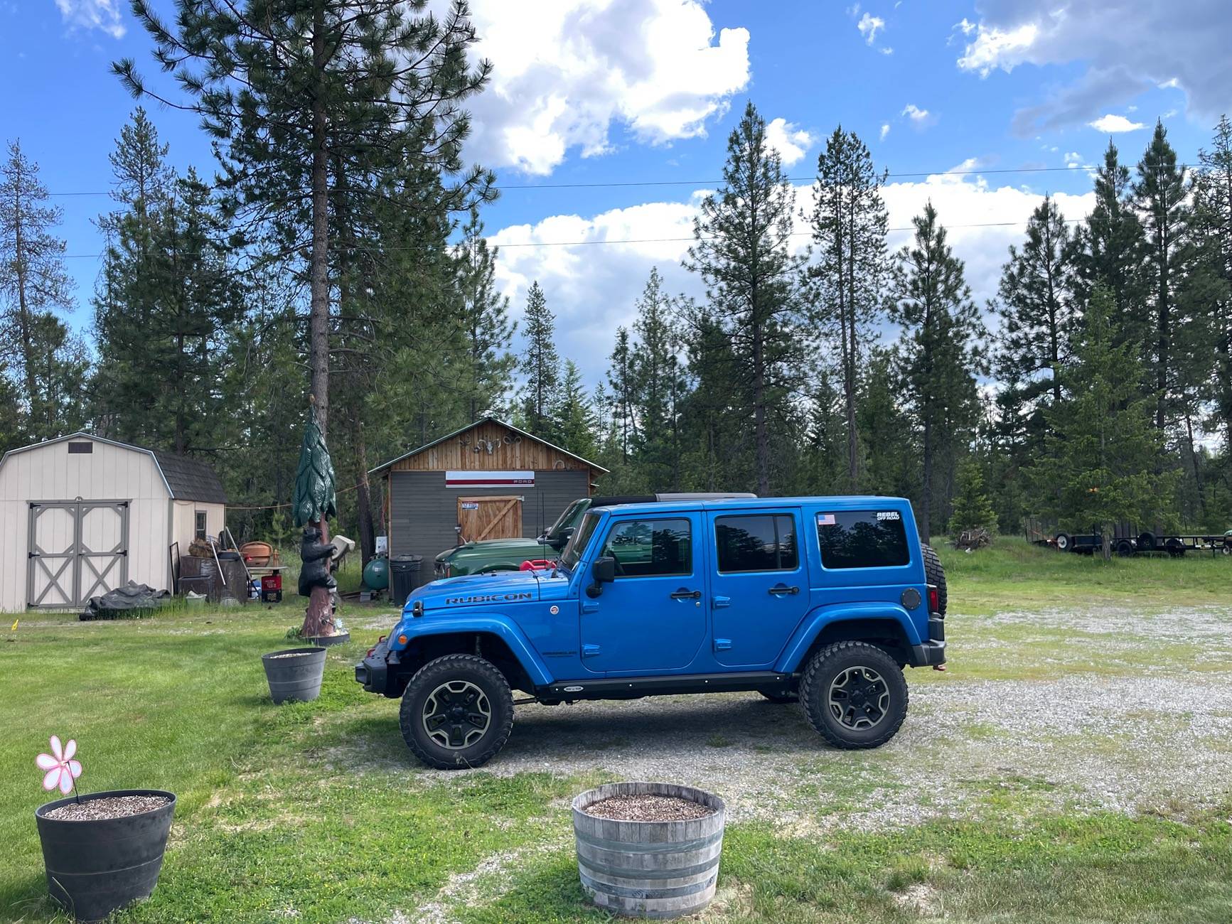

Here is the last picture I have. I liked how it looked, but some don’t like this look. It is a Rubicon Hardrock and the 2” Mopar lift gave just over 3”’of lift as the only heavy thing on the Jeep are the Rockslide Engineering steps (I love those things). I gave it to my sister. The rear tires look too forward in this pic but they are centered in the fender well.

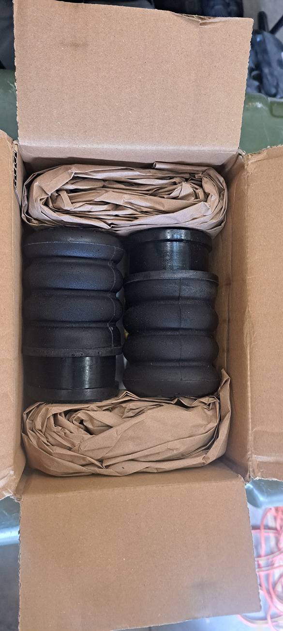

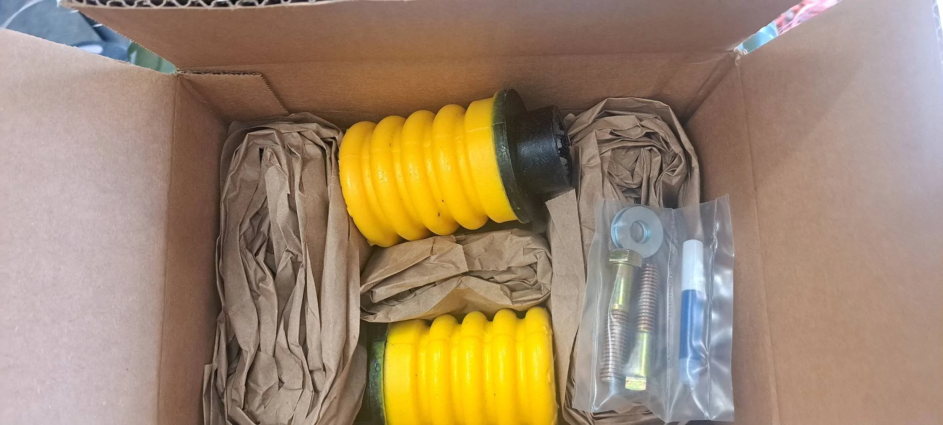

The bump stops on the 3.0L slam hard on anything like a minor pothole at speed. I had to baby it on the trail the other weekend as well.
Is it me, or is this known? I’m temped to get some teraflex oil damped stops until I get the lift.
Jeeps are notorious for this problem. I drive 1000s of miles of hard offroad trails in MOAB and AZ every year, and these Sumo Springs made all the difference. Super easy install.
