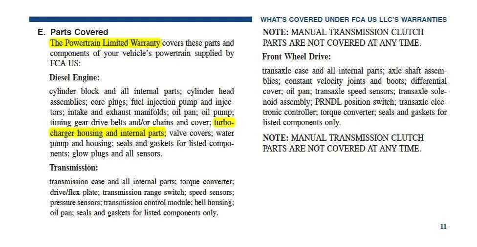

I agree with you that it should be covered even my dealership said it should be covered and couldn't understand it. I also sent that image of our manual to jeepscares clearly stating it's covered under the power train still denied saying It falls under federal emissions warranty. Jeep does not want to fix there issues or take care of there customers.
@AXISJT, I just looked at the warranty on my 2023 Jeep EcoDiesel and it says the "turbo-charger housing and internal parts" are covered under the 5 year/100,000 Powertrain Warranty. If I were you, I would try a different dealer or get an attorney involved.
Also, they lied to you about the federal emissions warranty. It says the federal emission warranty is 8 years/80,000 miles.

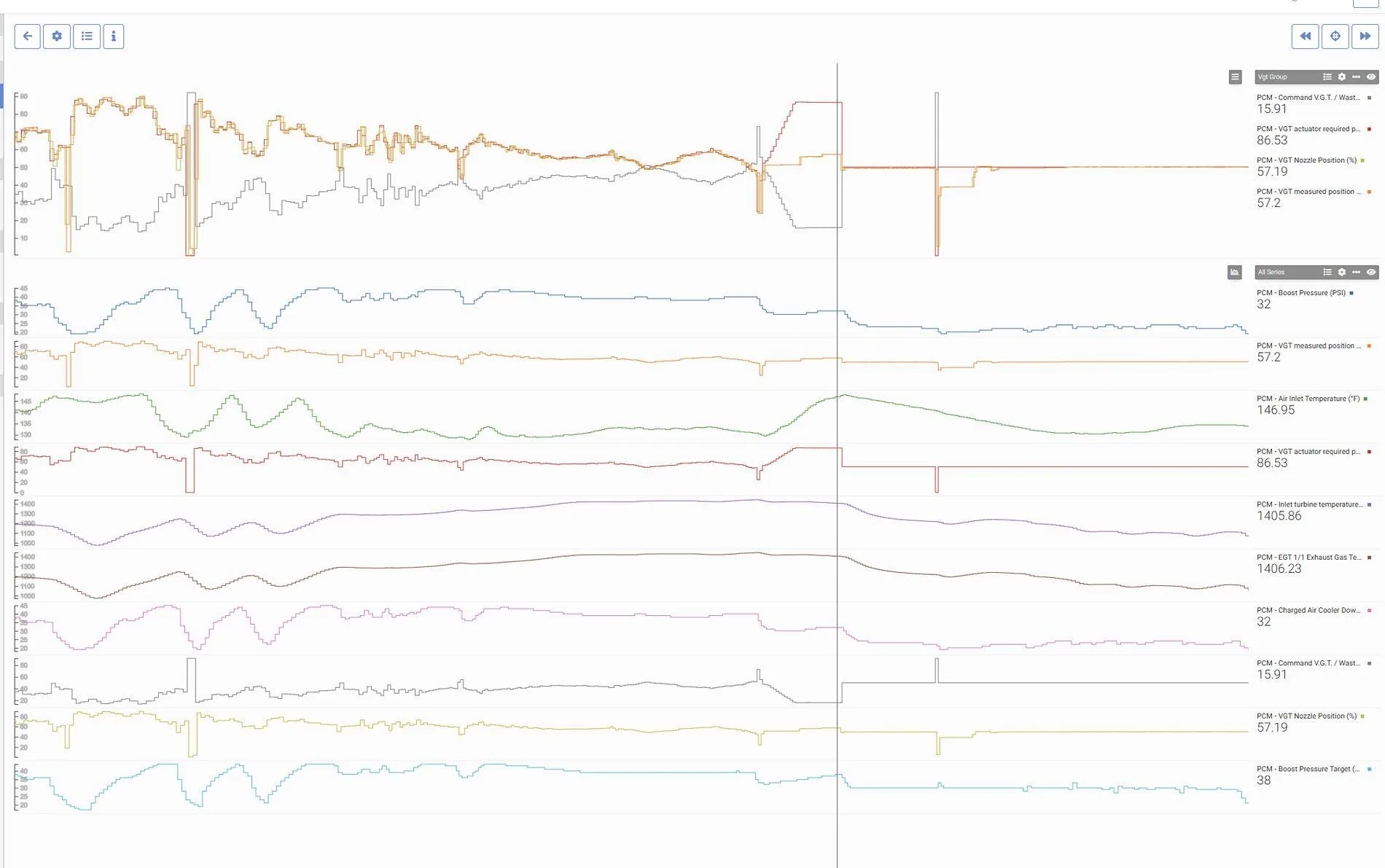

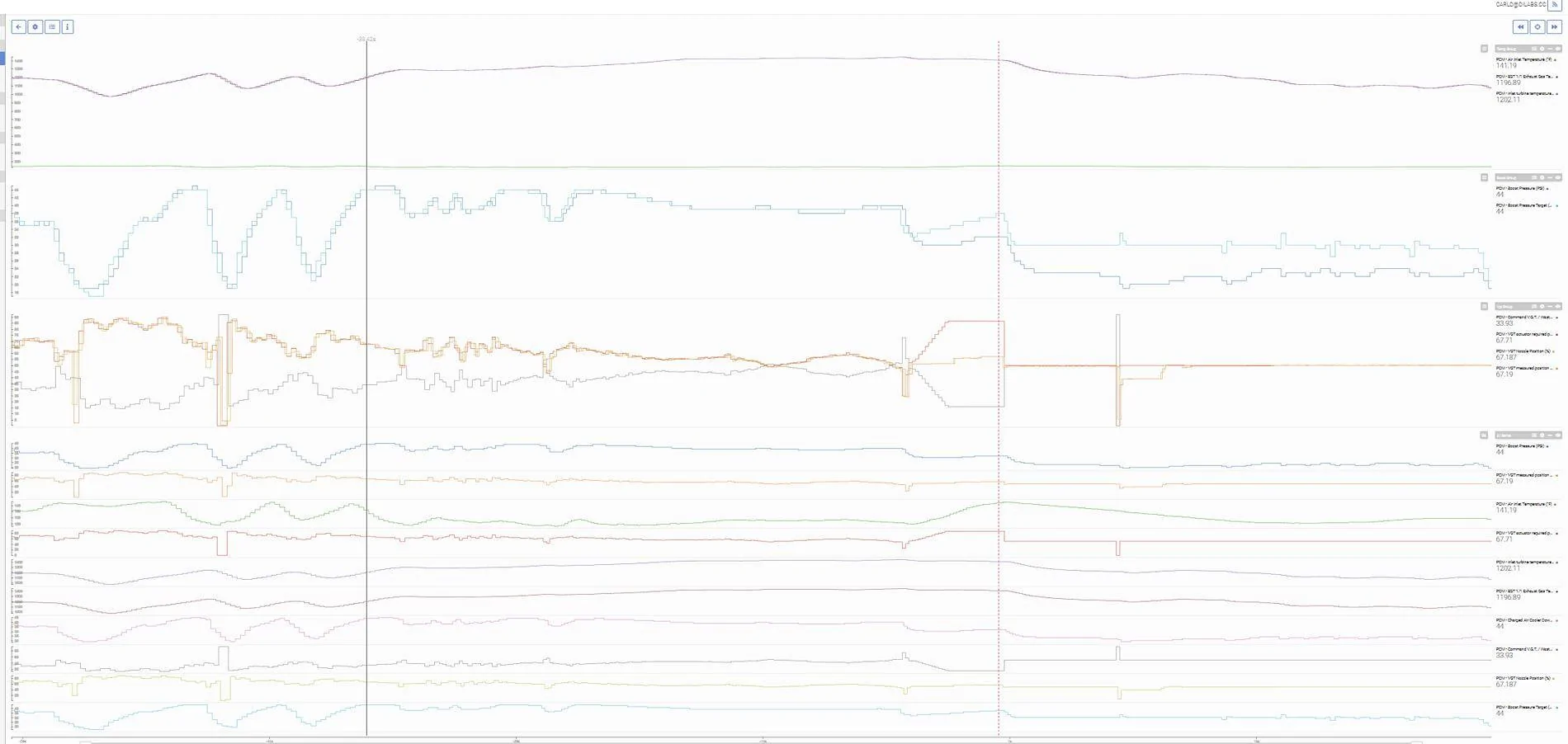

I swapped my VGT actuator for the hell of it :).
I learned there is no VGT calibration function for our platform. I first tried AlphaOBD and then resorted to WiTech 2.0 and found no option. After some researching I found it doesn't exist. This was after I swapped the unit. At that point I worried this may be the reason for no replacement actuator options.
I said, "Well, it's in, what's the worst that could happen?" I took it for a drive while flight recording (collecting data through WiTech). I was happy to see that the actual vs. target boost and VGT position were tracking perfectly. So far this is a win, I am cautiously optimistic (been here before).
I have a 24' enclosed trailer I will hook up soon and do an extended load test to see if I can trigger the P00AF. This is a load condition that's repeatedly triggered the error in the past.

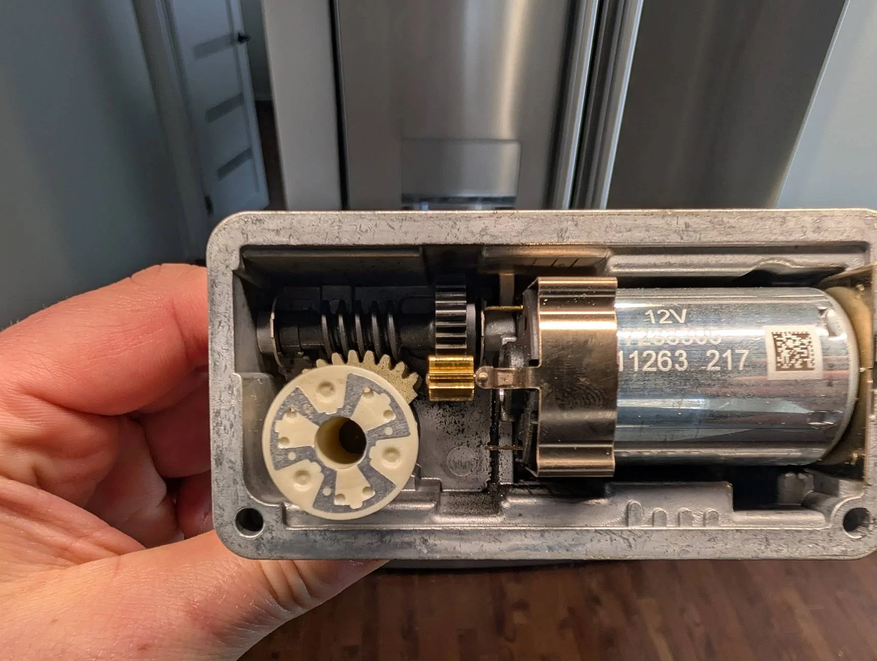

I disassembled the old actuator and found no obvious issues.
Jeep Gladiator P00AF - The Journey 2025-04-04 15.46.03
I'll share more as I learn.
did you apply 12v to the old actuator with the cover off to see how it operates?

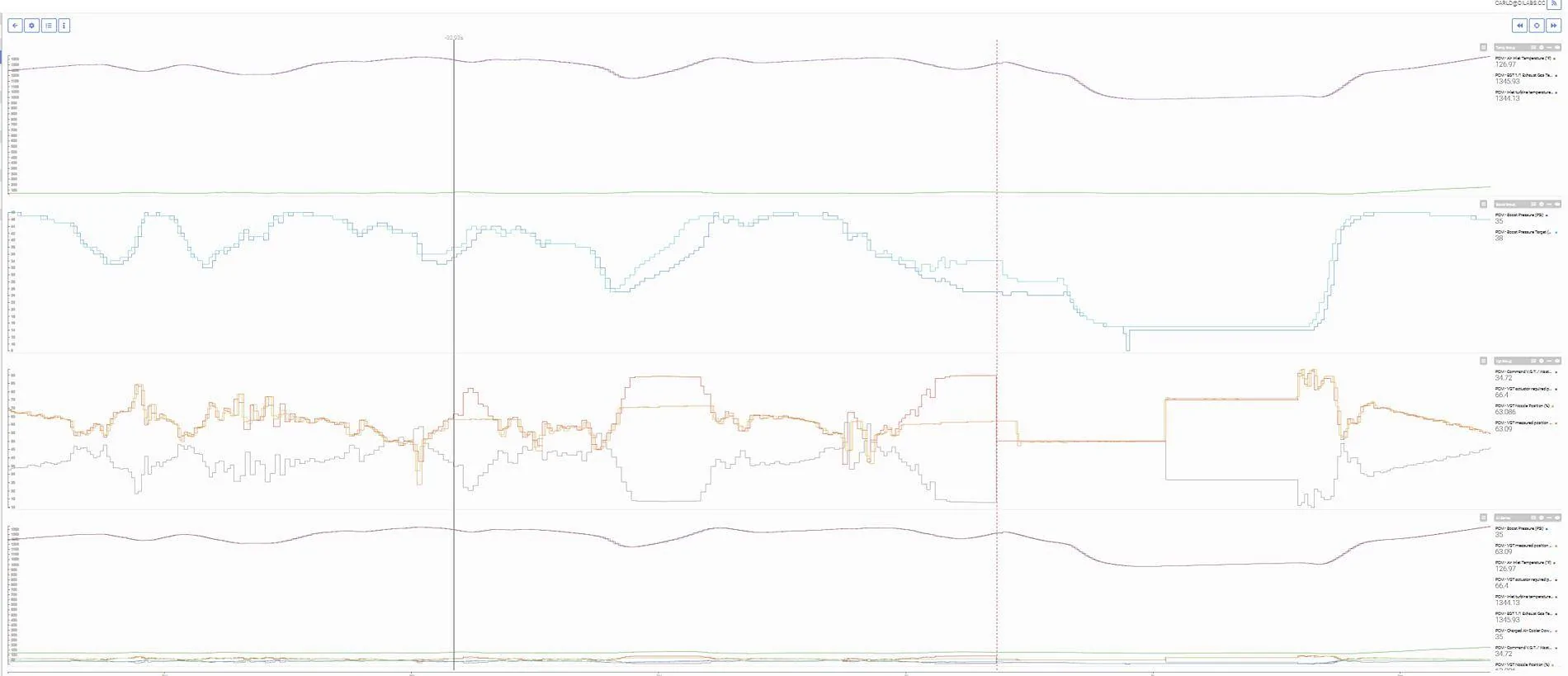

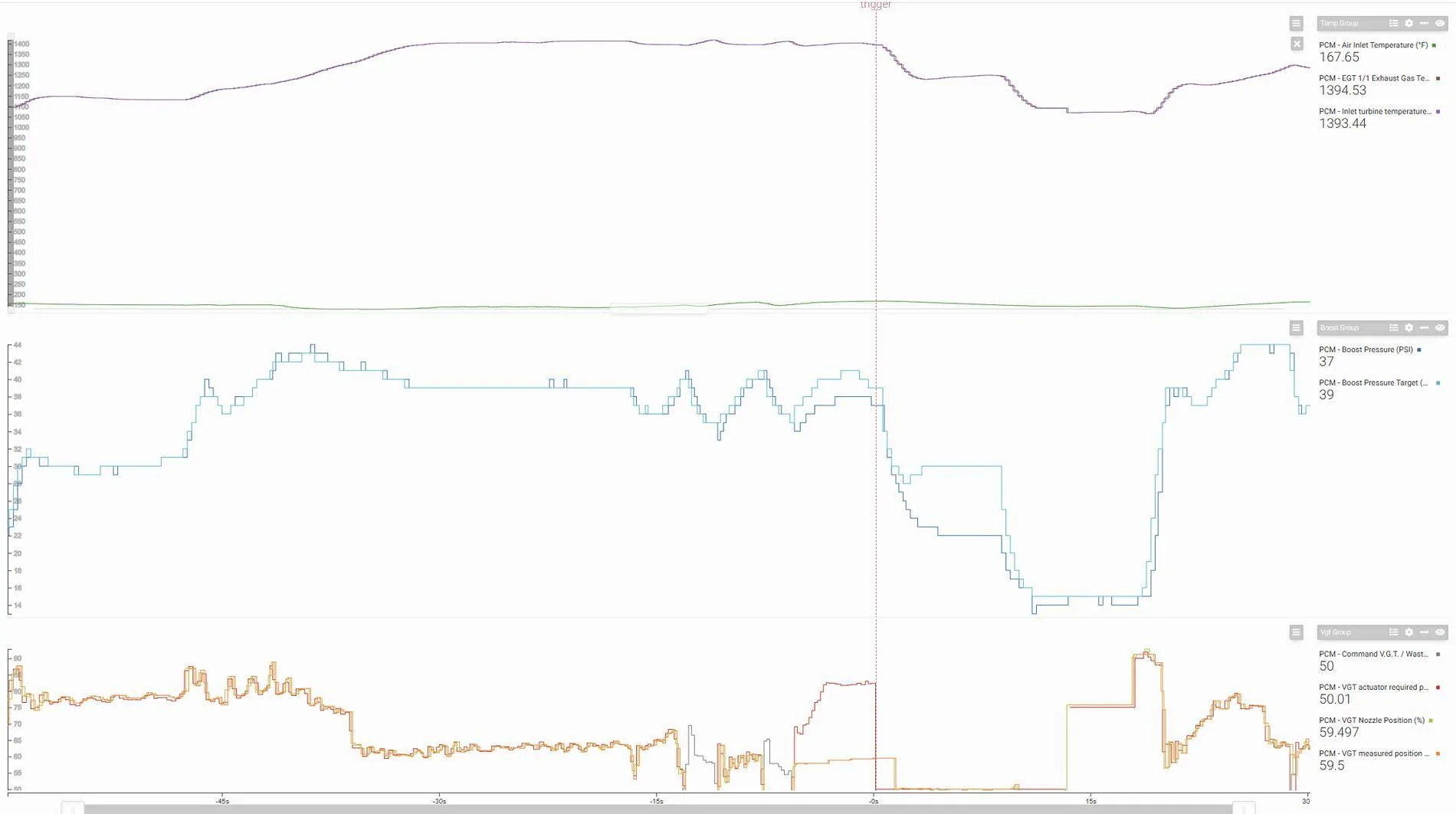

I didn't, I may do that for fun but based on the data I've collected, the issue only occurs under certain circumstances. I have included some photos with data collected proceeding the P00AF code. For the graphs with two vertical lines the dotted vertical line represents the P00AF trigger, if the graph shows a single solid line, that is the error code.
This is meant to show that under normal operating conditions (not steady load) the system functions as intended. One hypothesis is that the actuator is heat soaking which affects the electronics . On a few occasions the actuator just stops and flat lines and other occasions there is a little movement so it's difficult to pinpoint the cause. In a perfect world there would be a actuator temperature
