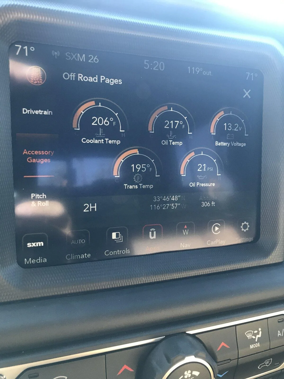

Muy caliente! No problemo. Hit 119 today no issues so far.

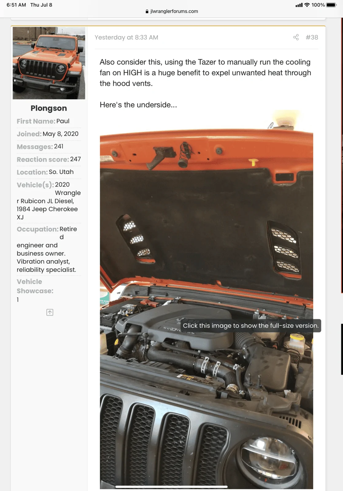

More experimenting over at the JL site.
anyone try this? Not the 392 hood but the stock Rubi hood and a taser.
